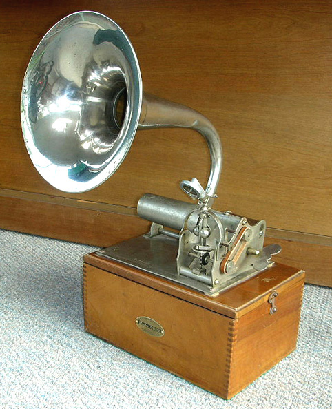

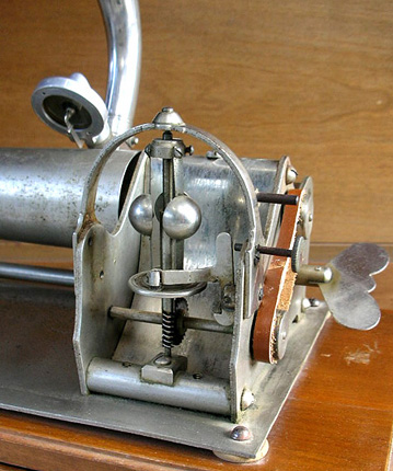

If you do want to go for a European style, I'd suggest looking for one with a 'hunting horn' design. A particularly interesting clone is the Omega, which has a vertical governor assembly. Definitely unusual but not really rare (at least in Europe).
