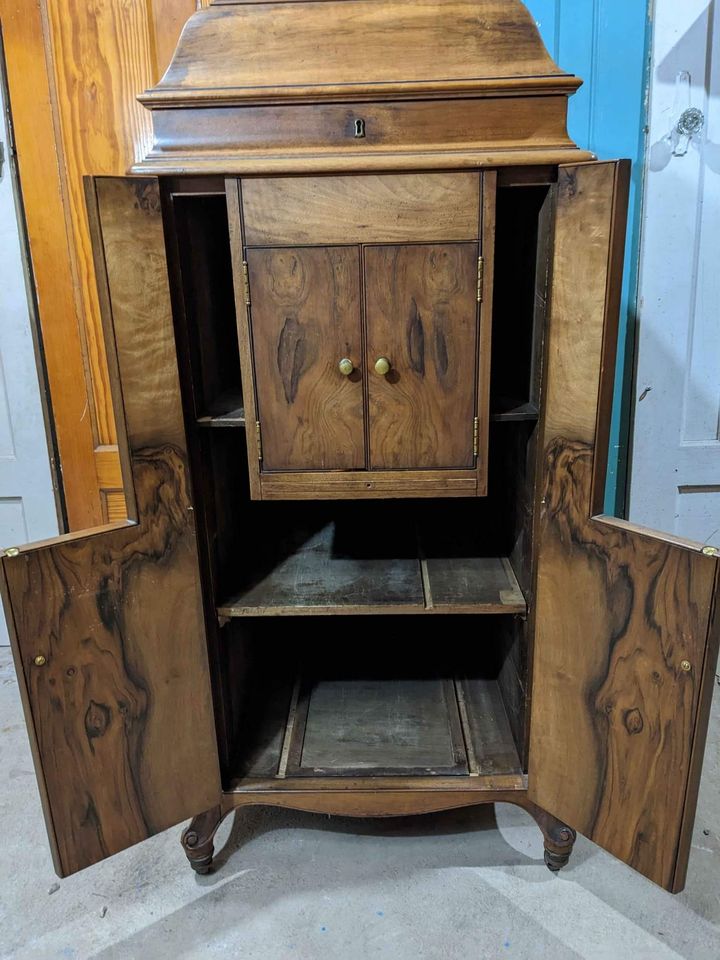

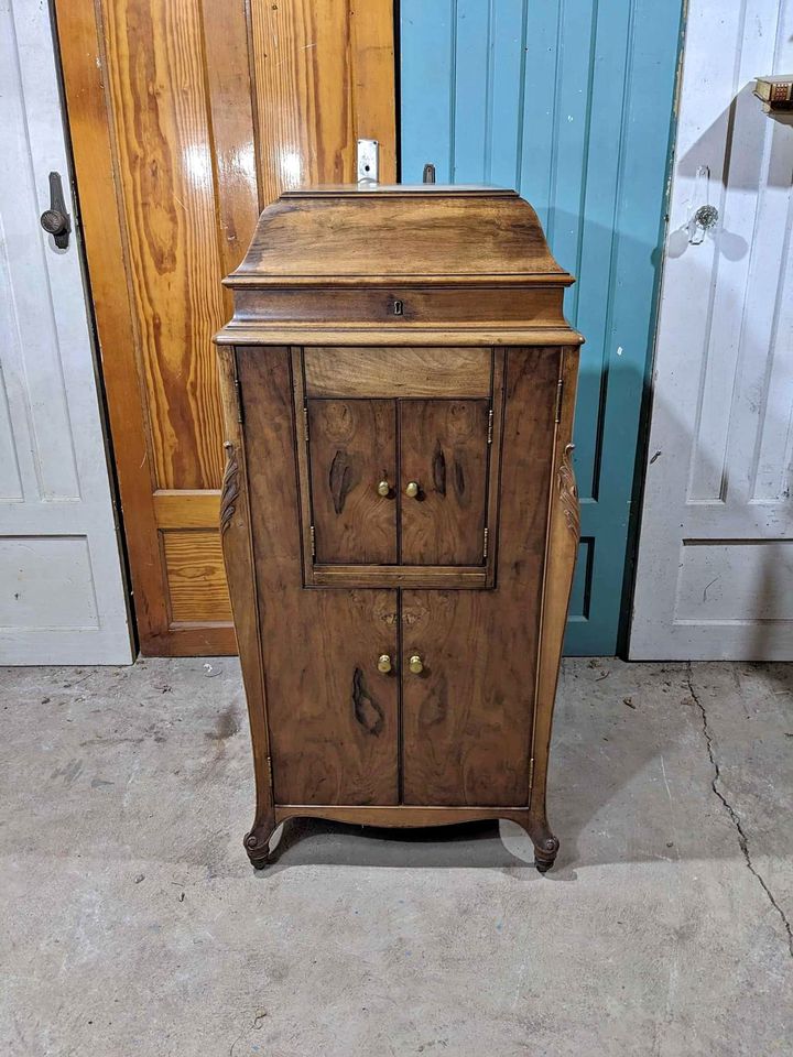

I said I wasn't going to do this anymore. Then this came up for sale not far from me and I couldn't resist. A circassian walnut L-door XVI. And I only paid $60 for it. OK before anyone starts commenting "deal of the year", I did say it's a project. The machine looks great and most of the wood is present, but the inside is gutted. The old owner made it into a beverage bar. I understand the appeal by some to do this, but to do it to a circassian walnut machine? It boggles the mind. The person obviously had no idea what they had.
If you look at the pictures, you'll understand. I've already removed the added interior parts of this "bar" as to stop insulting it. And I will try my best to bring it back to its former glory. So I will need some parts. A few I have lying around but I've decided to go after the really difficult pieces first. If I can't find those, no sense in buying the others. And if I can't make it happen then it will return to a beverage bar. The machine has it's original finish and that will clean up nice. I need to find a good (great) woodworker for the top part. To somehow rebuild the top board and make the color match. I used to know such a guy but he has since retired.

Oh it's hard to look at it all cut up inside like that. I wish you all the luck on this project, that outside is breathtaking

My hope of that bar thing was done 50 or 60 plus years ago and not in any year past 1975.

Even if you can't find all the parts you need, please don't turn it back into a bar. There are many others who would be glad to take over the project should you decide to give up. Congratulations on rescuing an important victrola.
