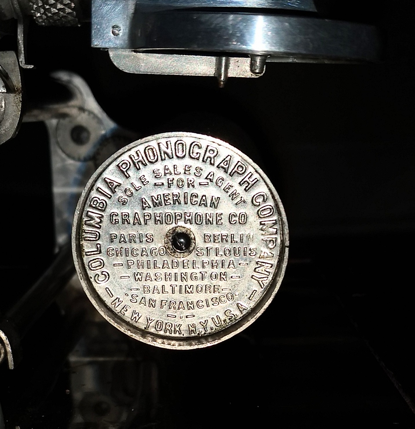

As picture #8 shows, my machine has the end-cap on the mandrel, which I believe was introduced after 1901, when the AA was sold. So again, this points to it being a later-produced machine. Also, Hazelcorn lists the last serial number for the AA as 712527, but as picture #9 shows, mine has the serial number 712826 -- much later than Hazelcorn's latest known example.

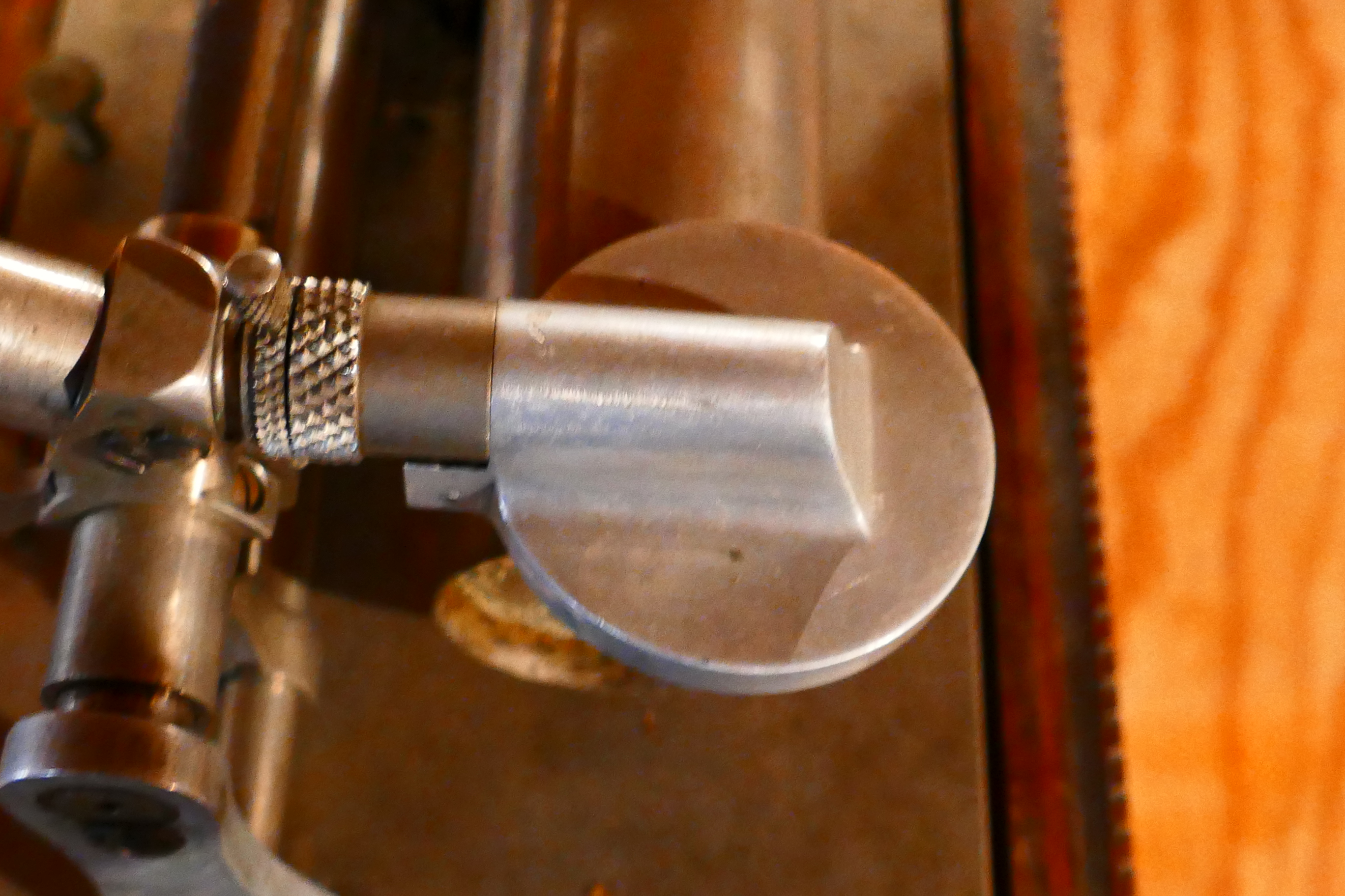

Another mystery is the reproducer. Hazelcorn says this machine originally came with a Columbia #2 floating reproducer, which makes sense given the 1901 date. Mine, though, has -- well, you can see what it is. Nothing like it is pictured in Hazelcorn. It looks like some 1980's reproductions I have seen (although none of those had stylus bars like this one does), but given that I know this was sitting in that attic at least since the 1960's, and probably earlier, I don't know how that's possible. What's more, just about every picture of an AA I've seen online has this same reproducer on it, except for one that appears to have a Columbia #7 on it. Could it be original? If so, what is it?

4. I can't get the reproducer off. (I don't want to try too hard and risk damaging it.) Any tips?

The reproducer you show on your AA Graphophone is typical for Graphophones of this period. A drop of penetrating oil at the base of the reproducer should help with its removal.
Mandrel tags began to appear on Columbia Graphophones in mid-1898.
