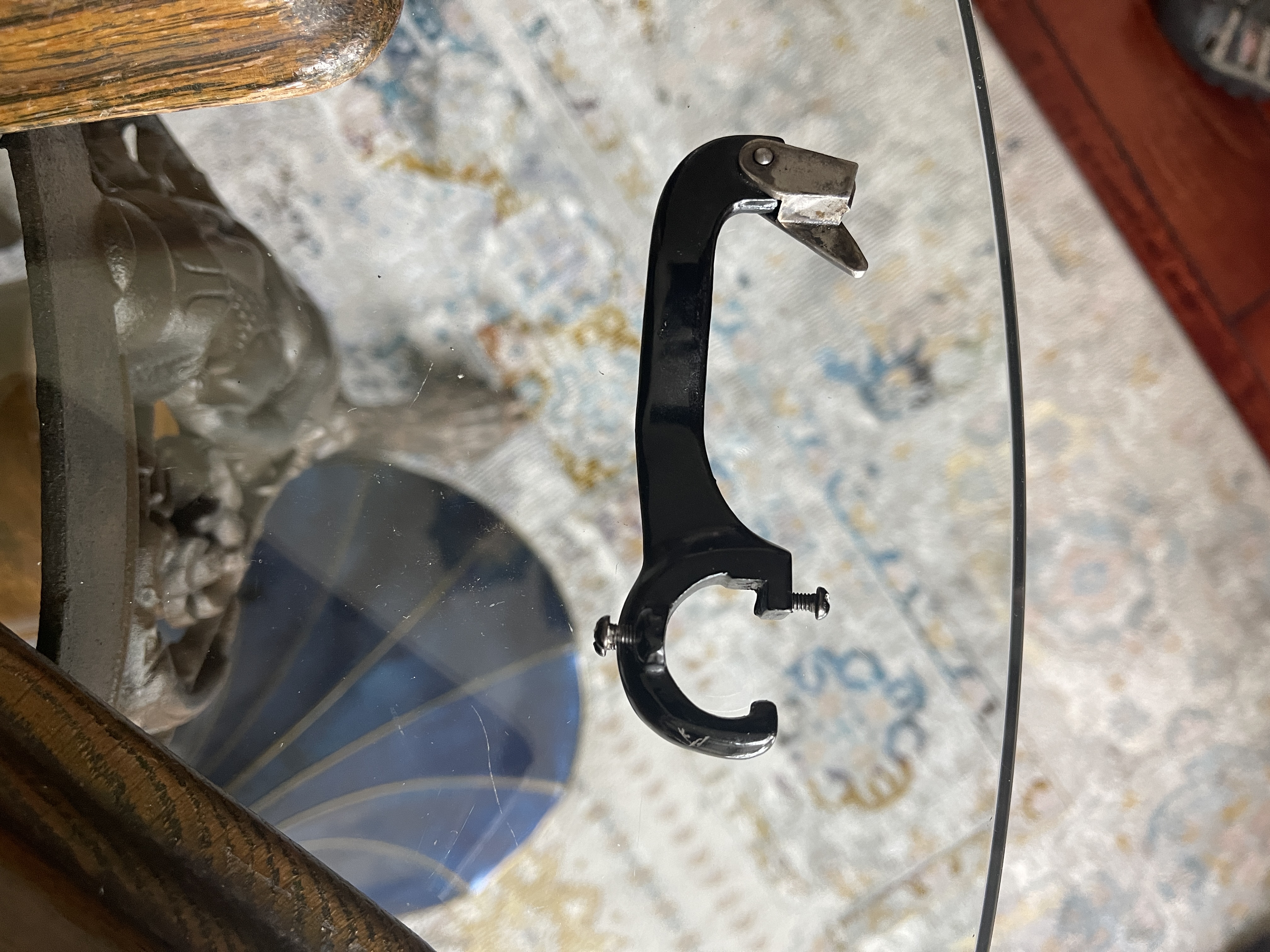

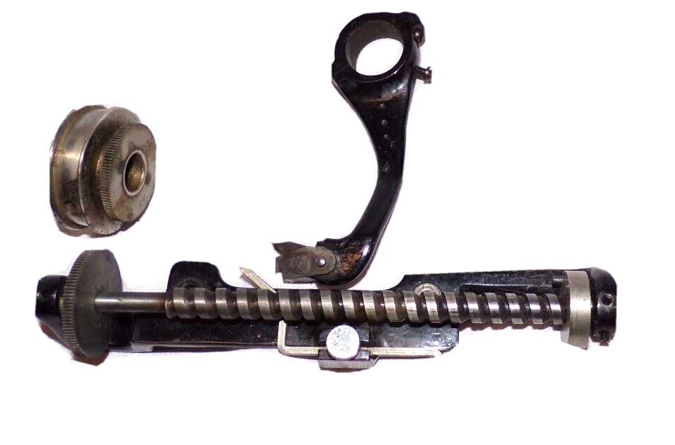

Yes, the repeater listed is for a Triumph. No, it will not fit on a Home (parts of it would). The arm where it attaches to the carriage is different. I dont believe the D repeater was even designed to lift the weight of a non crane supported horn.
Attached are pics of both designs.
