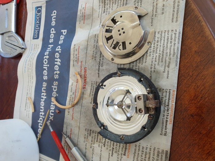

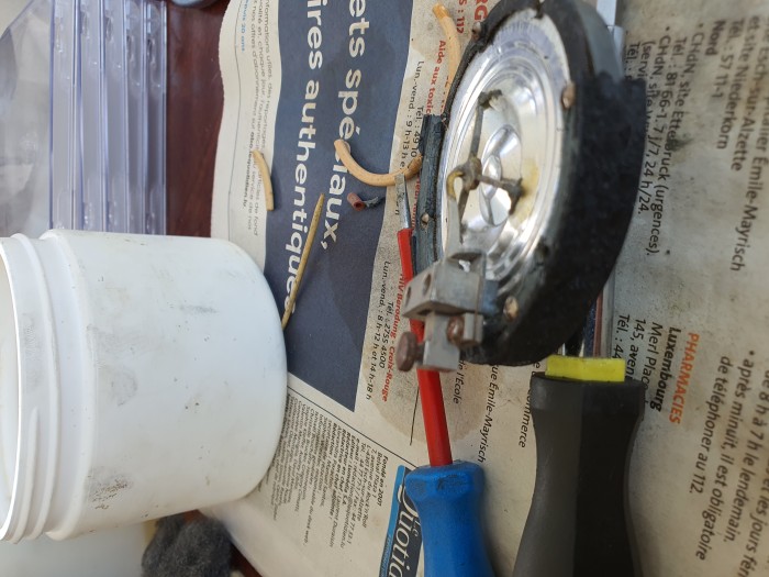

I disassembled a derelict Pathé soundbox from the late 20's/early 30s, and was surprised by its design. As you can guess from the photos, it is a beautiful Art Déco design, unfortunately unusable due to extreme swelling of the pot metal disc that holds the needle stem. The uniqueness of the design lies in three-legged spider connecting the needle bar to the diaphragm (visible in the photo), and the laminar spring that is used to flex the needle bar - this part of the design is not easy to see, as with the swelling of the body the connection broke, but it still can be hinted in the second photo (one side of the spring was screwed to a part of the disc, now broken). The only other use of a laminar spring to connect the needle bar I have seen, although quite different from this soundbox, is that of the Palmodian (the machine that utilizes a violin body in place of the horn). Too bad that the pot metal Pathé used to build this soundbox was so unstable (I have another one of these in the same poor condition), as the design hints at a high quality of reproduction.

The design of diaphragm and spider being so similar to the well known orthophonic system, it would be great to know if the backplate behind the diaphragm is shaped equally, as in the Victor/HMV examples.
The flexible copper plate (player spring) used to joint the needlebar fulcrum is a system also used by the later good quality Paillard and Thorens soundboxes.
