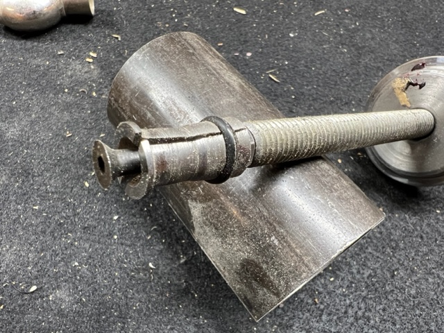

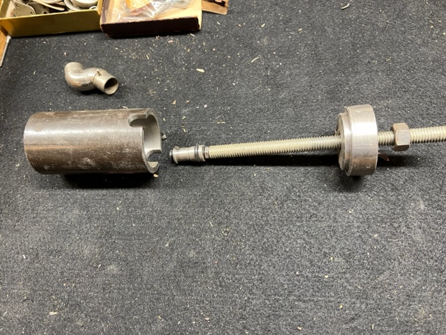

Re: Victor concert junior Long throat - how to open
Here is the tool I made to pull apart Victor Concert reproducers. I machined a piece to fit inside the tube and then cut it in half. There is a groove for an o-ring. The beveled head machine screw gets drawn up inside and expands the two halves. This will hook the ends inside. The reproducer then is fit on the end of the large pipe and then I slowly screw the large nut tighter until the reproducer comes apart. It is best to either de-solder or cut the wire on the needle bar.
I forgot to mention that in addition to detaching the wire from the diaphragm that I also use a curved dental pick to loosen the diaphragm from the gaskets as I start to pull it apart.
so this is a method that leaves the diaphragm undamaged. there is no fear that the throat will be separated from the inner part of the reproducer ?
- Phono-Phan
- Posts: 2908
- Location: Plover, WI
For the most part, yes. The diaphragm sometimes is very stuck to the gaskets. That is why I use a curved dental pick to help loosen the diaphragm from the gasket.
