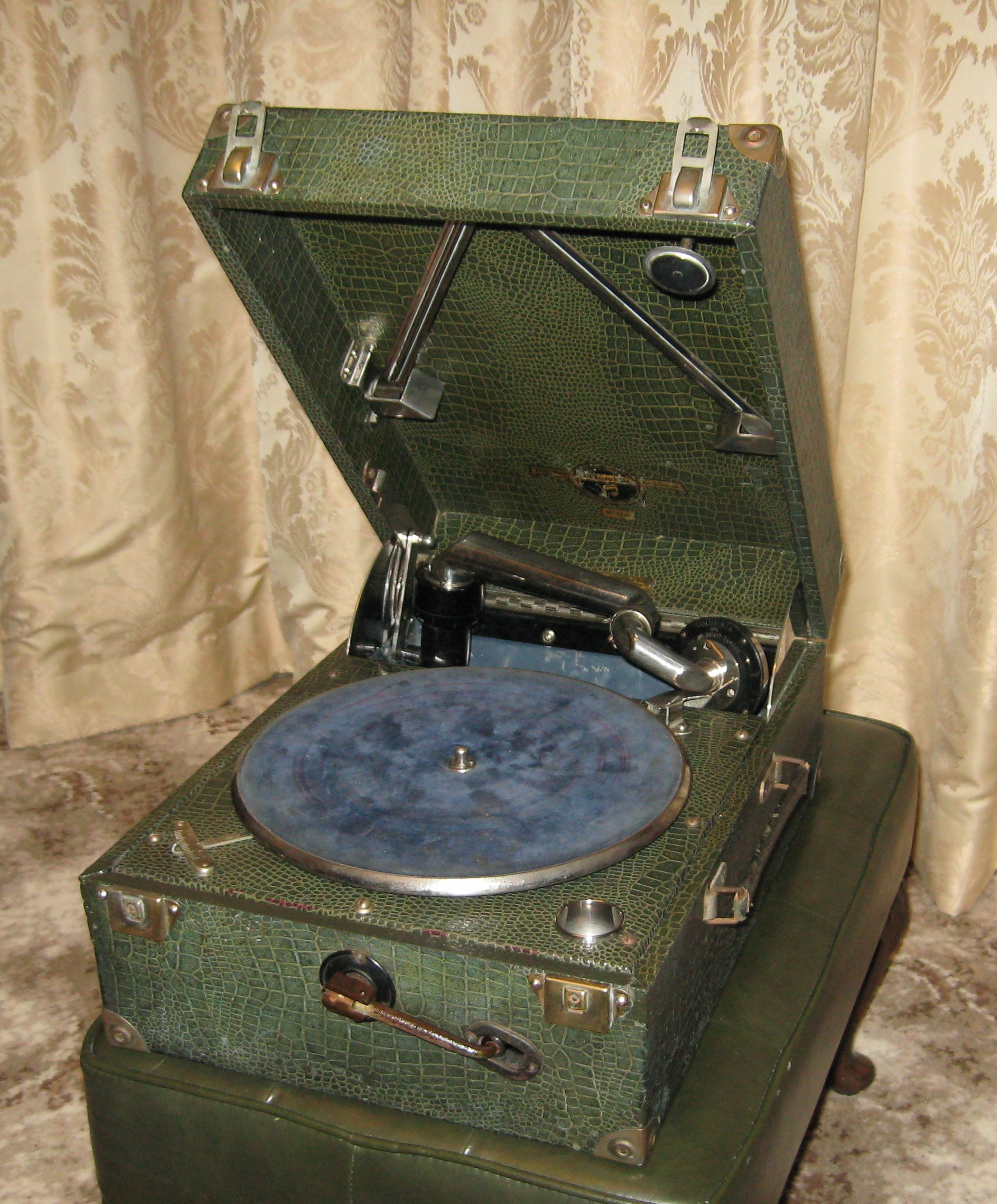

Inigo wrote: Tue Nov 09, 2021 7:24 pm It looks as having a big exponential horn inside... Must sound very well ... although similar to other portables, those have the tonearm at the back, so the horn is a bit longer. In this one, the mounting of the tonearm suggests that the horn runs along the large side and then turns right along the short side straight to the back opening. Shorter and wider than the other horns. Anyway, summing up the length of tonearm, large and short sides, it could well reach a total length of four feet for the sound pipe... not bad!
The size of the crank & latches compared to the rest makes it look diminutive. I am sure it has more horn than the average Birch 500 or Waters-Conley Phonola one is likely to find in the USA so it is already a nice find.
My 202 runs great & looks great, of course, but it is just now starting to show pot-metal decline with the internal horn; I found a fragment of metal that had crystallized & dropped off the horn. I need to disassemble it, remove that section, and try building something new out of modern materials. Technology has advanced enough to make repairing it something more than a pipe-dream. I am not interested in letting it go to the bad.
This 125 is a cute design & I am thinking about picking it up, giving it a cleanup & a bit of oil, and putting it to work. The tonearm may be brass as the plating is in nice shape.
Posts: 5649
Re: Columbia portables..the endless enigma?
I have never seen a 125 before. The tonearm is similar to the larger American Viva-Tonal portables and the American inspired UK Model 113, so I would not be surprised if the 125 is an American machine.
The UK 202 and it's predecessor the 112a are well known for pot metal problems. The lugs on which the narrow pot metal horn pivots at the far end of the large sheet metal horn are prone to breakage. Repair is possible but tricky.
I very carefully drill through the lugs and their mountings, then pass a threaded rod through the entire assembly and secure the ends with nuts. Having done this to a Brown Crocodile 112a I swore I would never do it again, until an even rarer Green Crocodile 112a came my way. Only Blue, Brown and Red Crocodile versions appear in Columbia catalogues.

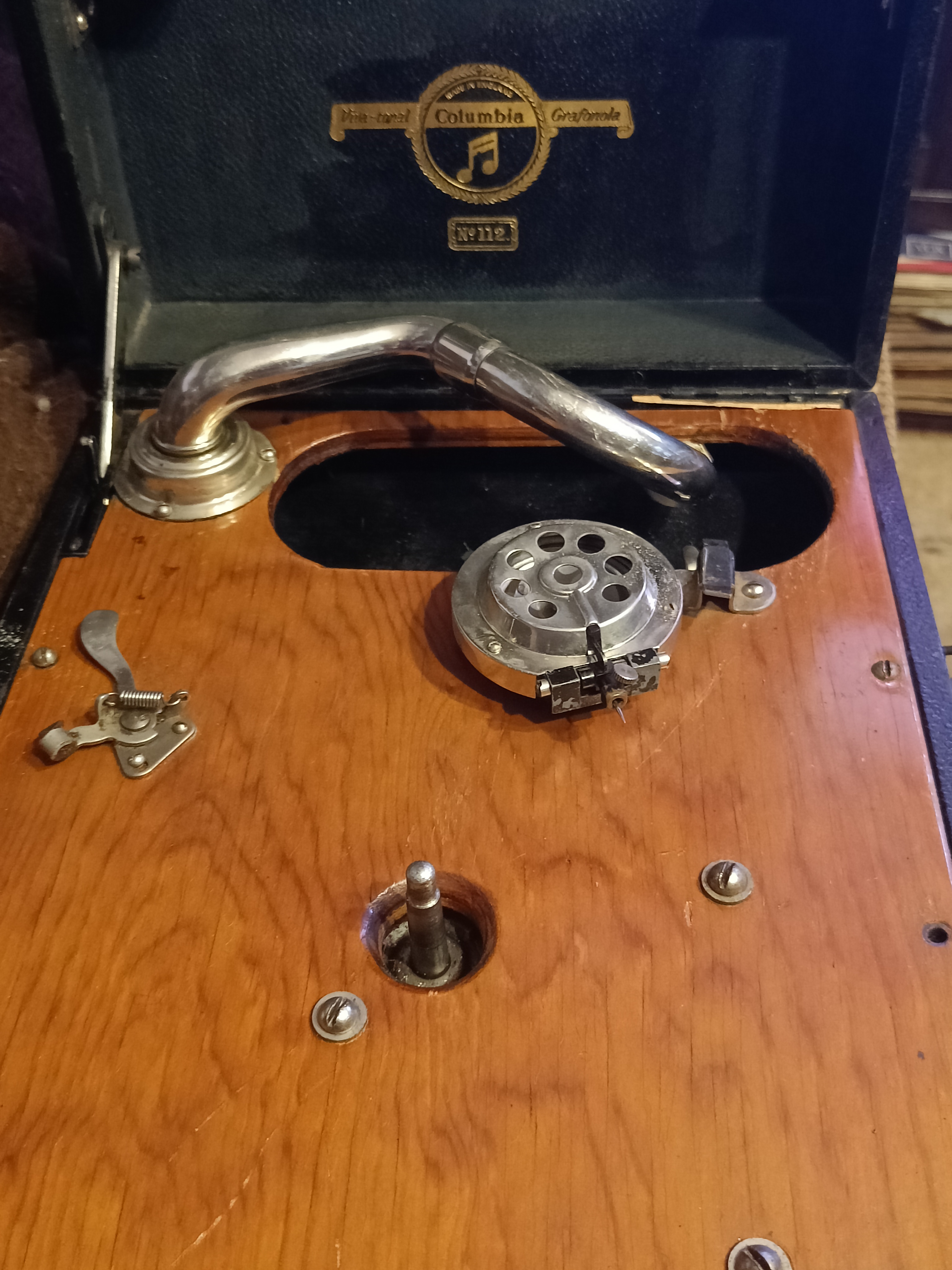

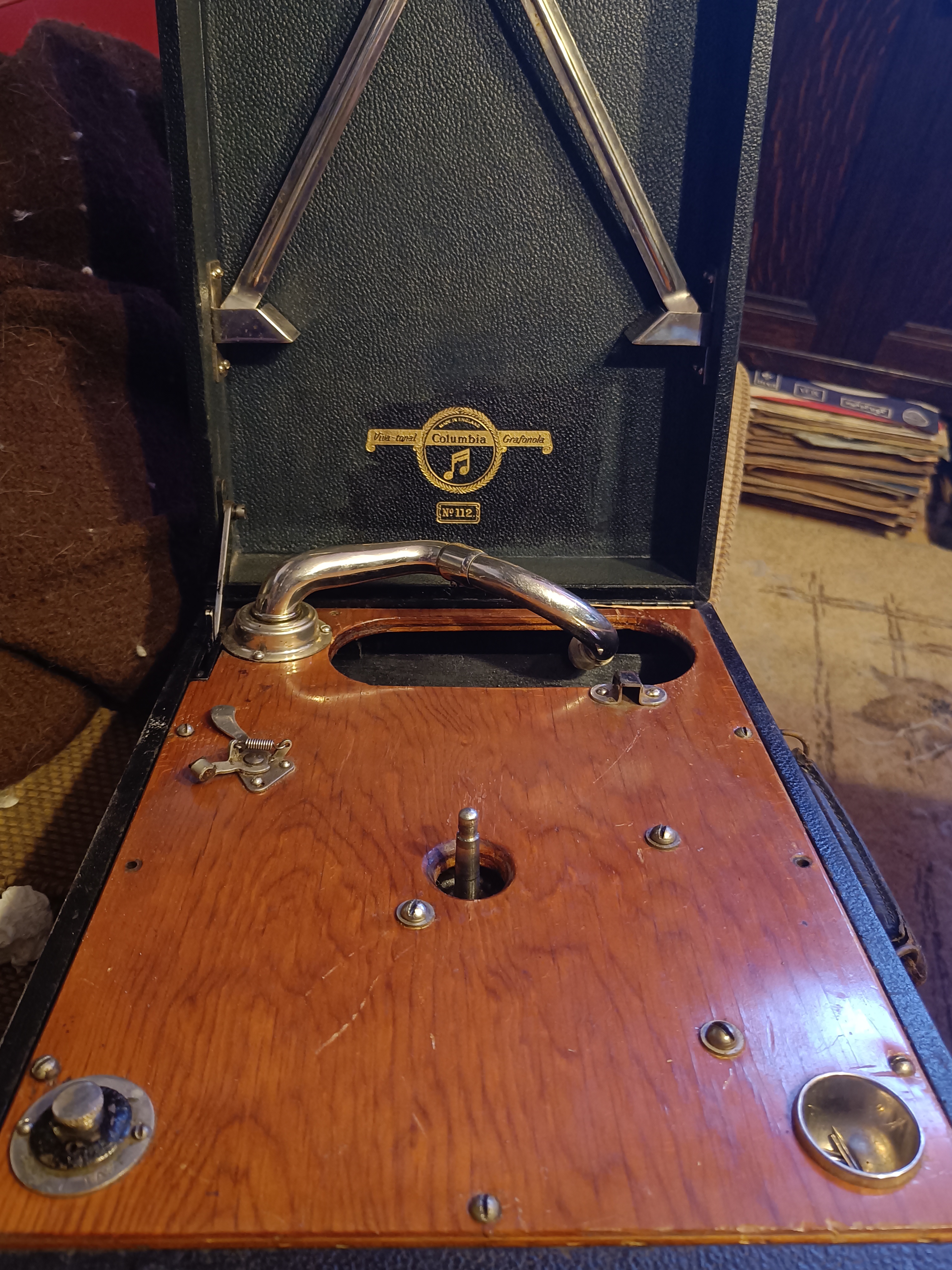

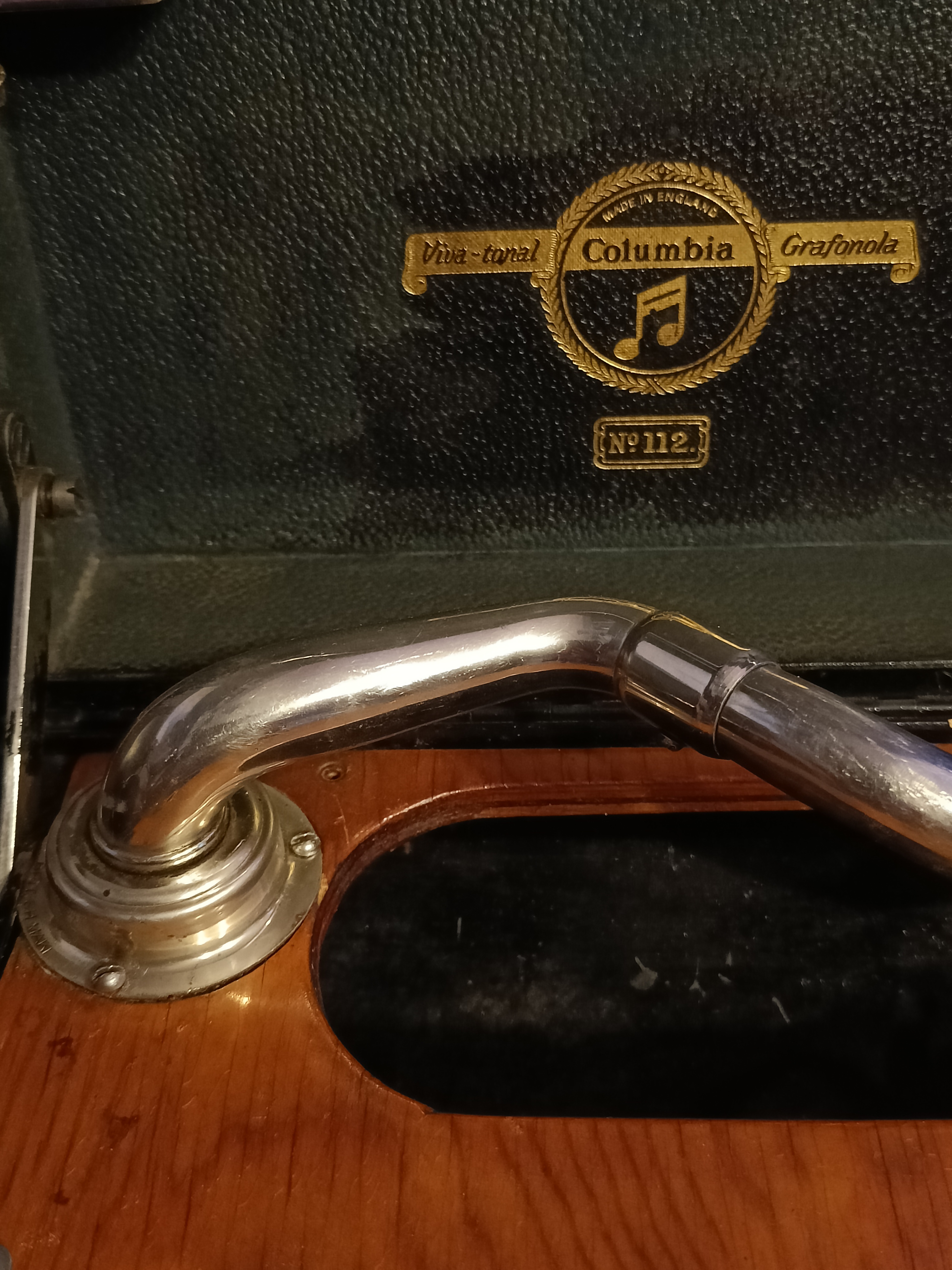

I am re opening an old thread, because of this Columbia 112, that landed on my doorstep yesterday. It looks nothing of what I was expecting it to look inside. The sound box is not original for the model, but...the motor board, and the tone arm and its base? I was expecting a straight tone arm, and a completely different tone arm base.
What are your views on this machine?
Posts: 5649
I suspect that the pot metal horn assembly suffered a breakage, and that a previous owner fabricated a new motor board.
They also sourced a replacement tonearm and soundbox. A lot of work to save a very common machine, but such things were done during the depression years when money was tight.

epigramophone wrote: Wed Jun 28, 2023 4:27 am I suspect that the pot metal horn assembly suffered a breakage, and that a previous owner fabricated a new motor board.
I am quite sure, you've nailed it. That is exactly what it looks like to me.
nostalgia
Posts: 1440
Post by nostalgia »
I agree, totally. Nothing to keep.
