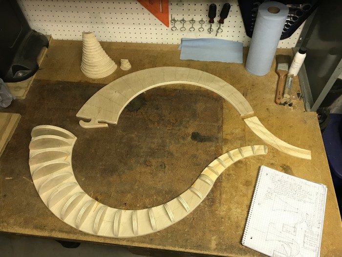

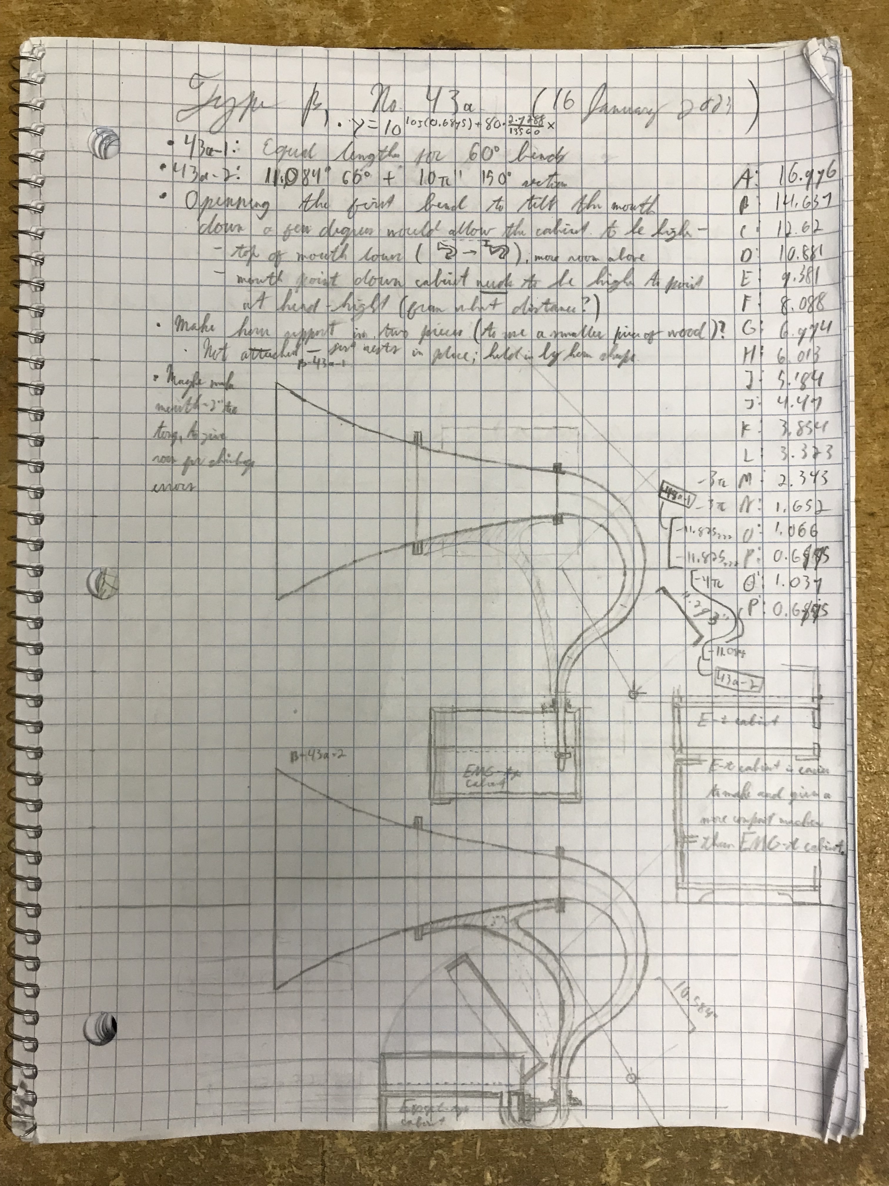

Here is the main design page from my notebook—I’m making the lower of the two horns (the B-43a-2); the only difference is that it has a 60° bend around a ~10.5” radius followed by a 150° bend around a 12” radius, instead of two 60° bends around ~11.25” radii (in opposite directions), followed by a 90° bend around a 12” radius, meaning that it can be made in two pieces instead of three.
The "Neck" Former--

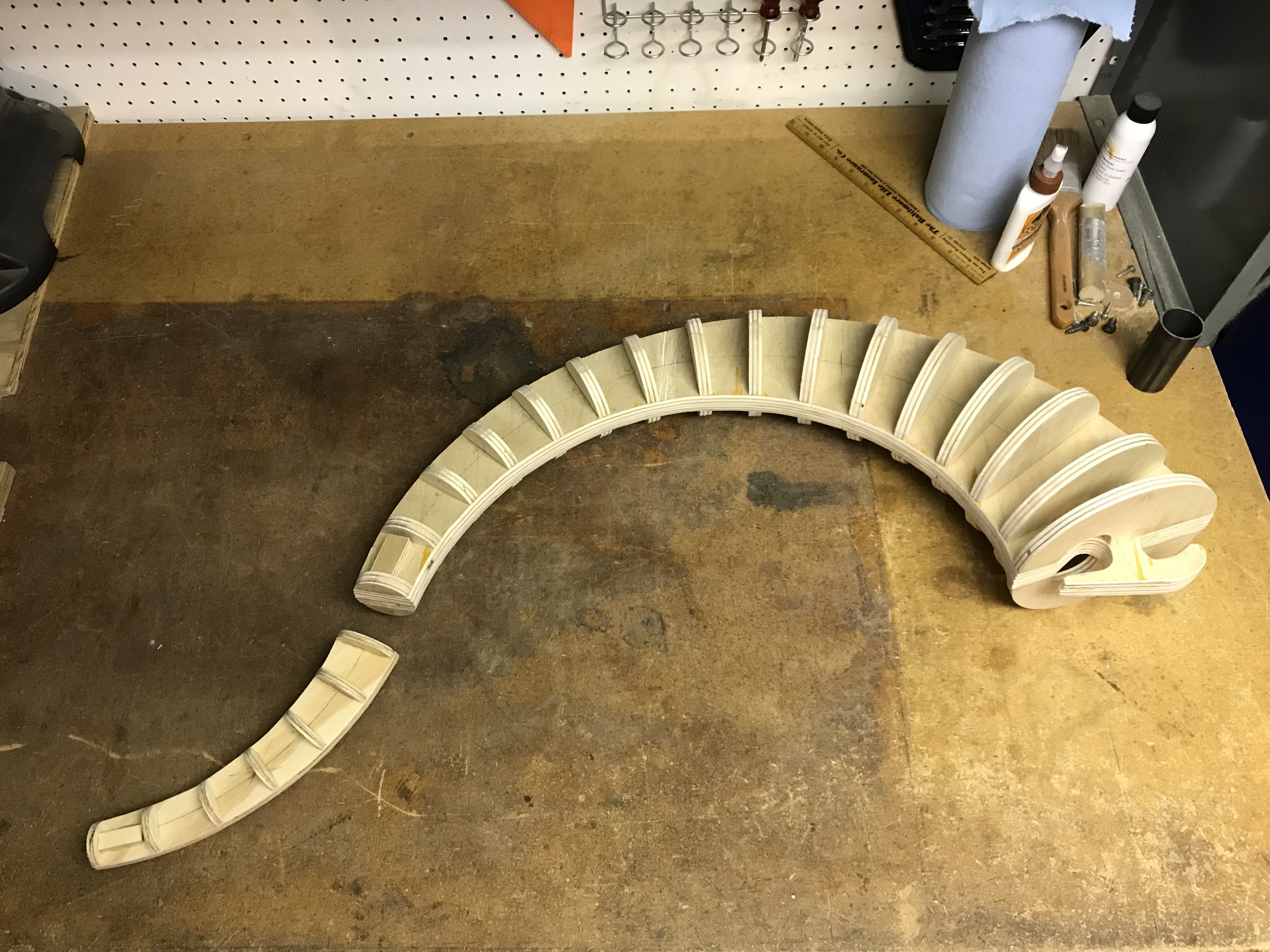

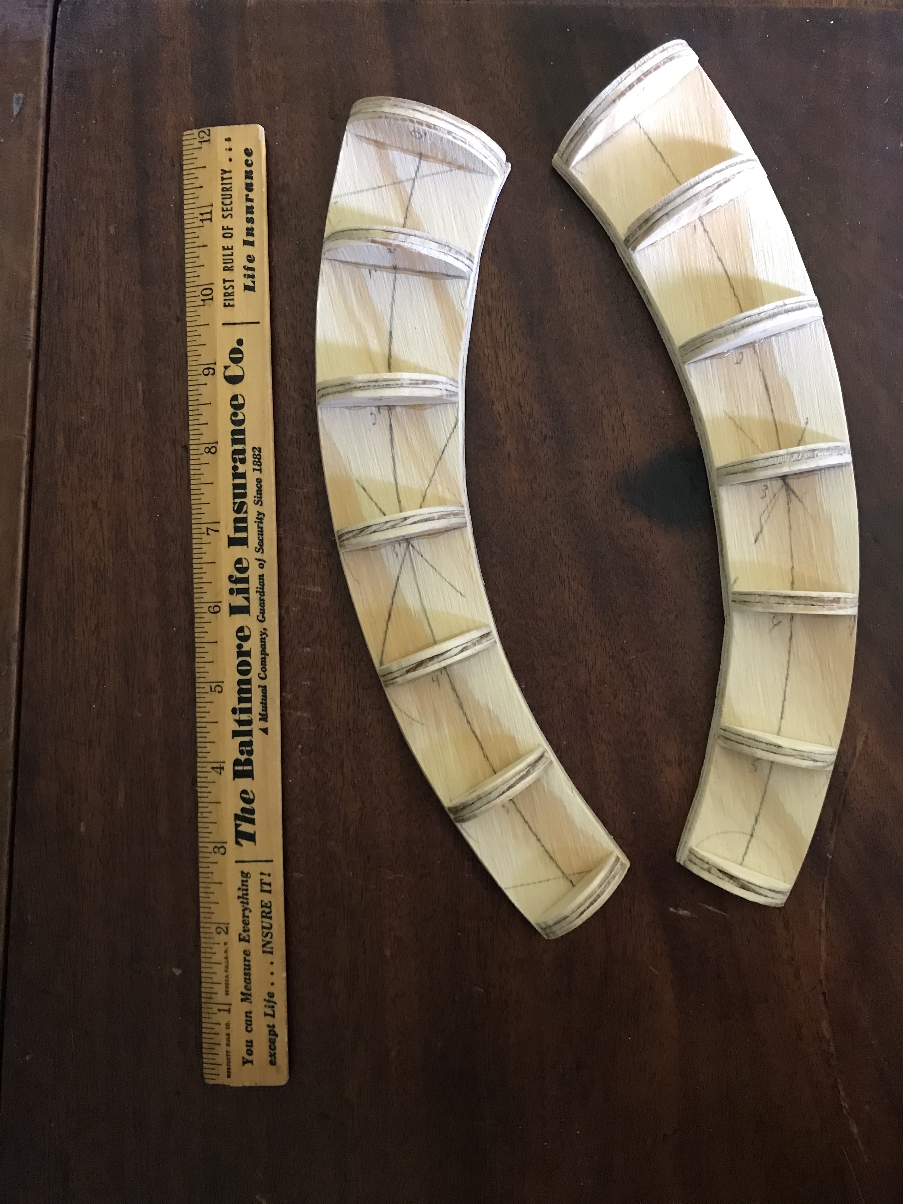

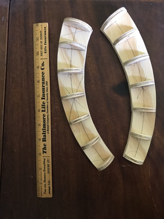

The wood skeleton cut out and sanded to a circular cross-section:
The ribs glued to the two halves of the skeleton of the first curve:
The halves of the skeleton glued together:

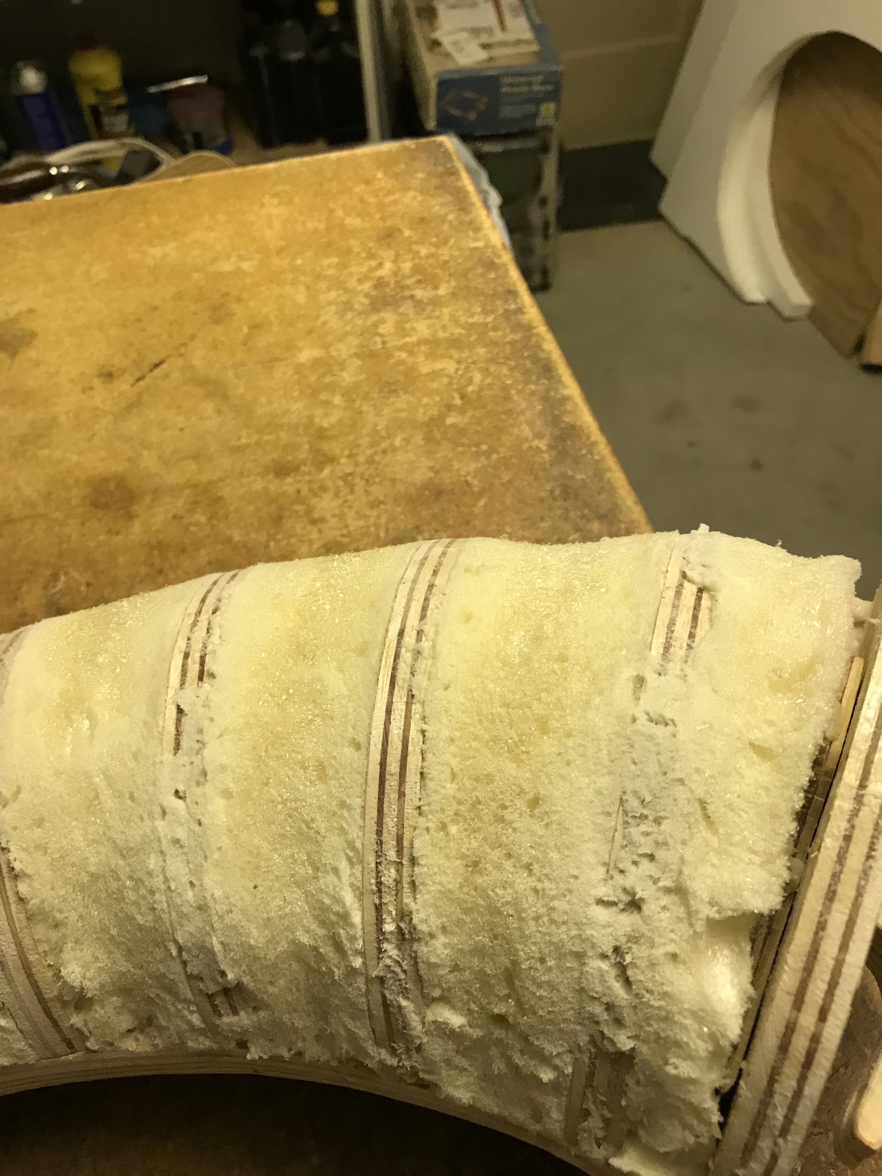

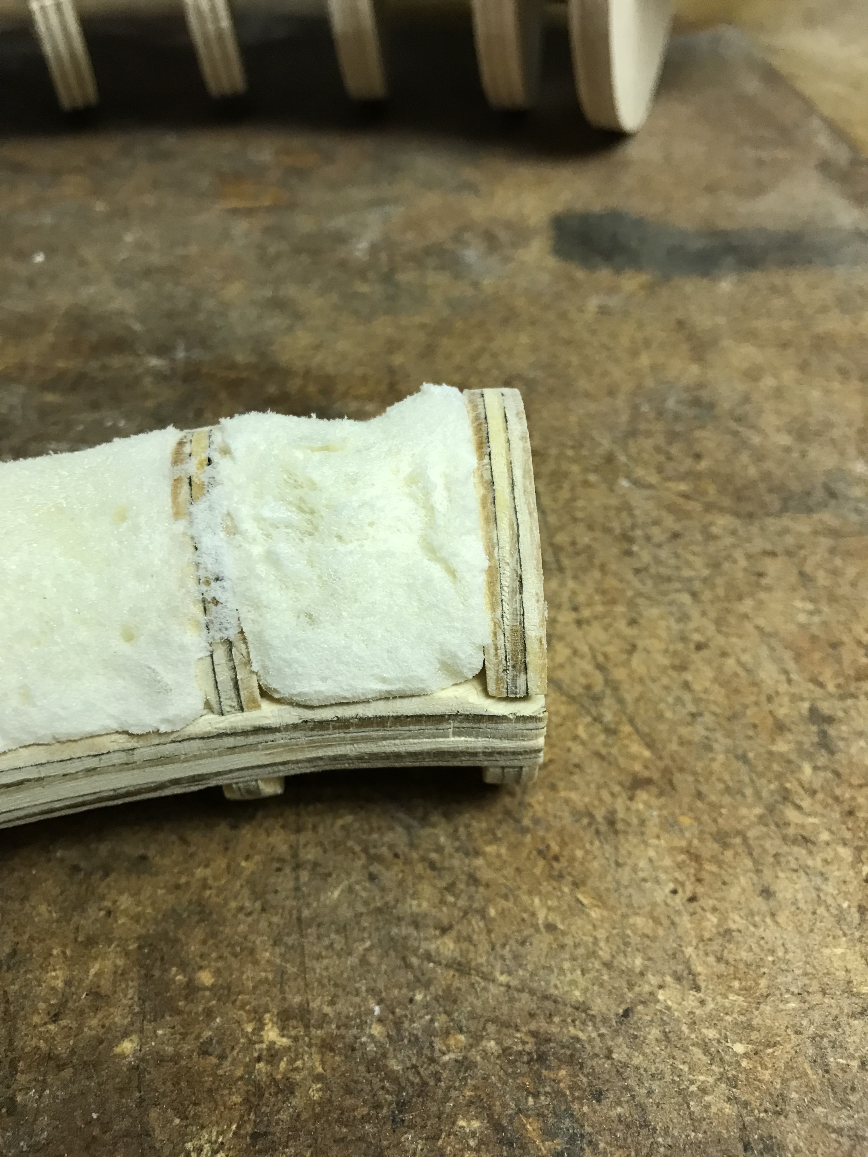

The first side of the former filled with expansion foam, after it started to collapse:
Former--D--Expansion foam on first side (after sanding, some collapsing).jpg
Detail of collapsed foam on the short curve:

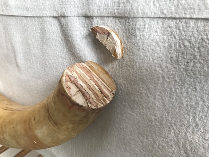

Detail of collapsed foam on the large curve. The expansion foam pushed the end half-disc out, so I had to cut out some foam and reglue the wood, hence the gap:

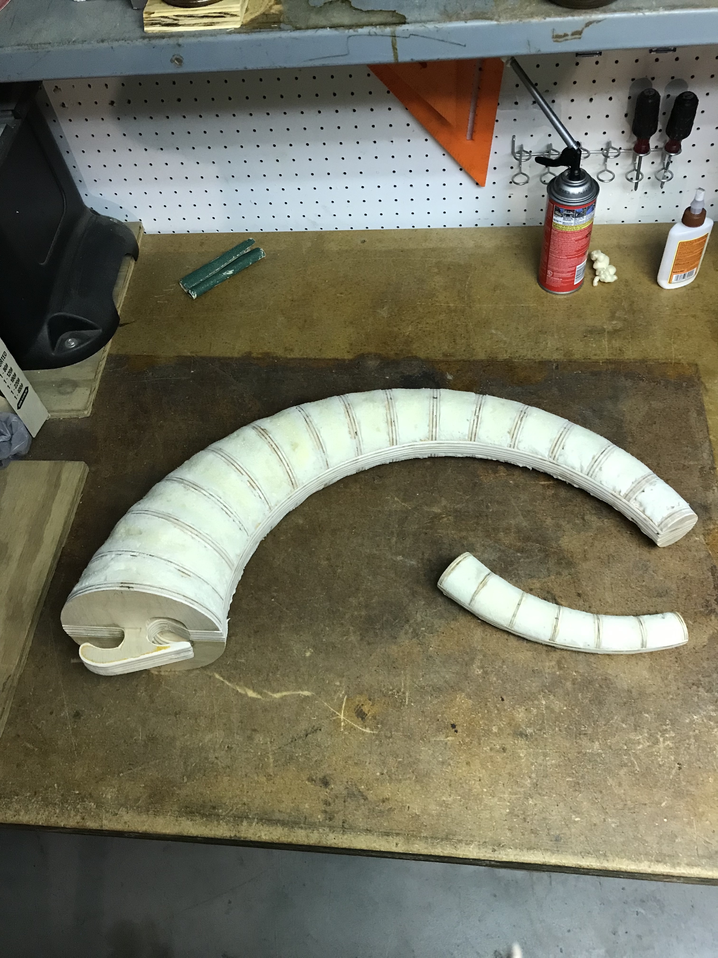

The second side of the former filled with expansion foam:
Former--E--Expansion foam on second half, after sanding, some collapsing.jpg
The first side after a few more days—more collapsing of the foam:

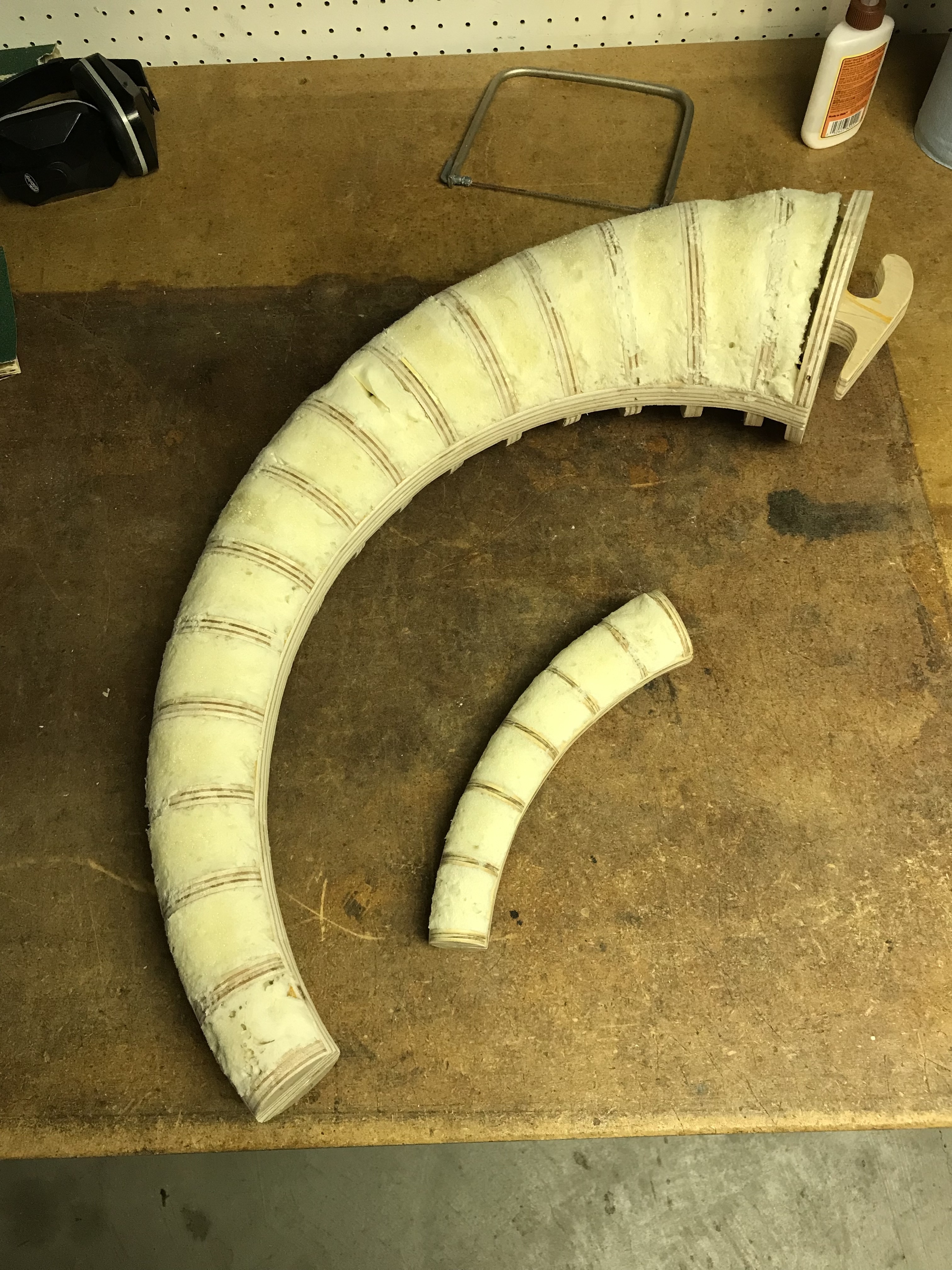

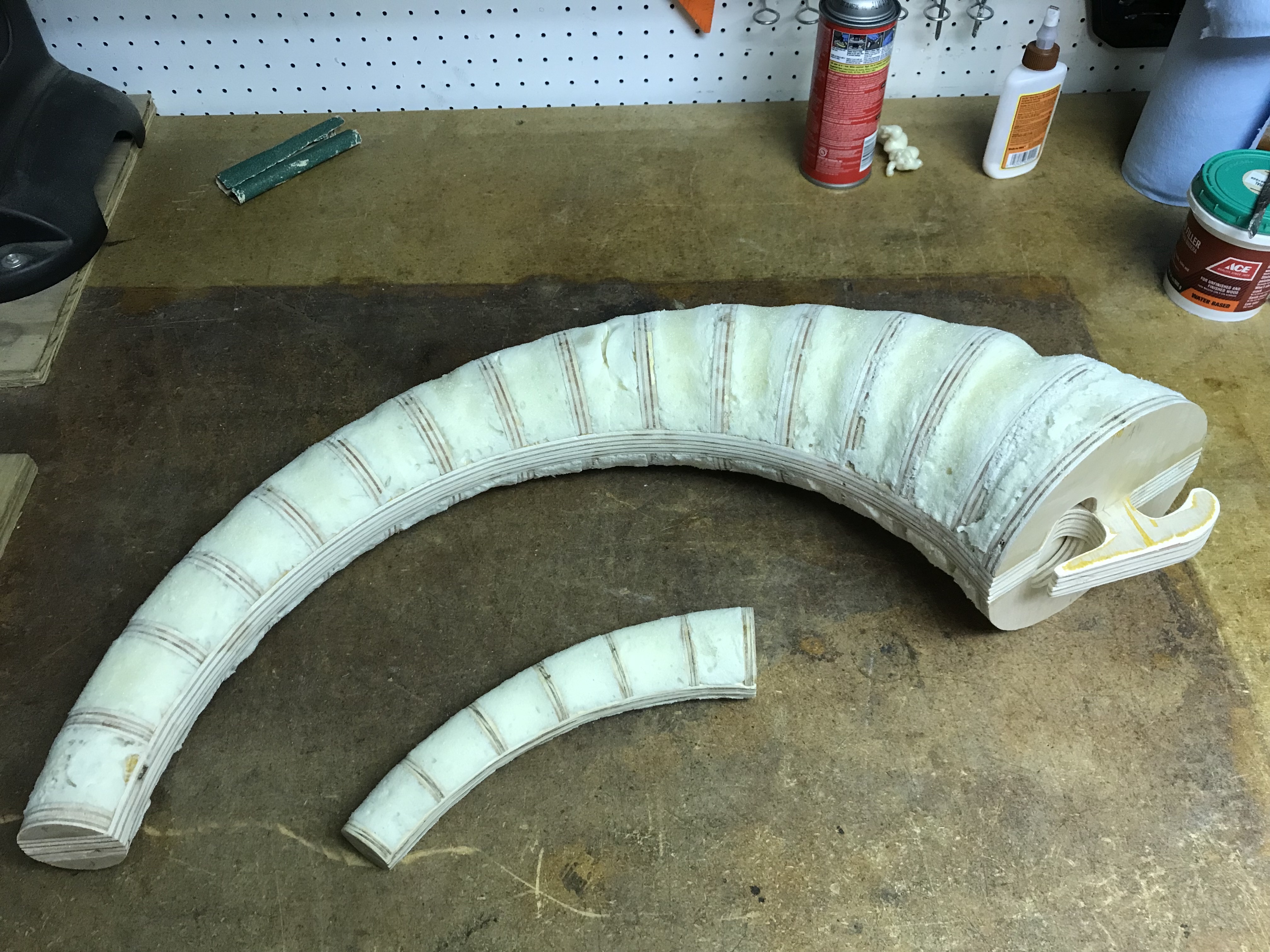

As the expansion foam wasn’t working quite as anticipated, I sanded it down and filled in with paper mâché. The first application of paper mâché (paste) on the first half of the former wasn’t quite thick enough, so I had to do another after it dried; this is the first layer:
The first side after the second layer of paper mâché dried, before sanding (apparently, I didn’t get a picture right after sanding):

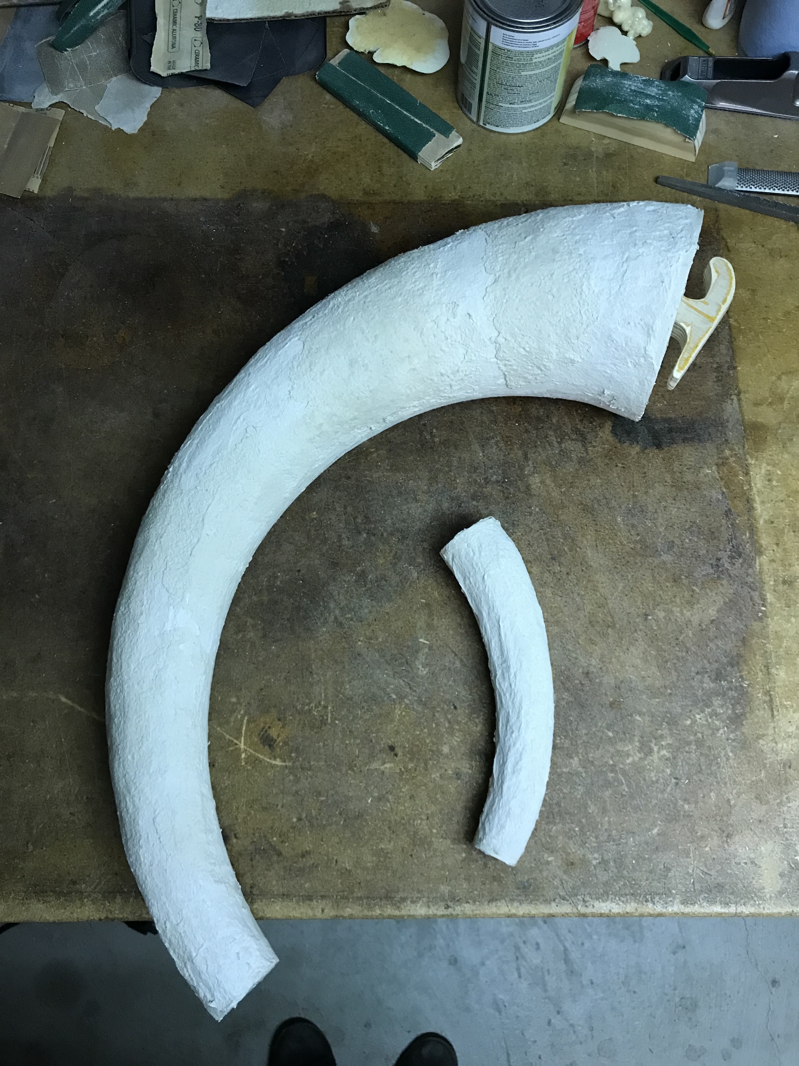

The finished former for the first curve. I sanded the paper mâché with 220 grit sandpaper after using an assortment of files and rasps to remove the excess material, then gave it two coats of shellac, sanded with 220 grit paper, and repeated the shellac-and-sanding process with 400, 600, and 800 grit paper.

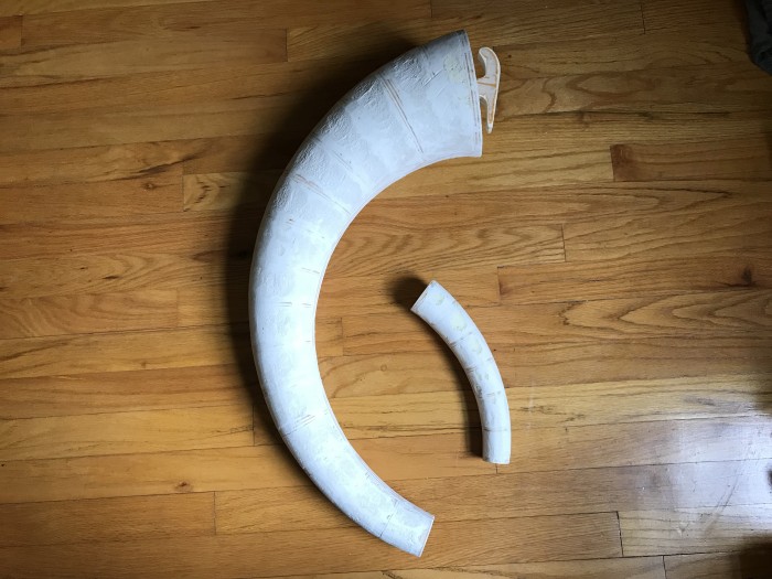

The finished former for the second curve. The surface isn’t perfectly even, but it should be good enough--the orange areas are where I sanded the paper mâché too far and filled in with wood filler. Unfortunately, the paper mâché pulled in one of the wood half-discs on the end that the expansion foam had pushed out, but it is only about an ⅛” off at the most, so I left it alone, as I should be able to fill in the missing length on the horn with paper mâché paste:

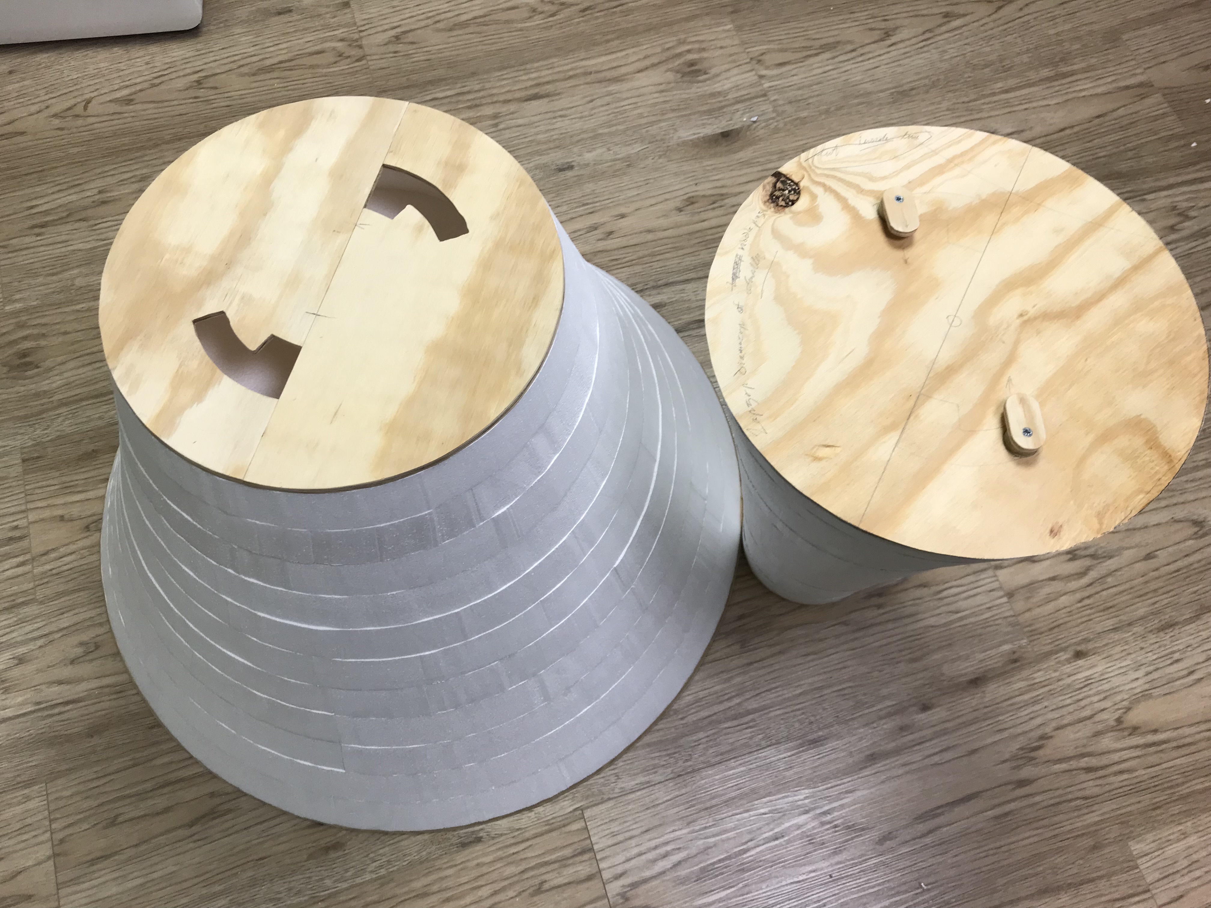

The Bell Former--

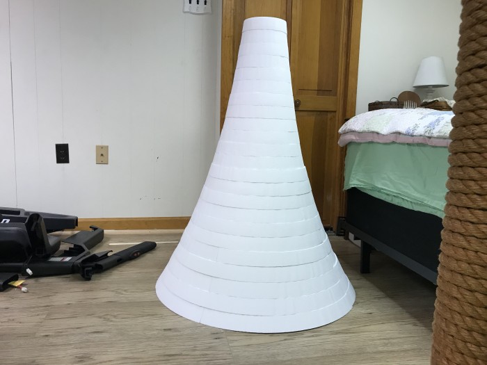

The Styrofoam rings for the bell former, before gluing and sanding:

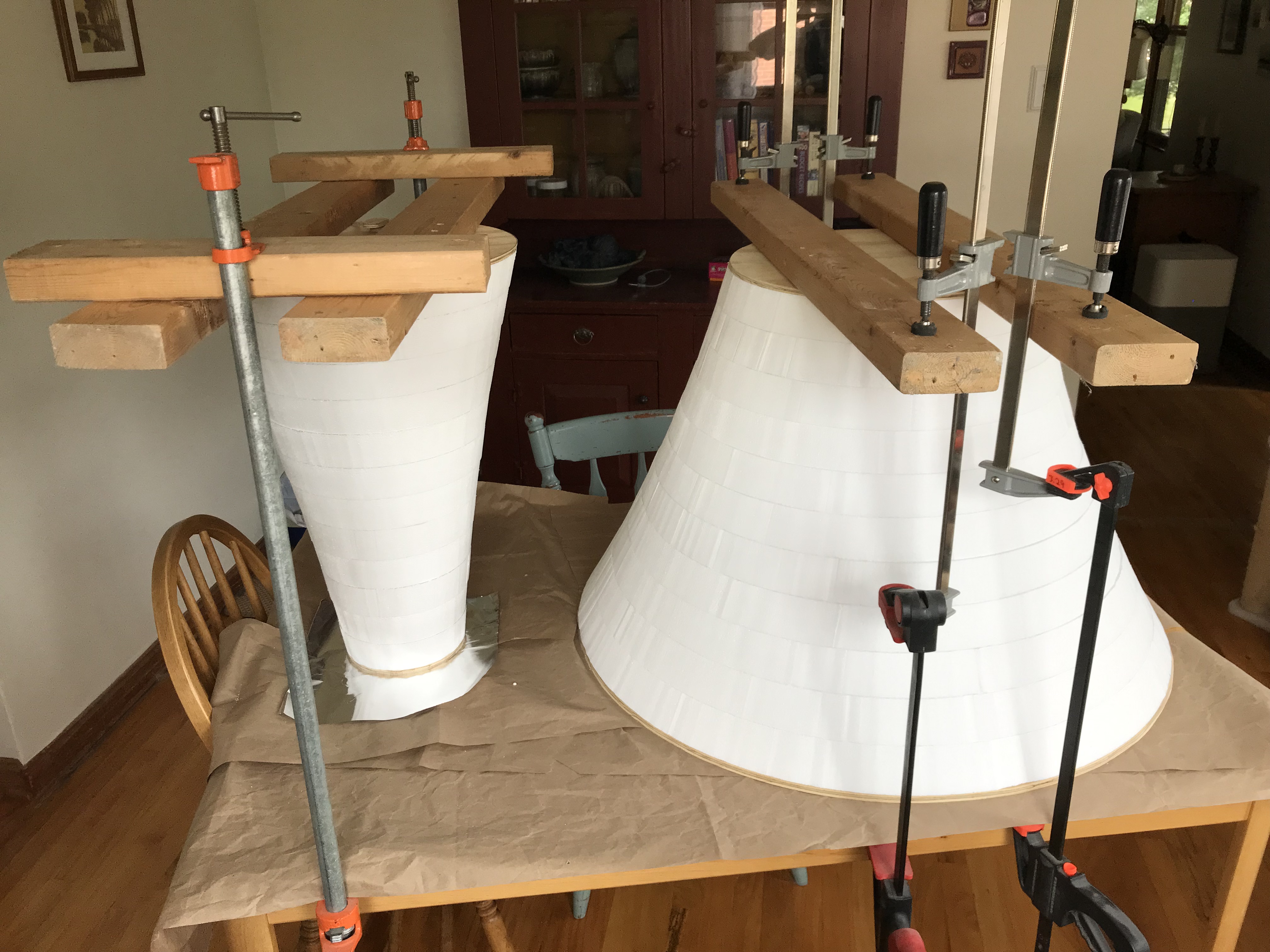

The formers for the two halves of the bell (prior to sanding) with the wood end discs glued and clamped in place:
The latch to keep the two halves of the bell together while sanding (to ensure a smooth flare):
The formers for the two halves of the bell after sanding:
The formers for the two halves of the bell after three coats of shellac (latched together):

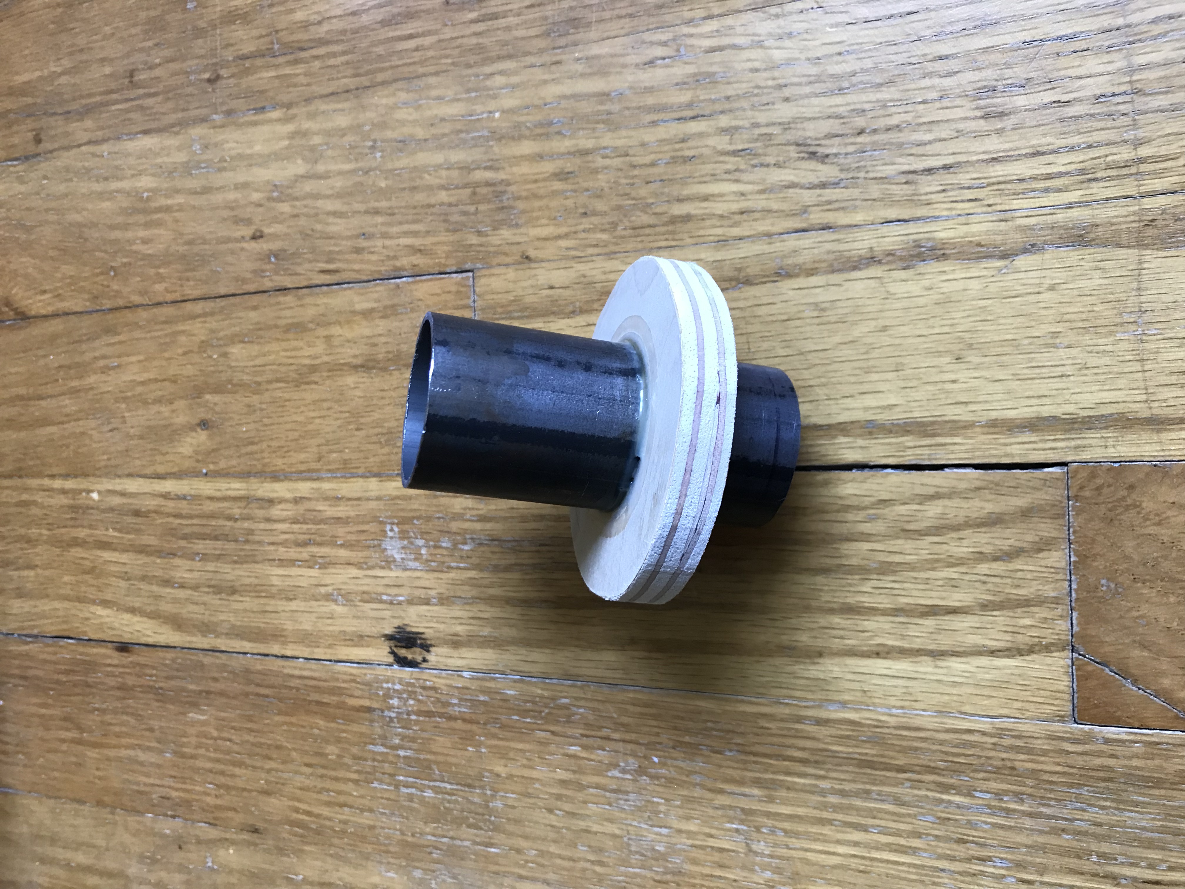

The horn spigot—1.5” outer diameter DOM steel tubing (1 ⅜” inner diameter):

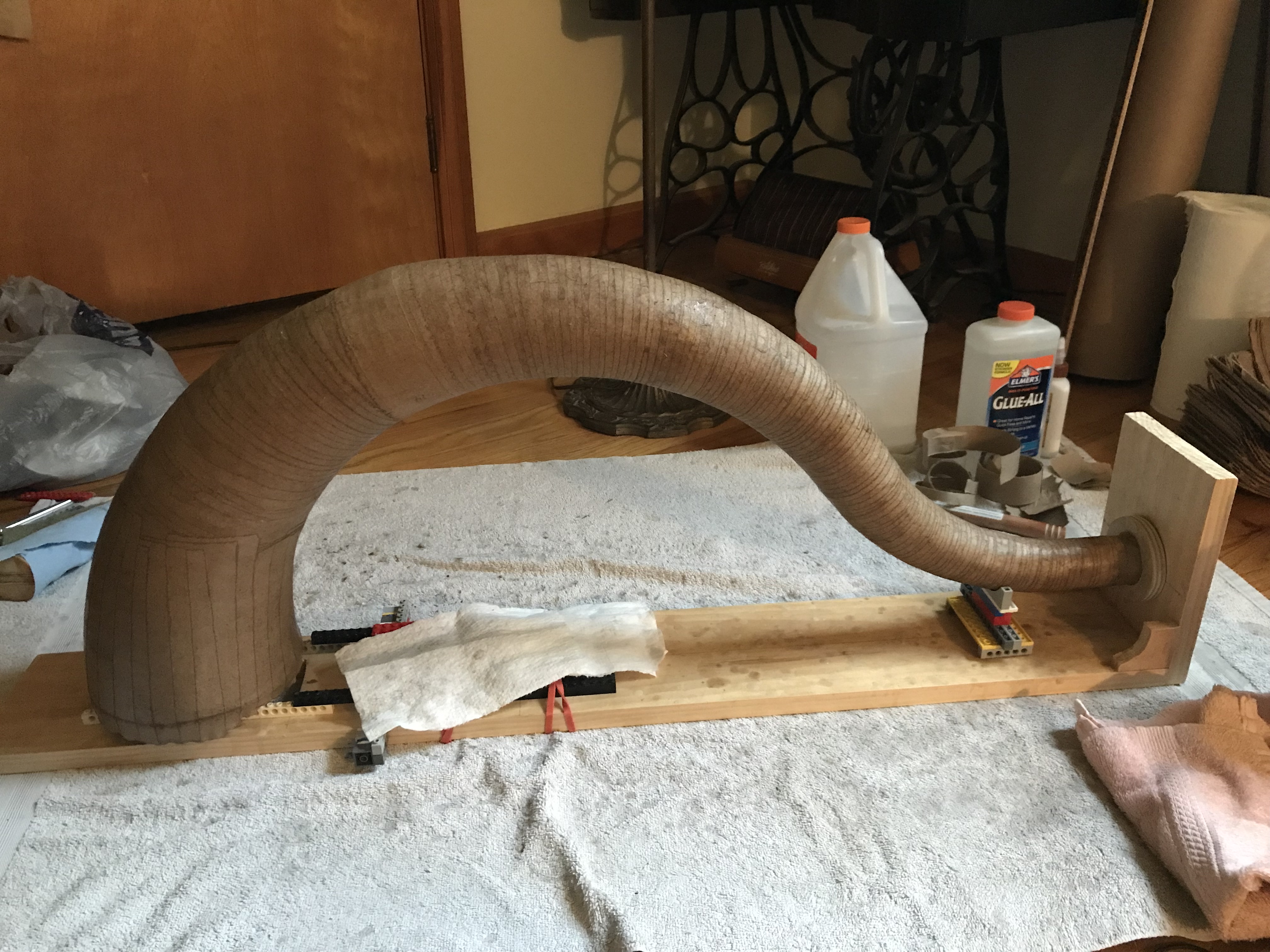

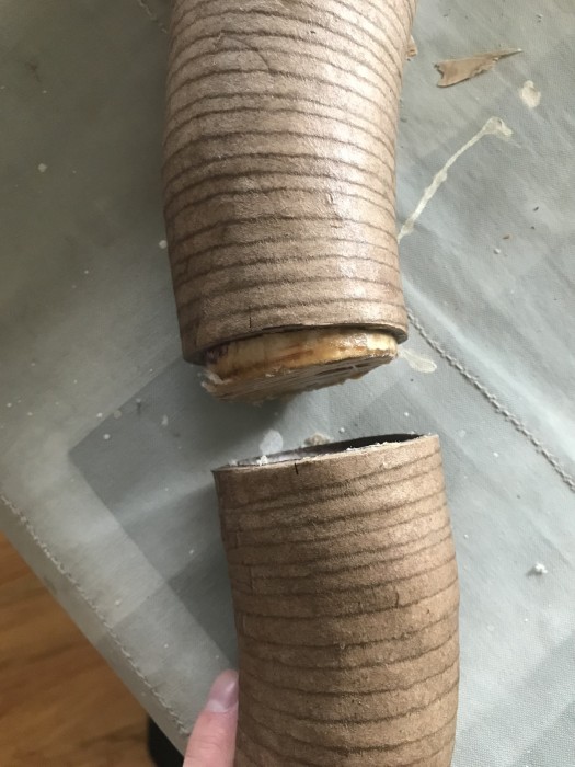

I bought a large roll of thick paper to make the horn, and finished two layers (overlapping paper strips about 50%) on the first section of former, but the layers didn’t laminate, I think because the paper was too thick and stiff for me to press it in place properly; so I had to tear it all off and start again with the same thinner paper I used for the last horn—so far, I have three layers done (overlapping about 75%), and the paper is laminating properly now.
The first section of the horn with two layers of the thick paper:

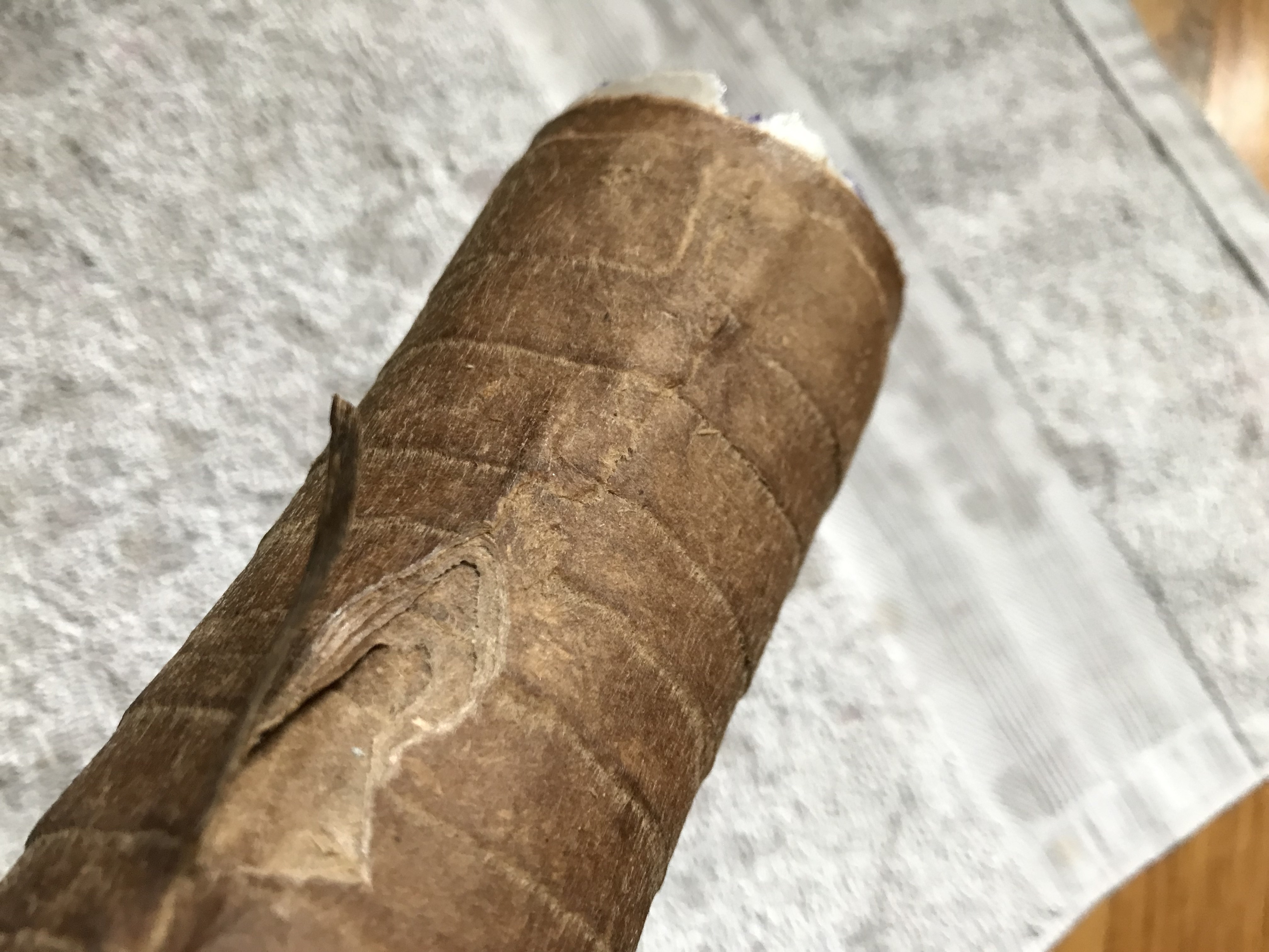

Detail of delamination, after cutting some paper away—I could feel that the overlapped paper was delaminated for most of the section’s length, which was confirmed by cutting some of the outer layers away:
The first section of the horn after tearing off the thick paper and applying a layer of thinner paper:
The same section after two subsequent applications of thinner paper (three applications total)—it took about three hours to do the third application, although I think I was overlapping somewhat more than 75%:
Unfortunately, the paper shrank a bit as it dried, so I need to add another partial layer at the large end to overlap with the next section of former by about ½", in order to align the the first section of the horn with the second section of the former:

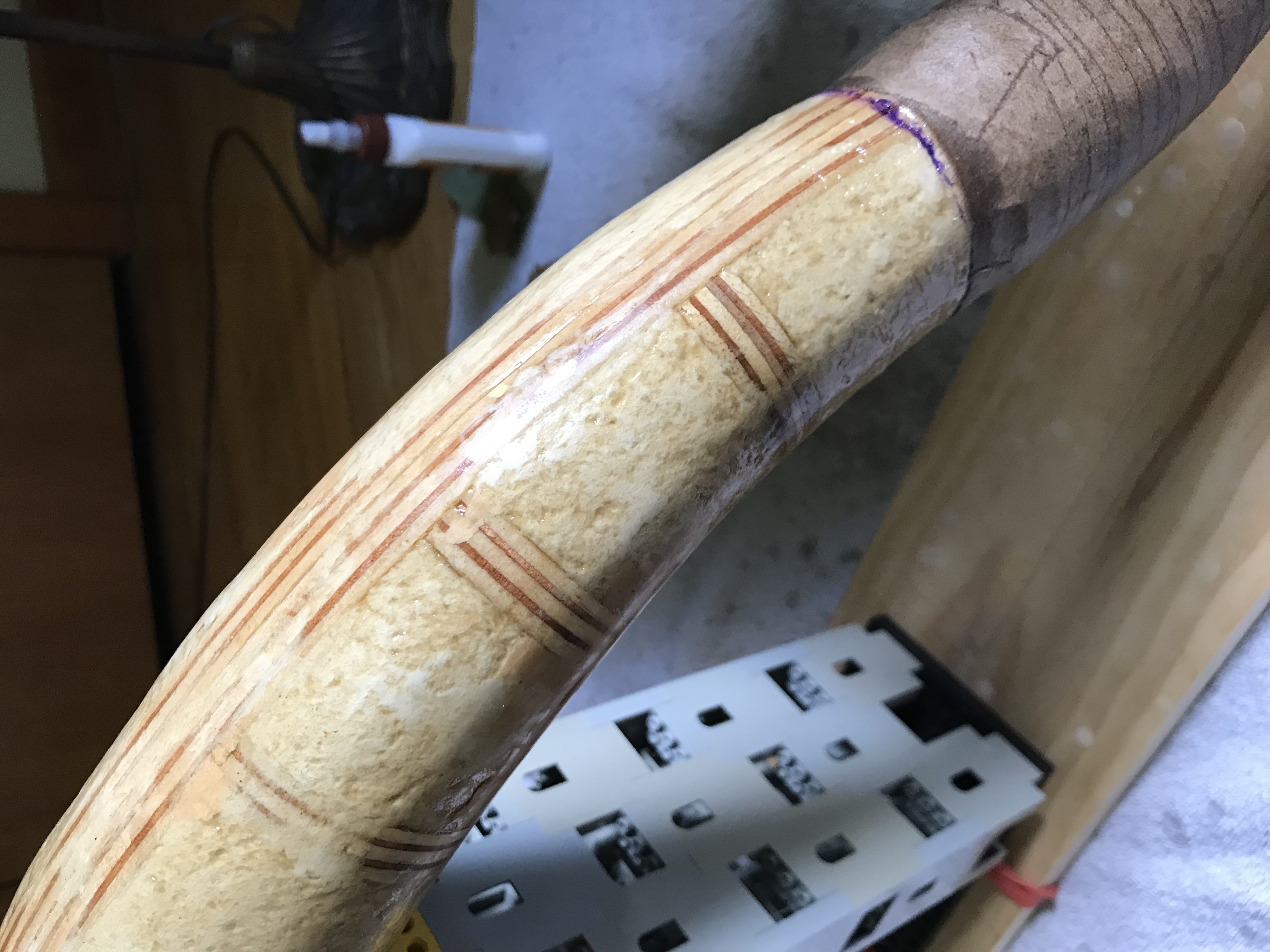

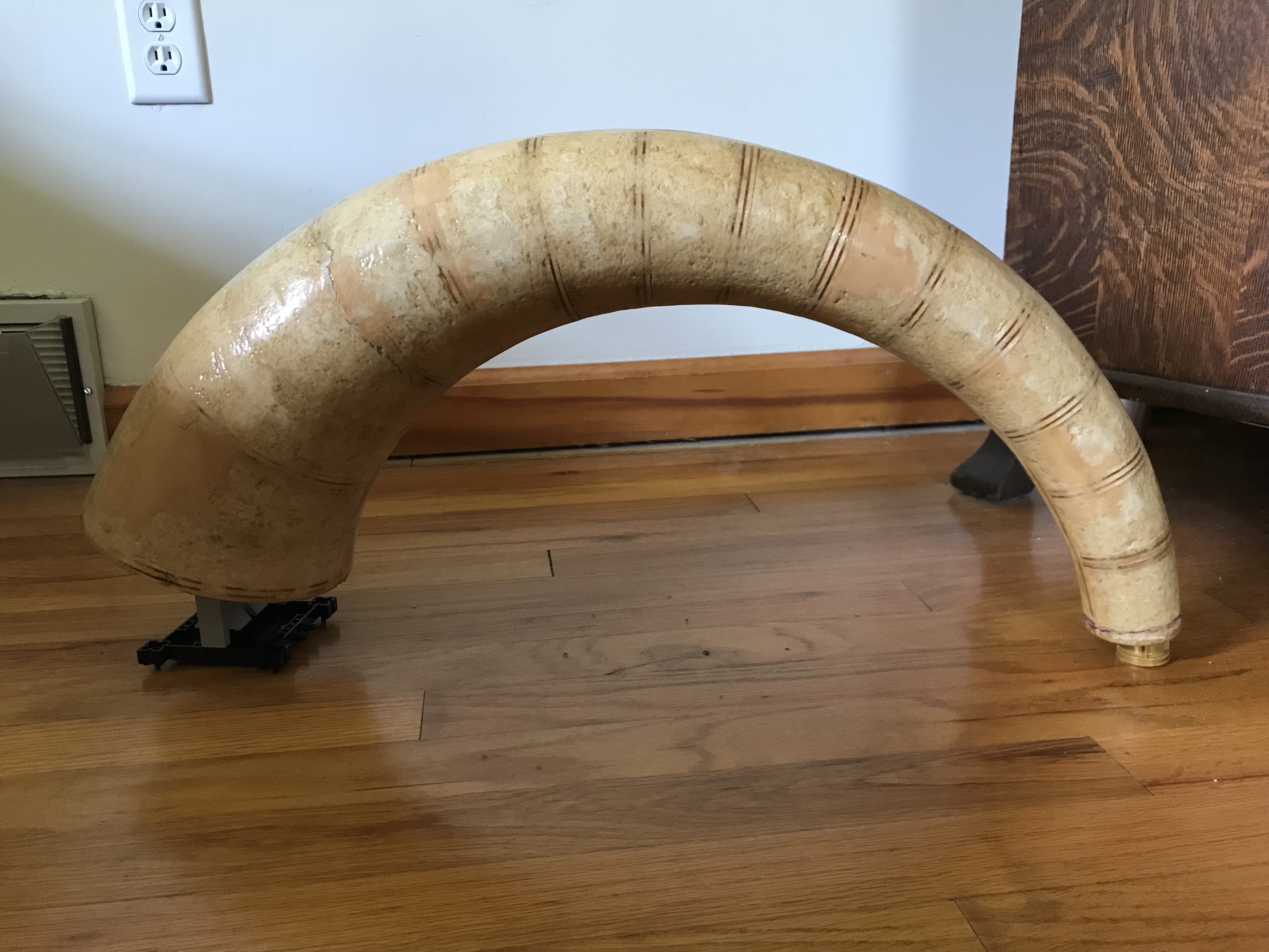

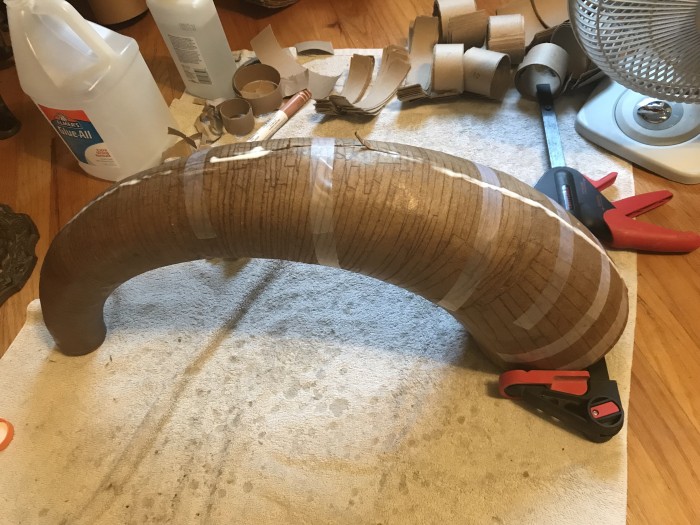

More to come over the next few weeks!--I'm hoping to be able to test the horn before I go back to college in about three weeks, although I doubt I will be able to get the full ¼" thickness for the neck by then.

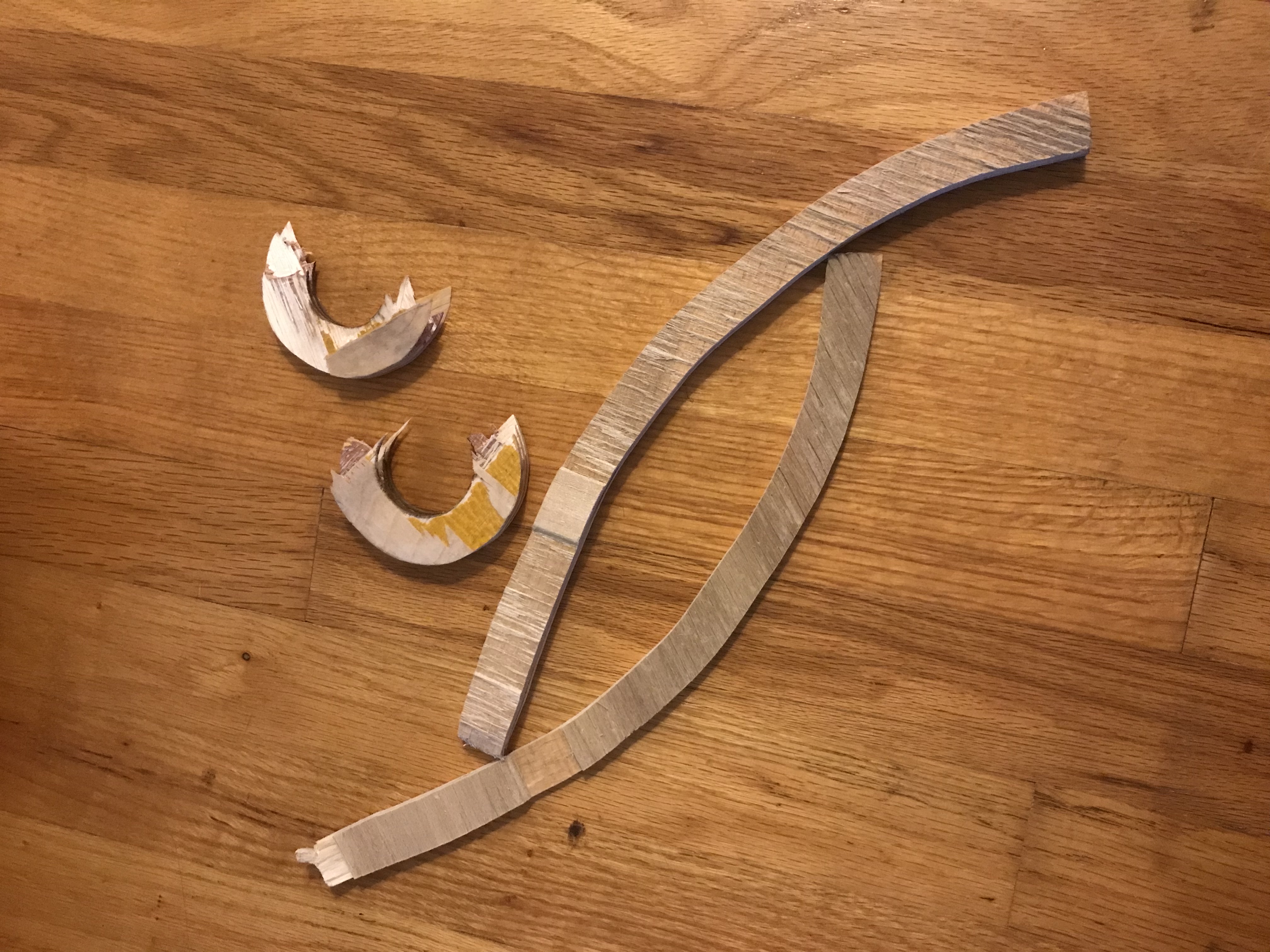

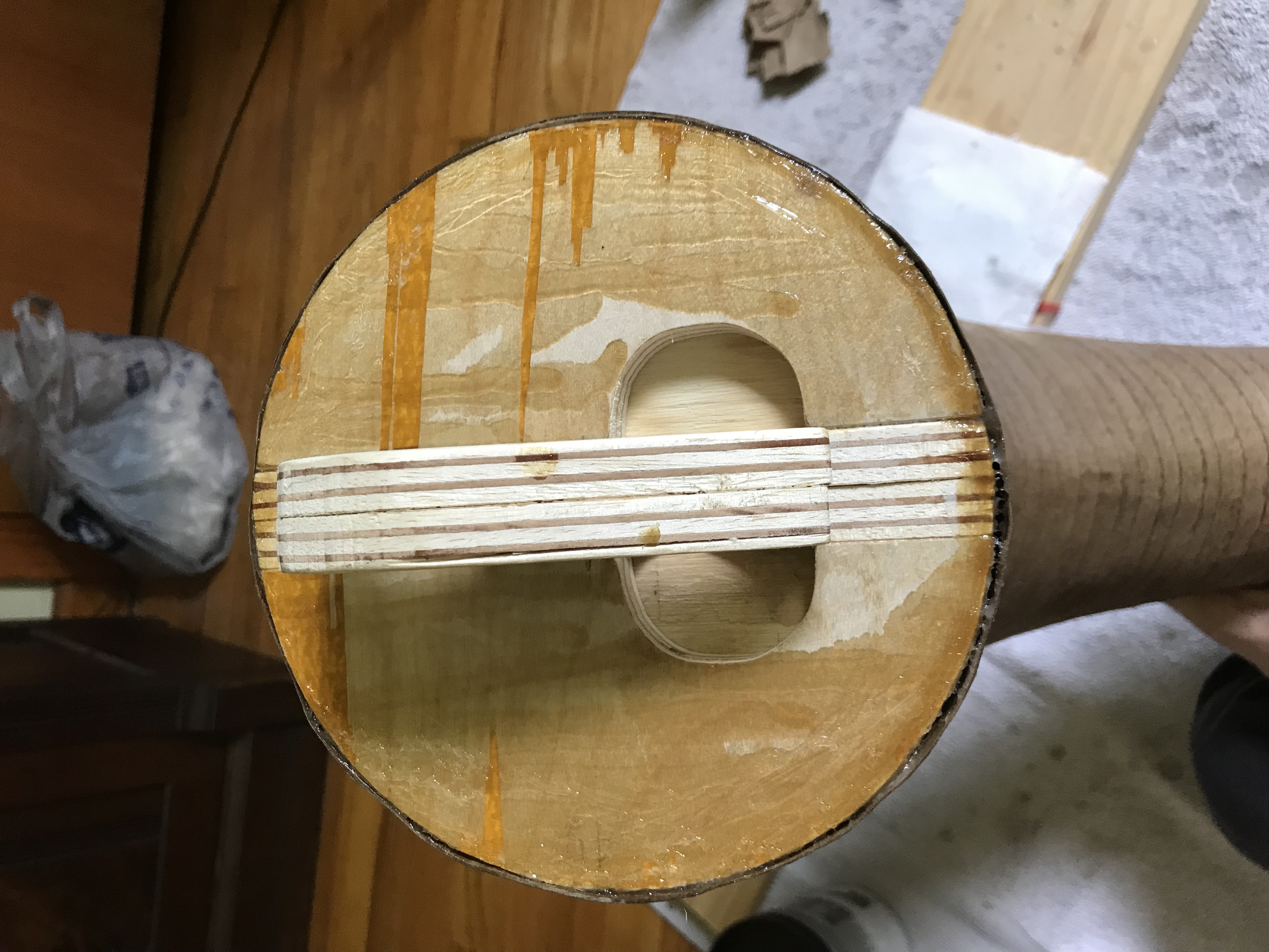

Thanks! The paper mâché went on top of the expansion foam, and the wood skeleton remained embedded in both to make a solid piece--my hope is that having the wood running from one end all the way to the other will help it release from the horn, as the force of the mallet striking the narrow end should be transmitted along the whole length. Here's a close-up of the former, showing how the wood skeleton is still in place, with paper mâché filling in the gaps:

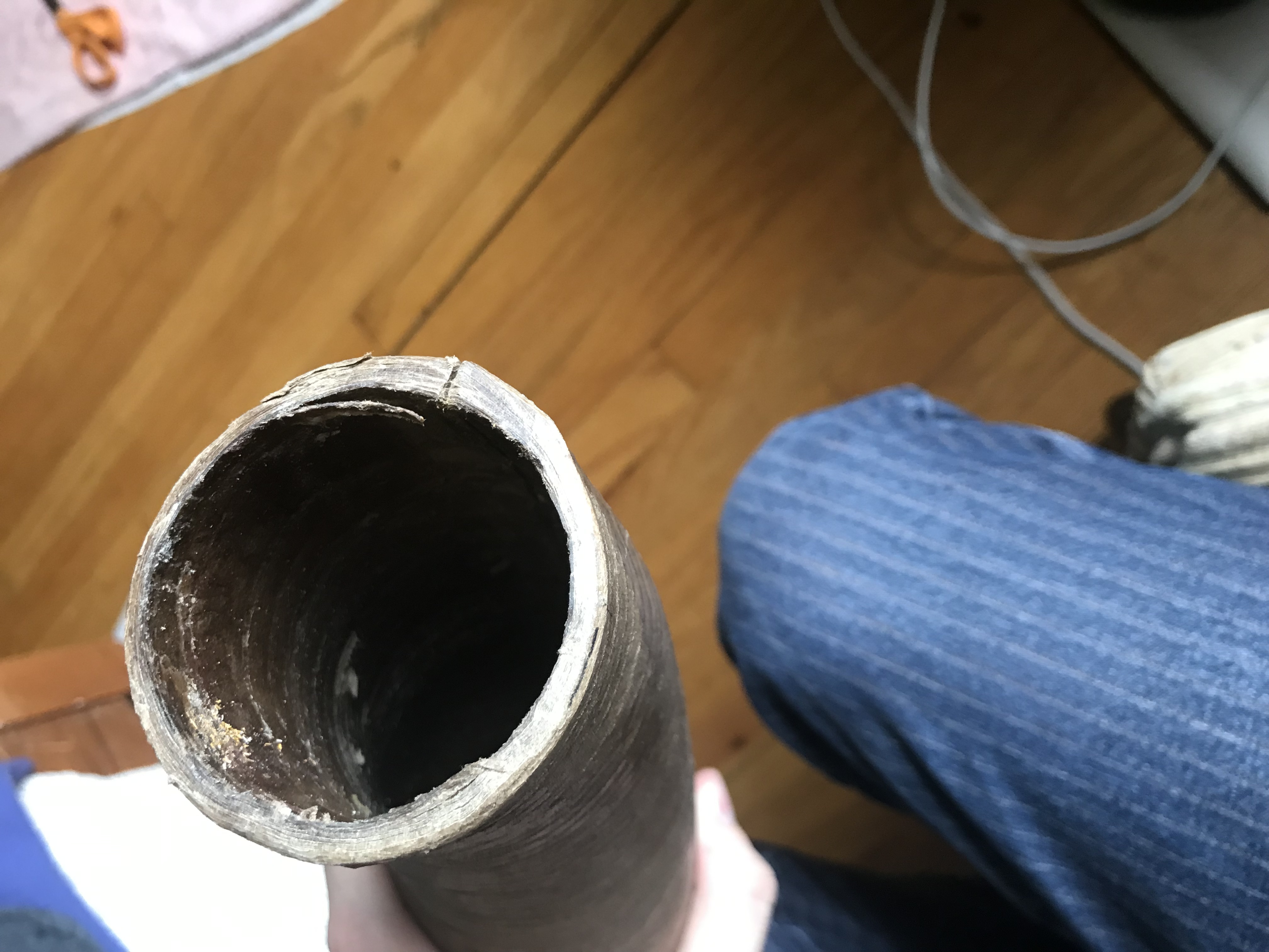

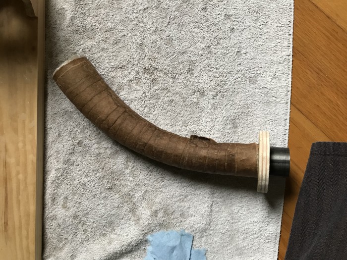

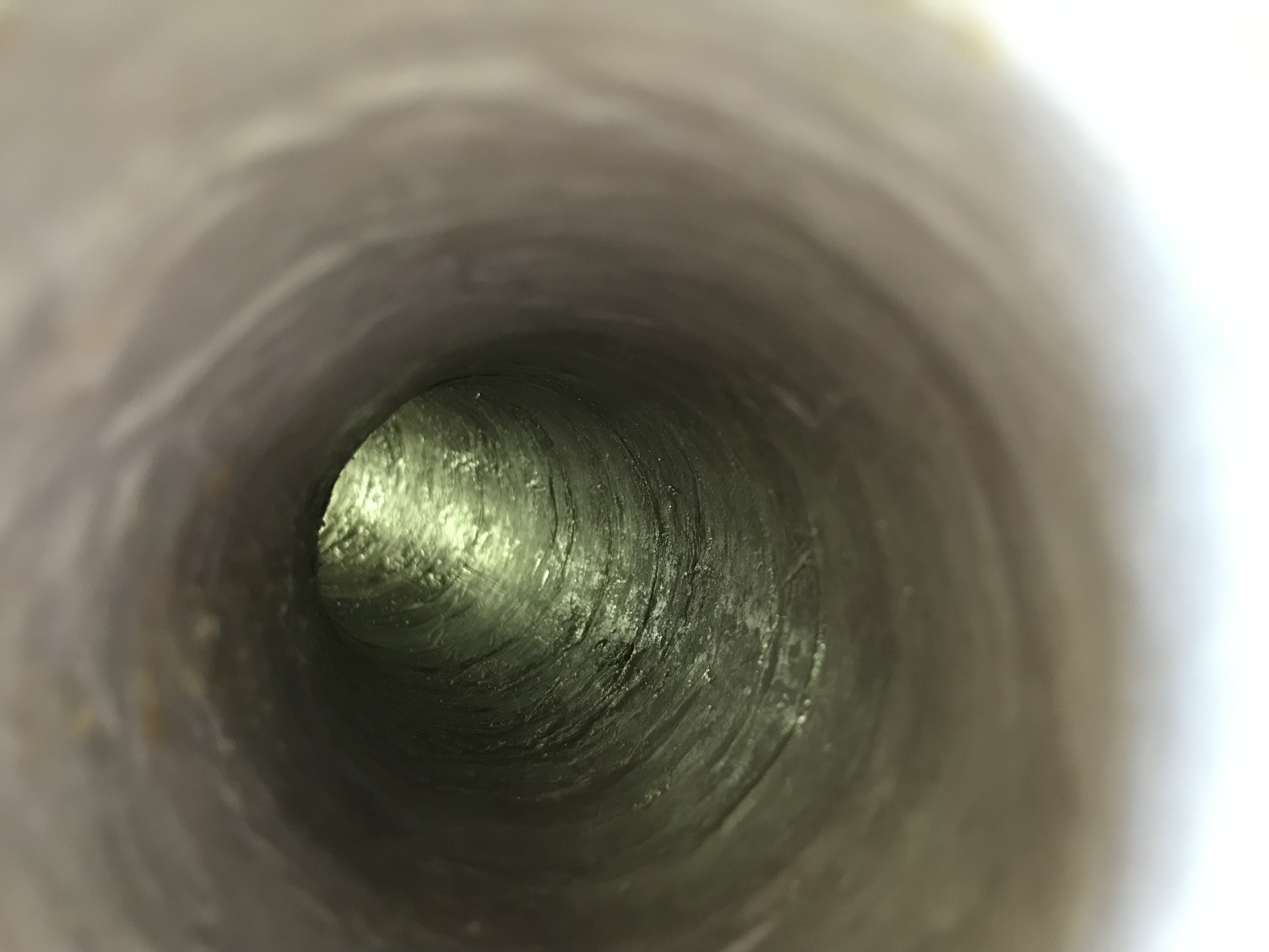

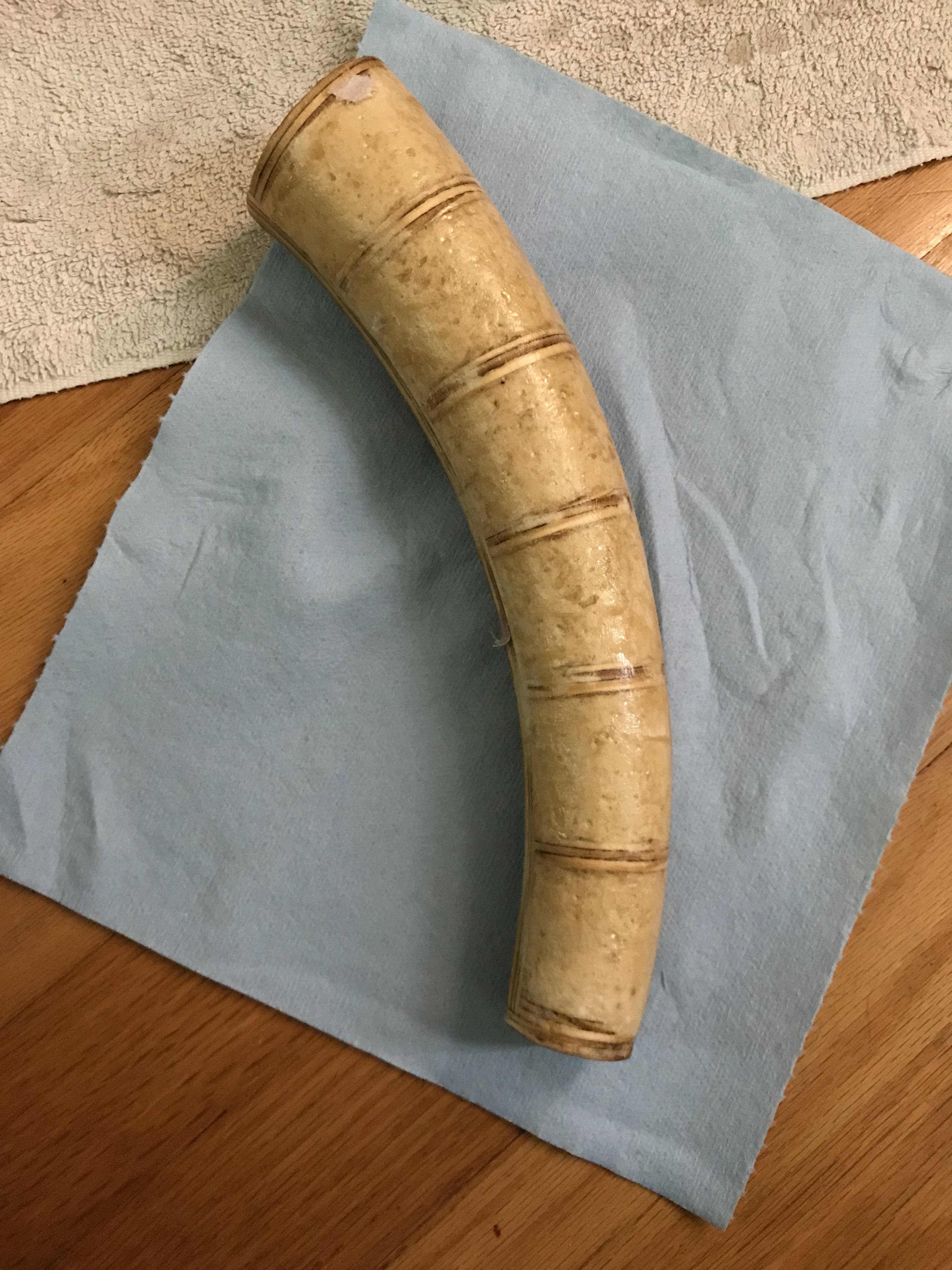

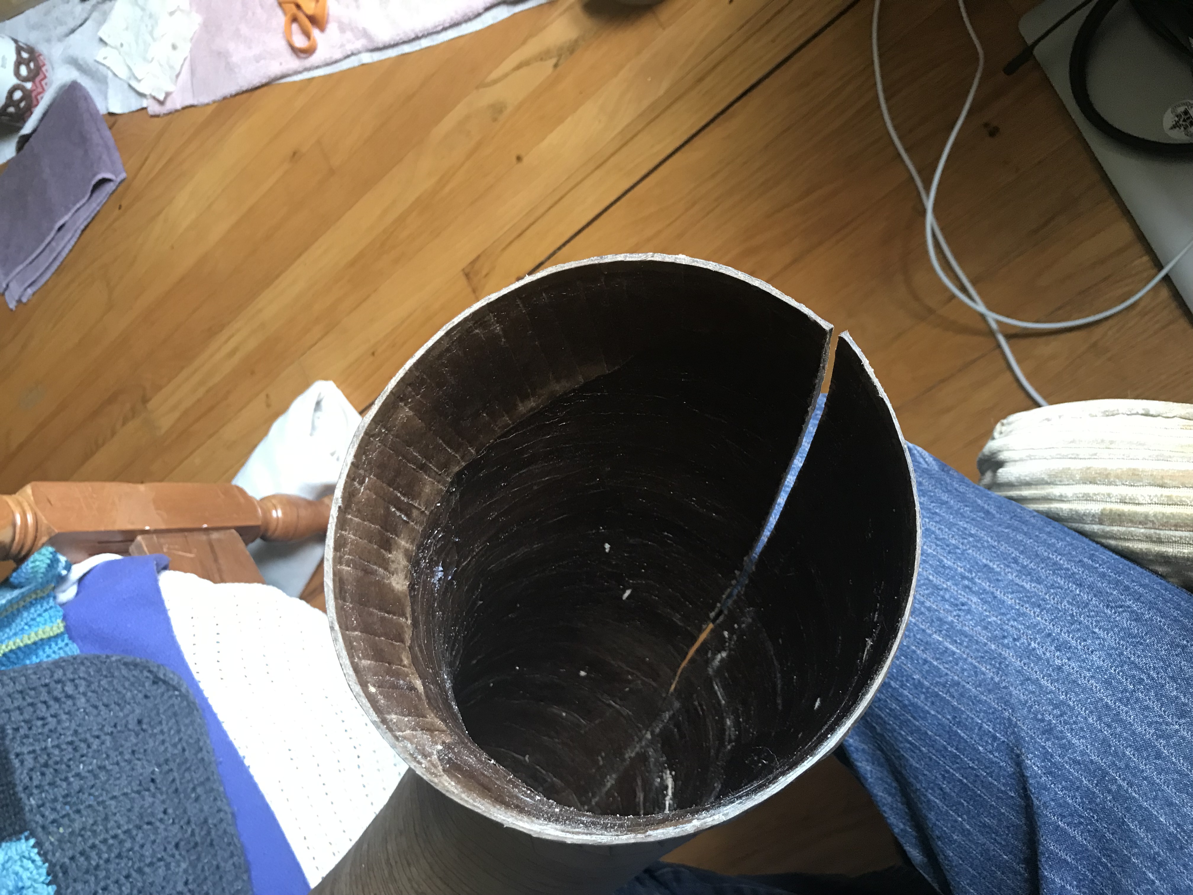

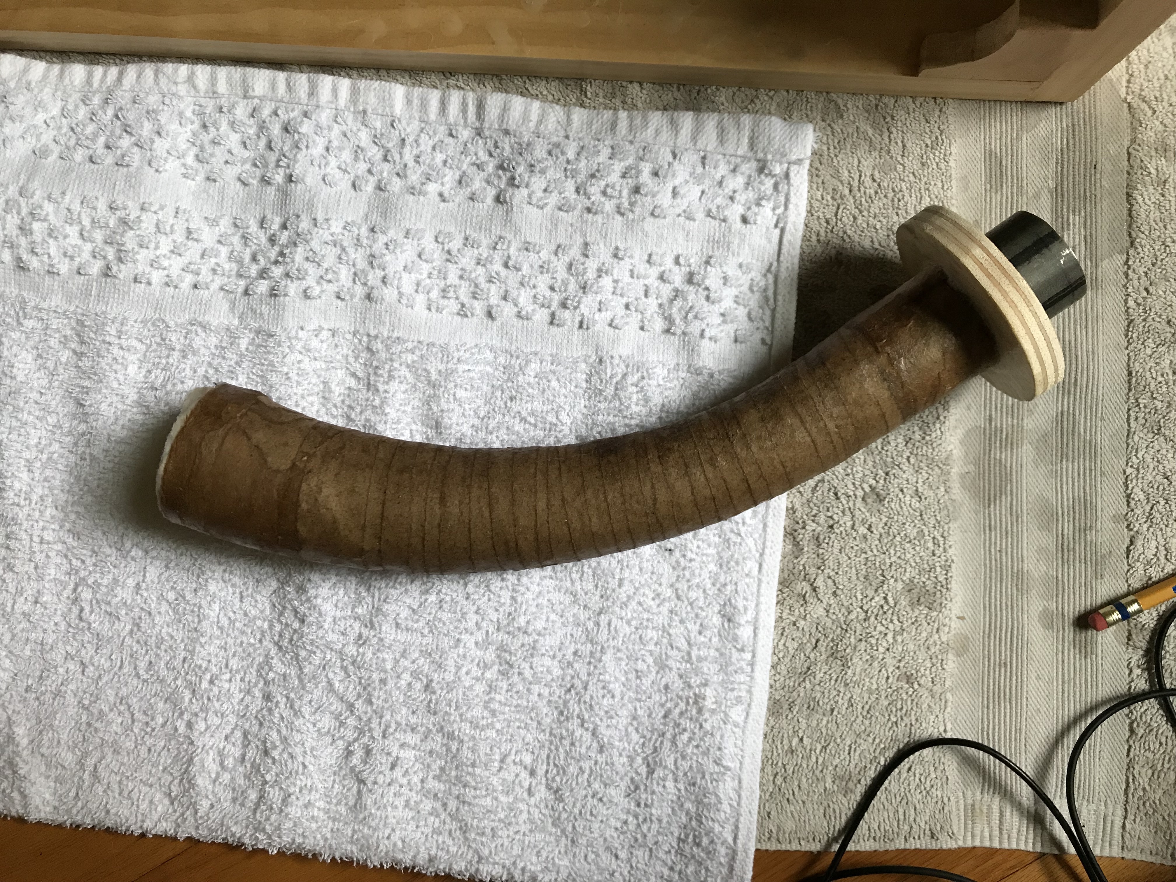

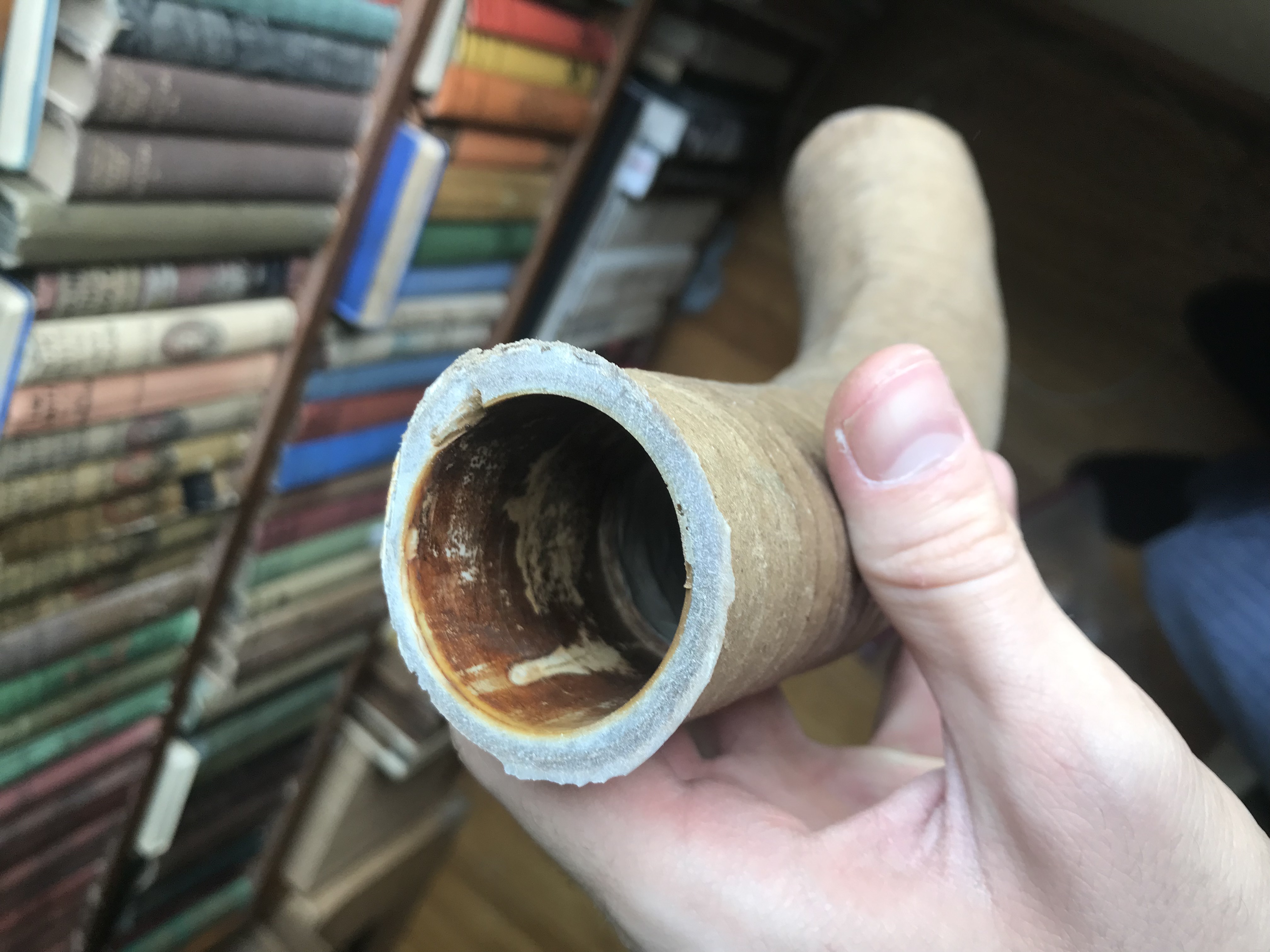

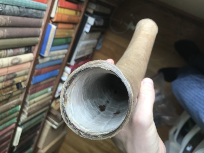

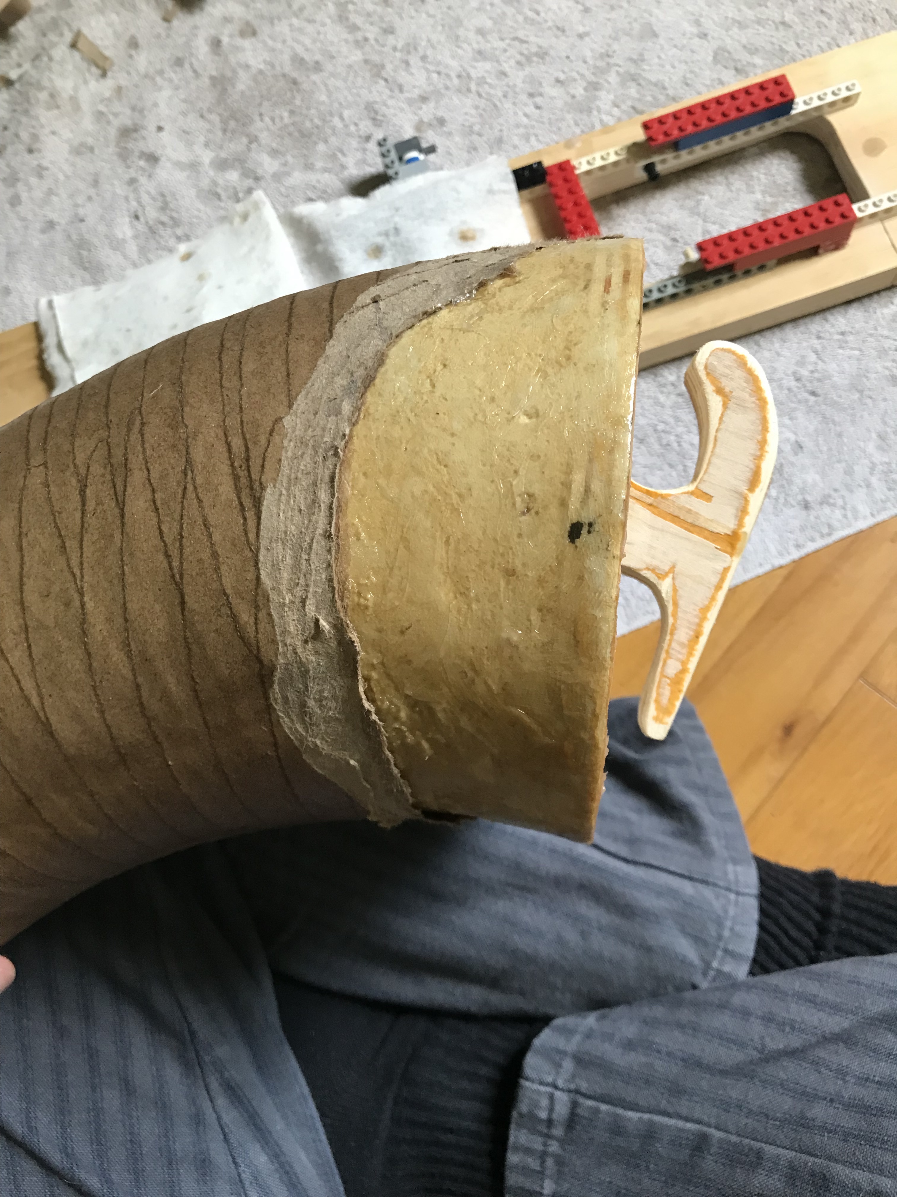

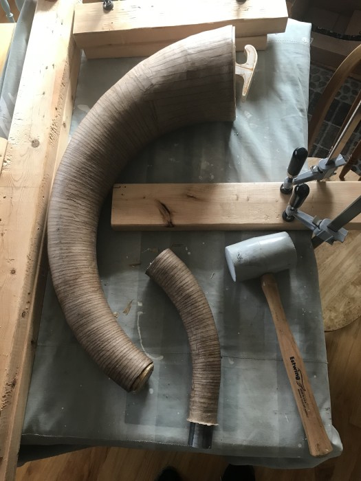

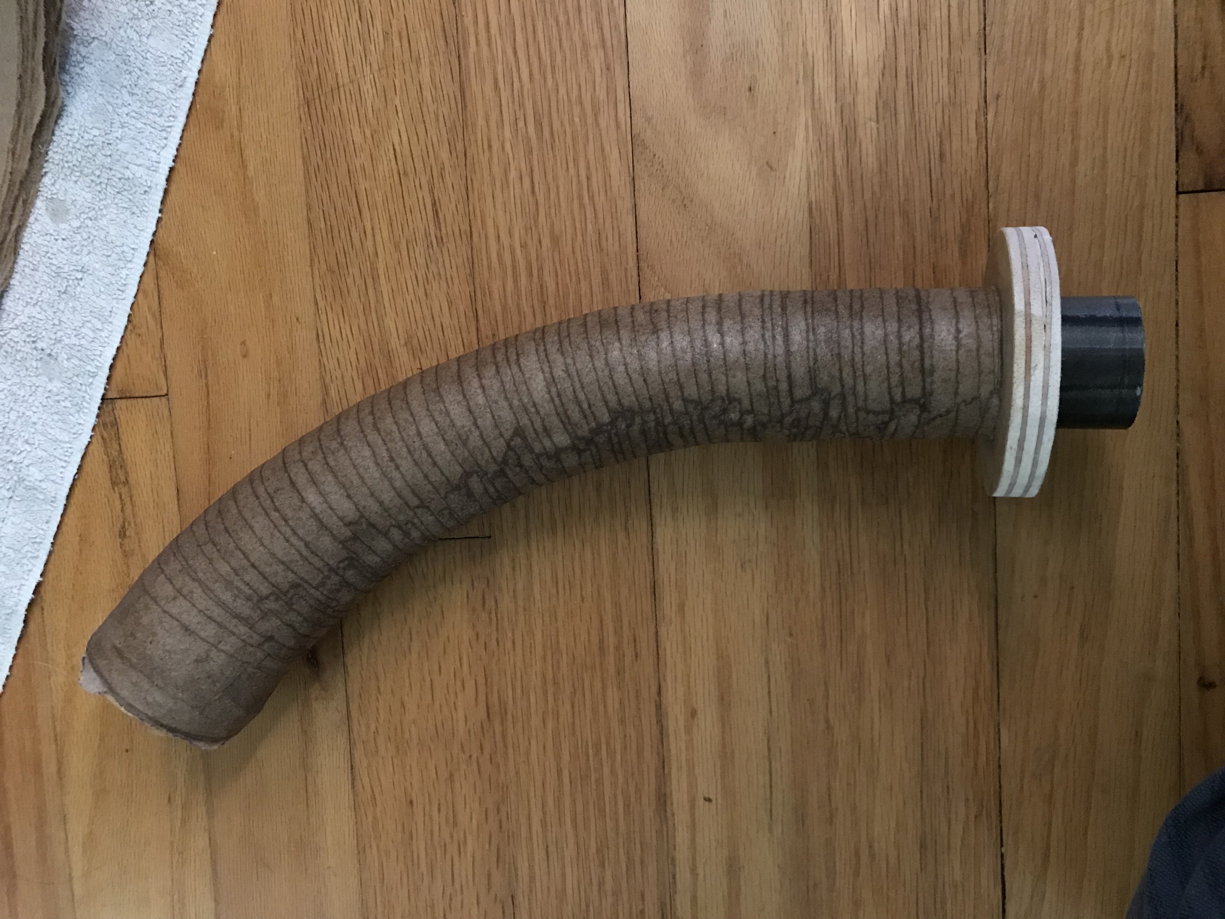

I successfully extracted the former for the first section—it was firmly stuck, but popped out after hammering heavily on the end several times with a mallet and dowel.
The inner surface is a little winkled and there were some loose pieces of paper inside (which I was able to scrape out), probably because the Vaseline that I used as a releasing agent soaked into the first layer of thin white paper, so that layer didn’t bond to the next properly—the white paper is a bit smoother than the brown, which seemed as though it would be beneficial for the treble response if used as an inner lining layer, but if it causes wrinkling, it would probably be better to skip it.

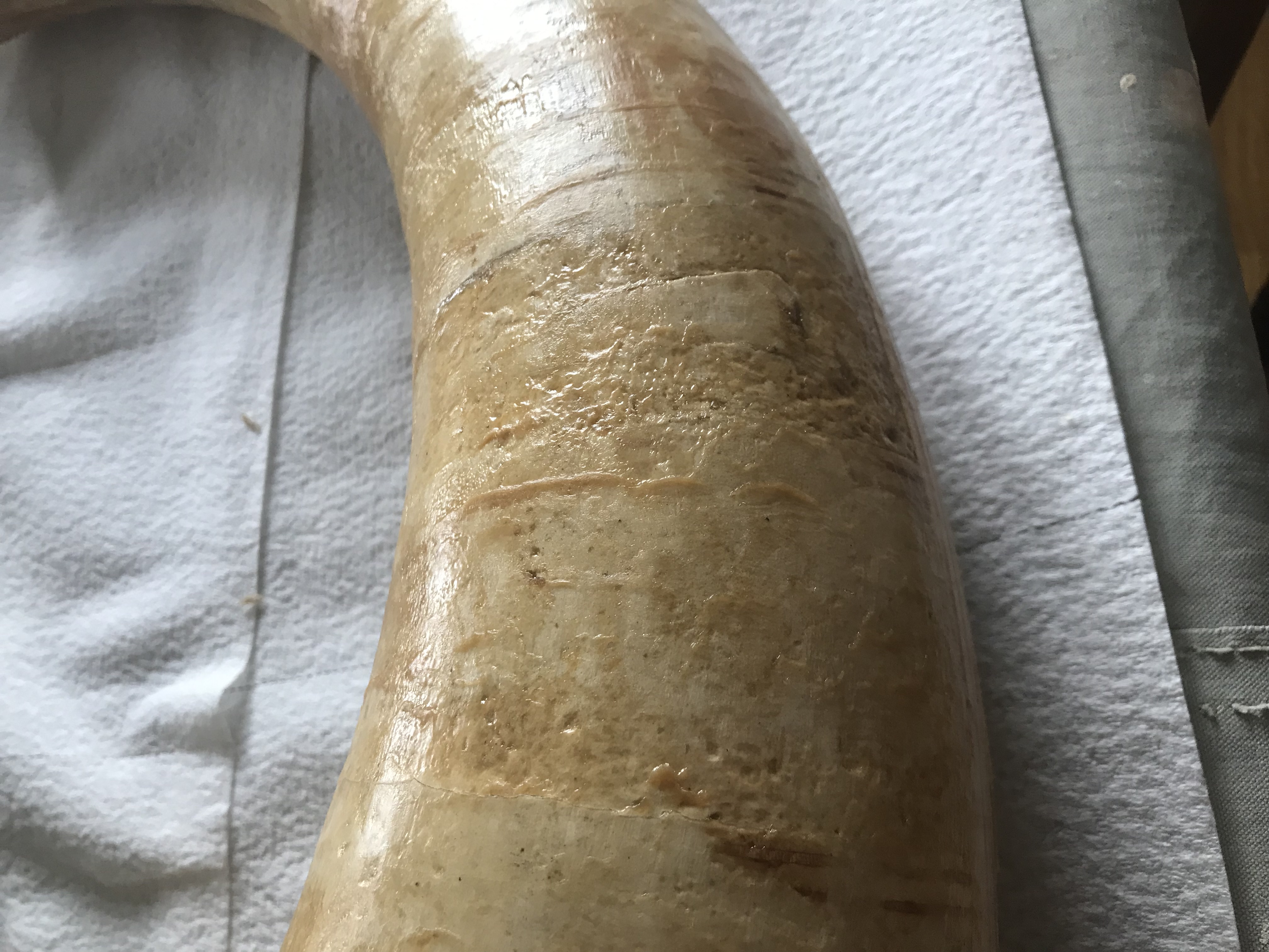

Oddly, the shellac finish on the former seems to have deformed; it doesn’t feel as smooth as it did to start, and there are a few places were there seems to be a thick build-up of shellac. (It could actually be a combination of Vaseline and dried glue, but the orange color looks like shellac.)

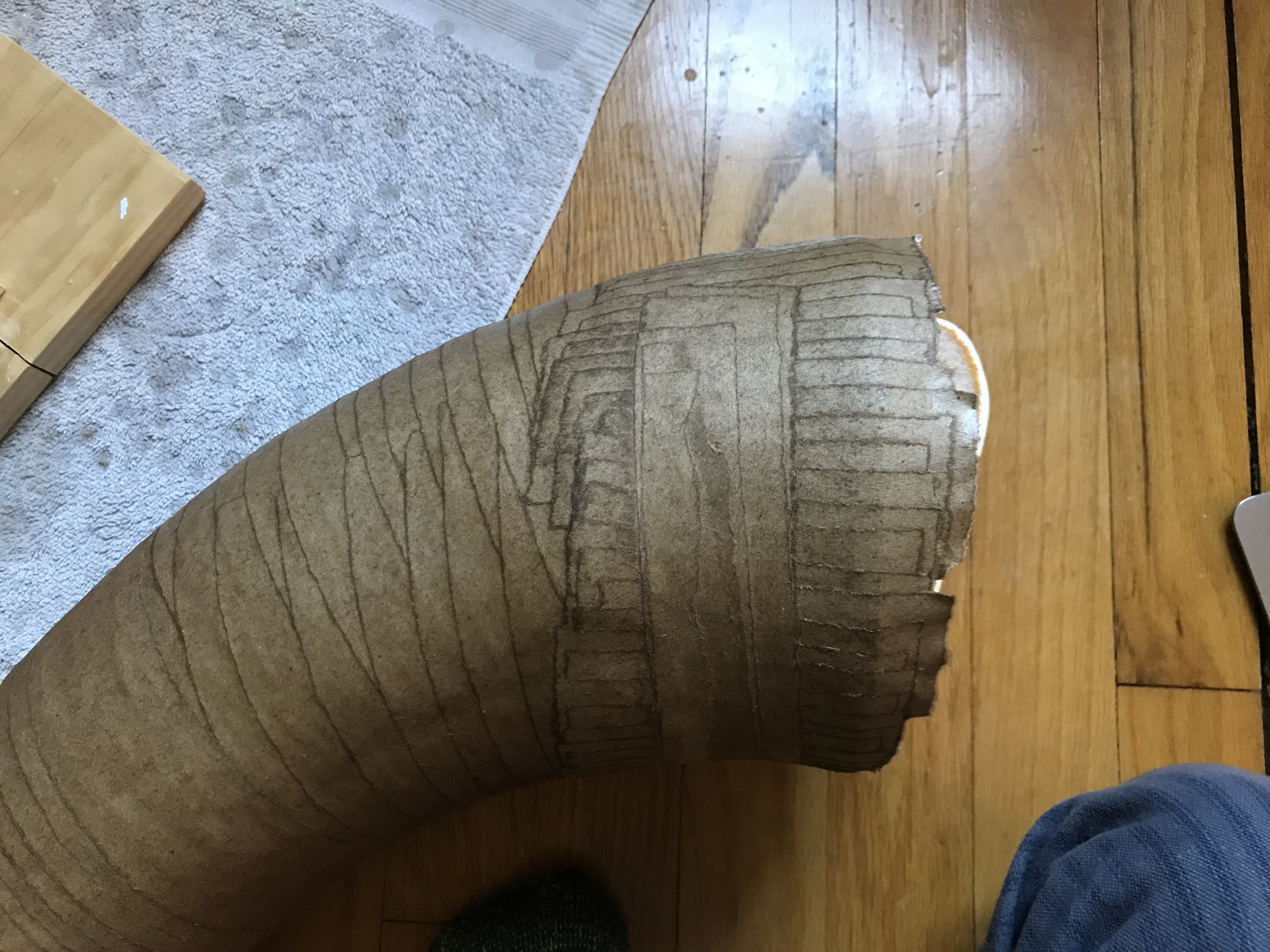

As of now, I have two layers of paper on the next section—my plan is to do one more layer over just the large curve, then at least two over the whole before extracting the former, and then adding more layers as necessary.

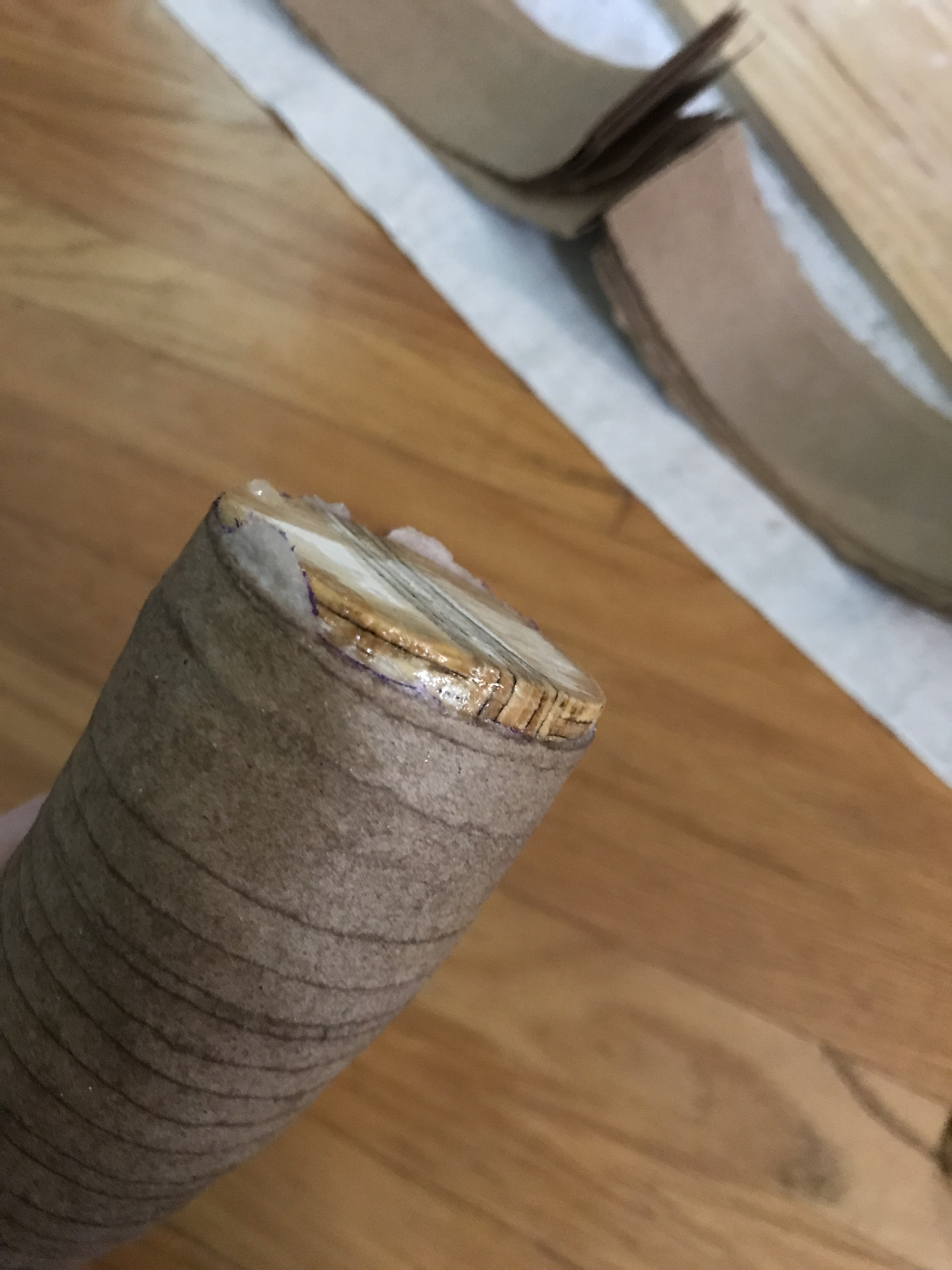

For some reason, the paper is raised up from the former at the large end—I’m not sure why, but at any rate, I think I will have to cut it so that I can press it against the former, then add more layers on top to keep it flat.
Here are some photos—

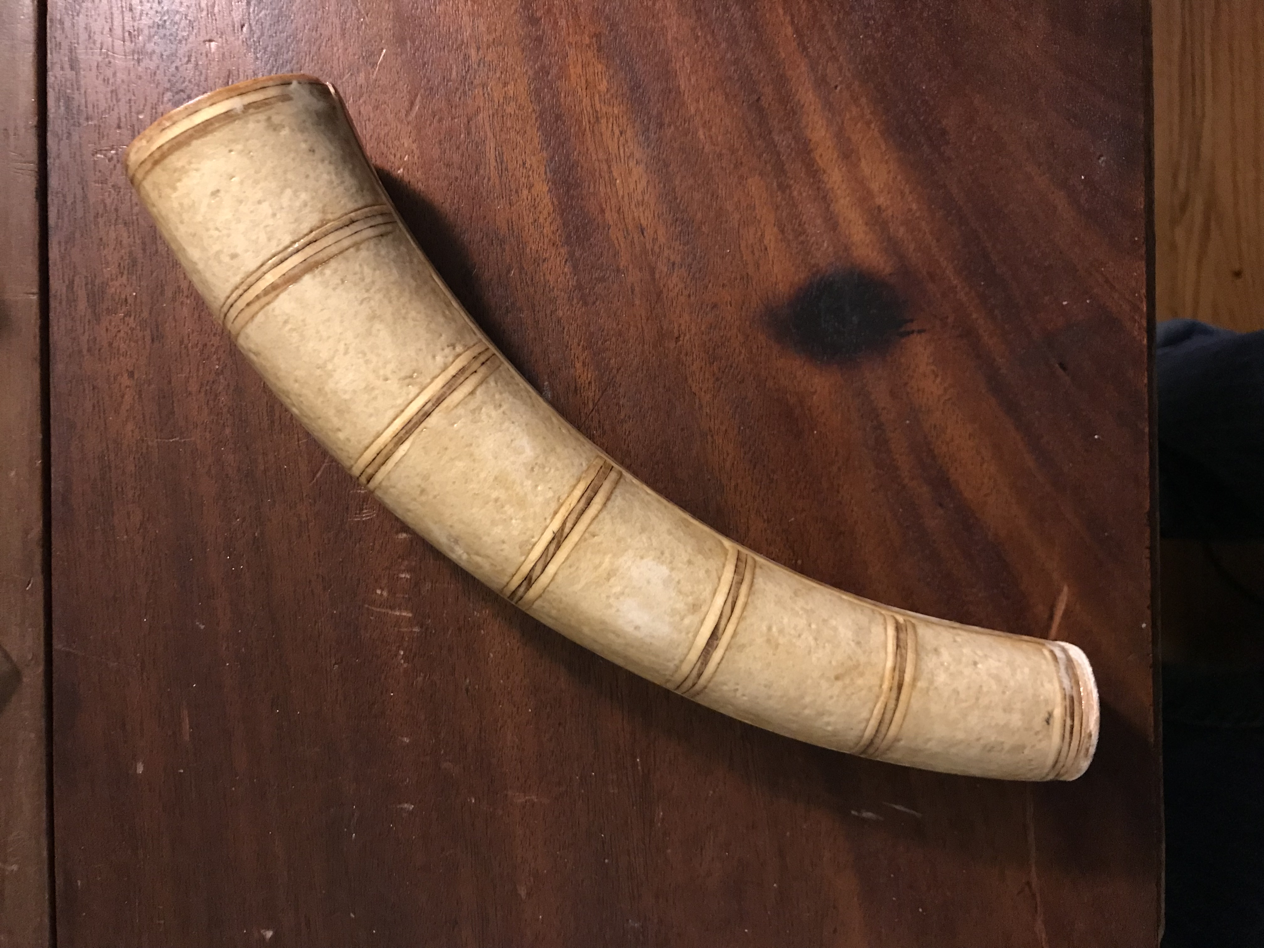

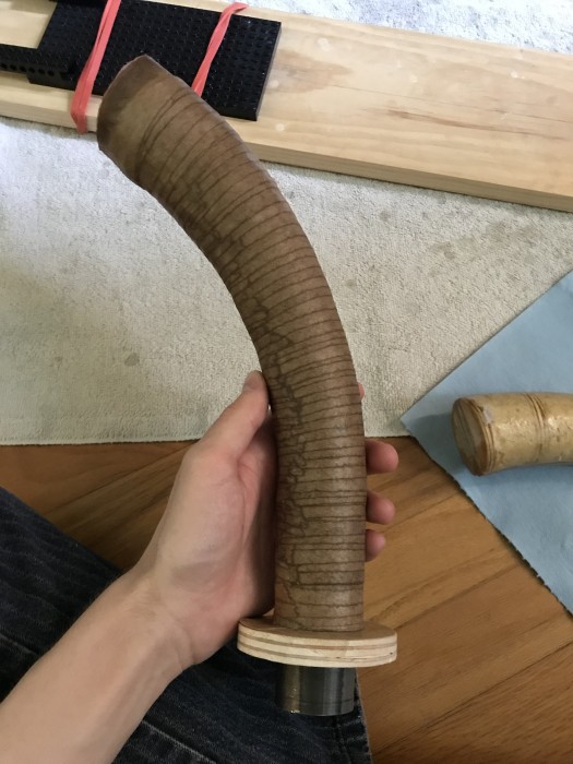

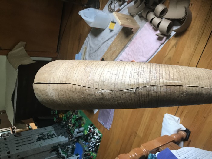

The exterior of the first section of the horn:

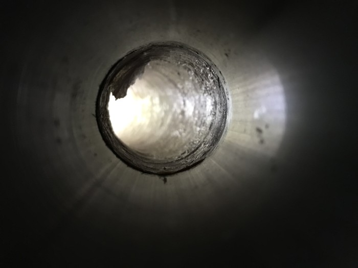

The large end:

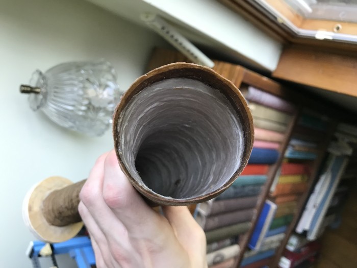

The interior looking through the spigot (I was able to remove the loose bit of paper on the upper left):
The interior looking towards the spigot:

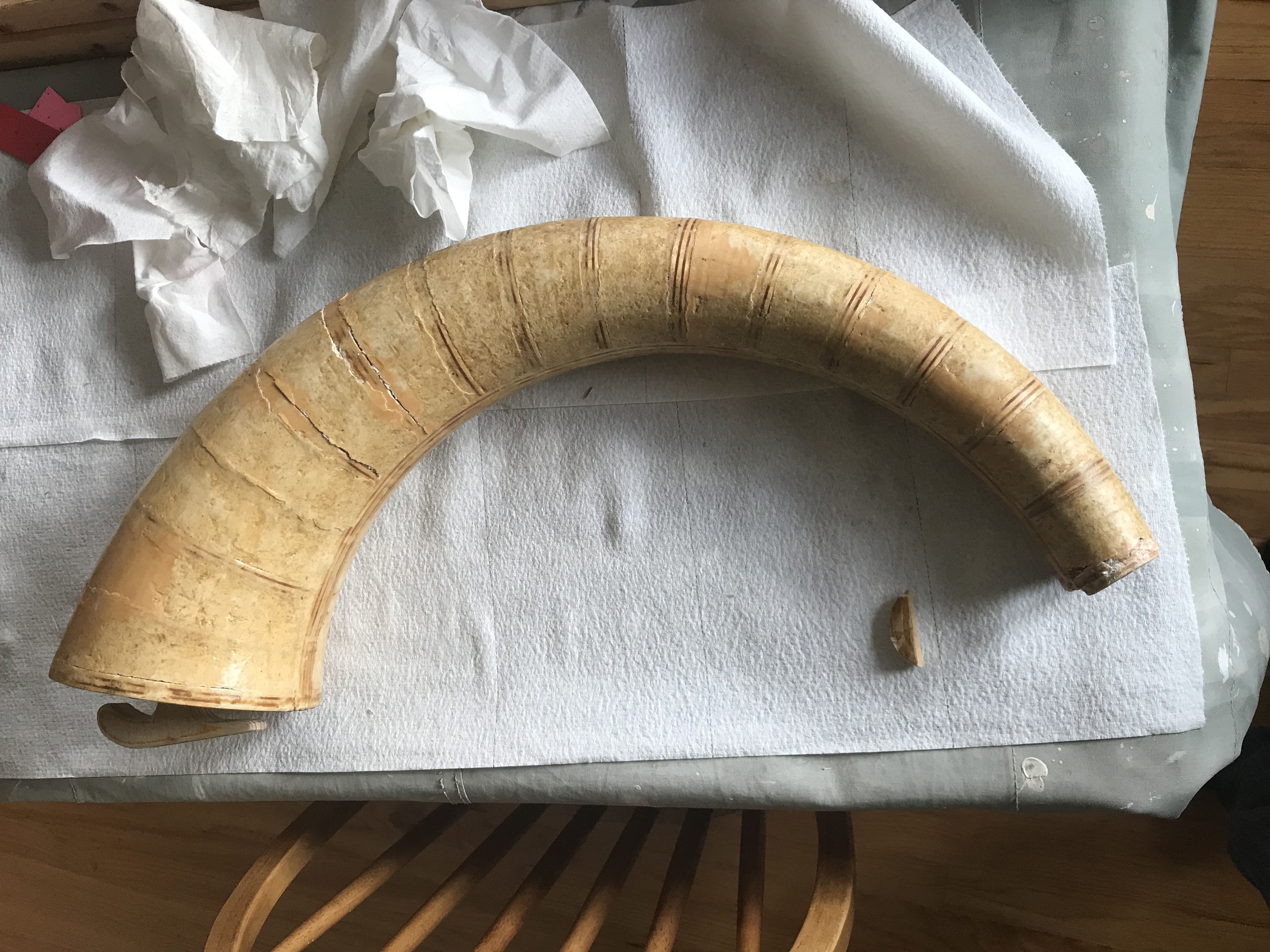

The former after extraction:

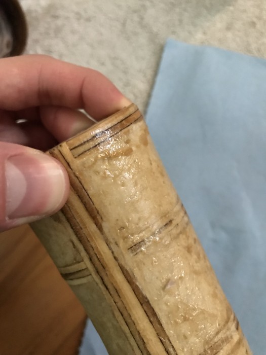

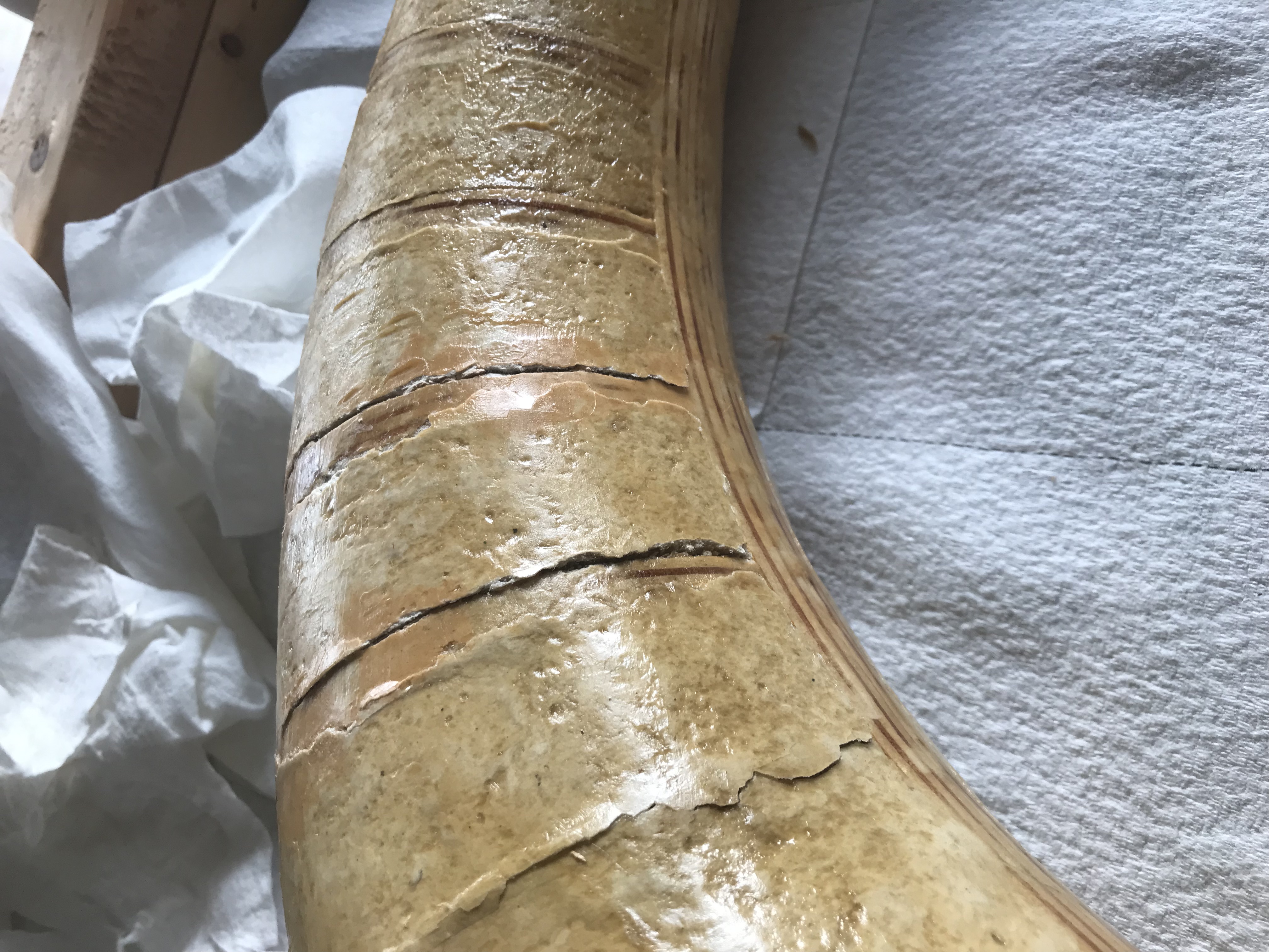

Detail of shellac build-up, visible as a couple darker spots near the end of the former:

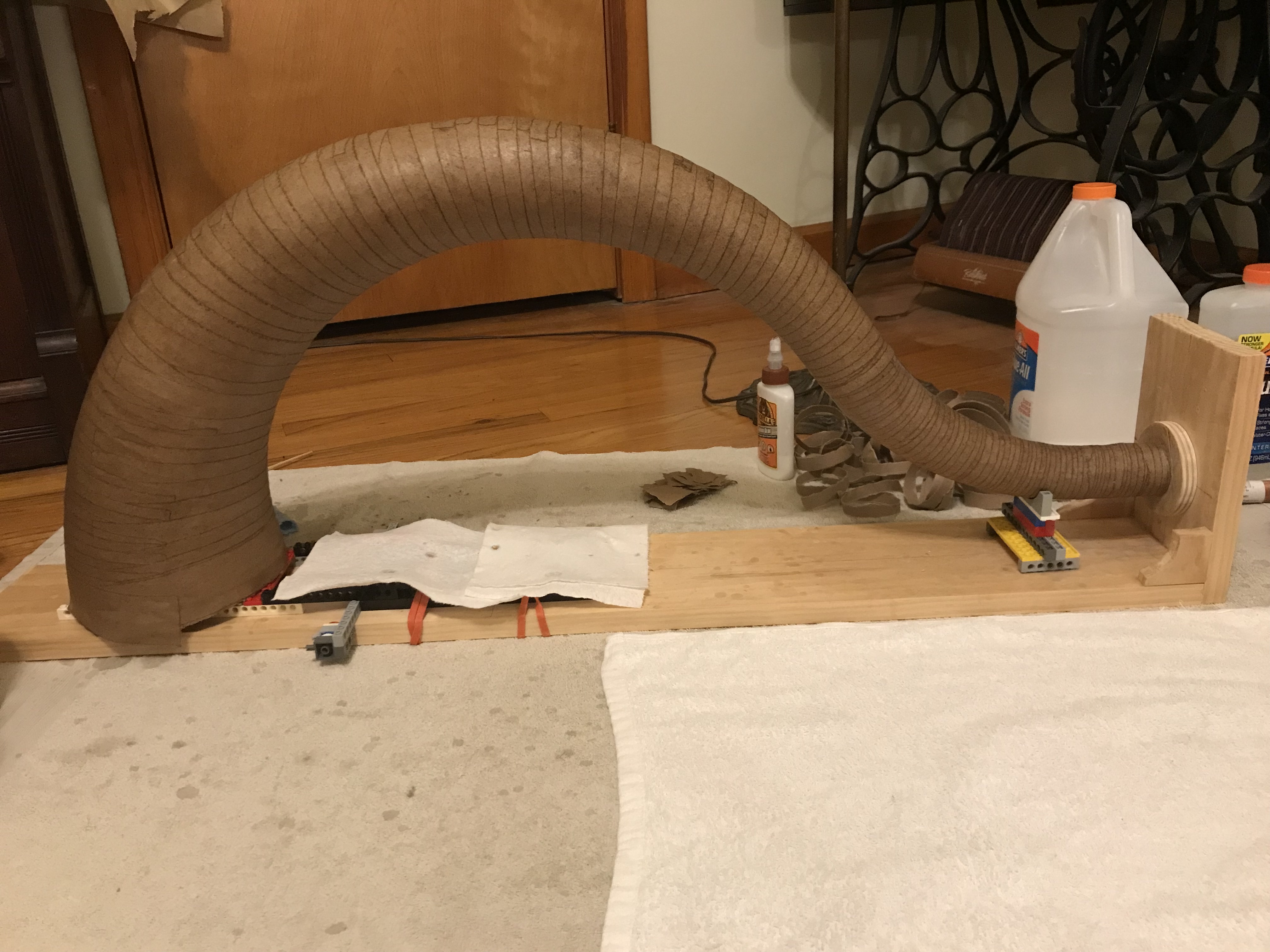

The horn with two layers of paper extended over the large curve (not trimmed to the end of the former):
Detail of paper not lying flat against the large end of the former (after trimming)--the lifted paper is visible on the right-hand side of the photo:

Ethan wrote: Wed Jul 26, 2023 10:32 pm Thanks, Inigo!
The large end:

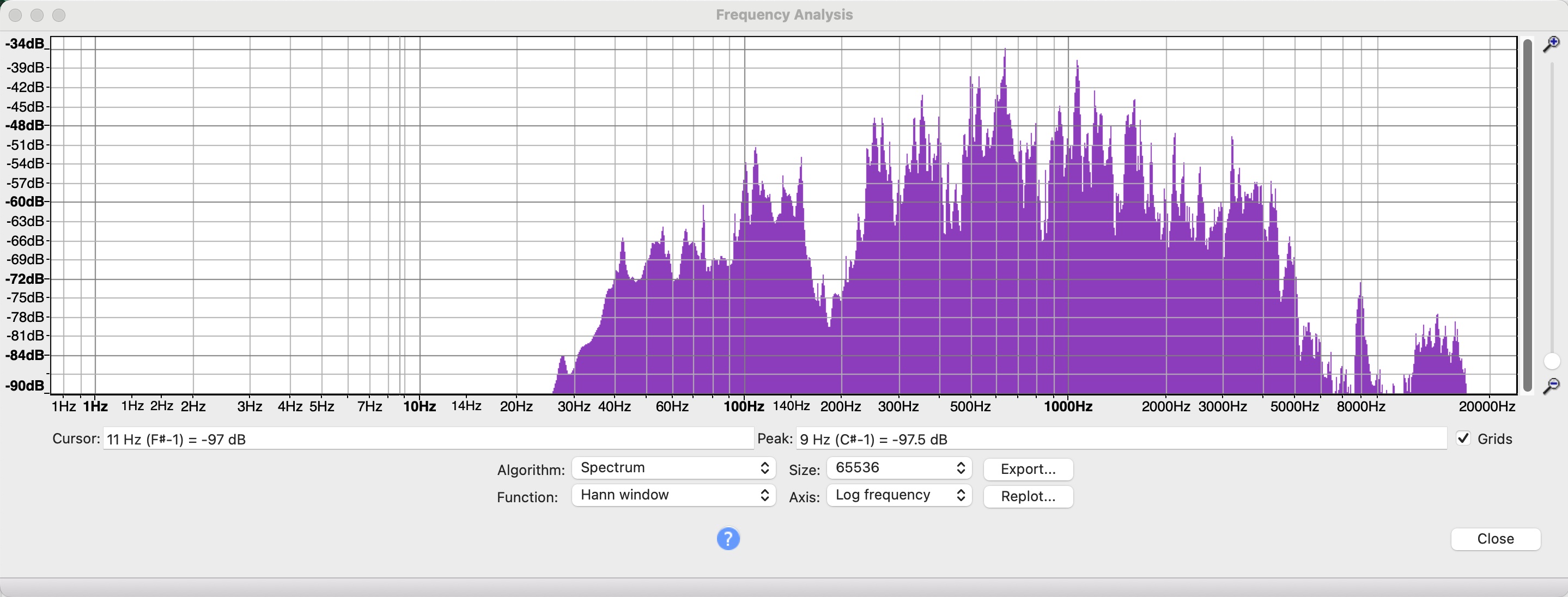

And here’s a video of the first section of horn in action before I started papering the next section—it sounded about as one would expect for something of its size, although the bass was surprisingly strong, audible down to about 100 Hz: https://youtu.be/48IxSfDBSUQ
Wow ! Fantastic sound on your excellent video ! To me, this sounds at least equal to an emg with an original horn already !
Excellent, and still fascinating. Can't wait for the next instalments ! Thank you so very much for sharing your adventure !

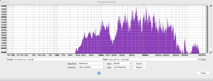

Thanks! In person, though, there would be no competition between the horn stub and an EMG--even with bass as deep as it had, the stub sounded much less full than my Victrola Alhambra with its 200 Hz horn (which doesn't sound as full as my 100 Hz homemade horn). Here's the frequency content of the video of the horn stub--I believe everything below about 100 Hz is ambient sound, with the possible exception of the small 66 Hz peak:
1--Frequency Response--1--First Section playing Cryin for the Carolines Steel.jpg
I ended up tearing out the worst of the lifted-up paper and redoing it with the strips parallel to the horn’s axis instead of perpendicular to it (which I remembered, after doing two layers with strips wrapped around the horn, was how I did the first layers on the last horn); the replacement layers seem to be working well now, although there might be a small discontinuity that I’ll have to fill in on the inside of the horn, as it feels as though there are still places where the paper isn’t perfectly snug against the former.
Strangely, the horn seems to have bent between when I set the former for the 150-degree bend in place on the first section and now; instead of having the horn’s axis pointing very slightly downward at the large end of the curve, it seems to be pointing horizontal or ever-so-slightly upward—I’m not sure why; all I can think of is that the weight of the former in the center of the horn (when in position on the holder) pulled the middle down, changing the angle. I’m not quite sure how that would have happened, though, as I had a support below the first curve while doing the first couple layers of paper on the large curve, and after a few layers, the horn walls felt stiff enough that they should have been able to withstand the weight of the former, unless I removed the support before the innermost layers of paper were completely dry. Fortunately, it isn’t a major change, so I don’t think it should cause any significant problems.
The wall thickness where the two curves meet seems to be around 3/16” thick as of the fourth layer of paper, so I am hoping that I will be able to extract the former Sunday or Monday, after finishing the fourth layer and possibly adding a fifth, depending on the wall thickness at the large end of the section.

Here is the horn with the lifted paper town off—a rather depressingly large area had to be torn out, but on the bright side, tearing it out proved that paper appliqué is quite sturdy—I had to use a pocket knife to cut the paper and peel back the edges of the strips before I could tear them off, and even so, it wasn’t terribly easy to deconstruct.

Well, I finished the fourth layer Saturday and tried hammering out the former Sunday, by which I mean that I spent all of Sunday trying to hammer out the former. Conscripted both parents to hold it in place while I hit the end with a mallet and (for a brief while) a small sledgehammer—broke two ¾” plywood ramrods—accidentally smashed the wood flange on the spigot—accidentally loosened the metal spigot from the paper horn—went back to it in the evening after dinner—and by the end of the day, the former had only moved out about 1/16” to ⅛” at best. Tried again for a little while Monday—no luck. Cut off the 60-degree curve so I could hit the former directly (without a ramrod)—still no luck, but I found out the end of the former was slightly crushed from the hammering. Tried again to-day, with no better luck, so I cut the horn lengthwise along the outside of the curve, using a non-serrated knife to minimize loss of material—pried the horn off the former along the cut—and finally was able to pop the former out by slamming the narrow end against a concrete garage floor. (Methinks the former design needs some—er—slight—modification.)
It turns out some of the glue from the horn had stuck to the former despite using (I thought) a thick coat of Vaseline, and the shellac did the same clumping-thing as with the last section, hence its tenacity in the face of removal—rather a nuisance, but now I only have to deal with extracting the two straight sections of former for the bell, which should be much easier, at least by comparison.
I glued the cut along the back of the 150-degree curve, but will have to glue it again, as I couldn’t find a good way to clamp the two sides so used tape instead, and will need to add glue where there is currently tape across the cut.
Any thoughts on whether it would be better to re-attach the two curved sections by gluing the ends together and adding more paper over them (I plan to add about ⅛” more anyway, but wasn’t planning on doing it until fall break), or by attaching wood mounting rings to the adjacent ends, similar to how EMG made their Export horns?

The first of the two broken ramrods, and the broken spigot flange:
The horn after cutting off the first curve and before extracting the second former:
Close-up of the cut:
Interior of the first section where the spigot came out:
Interior of the first section where I cut it off the next:
Horn--11--Interior of first section lookingto large end after cutting of next section.jpeg
The second section’s former after extraction:
Close-up of the former—the paper mâché came loose between several ribs:
Close-up of the former—clumped shellac:
Close-up of the narrow end of the former where it was crushed by the mallet and sledgehammer—the two end ribs came loose:
The cut along the back of the 150-degree curve section of horn:
Interior of the same section prior to cleaning out Vaseline and shellac residue and crumbs, looking into the large end:
Interior of the same section prior to cleaning, looking into the narrow end:
The same section with the first application of glue along the cut drying, with the two sides held in place by tape:
