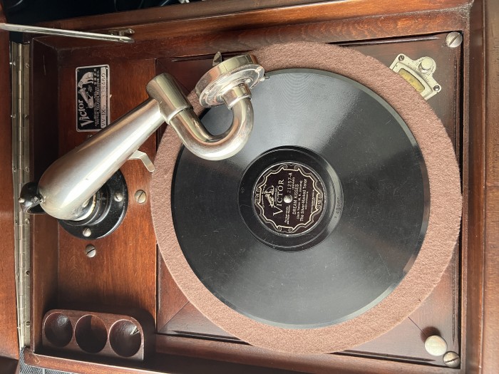

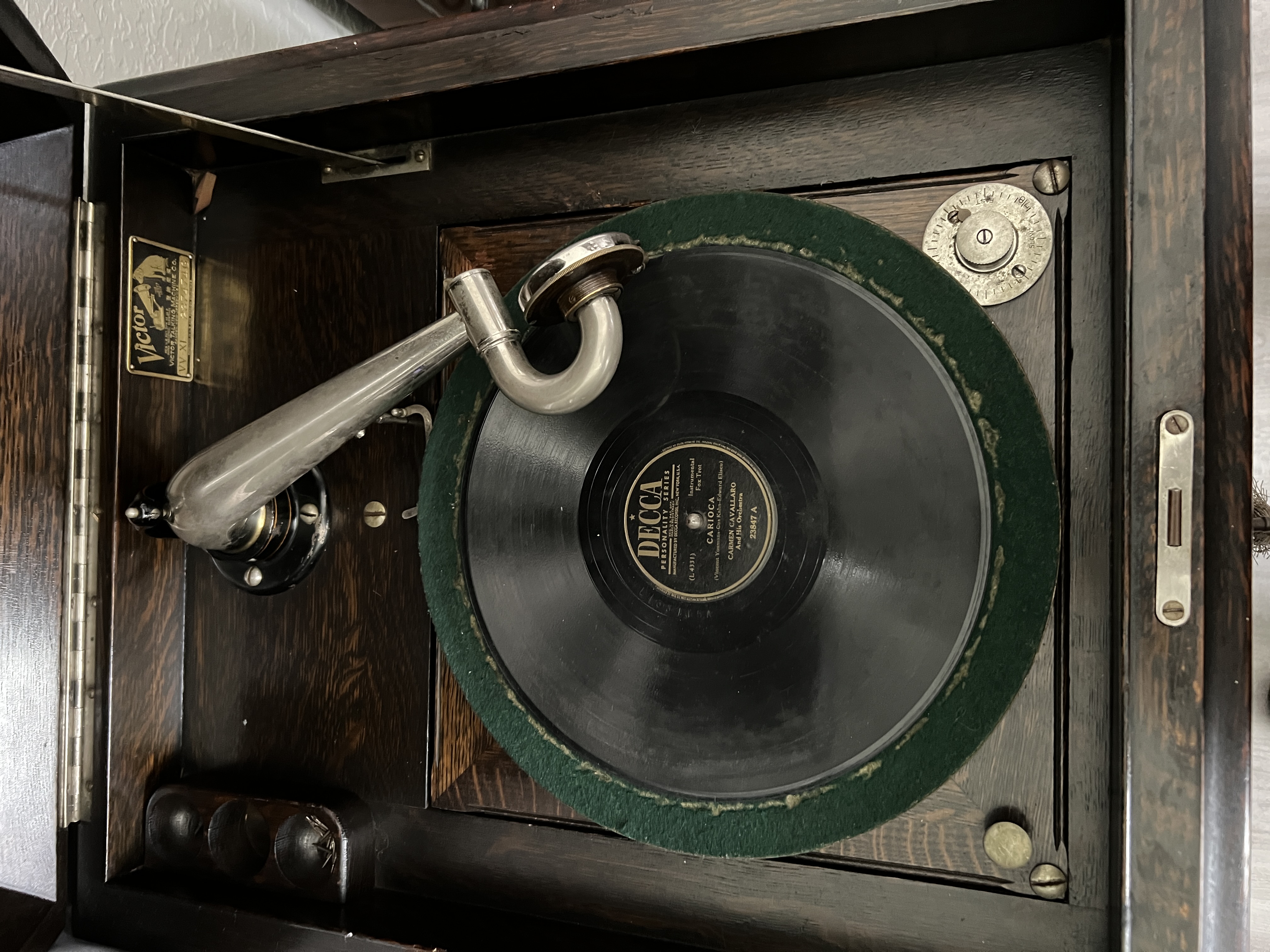

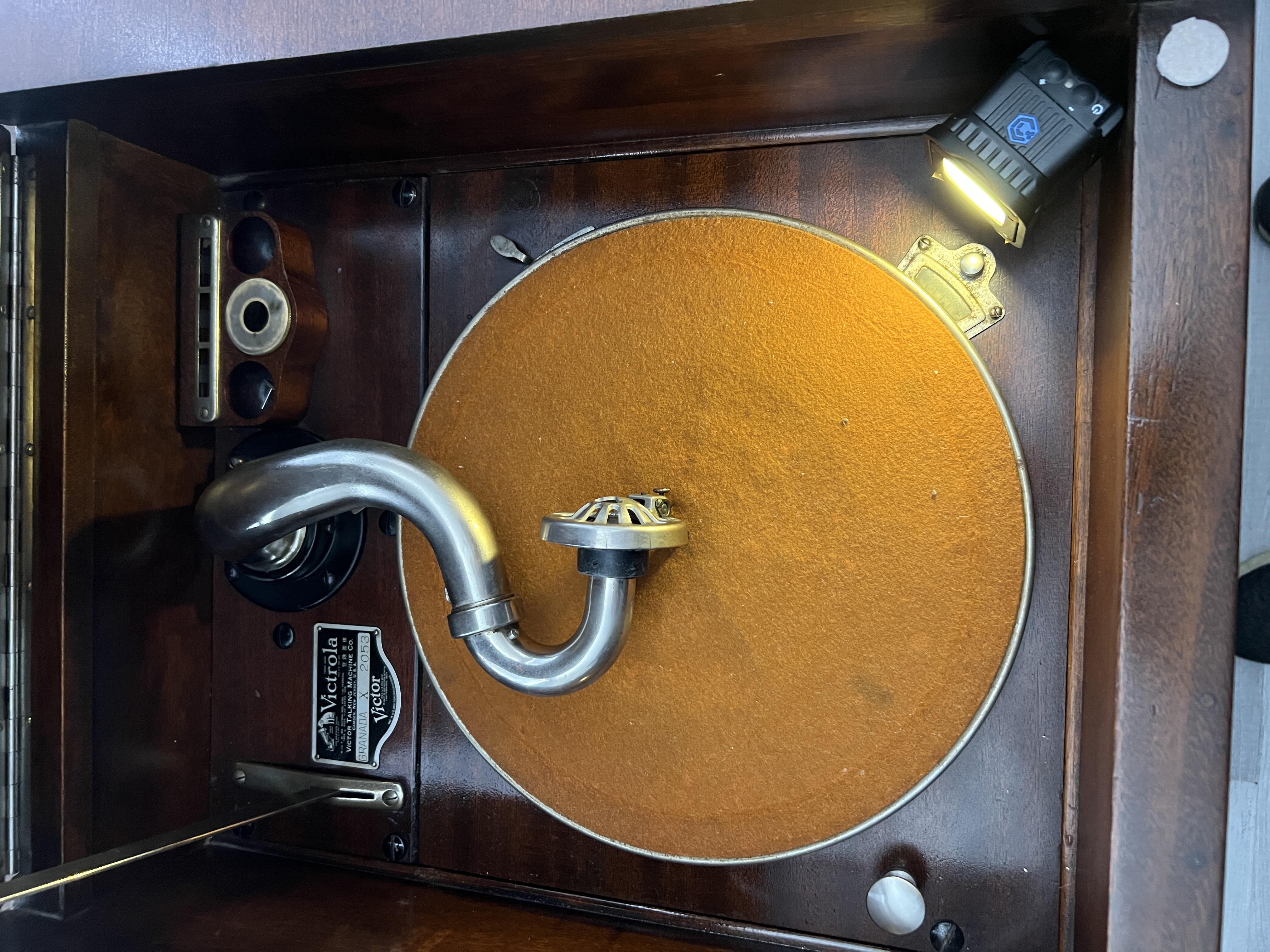

Re: Victrola Tonearm Variations
Here are the photos. The VV-XI has a gold serial plate for some reason. The Granada has an induction motor that works very well. I haven't taken apart the tone arms or reproducer to clean them yet. I have only had them for a month or so. Long story but when I went looking for them I found these 3 almost immediately so much to my wife's objection I got all three! The more I delve into these machines the more I worry I am getting addicted.
