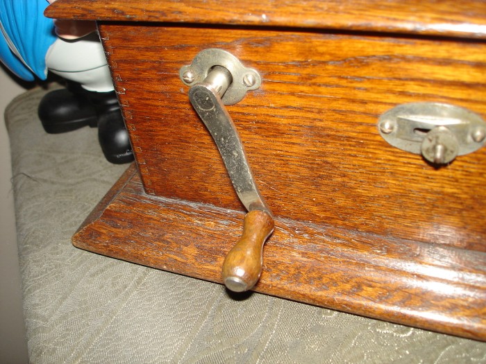

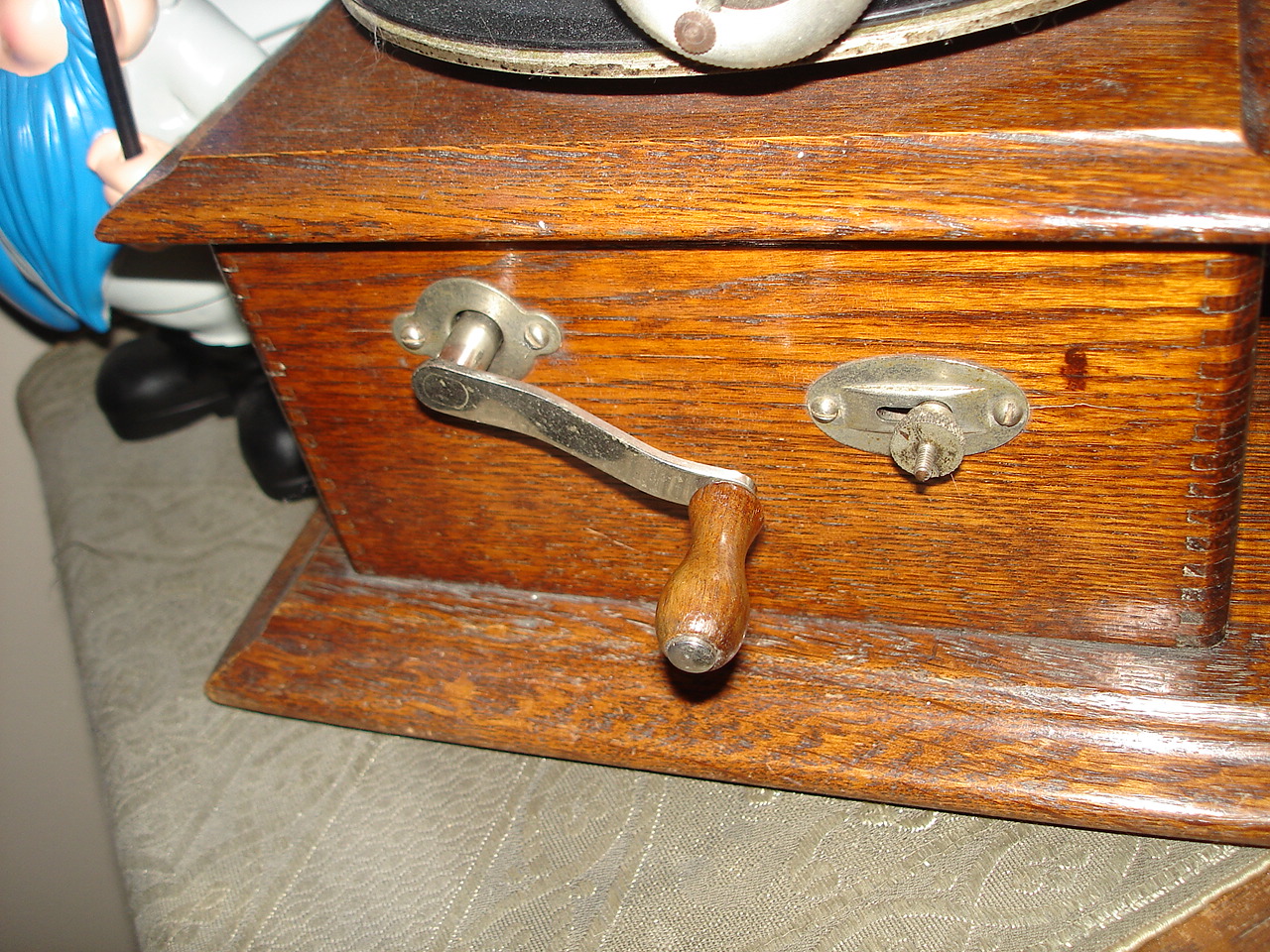

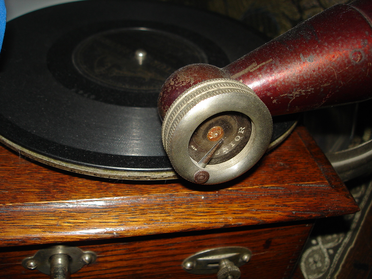

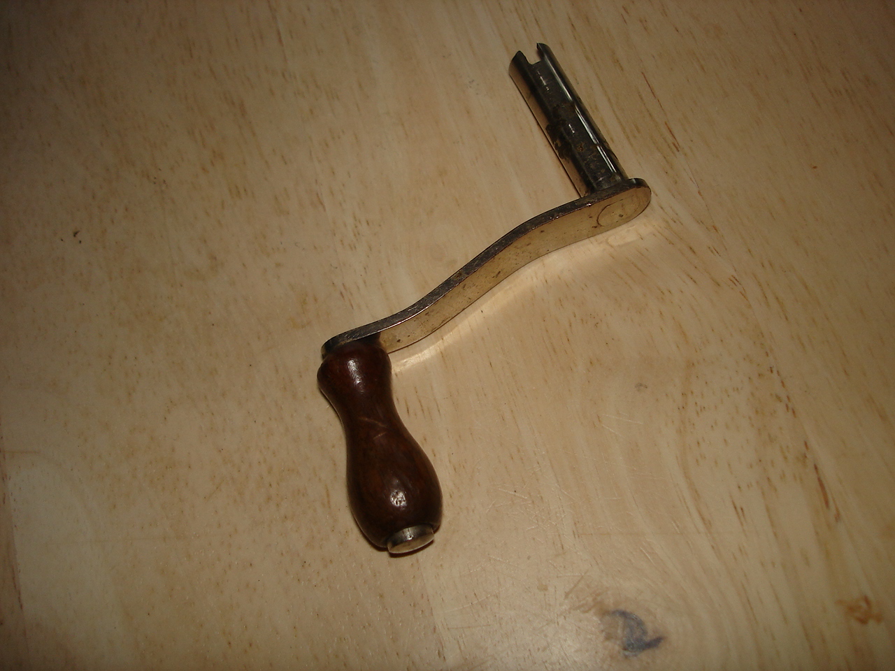

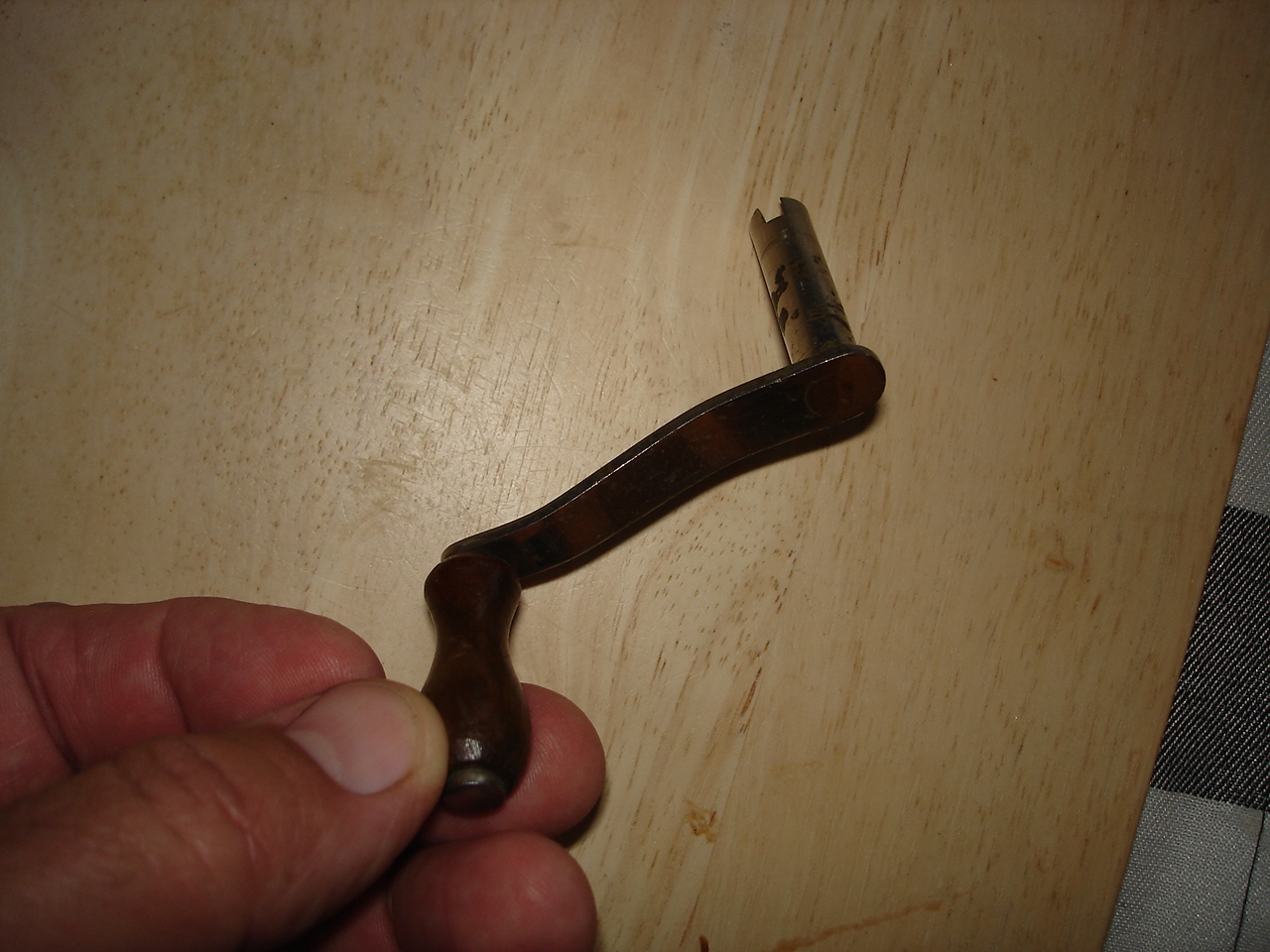

Upon closer inspection, the crank and reproducer are most likely reproductions. I believe the Victor type R and P (certain variations) share the same slotted crank so that shouldn't be too hard to find an original crank. Wonder if it'd be better to refer the seller to a phonograph sales group directly, if they care enough to have a good buyer & seller experience.
Liam Hood
Posts: 6919

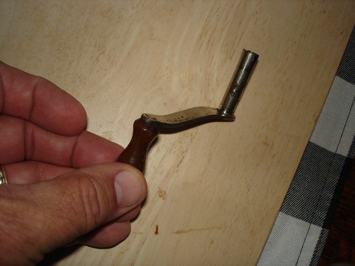

Re: Nice Vic Jr on Ebay
Here is an original crank and reproducer. There is nothing technically wrong with the reproduction reproducer. They are darn near perfect, and that's what makes them stand out. No signs of aging.

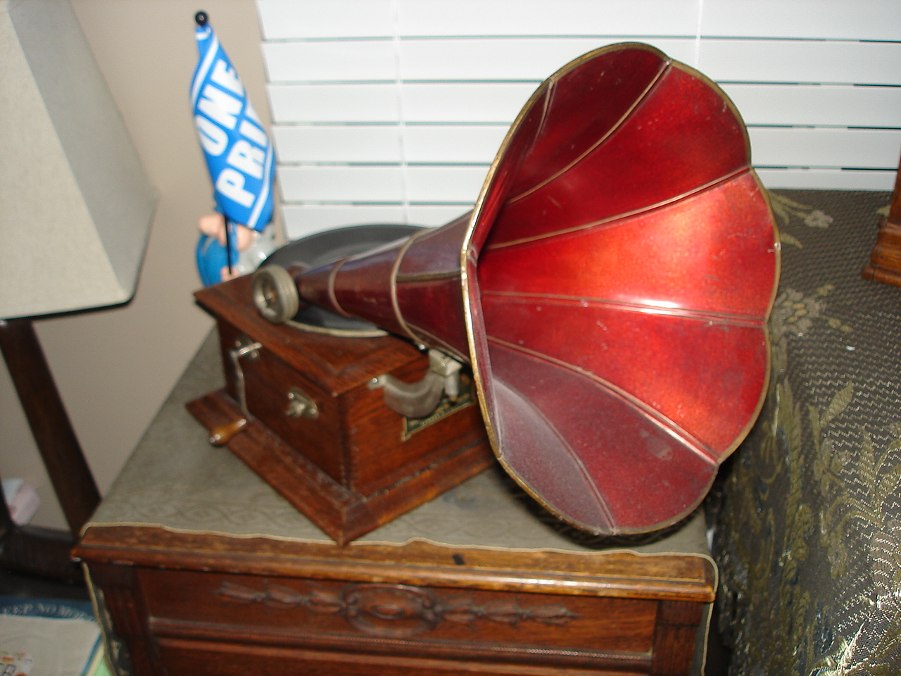

Send us a picture of that red horn!!!!

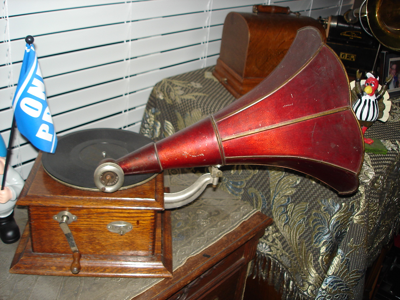

fonograph wrote: Mon Sep 18, 2023 9:15 am Send us a picture of that red horn!!!!
Here you go...

The Reproducer is a reproduction possibly made by Mirek Stehlik. If you could buy it for 500-600 you would be ok
