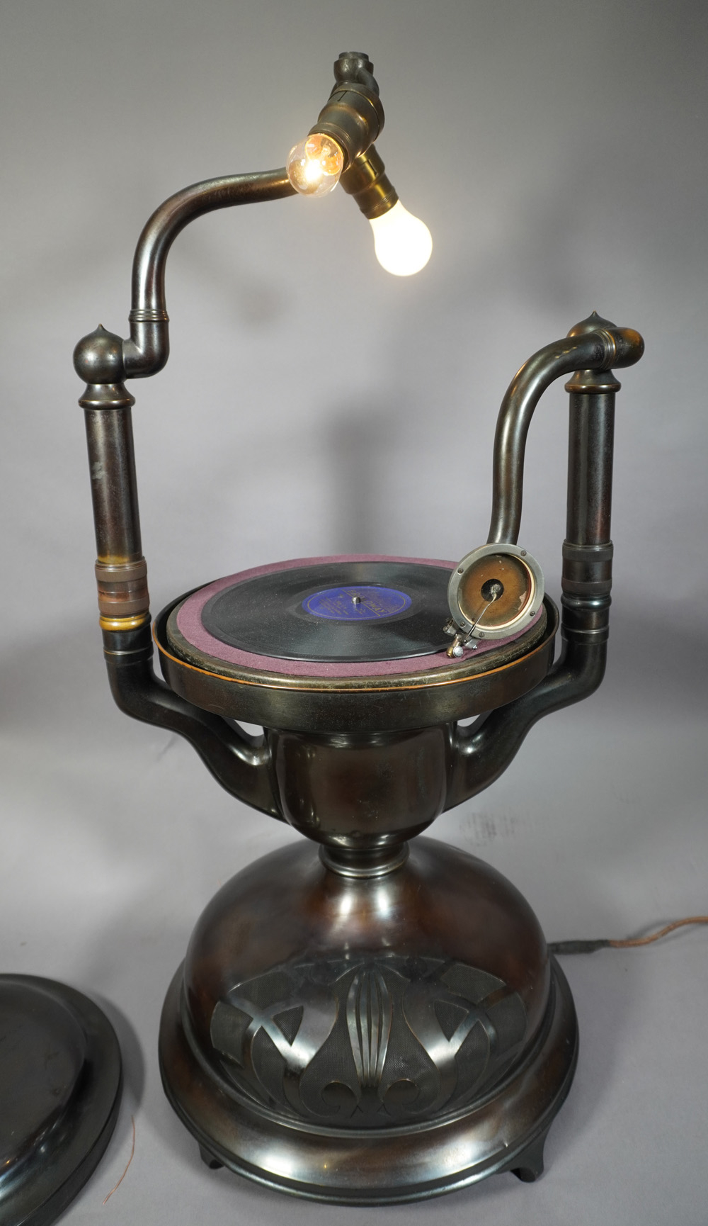

Does anyone have a wiring diagram for the Endless Fairy Lamp which has a cartridge on-off switch?
I am particulalry interested in how the power cord to the motor ties into the power to the lights.
Thx if you have any info on this.

I have restored two of these 10 or more years ago and have never found a manual or wiring diagram, though one might exist. If I remember correctly, the motor switch is the lower ring on the lamp arm and is wired separately from the lamp switch and connected to the power cord. The motor can be run with or without the lights and the lights can be powered without the turntable being on. The volume control ring is on the tonearm stanchion and operates like a choke valve on an old carburetor - turn it one way and it opens, the other way and it closes.
You will need to disassemble the lamp arm by removing several set screws that hold the switches and the entire assembly inside the arm. I replaced the crude wood switches with modern rotary switches modified to fit into plastic conduit sleeves. The original factory switches were just crudely made from rectangular brass blocks that rotated between two brass leaves that created a contact (and a large spark) when rotated, mounted to a round wood piece.
I'm not a fan of sketchy wiring, so I modified them. I always thought that their scarcity was due to burning up in the houses they burned down. Imagine a spark in a house with gas fixtures and a small leak... :?

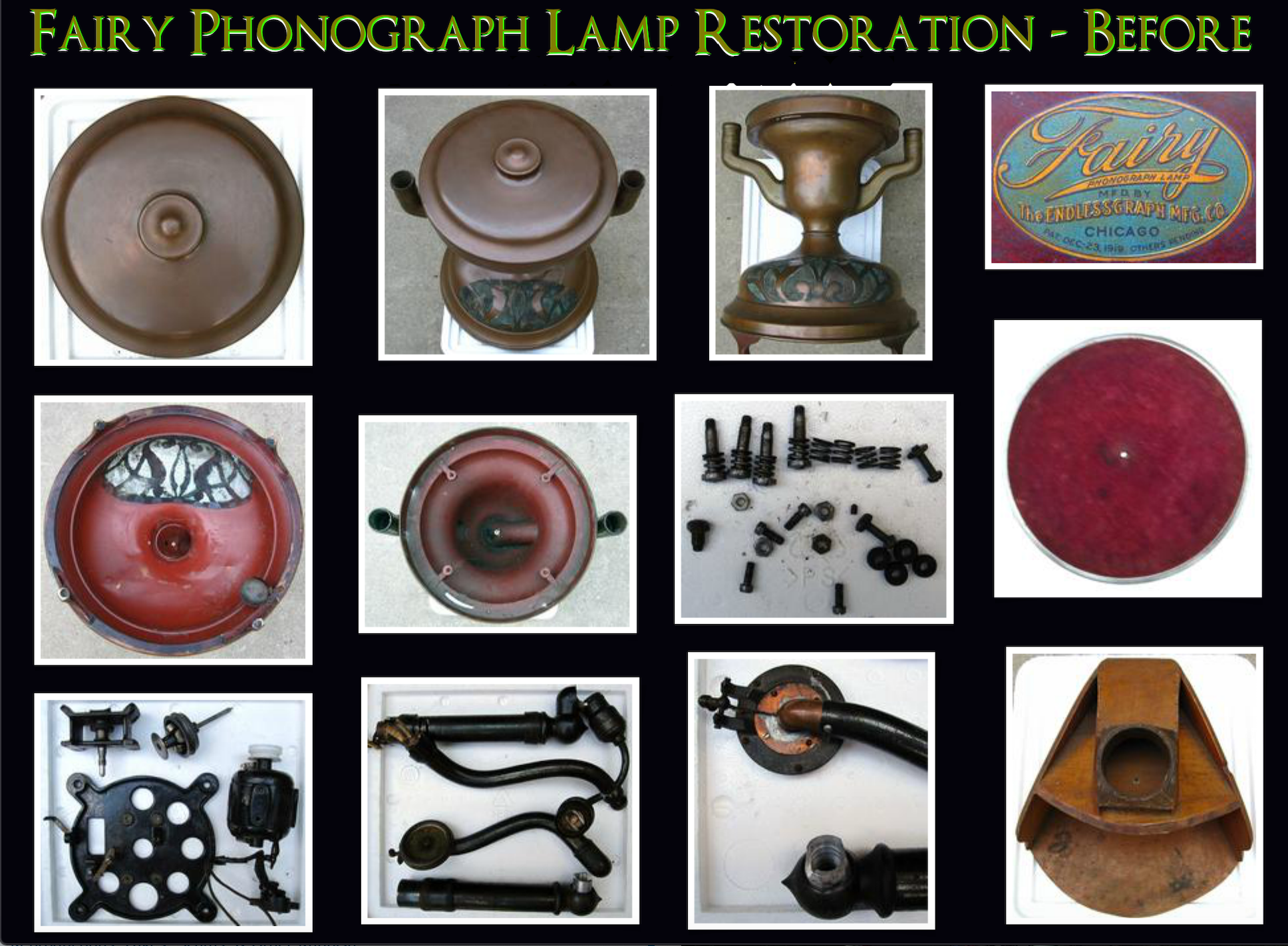

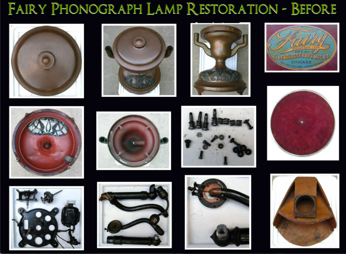

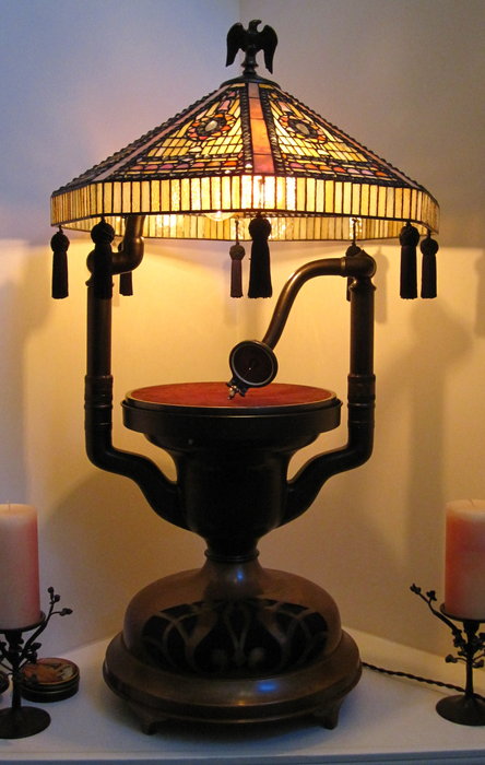

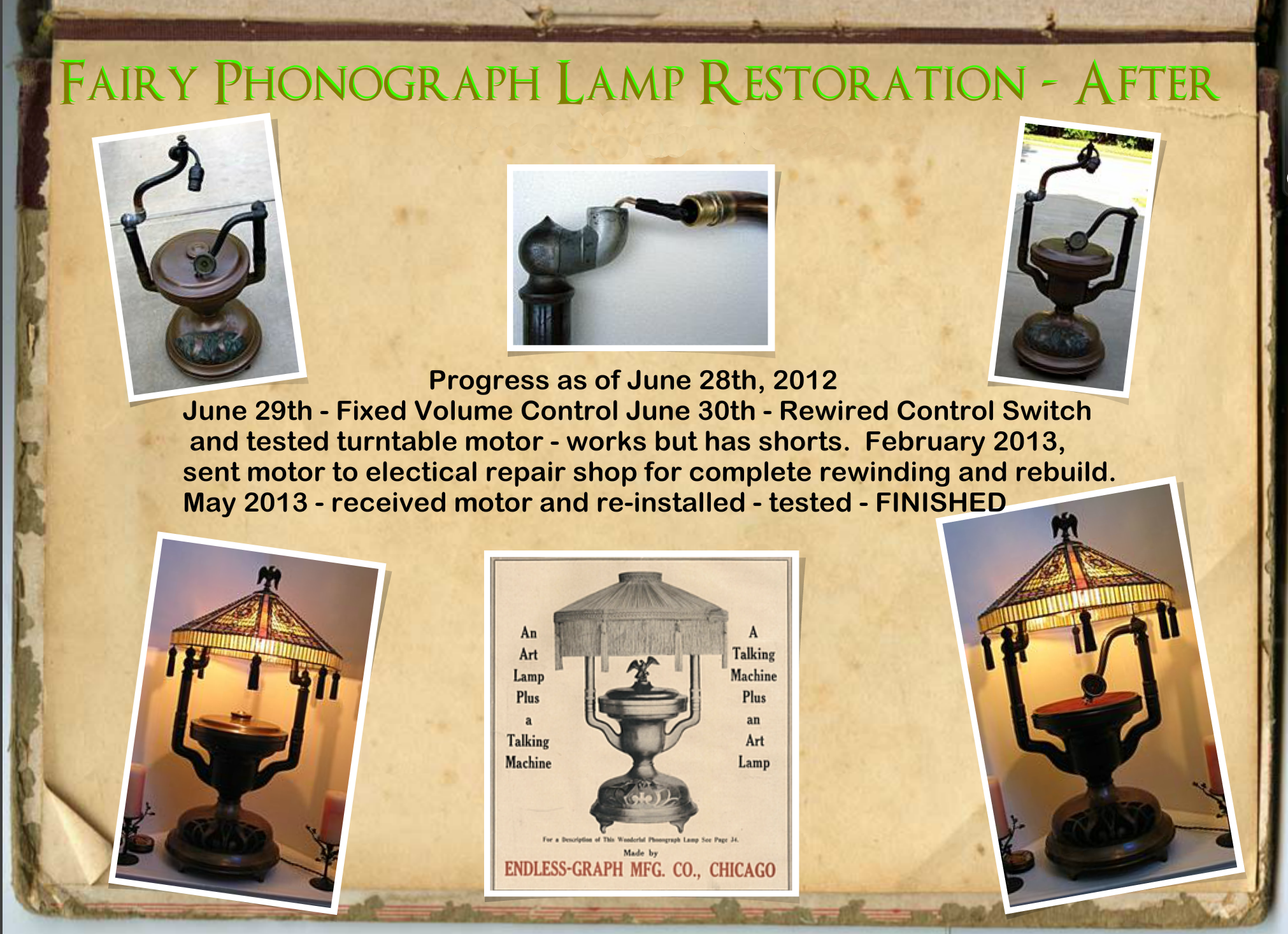

As a reference, here is my Fairy Lamp, Before (when I got it) and After complete restoration:

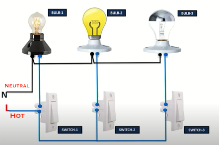

Now, to answer your first question - how to connect the wiring.
Do you have basic knowledge of electrical wiring? Black - hot wire, White - neutral wire
Switch - breaks electrical current coming through the black wire (on a switch the copper colored connections are hot and the silver are neutral). On plugs the large prong is neutral and connected to the ribbed half of a lamp cord. Hot is the small prong connected to the smooth half of the lamp cord.
Without knowing how much knowledge you have, I hesitate giving advice...
This video explains how to wire two lights with separate switches connected to one input power source (cord). It is basically what you need to do to connect your lamp separately from the motor using one power cord...
https://www.youtube.com/watch?v=mxbaqegYxBU
Pay attention around the 5:40 mark on the video.
