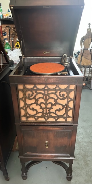

I'm also working on an Edison 250.Image
I cannot determine whether this is a C250 or a W250. The cabinet resembles W250s I've seen on line but I'm not sure.

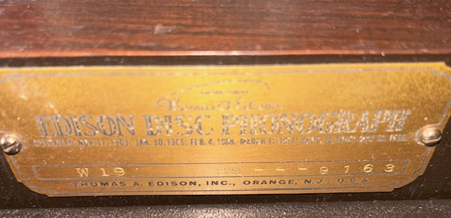

On the data tag, what does the number mean. Is it a serial number?
Thank you in advance.
Rene
Data tag inside of turntable cabinet

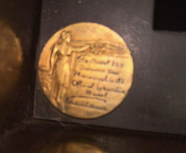

Edison Tag inside turntable cabinet

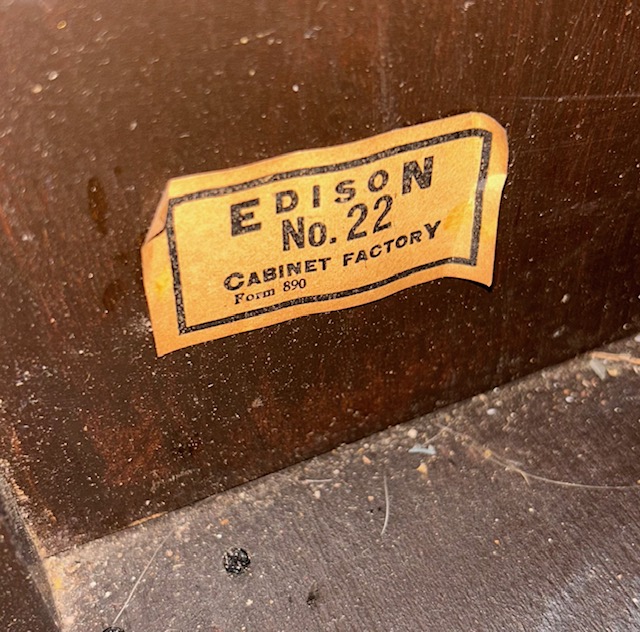

Paper tag inside of Speaker cabinet
Edison 250
Edison 250
Posts: 8281
Re: Edison 250
As shown on the data plate, your machine is a W 19, which was simply a renaming of the W 250 (which occurred in April 1919). Edison documentation called these machines the "William & Mary."
The "9163" is indeed the serial number.
