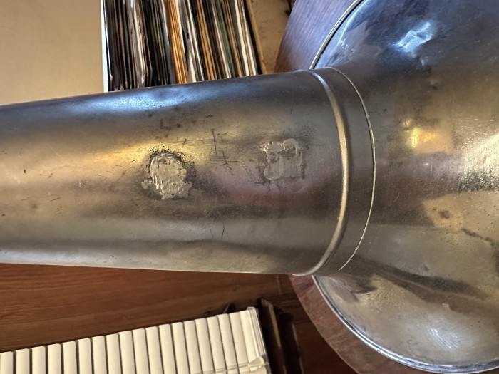

I have one of these machines that has some damaged/ mismatched parts. I'm seeking a horn (Trichter) as mine has 4 ugly soldered repairs. It's zinc with a blood orange (ish) paint on the inside. I also need a DGAG Concert soundbox, long throat. Mine has a G&T soundbox similar to a Berliner, but I think it's for the later upright rather than flat trailing arm as it came with an extension installed.

Regarding the solder repairs, can you post a pic of what they look like? It sounds like they were done with the wrong type of solder or not enough flux and heat. They might be able to be corrected by reheating them and brushing them with paste flux, like Nokorode (not liquid). While hot try to remove as much solder as possible. If it smears, the excess can be buffed off. If they need new solder, use 60/40 for repairs - never use acid core or non-lead solder on anything important.

But seriously- I was sort of thinking along the same lines as a back up plan on the horn. I am honestly not even sure why the solder is there because it does not seem as if there are holes. It looks like radiator solder honestly.
I may melt this off when I get time and go from there. If I need to resolder I'd use a silver solder. If I get it halfway decent I may send the horn to John and have it rolled/ straightened/ polished, then paint the inside of the cone when I get it back.

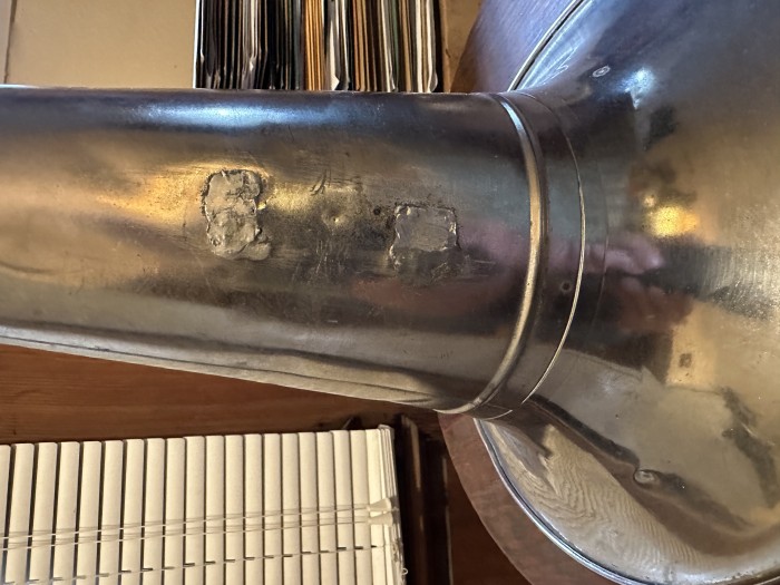

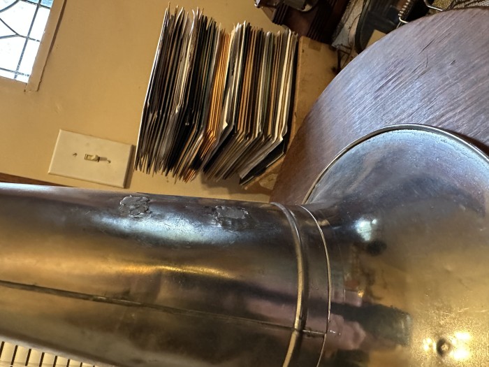

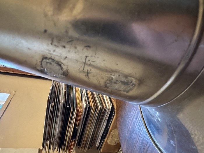

Photos

It looks like someone decided that it needed a strap hanger - hence the two evenly spaced solder spots. If there is not a hole visible after removing the solder the remainder may just buff off. Send it to John, he may have a better way to remove it. It looks to be a very nice horn and probably difficult to find another original.

If any resoldering is needed I would not use silver solder, as previously mentioned. The needed temperature to flow silver solder will likely burn through the horn. There's likely nothing wrong with the solder that was used. The problem was in the sloppy application. The link to the original example of this machine does not seem to show any need for soldering anything. What's the solder about anyway?

No idea. I got it like this. I assumed there were holes in the horn but the solder does not go through.

Obviously, something was crudely attached there. That's what made me think of a "strap" hanger ( a flat piece of metal shaped like a handle) - as found on early horns. Maybe someone thought a horn crane was necessary for whatever reason.

I am thinking that you are likely correct.
