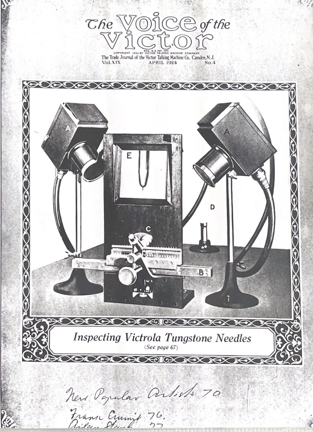

An interesting article in the April 1924 issue of Voice of the Victor.
I copied this from the Jim Walsh (Hobbies) collection at the Library or Congress 30 years ago.
Victor could make Tungstone needles 99 years ago, maybe this article will inspire one of us to take up mantle now?

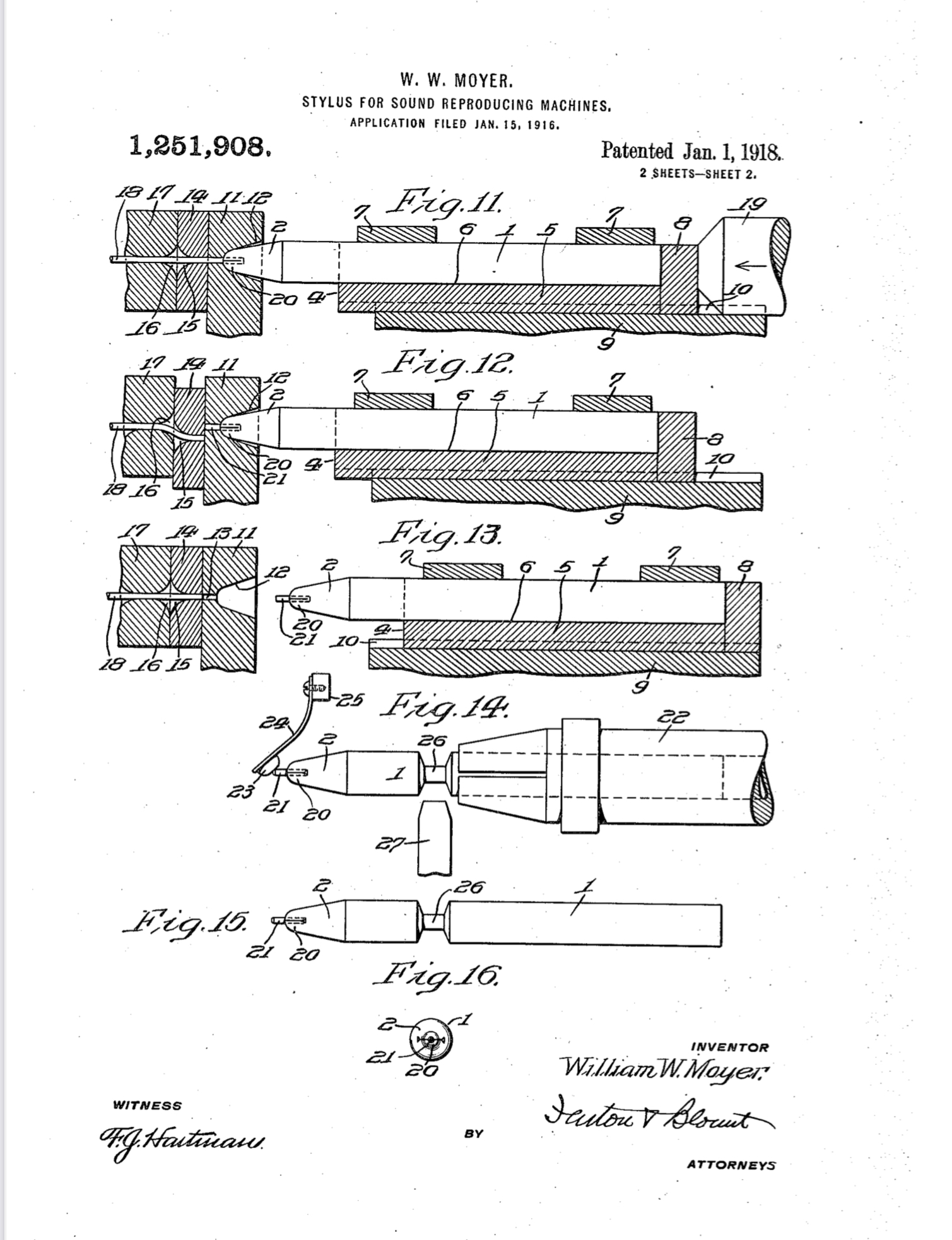

I tried making tungstone needles a few years ago, but my results were not good.
I bought some tungsten wire of appropriate diameter and used epoxy to fix a short piece in a fine metal tube, a 27ga iv needle, but it ended up being quite messy and the 27ga needle was so fine that I had to fit that into a larger needle, an 18ga or something like that.
I also found that when I cut the wire with snips it caused it to split lengthwise. A cutting disk would work better.
I may try again some day, but use a different method.
Any suggestions?

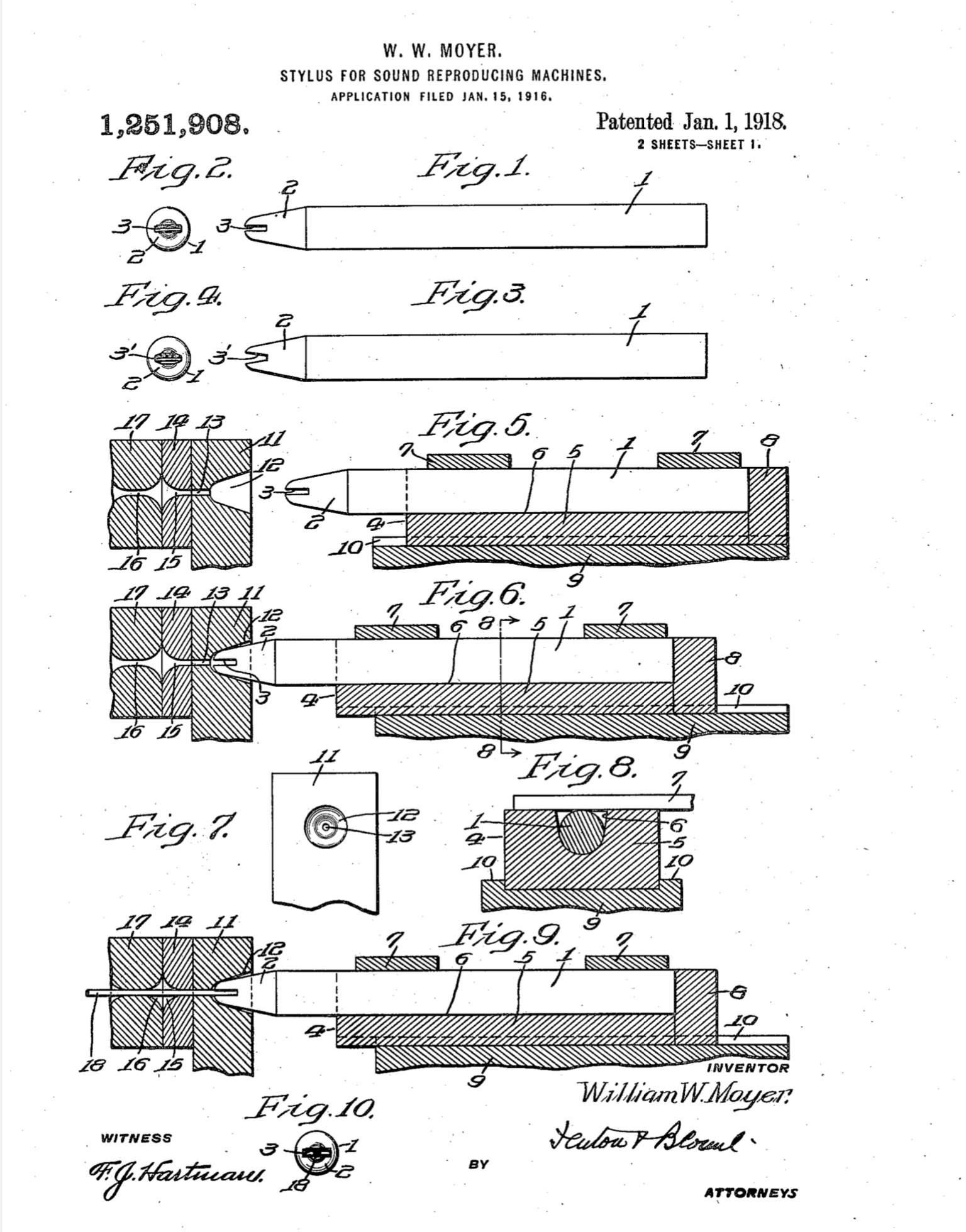

The Moyer patent for the tungsten stylus describes exactly how they were manufactured. The tungsten wire was swaged in place. It also mentions the difficulty in cutting the tungsten wire. The tip was rounded by grinding after cutting to remove burrs, The patent was assigned to the VTMCo. in 1918.
https://patentimages.storage.googleapis ... 251908.pdf

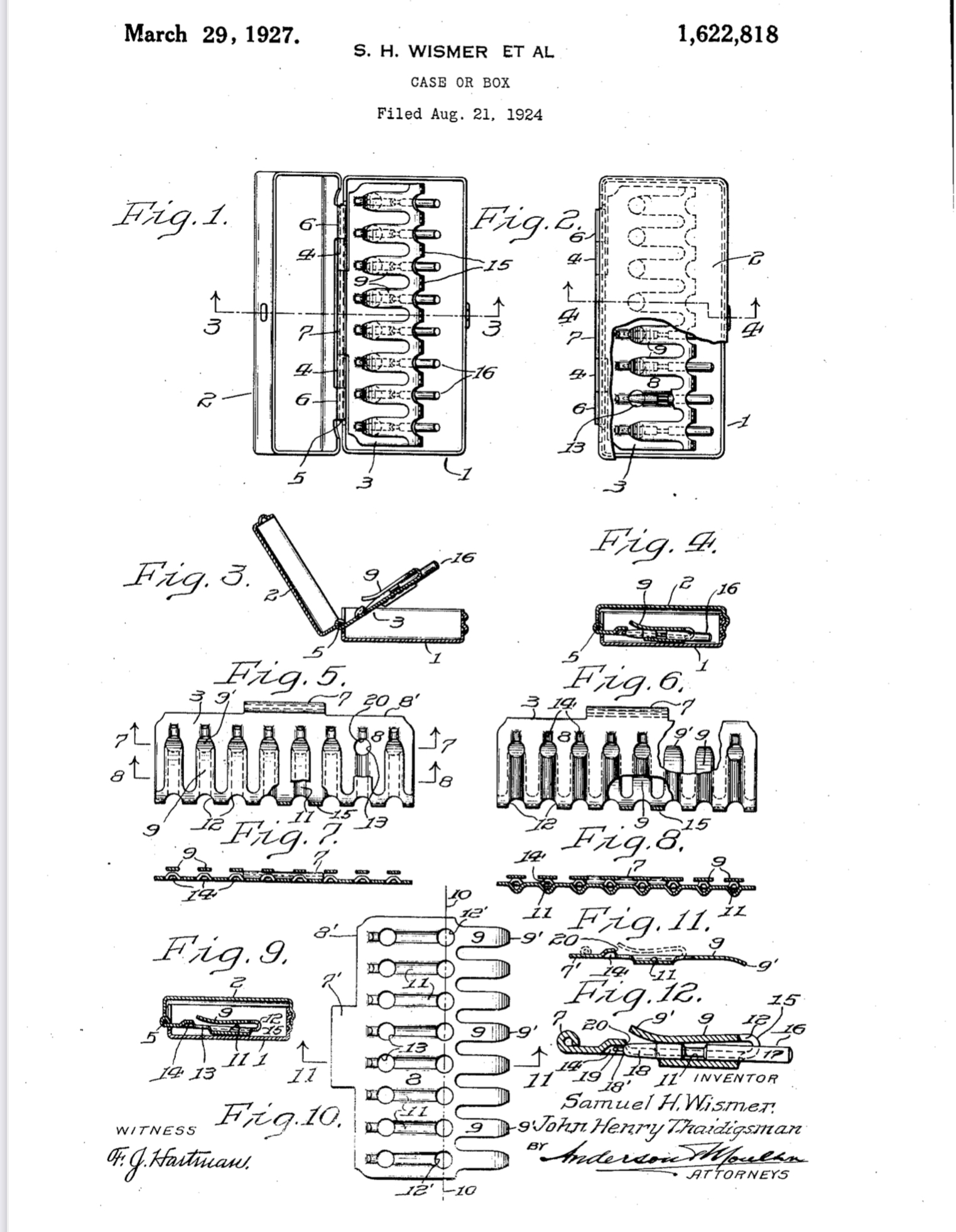

The metal case many of us are familiar with for holding a set of Tungstones is covered in this patent.
https://patentimages.storage.googleapis ... 622818.pdf
