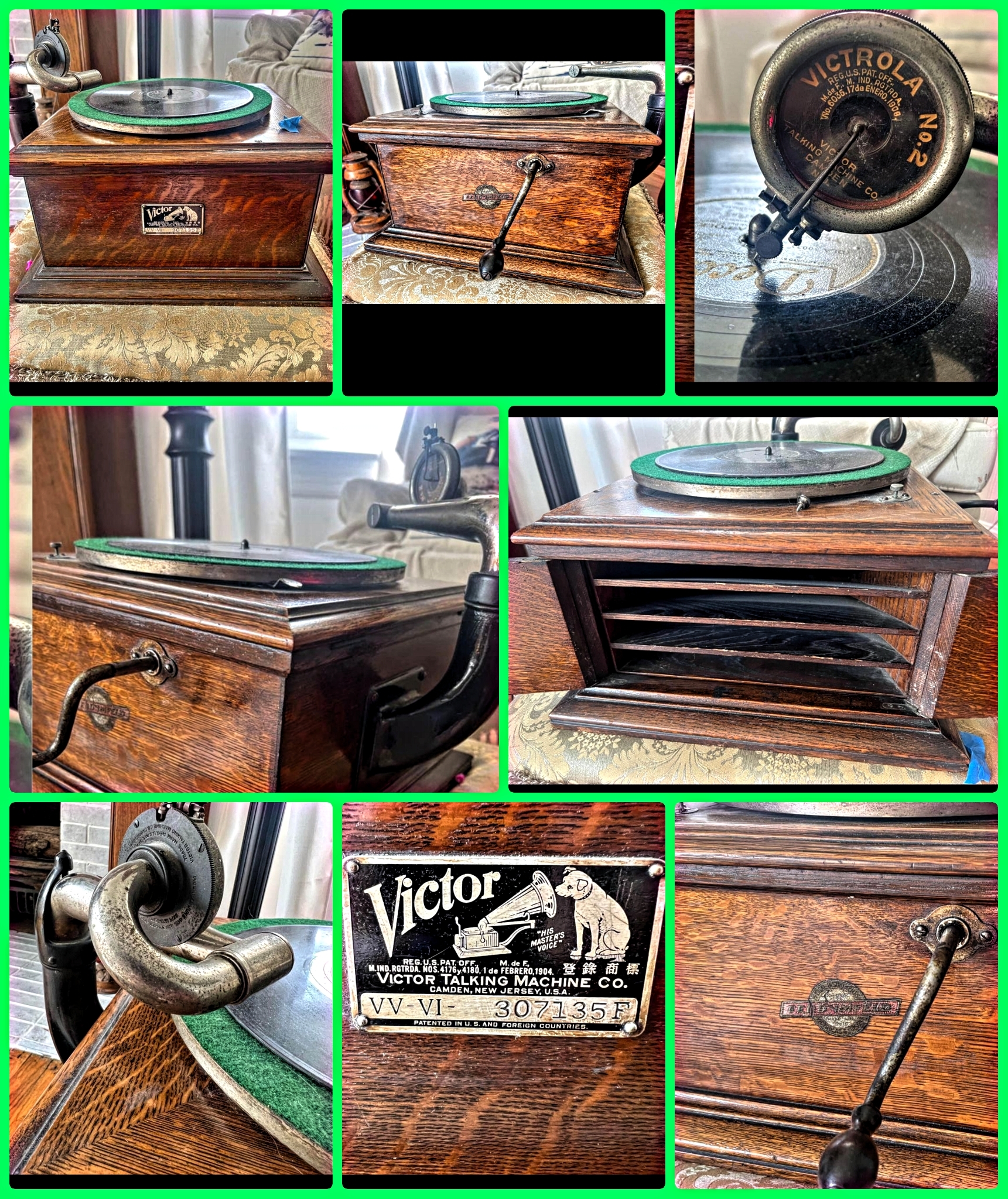

I think, maybe, it's internal. The add said "missing horn" or "no horn". Something like that. I think I may have caught the bug. I can't stop looking for these machines! This one looks so much nicer than the Columbia I bought and this one is less money and there was a video of it playing and it sounded great. Here's the pictures of it. I'm guessing it's the second type you mentioned bcuz of the serial number. Think its worth two hundred and fifty?

I think $250 is a bit steep for this. Finish has been slobbered over with a coat of shellac(?)

The seller seems confused with the nomenclature of phonographs and is using "no horn" to imply an internal horn. The VV-VI is completely different from your Columbia BN in that it's cast iron and sits in the interior of the cabinet connected to the front with wooden slats to direct sound out past the doors. Notice how the back bracket curves downwards into the cabinet and does not support any sort of horn elbow. The VV-VI is (at least in the east coast) an extremely common machine and can be found dirt cheap in unrestored condition. I've had friends give them to me for free from garage sales and shed finds and I usually restore them and flip for about $125. I personally think $250 is way too high if it hasn't been properly restored. I say wait for a cheaper unit to pop up or buy a restored example from a collector.alienj wrote: Sun Dec 03, 2023 6:22 pm I think, maybe, it's internal. The add said "missing horn" or "no horn". Something like that. I think I may have caught the bug. I can't stop looking for these machines! This one looks so much nicer than the Columbia I bought and this one is less money and there was a video of it playing and it sounded great. Here's the pictures of it. I'm guessing it's the second type you mentioned bcuz of the serial number. Think its worth two hundred and fifty?

I have purchased a few of these and really have a hard time selling them for $75 each after I fix them up.
