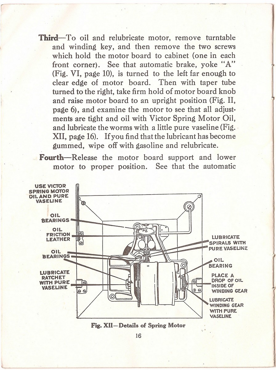

Have you tried to oil the machine as per the instructions stuck to the inside of the motor compartment? Something similar to this. BTW, don't use vaseline, but a modern high quality grease as Mobil1 or lithium grease...
