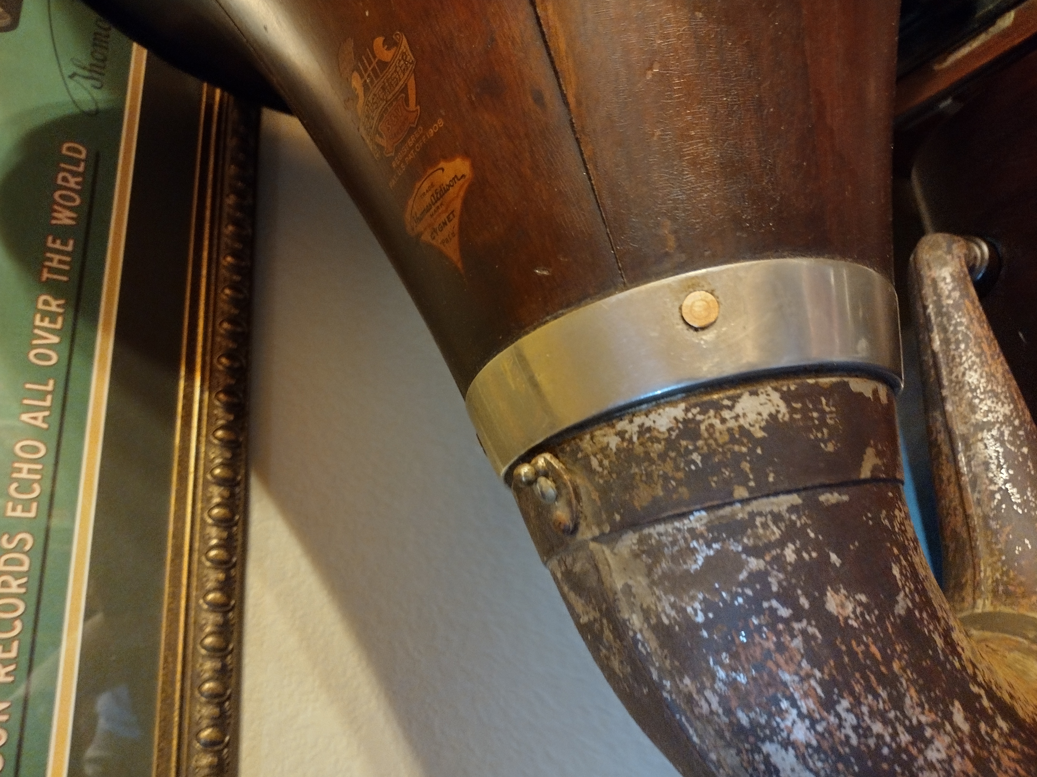

Ok here is a pic of the horn...I believe you can see enough of the elbow to see its in rough shape. Thanks for any suggestions. James ps sorry pic is sideways this is my first pic here and second posting!

Here is a cheap, simplified technique that would work fine for your horn. Just try to match the colors to the wood portion.
Remember - you can't ruin it (it already is) and you can re-do it until you like it...
https://www.youtube.com/watch?v=CIZZfzCVmLo
PS: My previous comments were tools for oak graining - mahogany is easier since it is fine straight grain...

Thanks Curt....I enjoyed the videos....will try it, as you said I dont really have much to lose since it's shot already. Thanks for all the help folks. Have a great 2024! James Manker
