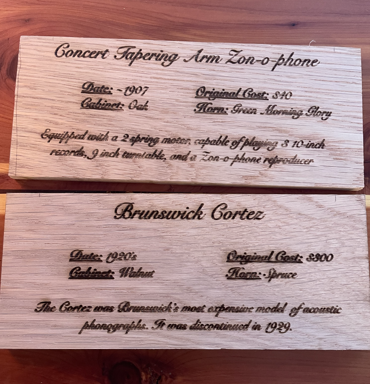

I want to make plaques like the one shown below for all of my machines. I need help making sure that the dates I am putting on the plaque are actually correct, as I don't know most of them.
I know Brunswick Cortez's were made in the 1920's and production stopped in 1929. I also know that not much dating info is there for brunswick's, so I am OK just putting 1920's for this one if there is no approx date for it.

I am not really happy with how the first two turned out. I think I will stain, grain fill, and finish all the pieces of wood and then burn them on the laser. This should make the words stand out much clearer. If I stain the pieces after they are lasered the stain will go down into the groove where the words are. I also think a less fancy font will be more readable :lol: :roll:

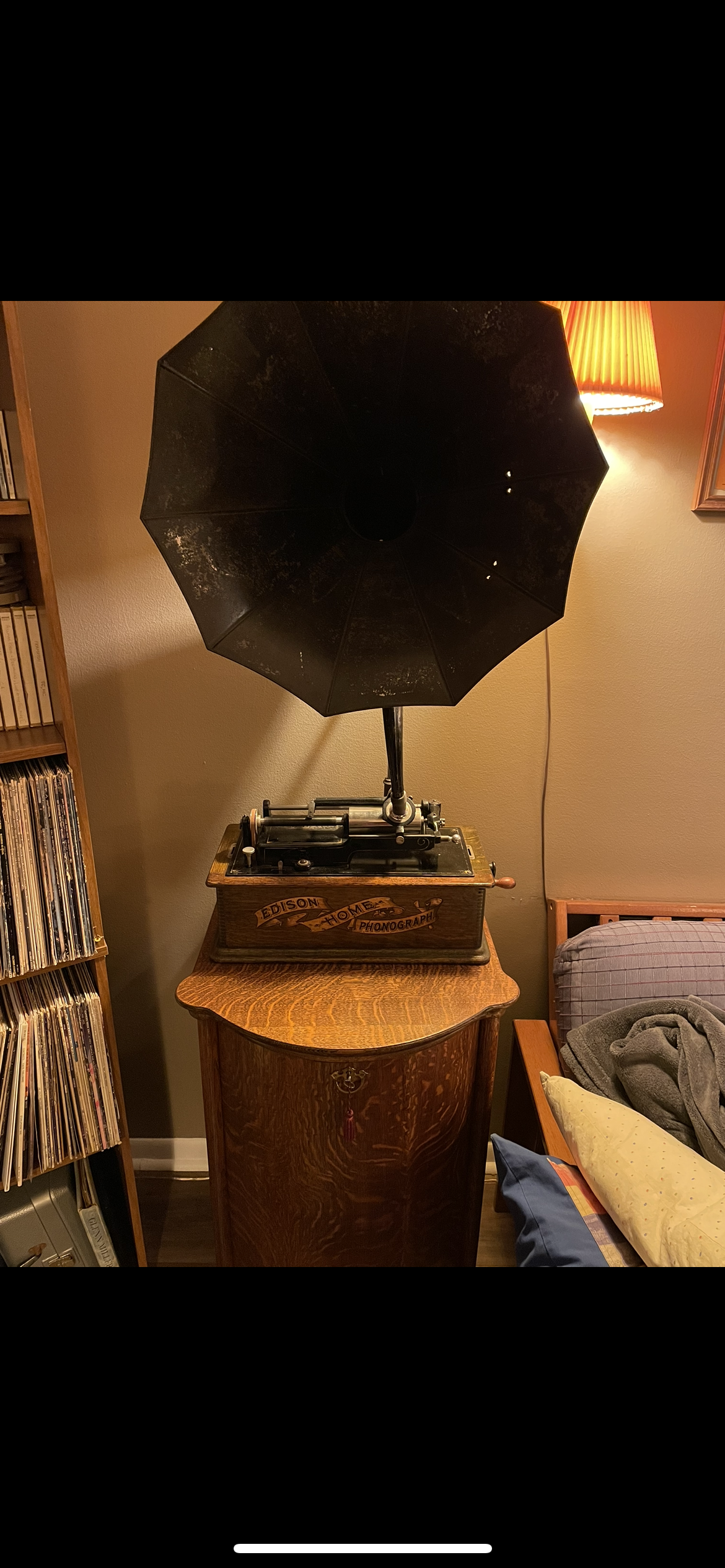

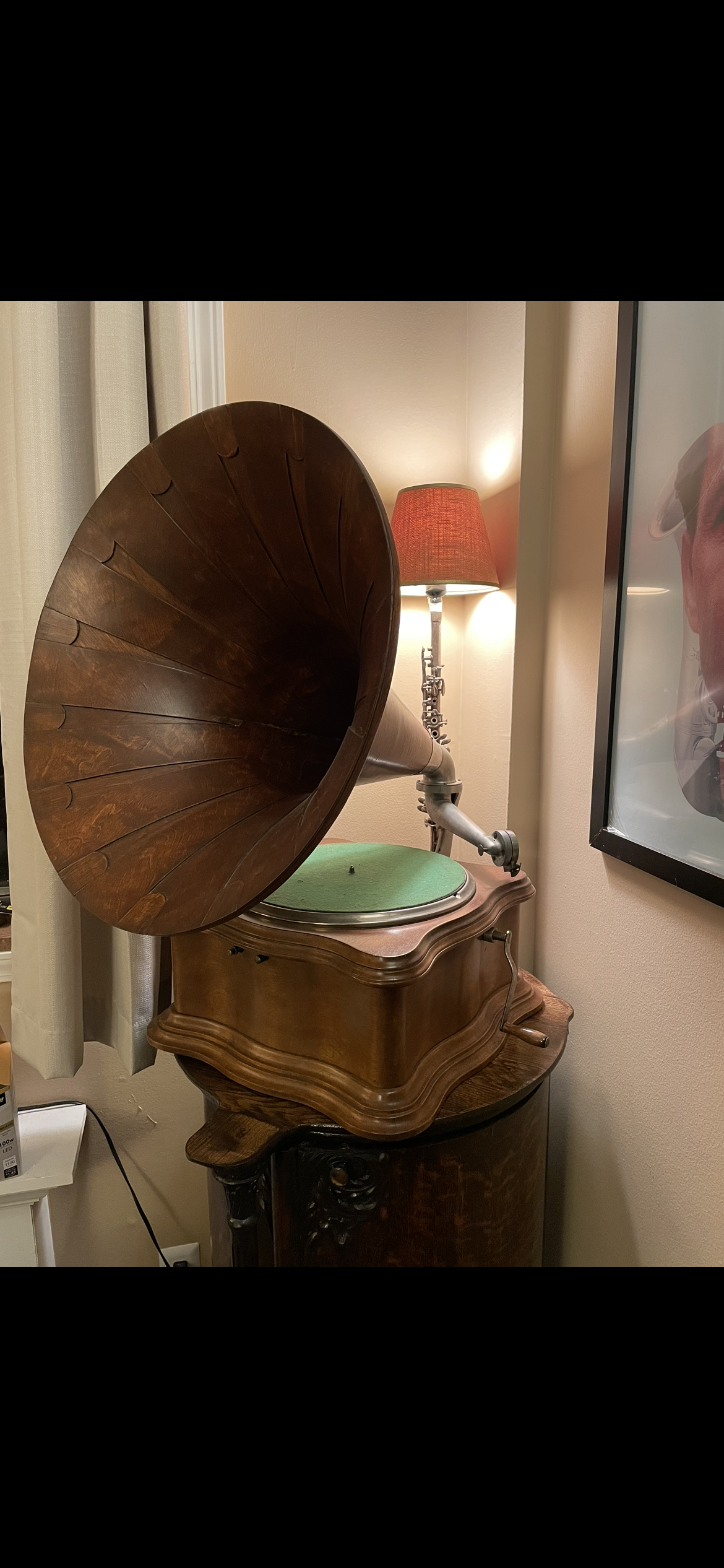

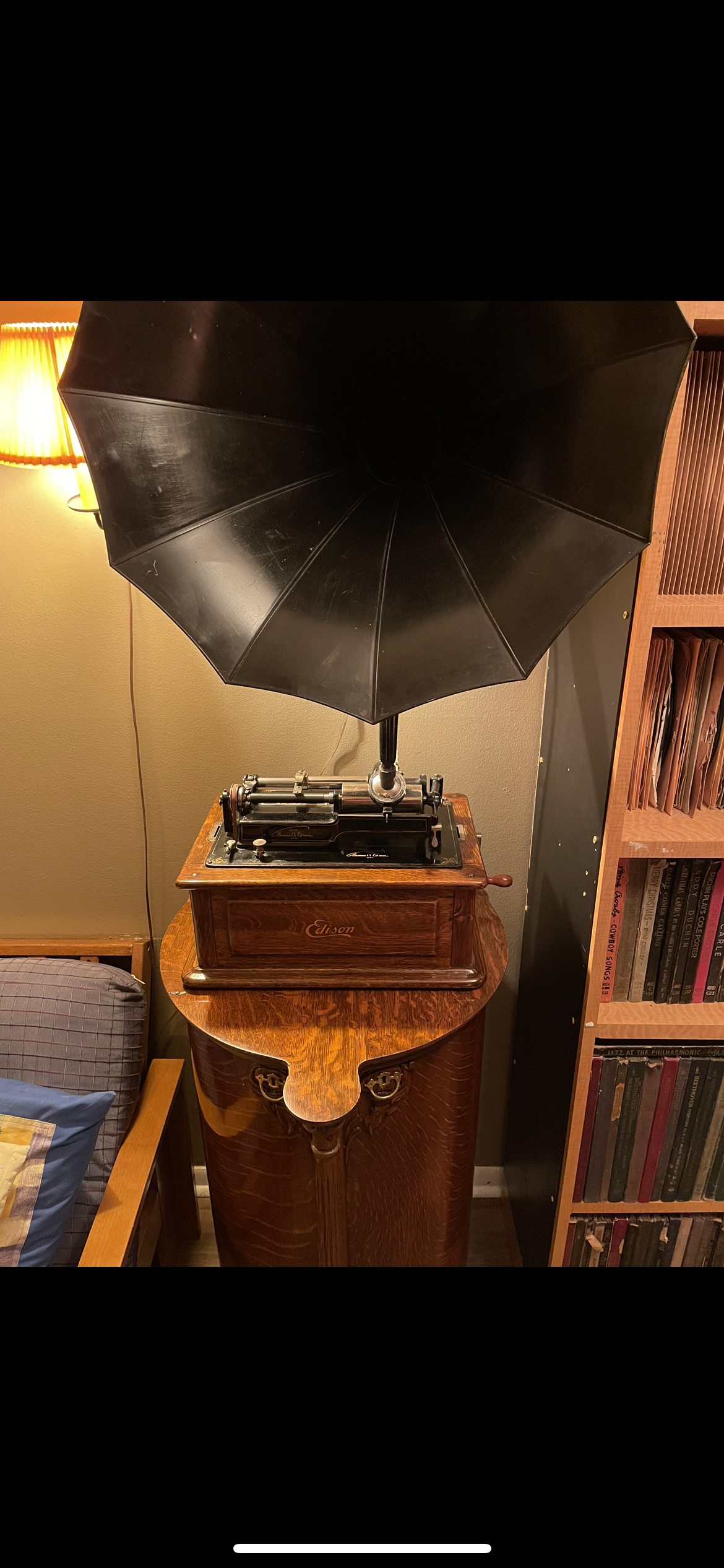

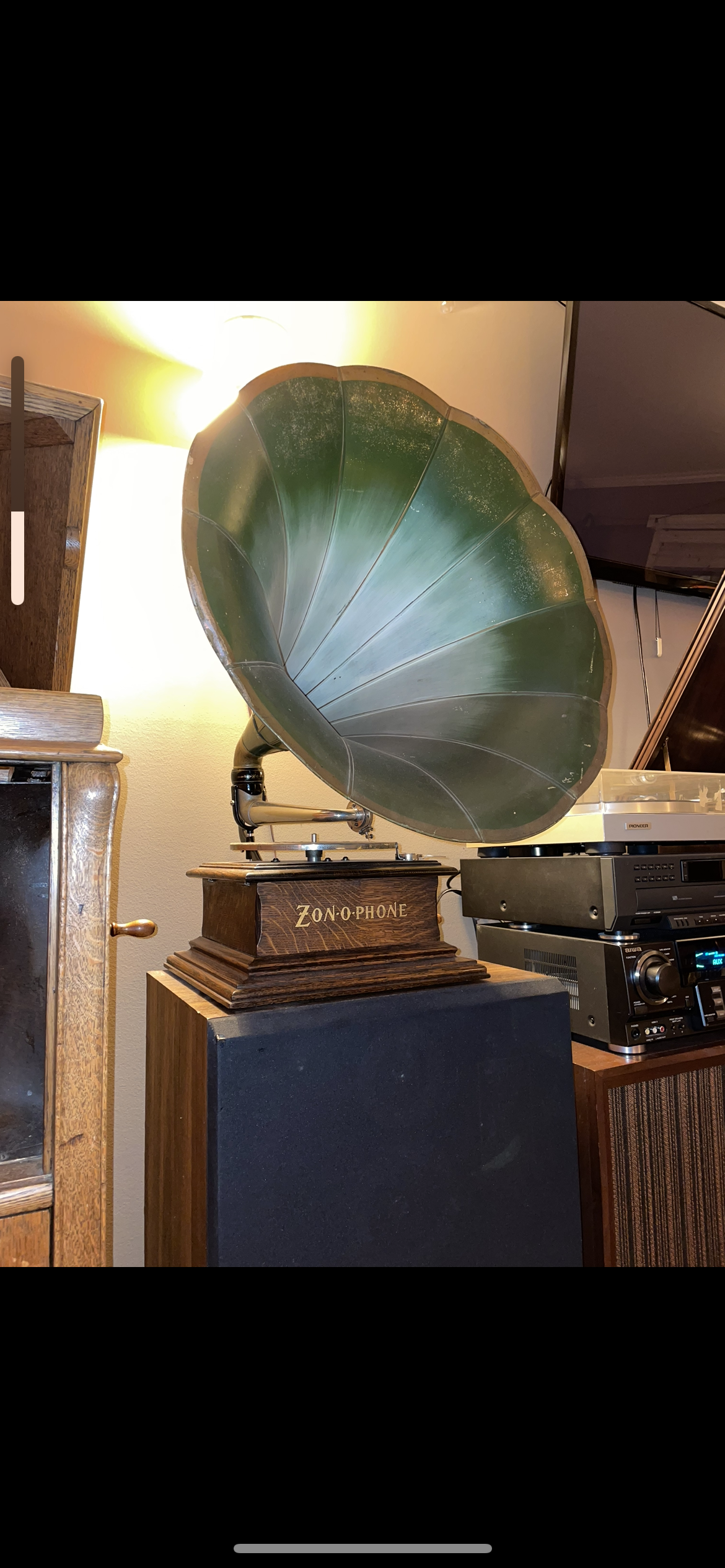

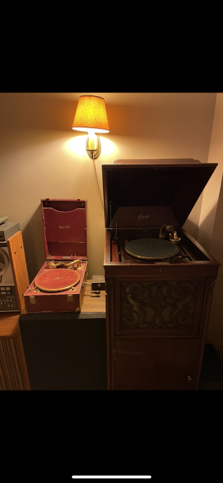

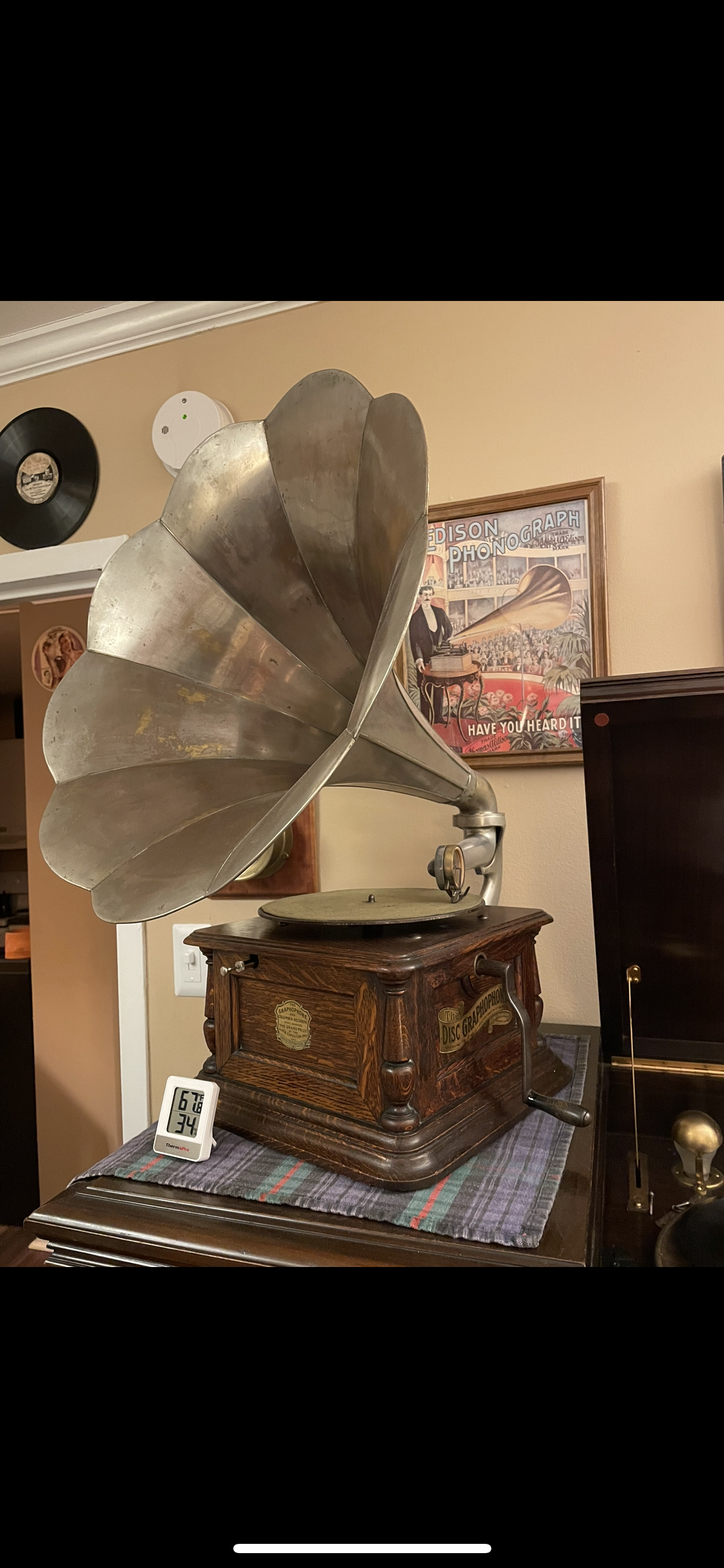

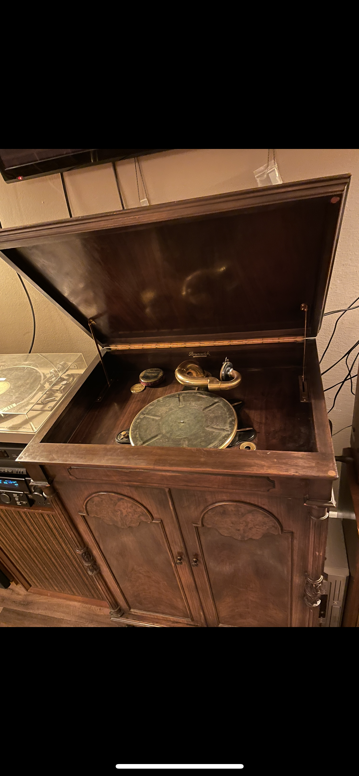

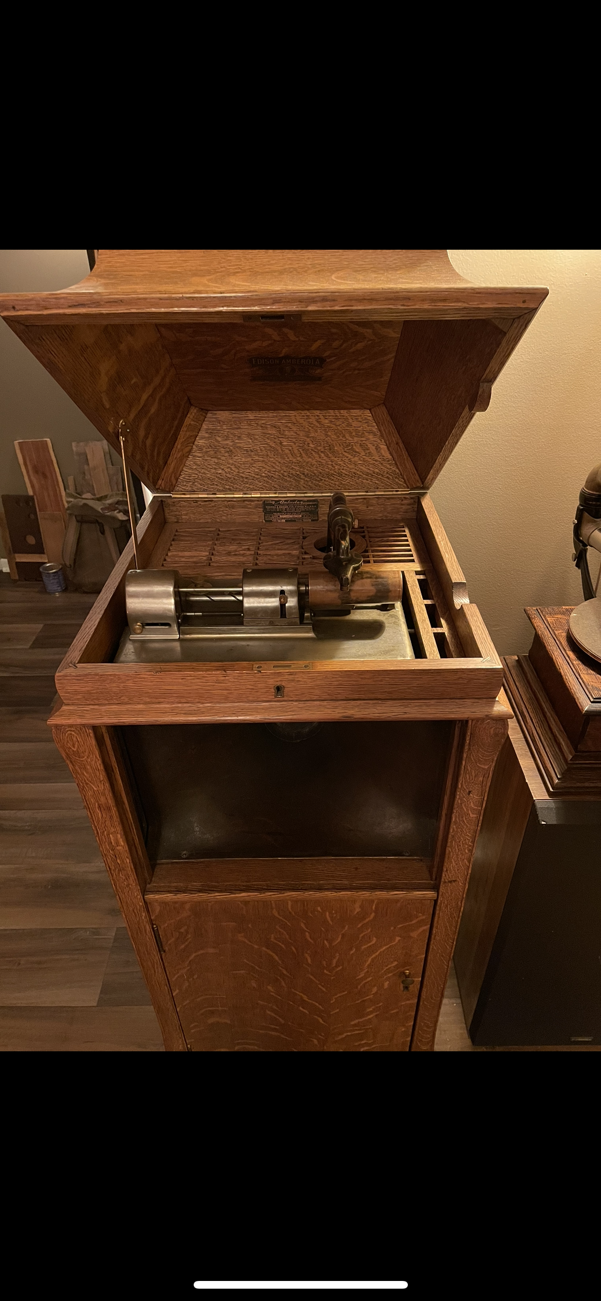

Sorry bout that George! Here’s some photos
I believe the triumph is a Model B and yes the Edison Home is a model A. Let me know if you need anymore additional photos. The A1 is unfortunately missing the grill... but it should have the Lyre grill right?
I apologize for not including photos earlier... I was in a bit of a time crunch :roll: :oops:
David
Posts: 8085
Re: Need help dating some machines
David,
Your Triumph is a Model B.
Your Amberola IA is in the early Weber cabinet, with the early style interior grille, but with slightly later locks. I believe this is a Herzog or Saginaw-manufactured cabinet (3 louvers on each side) which originally had either the transitional grille or the "urn" grille common to the IB. (If the longest of the 3 louvers is 9", it's probably Saginaw. If 11", it's probably Herzog). This Amberola dates to 1910, but the Diamond A Reproducer is of course later.
