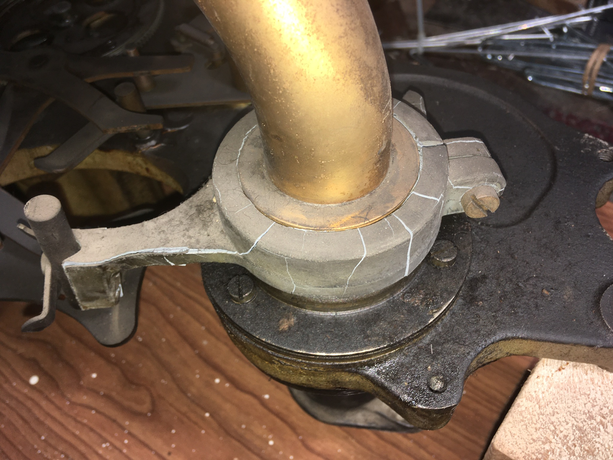

- Posts: 472
- Location: Silver Spring, MD
Re: Repair Pot Metal Reproducer
The big problem is that a pot-metal part made prior to 1930 is that it never stop expanding. I have 1927 Victor changer parts that looked okay 30 years ago that are now hopelessly cracked and swollen out of spec. The post attached to the potmetal casting pictured here was vertical at one time. The only real solution is replacement. Advances in metallurgy in 1930 make some parts stable or repairable. For example, the potmetal Orthophonic soundboxes labeled RCA are almost always good.
Mark
