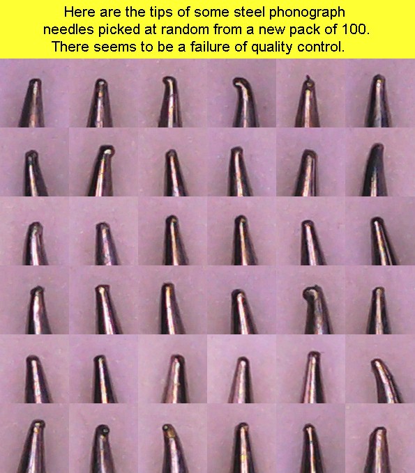

I recently bought some funky needles. The tips appeared to be simply sheared off with no attempt to smooth or round them.
- Attachments
- Poor quality control…
- 677E7AA7-DA22-4965-BB65-43186E3C7A47.jpeg (111.84 KiB) Viewed 657 times

That's disgraceful!CDBPDX wrote: Mon Jan 29, 2024 4:51 pm I recently bought some funky needles. The tips appeared to be simply sheared off with no attempt to smooth or round them.
