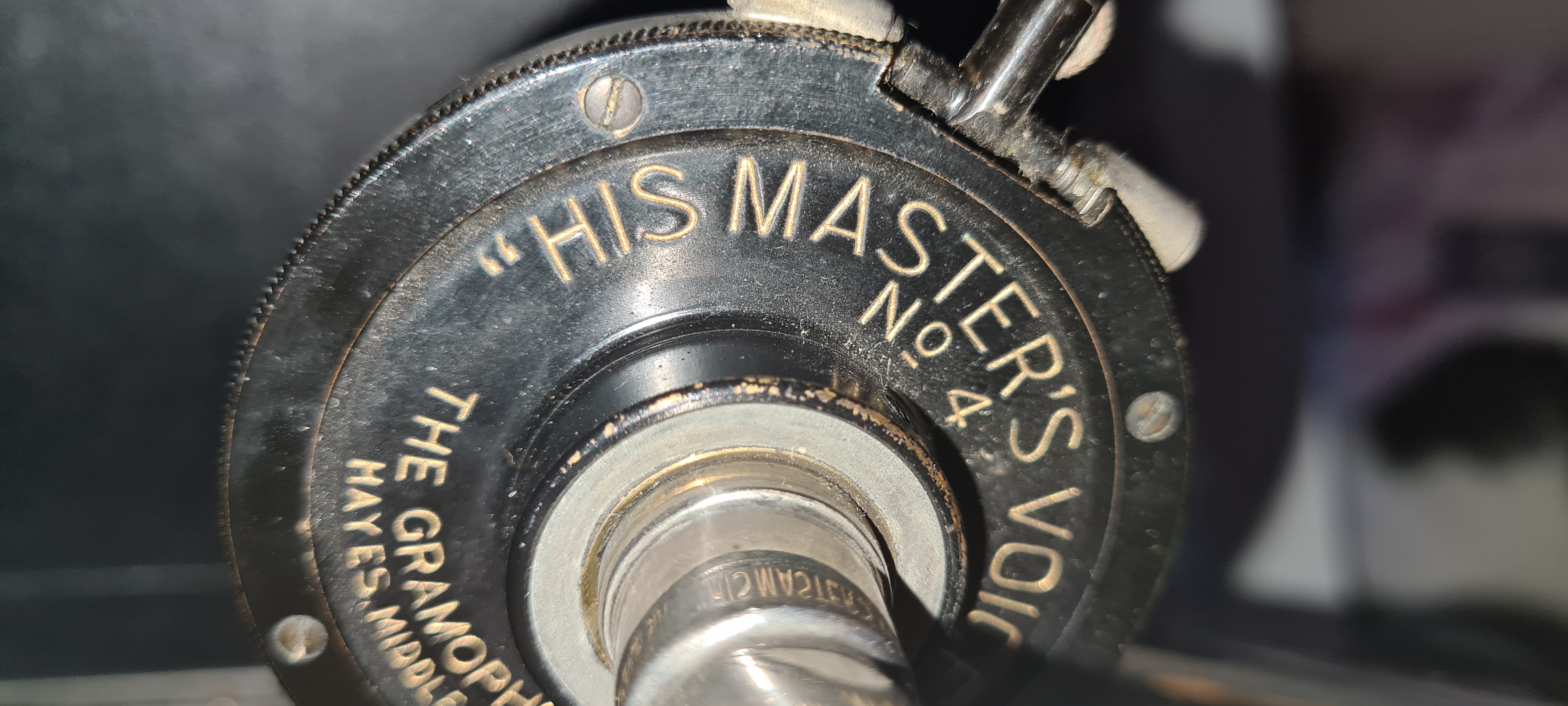

HMV identification possible 101?
I have a new arrival, nice u it and working fine. Just no id label or tag.
The sound unit is a No.4, the winder screws in, and it has a brake and speed adjust. The recess looks like other 101's
Any ideas if an old 101 or early 102, etc?
Regards
Brian
Regards
Brian

- Posts: 4675
Re: HMV identification
And seems of the intermediate era, not the latet ones, as it has the clips for the crank under the tonearm, and probably the old style motor, not the enclosed no59 but the former one (type 410 was it?). Does the soundbox carry the lettering at the back or it can be seen through the front mica?
Brian C
- Posts: 4
- Joined: Fri Feb 09, 2024 9:42 am
- Personal Text: Reenactor
Hello Hugo
Nothing seen through the mica and has the wording on the back with No.4 on it. Photos attached.
I was thinking a mid 30's unit?
Regards
Brian.
Regards
Brian.
