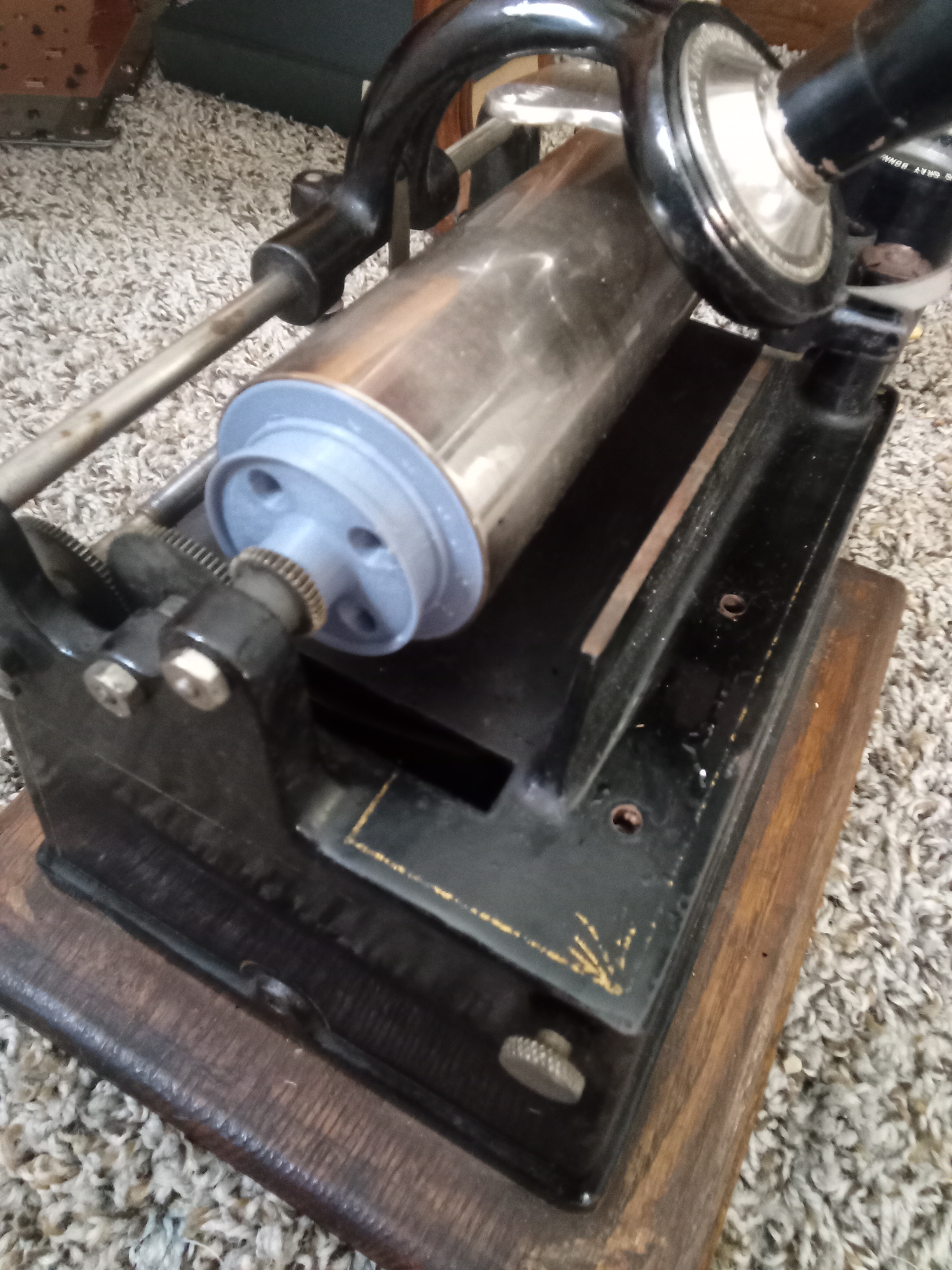

Hey @dzavracky there was 3d printing mentioned in this thread, engineering, and records. Any chance you could work your magic again?
