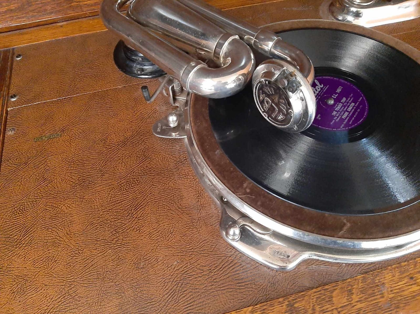

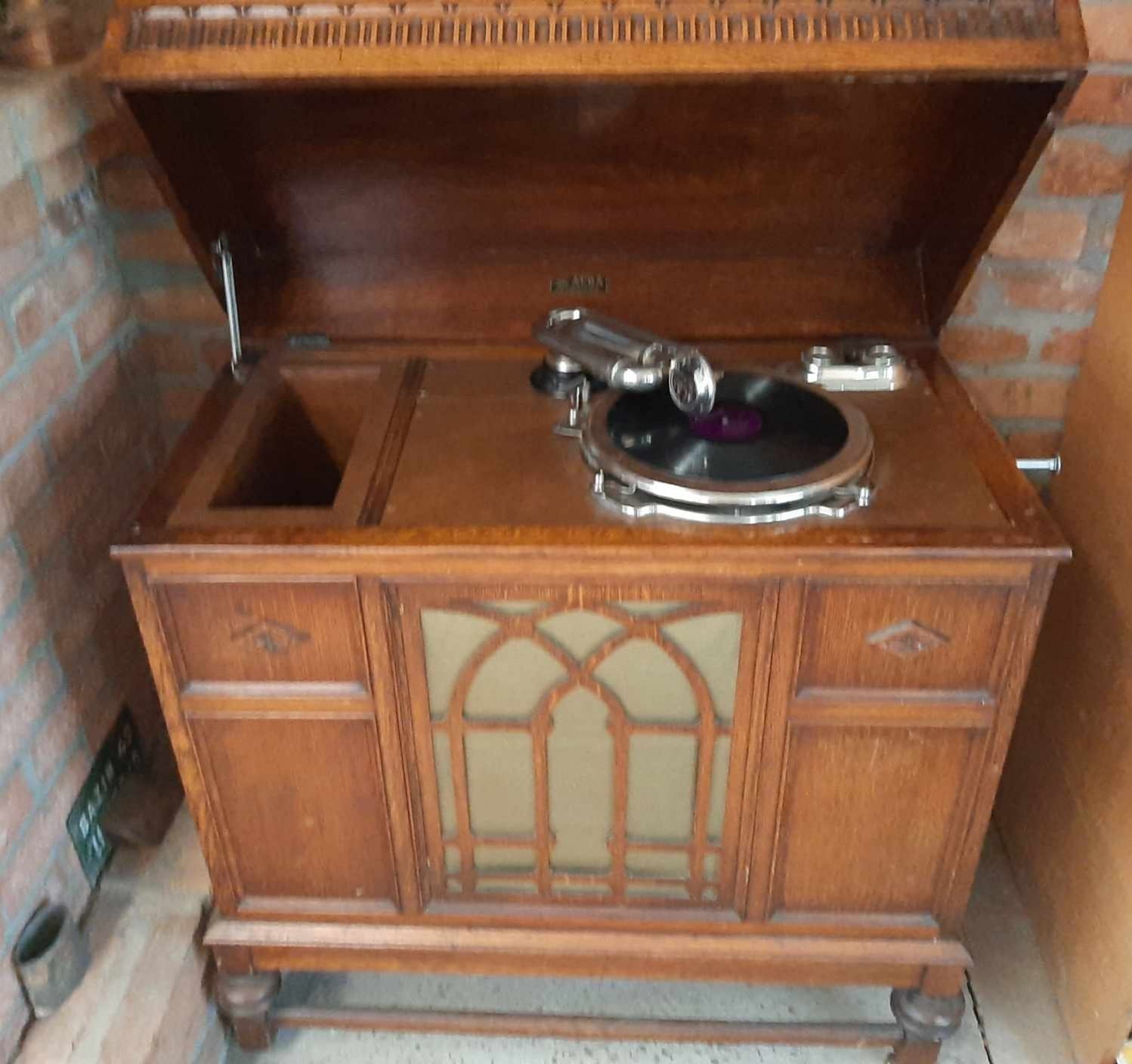

Hello

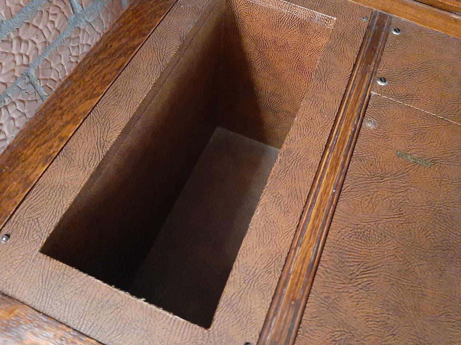

I have found a gramophone for sale from Alba. I have not find too many info on these specific one , i thought it me be rare due to it unusual tone arm shape. Year of manufacturing could be from 1910-1926 or so.. The selling price is around 1100 euro ( in Europe) , what do you people think about this, it is worth buying it? Any idea of what model this is?
Thank you and Regards
P.S I have attached also a video with the gramophone, it sounds pretty good..

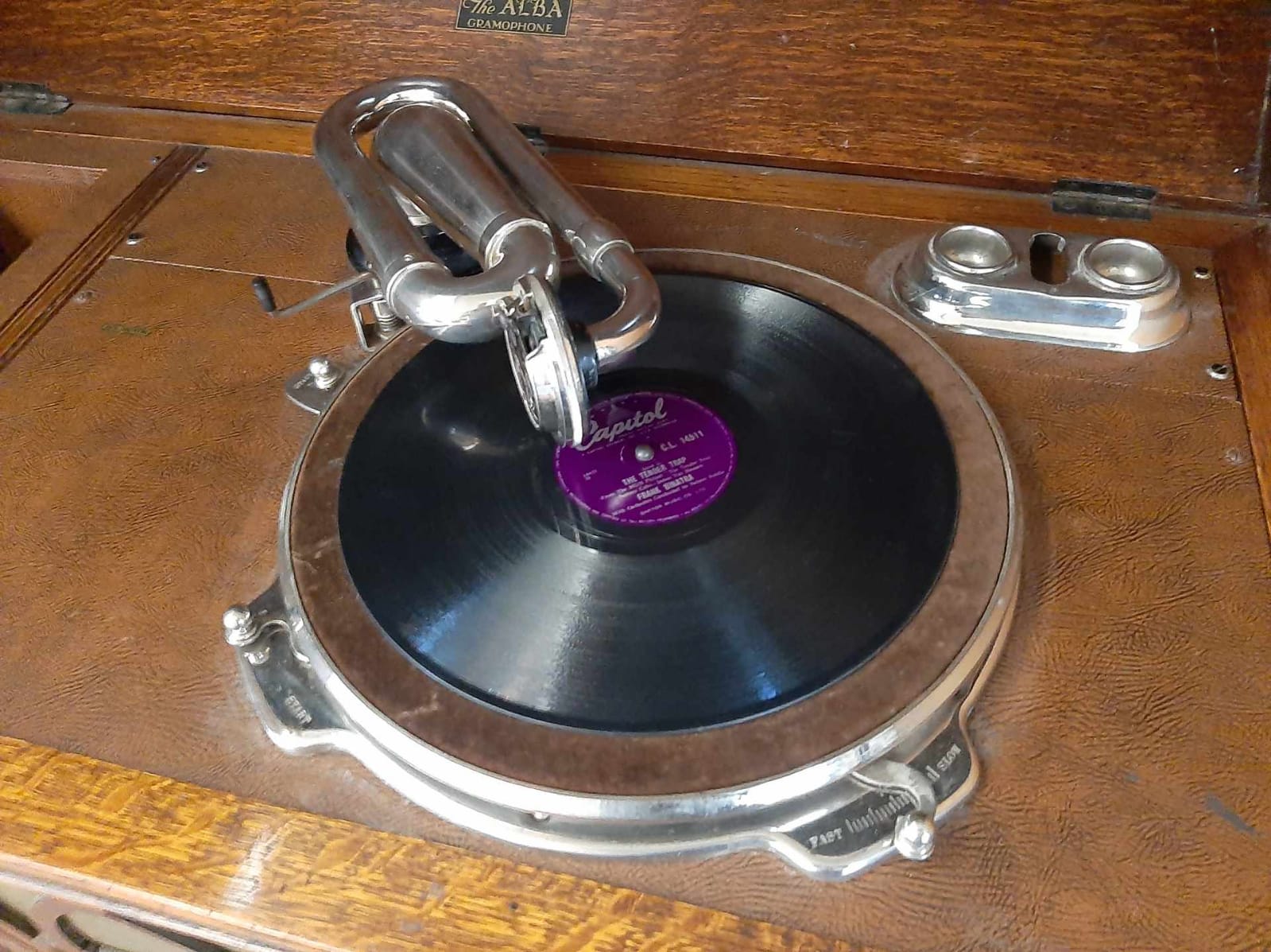

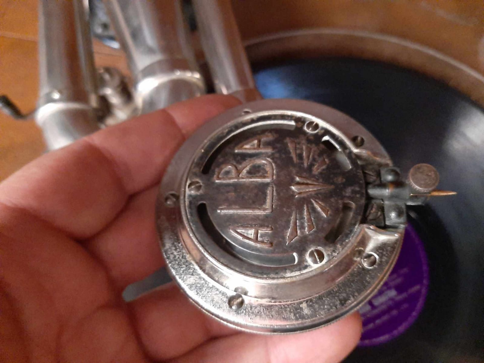

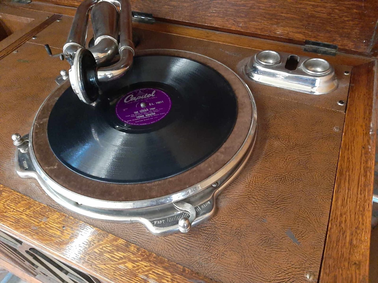

Excellent and adjustable Paillard "Alba" soundbox, excellent tone-arm and superb Garrard or possibly Collaro (?) motor. The cabinet appears to be good quality too but, the horn is quite small. It should sound quite good but will be limited by the size of horn. With that said, valuation on the Euro continent is very difficult to determine. Certainly in the UK this would struggle to raise more than an eyebrow at auction. It wouldn't make £50 on a good day, sad to say.
On the continent it can't be common so it's a very personal choice if you like it. The cost of shipping from UK would be astronomical so you're saving that at least!

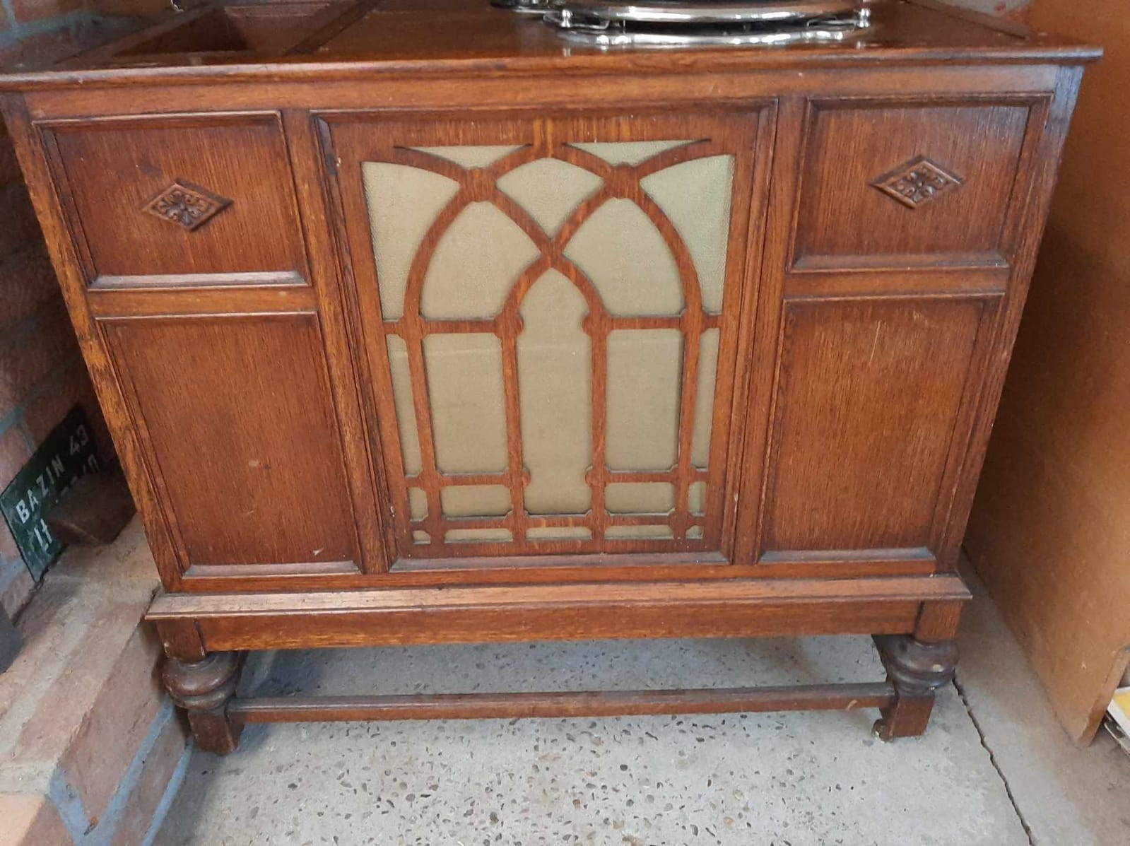

It is an unusual machine, with an arm resembling that of the Gilbert, but there is no market for such cabinets, be it in the UK or elsewhere. It may stay forever for sale, as I have seen with many gramophones of this size, or as Steve mentioned, someone with particular interest in an original piece may want to buy it, despite its astronomical price. And unless the buyer is willing to pick it up, shipment of such cabinet across Europe is not cheap neither.

One other issue I've noticed (and I could be wrong), is that there are castors fitted to the legs which I don't believe would be original and it looks to me that the legs might have been truncated during the process? I would have expected the legs to look a little taller and to extend further below the stretcher.

The tonearm is a "Novaphonic", also available to purchase separately :
viewtopic.php?t=54329&start=10

Steve wrote: Wed May 01, 2024 10:17 am One other issue I've noticed (and I could be wrong), is that there are castors fitted to the legs which I don't believe would be original and it looks to me that the legs might have been truncated during the process? I would have expected the legs to look a little taller and to extend further below the stretcher.
I agree. the legs look far too short. I also could be wrong, but to me, that leather cloth interior looks very suspicious!

It's hard to be sure with items like this we don't exactly see every day but I have a similar period Apollo cabinet machine with the internal record storage "bin" at the side of the turntable and that has the same identical rexine covering inside it!

Steve wrote: Thu May 02, 2024 4:15 am It's hard to be sure with items like this we don't exactly see every day but I have a similar period Apollo cabinet machine with the internal record storage "bin" at the side of the turntable and that has the same identical rexine covering inside it!
Thanks for that Steve, if I had examined the rexine to the right of the record bin a bit closer I would have spotted the small transfer that surely is original.
