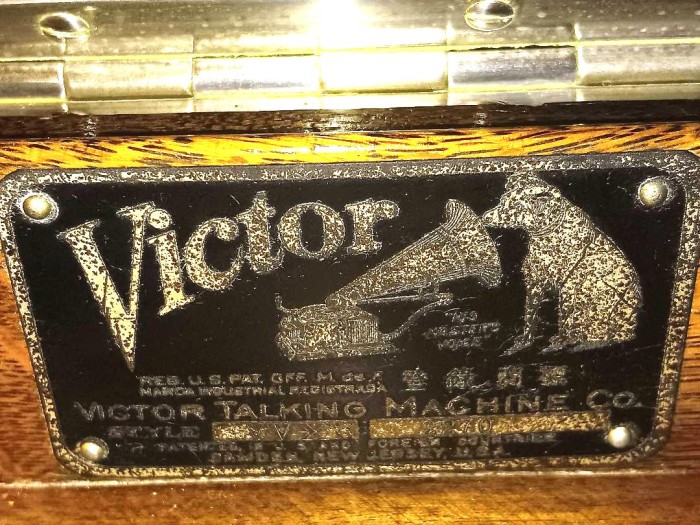

This is perplexing me because I own an early table top VV-X (S/N 2470 dating it to 1910) that doesn't have its original key. Other Victrola keys don't work on it. It seems that the part of the lock that goes into the hollow key barrel is too thick and as a result common Victrola keys don't fit.

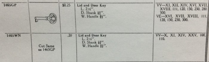

MarkELynch
- Posts: 562
- Location: Silver Spring, MD
Re: Did early Victrolas use a different cabinet key?
Thanks for listing your Victrola model and the serial number.
According to the Victor parts listing the common key Part Number 1465WN is specified for your serial number. The WN suffix refers to the white nickel finish as contrasted with GP for gold plated. The specs are the same other than the finish.
Here are the dimensions. If you have 20¢ and a WayBack machine you could go pick one up from your dealer.
Mark
Mark

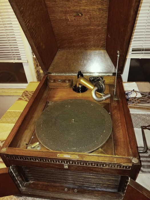

Here's a view of the early VV-X. It could use cosmetics but I'm not interested in restoring it; I just want to preserve it.
You may be able to spot the very tiny tone arm base screws...
