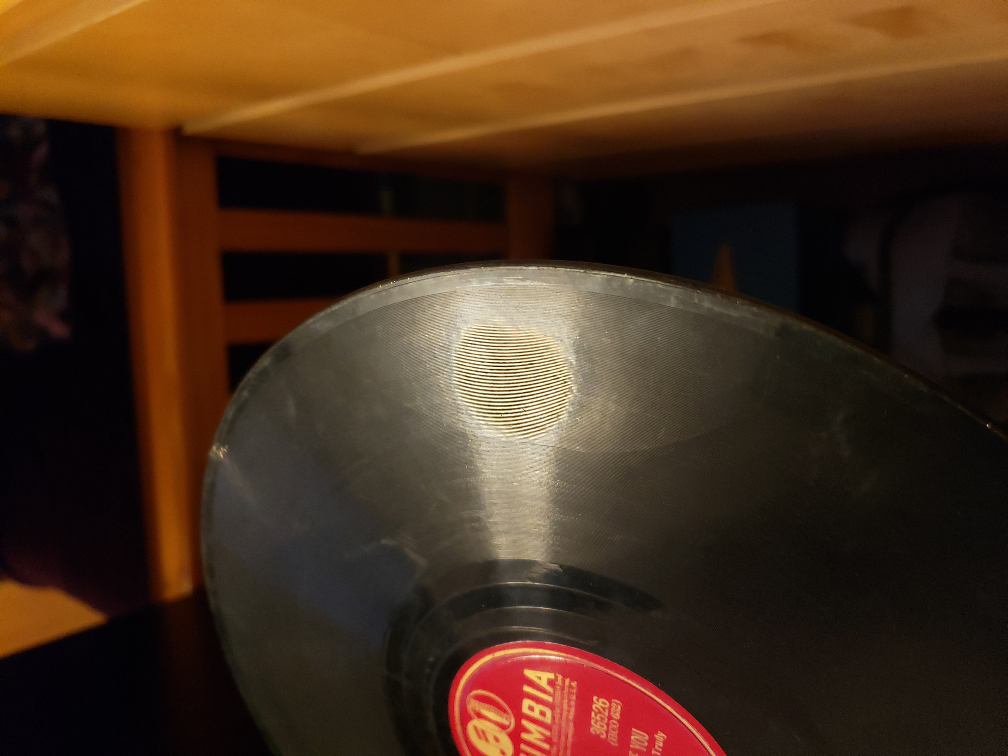

I would imagine warping would make it more unstable, and that comes from another experience I had. Tonight, the record I broke dropped 16" (I measured from the shelf it fell off of). A year ago, I dropped a Kay Kyser record from my chest height (probably 4 feet) trying to get it out of a torn up Columbia sleeve, and it landed on my big toe! Impressively, no piece broke off, but I can see a line (probably not there before) on the A-side only. Did it hold up better because it wasn't warped? Did my big toe "break the fall?" Or is this something that can only be explained by pure luck/chance?

The Columbia didn't break because it is laminated with layers of tissue paper under both faces. Look for Columbia New Process records of 1923 or Columbia laminated pressings in Google, or in the record sleeves or catalogues.

Columbias have their own stability issues. When stored in unsuitable conditions they can begin to de-laminate.Inigo wrote: Wed May 15, 2024 12:34 am The Columbia didn't break because it is laminated with layers of tissue paper under both faces. Look for Columbia New Process records of 1923 or Columbia laminated pressings in Google, or in the record sleeves or catalogues.
