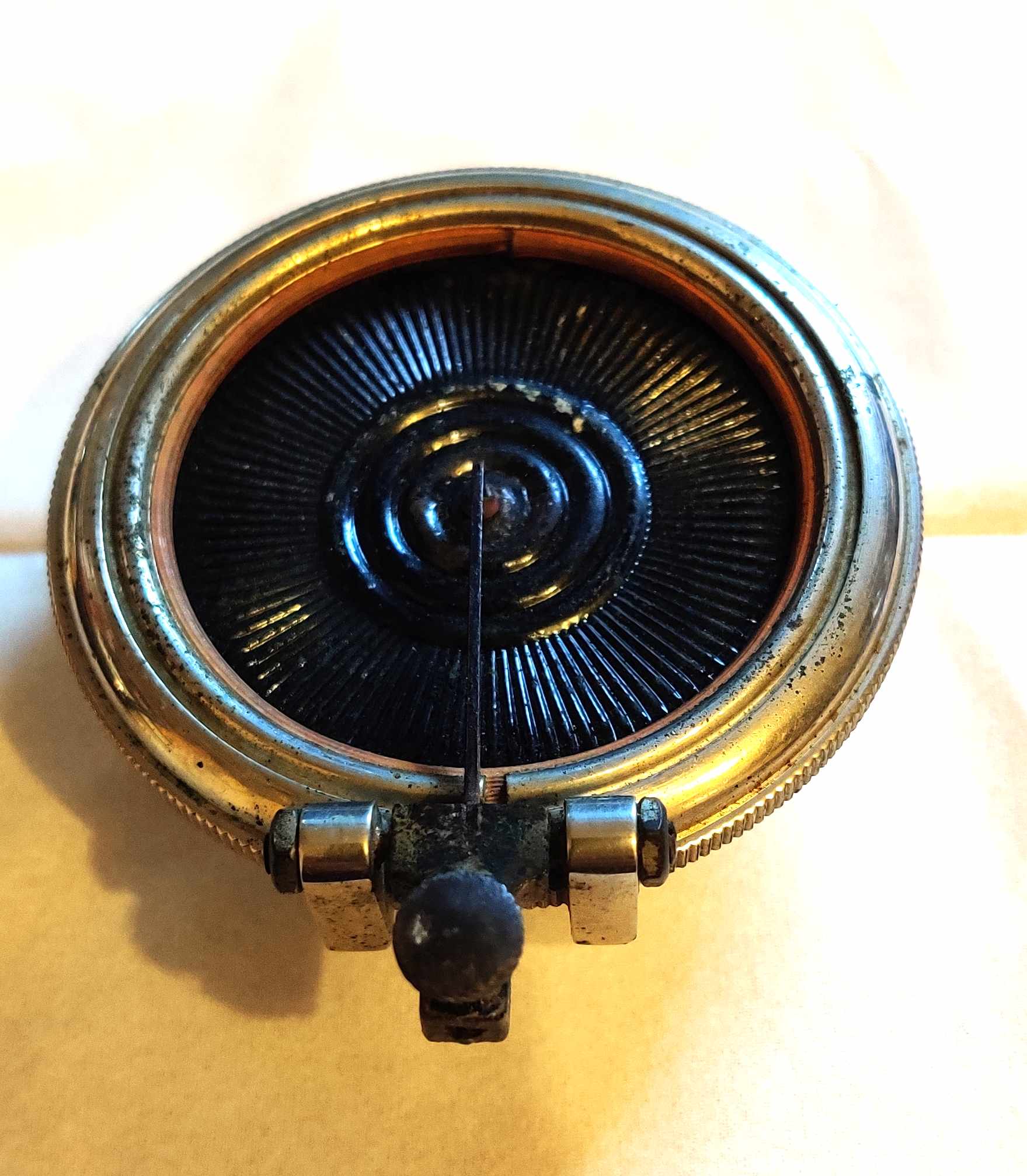

I am servicing a 1911-1912 Columbia Grafonola Favorite with two front doors.

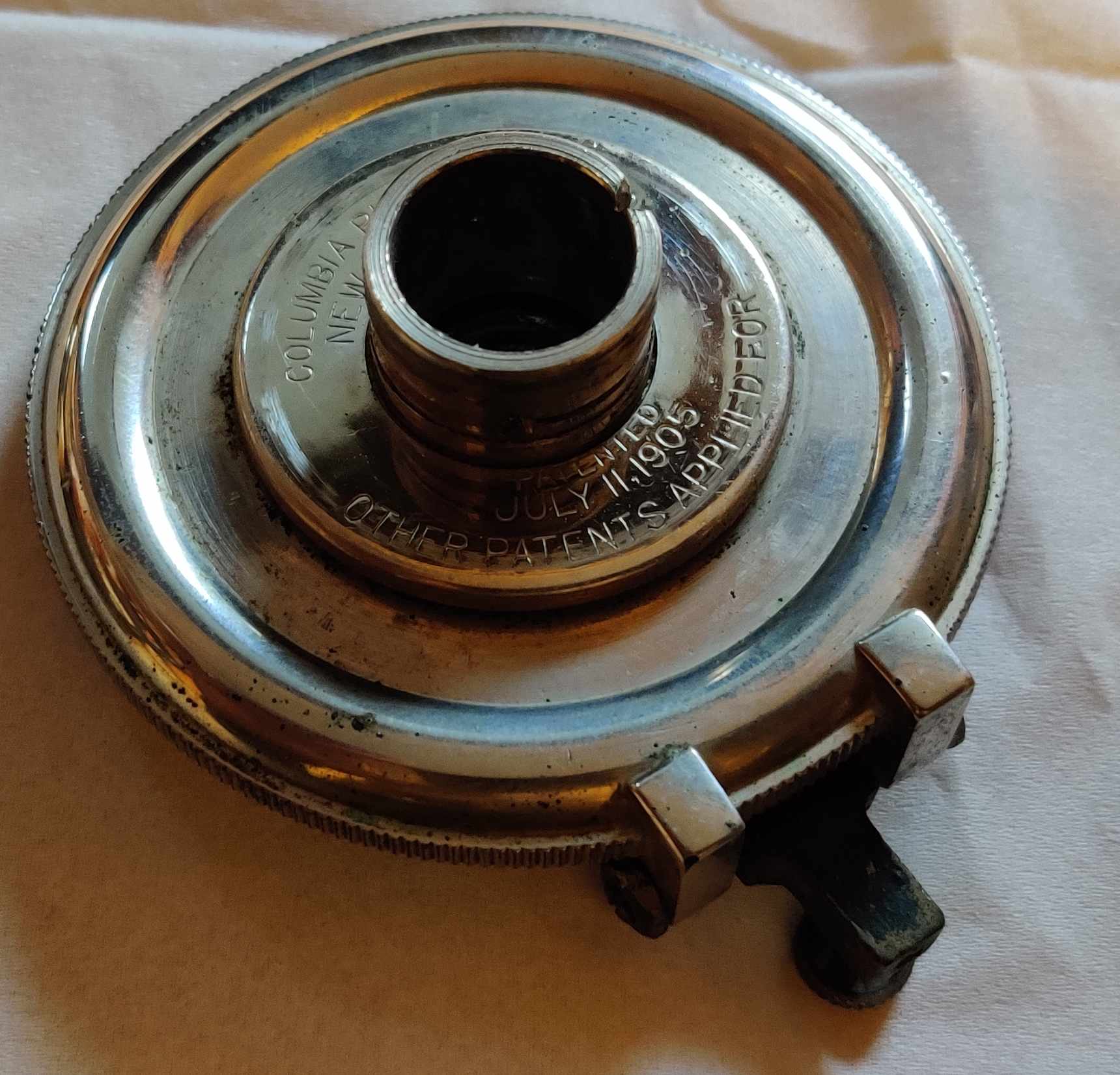

It's all original but two of the three motor springs are broken. I've replaced all three and am now rebuilding the reproducer. My question, surly this should have a mica diaphragm?. The reproducer is marked patented 1905. I've checked for images of other Favorites online and was surprised to find that the ones I have found have the same black painted aluminum diaphragm. I am assuming this was a common upgrade offered by Columbia around 1925. Can anyone confirm my suspicions.
Thanks

Not sure it was an upgrade. It's the proper diaphragm for that reproducer. As the to whether or not it's correct for a Favorite I can't say. I have a Columbia BII that has the same.chunnybh wrote: Wed May 15, 2024 3:36 am My question, surly this should have a mica diaphragm?. The reproducer is marked patented 1905.

I've read "Modern Gramophones and Electrical Reproducers" so many times and still didn't notice this soundbox. The diaphragm is way ahead of it's time with the intricate ribbing and rings. The only downside seems to be the black paint on both sides of the diaphragm, which would have dampened it. Looks like the diaphragm was dipped in the thick paint. Odd how the later reproducers were still using mica. Must have been a cost thing.
