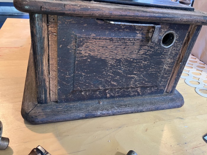

I don't know how part of a case could get torn away like this. Maybe it was yanked, and split, and missing bits discarded. Anyway, I don't have the bits. What do people suggest? Do I need a replacement base? In that case I am looking for a Triumph D2 base. Thanks for your suggestions.

To my thinking, you do not need a new base/cabinet. The problem is that the 2 corner pieces have sections missing. Those corners need to be neatly removed. At that point, you have 2 options. 1.) make replacement corners. 2.) repair the existing corners.
Number 2 option:
(Why go to the trouble? Because I like to save as much original material as possible.)

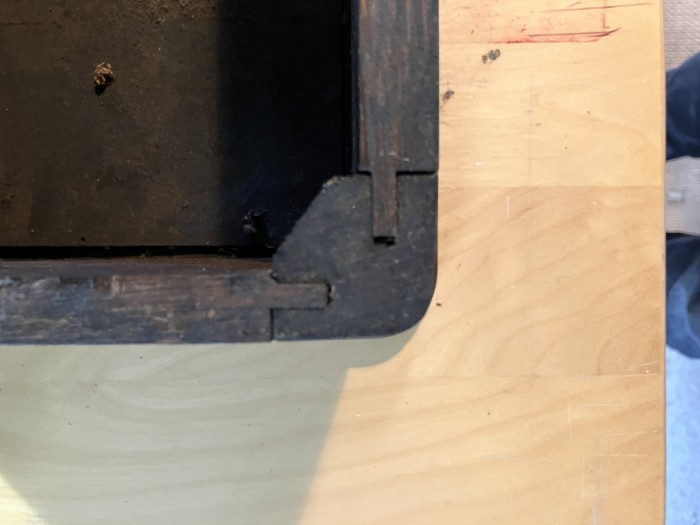

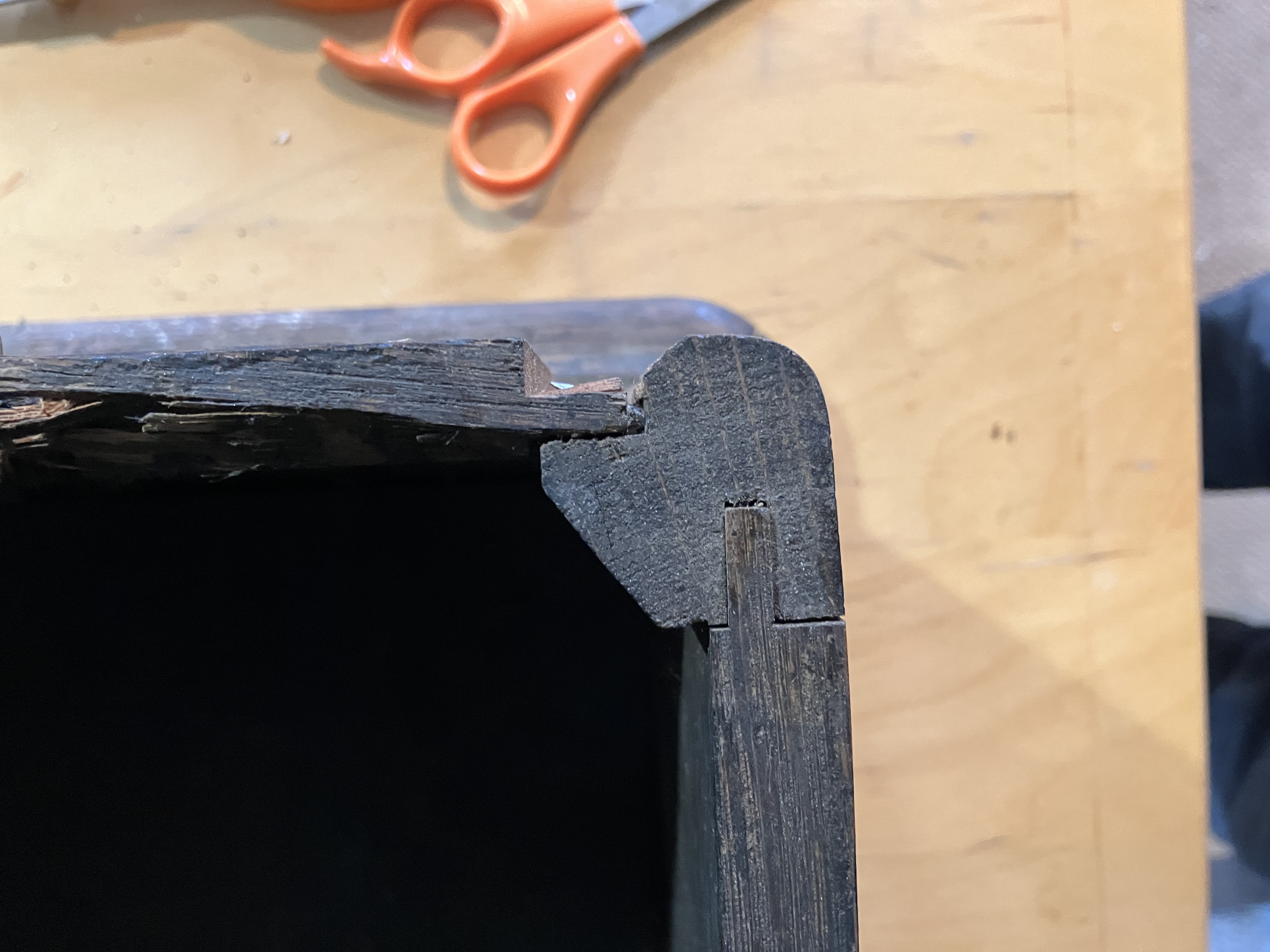

On the other hand, if someone just happened to have the remains of an old Triumph case, and it had three corners.... I think all corners are identical, some just turned upside down. One on the left has been screwed into, so that makes three damaged or with wood missing.
I may still go for the repair but am scouting options.
Pic attached here of what those corner pieces look like.

Anyone with a table saw and some dado blades can make that.
The dado grooves are cut first from a piece of square stock, and then shaped to fit the cabinet with a hand plane and "blocked" sand paper.
