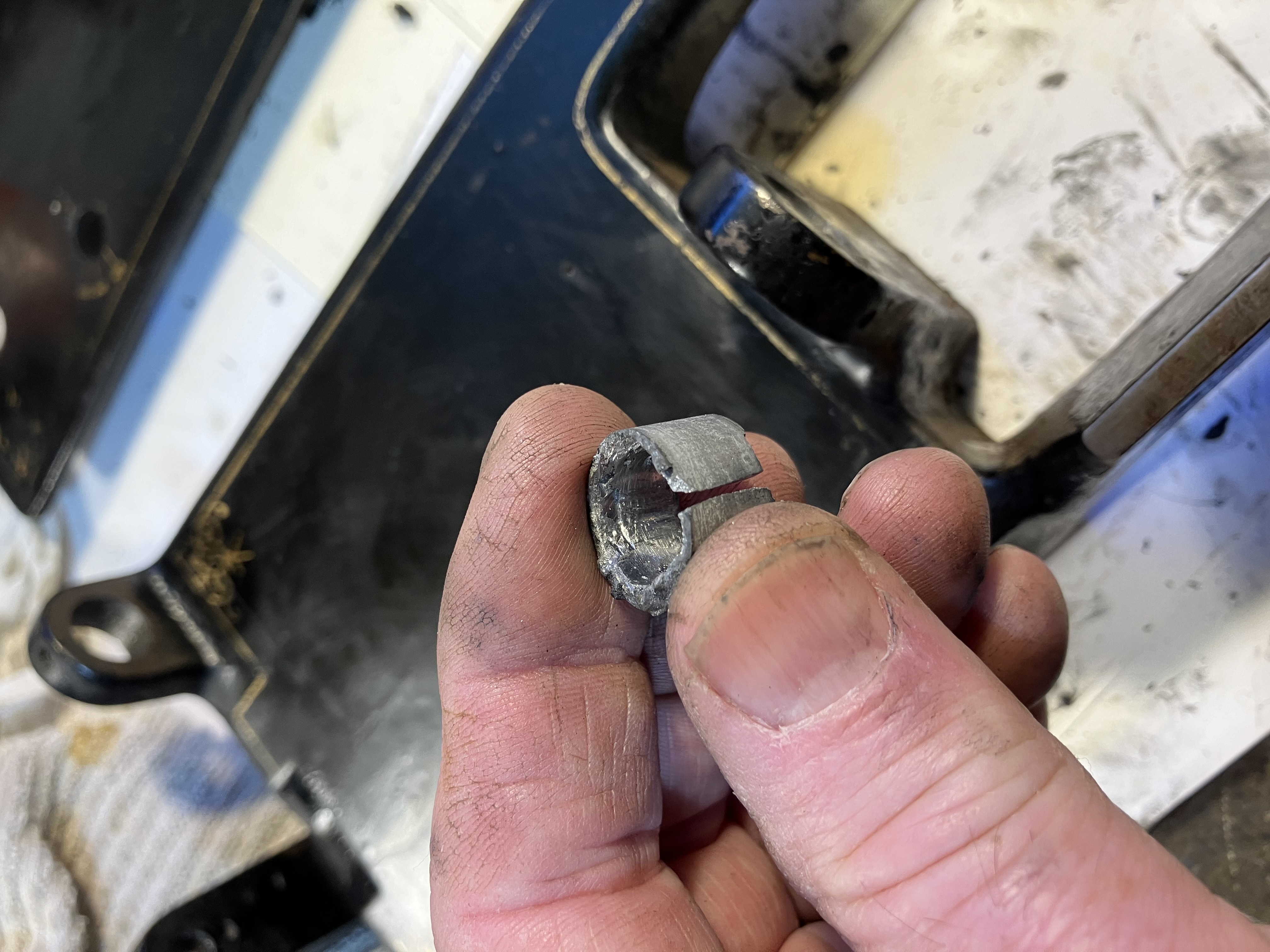

Triumph D stuck mandrel
Really frozen -- mandrel will not turn at all. Do I try to chip away parts of the pot-metal bearing?

mjbarnes
- Posts: 187
- Joined: Fri Jul 11, 2014 10:34 am
Re: Triumph D stuck mandrel
Thank you, Doug, and others who responded here and to my other questions in other posts. Before I pull off the mandrel I am going to keep dribbling muriatic acid through the lock screw hole and on the sides in hopes the pot metal bearing gives up. It is certainly chipping easily at the ends but I am afraid that inside the boss it will just remain tightly sandwiched.
mjbarnes
- Posts: 187
Knocked off mandrel with mallet and block, worked off shaft with vice grips and a rag around the shaft. Success. First turn is needed just to find the lock screws. And the belt pulley acted as if it was still attached even without a screw. WD40 helped.
mjbarnes
- Posts: 187
Brett Hurt's suggestion in a Youtube video was also very helpful about placing a hacksaw blade inside the hole and cutting a slot in the stuck bushing. Once the slot was complete the old bushing tapped out easily.
