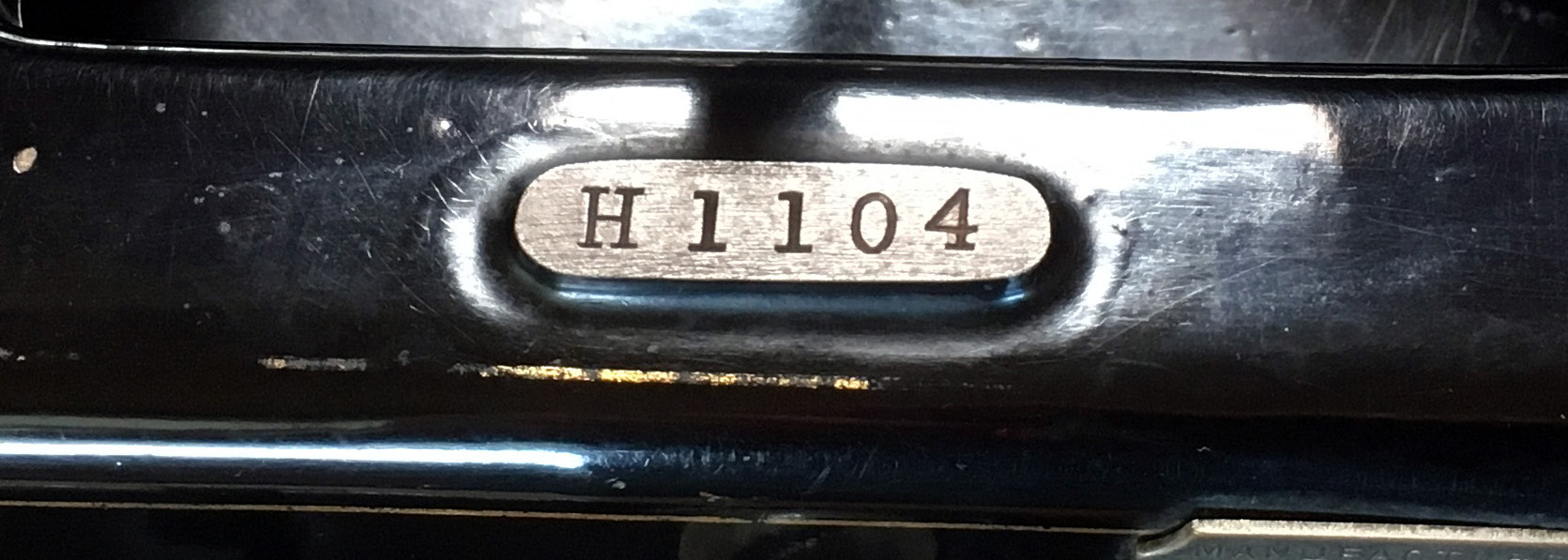

I possibly might get a 4 latch suitcase and put the works in it BUT something is telling me this is a very early “new style” but made with parts they needed to get rid of. BUT the 1898 serial number is the super perplexing part. This is only a theory. Maybe somebody with a first month new style home can set me straight?

I'm inclined to believe the theory you suggested previously -- "This could be a later 1898 to early 1901 machine that may have a forged serial number that was eventually housed in a new style case." As George pointed out last year, the font of the serial number doesn't look normal. It certainly doesn't look like any Home I have, or have owned in the past. Consequently I don't believe that was stamped at the factory. Compare the shape, spacing and size of the numbers in my pictures here against the one on yours, particularly the 4 and 8. They are very different.
It's entirely possible that the original number was filed off -- maybe it was a stolen machine -- and a bogus number stamped in its place to hide that fact.
Just a guess, but it makes the most sense.

As APS members can see in the current issue of the magazine, Home #5584 left the factory in March 1898. Yet, this machine carries a data plate with a May 31, 1898 date. Clearly, something is amiss.
Based on the unusual typeface of the serial number, I'm inclined toward the stolen/filed/re-stamped theory. Anyone who has read through The Edison Phonograph Monthly can attest that thievery was occasionally reported in its pages - including subject serial numbers. I suspect the machine had a colorful history.

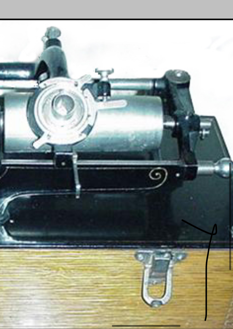

Ok this just got extra confusing for me! Apparently some suitcase models already had that pinstripe swirl on the knife edge and I even saw one with a S/N embossed on there too.

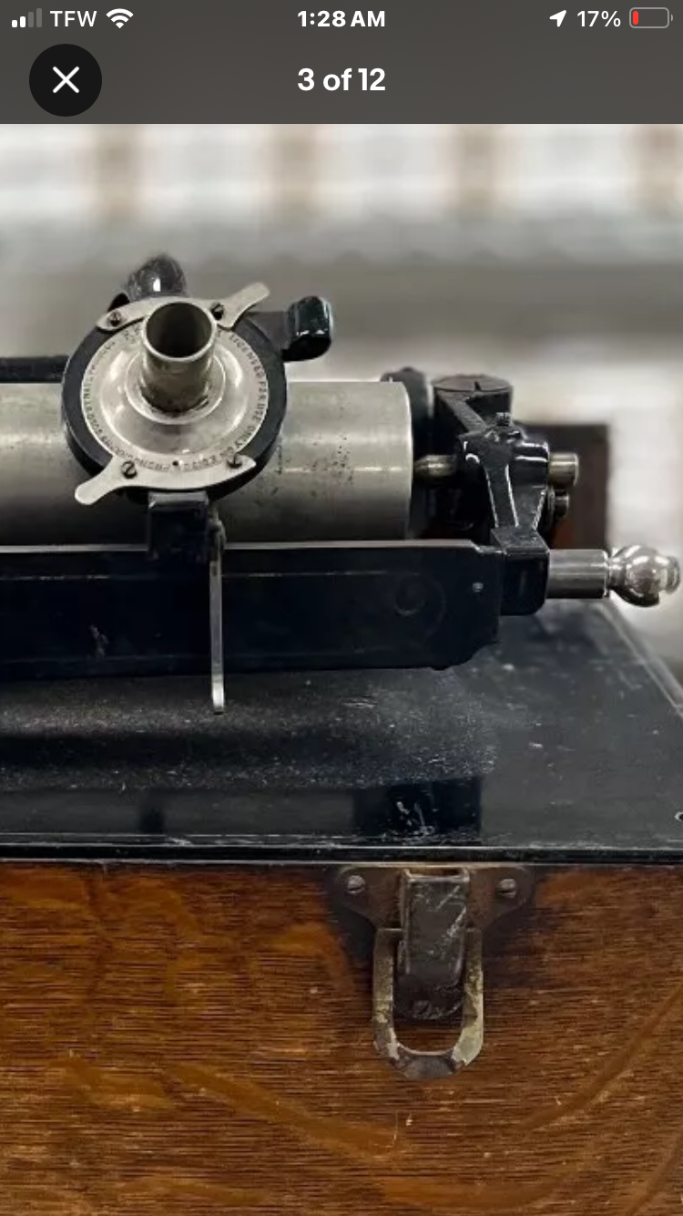

Ok, I think I do actually have an original suitcase model where both serial numbers were filed off, I’m scouring photos of Suitcase homes online including looking at eBay posts of any, and I see two machines that might fit the same timeframe of what I have here…these are possibly the same timeframe of what I have here which I’m guesstimating late 1899 early 1900?

Ok doing more research the badge was moved to the back in May 1899 and now with my APS membership renewed, I was able to determine the swirl was added in either November, December 1899 so in between that time period, (5/1899 to 12/1899) that’s when it was manufactured!
I will be purchasing an empty suitcase case to drop the works in and an automatic reproducer, and bring it back to its original 1899 roots!
