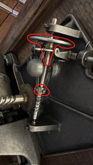

Re: A Vic III New To Me
Dischoard wrote: Sun Jul 21, 2024 7:04 pm Um, you’re absolutely right, that is not a Vic governor. Crazy that someone got it to fit. Is the Vic III governor specific or could I use one from, say, a VV-X donor which I happen to have ;)
Well, some of it is for a Victor. The governor shaft and the two weights are correct. The rest is from a Columbia, (I think). You need the third weight and the correct friction disc and the small hub. Hard to say if the governor springs are correct. At the very least, you need a third spring.
Dischoard
Posts: 687
Location: St. Albans, Vermont
Post by Dischoard »
JerryVan wrote: Mon Jul 22, 2024 6:33 am
That’s why I think the whole governor is wrong, it’s a two spring governor and they’re exactly offset from each other, there’s no space for a third spring and weight…

I suspect the governor shaft is correct; it’s the right length and the worm meshes with the worm wheel, so it looks to me like someone has replaced the other bits with Columbia or other manufacturers parts.
It may work as is, though you could change them to the proper Victor parts when you find them.

kiwiatlarge wrote: Sat Jul 20, 2024 9:35 pm Jerry is right that the governor friction part is wrong. From the photos, the rest of the governor looks right. I believe this is the right part.https://thephonographshop.com/products/ ... s=e&_v=1.0. The Phonograph Shop also has the governor weights and springs if you need them.
Michael
Thanks Michael, all these links you've posted have been great, I really appreciate you taking the time to look them up. I'm compiling my list right now and it's a doozie!
Dischoard wrote: Mon Jul 22, 2024 7:42 am
No. It's not the whole governor that's wrong. If the correct Victor parts were mounted on your correct Victor governor shaft, there would be a place for the third weight, (two of which you now have).
The circled parts are the only ones that are wrong.

JerryVan wrote: Mon Jul 22, 2024 1:37 pm
Right you are, I thought that screw was a set screw to attach that bottom collar but of course that collar has to be able to drift up the shaft.
Thank you, that really helps direct me in the right direction.
