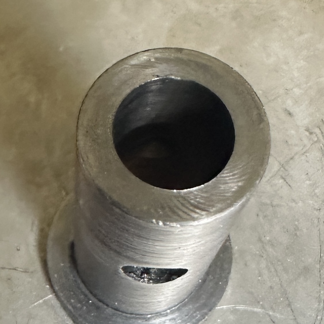

JerryVan wrote: Sun Jul 28, 2024 7:50 am opening up the hole to accommodate a brass sleeve will cut away the back side of the stepped drive pin, allowing it to fall out.
I don't know if you can see from the pictures but the inside of the bore is actually stepped. It's narrower up by the exit and deeper where the pin is. I would only drill out the raised section and put the bushing in there. The reason for this is the amount of play between this bore and the shaft was great enough to put some pretty big scoring marks on the through spindle. I've polished those out but would like to avoid anymore wear.
I've contacted a local instrument repair shop. I've sent instruments to them for 20 years. Not sure why this would be any different than repairing a euphonium or horn in F! If they think adding the bushing is beyond them (which I can't believe it would be) I'll skip that part, but if I have a chance to improve this motor after what the poor thing has gone through I'll do my best.
Thanks!

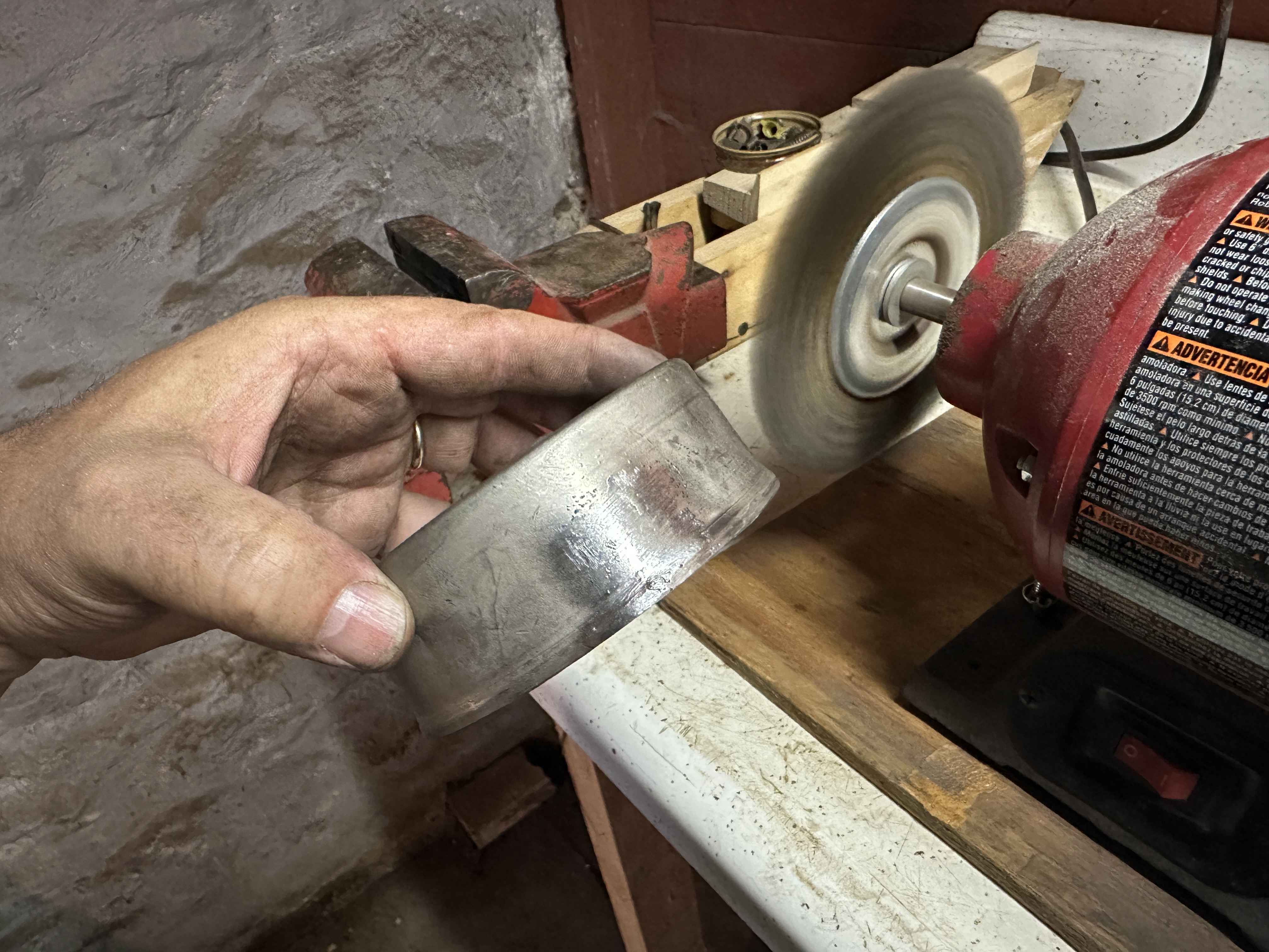

I decided, while I'm waiting to get the spring barrels going, that I would start on all the other parts. Remember, I want to keep the patina, but not the grunge. The nickel on the tonearm was pretty bad but using a dremel with a very fine wire wheel, some #0000 steel wool, and some Hagerty silver polish it's starting to look better than it did. I need to decide if I pick up a tube of Flitz and have another go at it or if this is as good as it's going to get. What do you think?

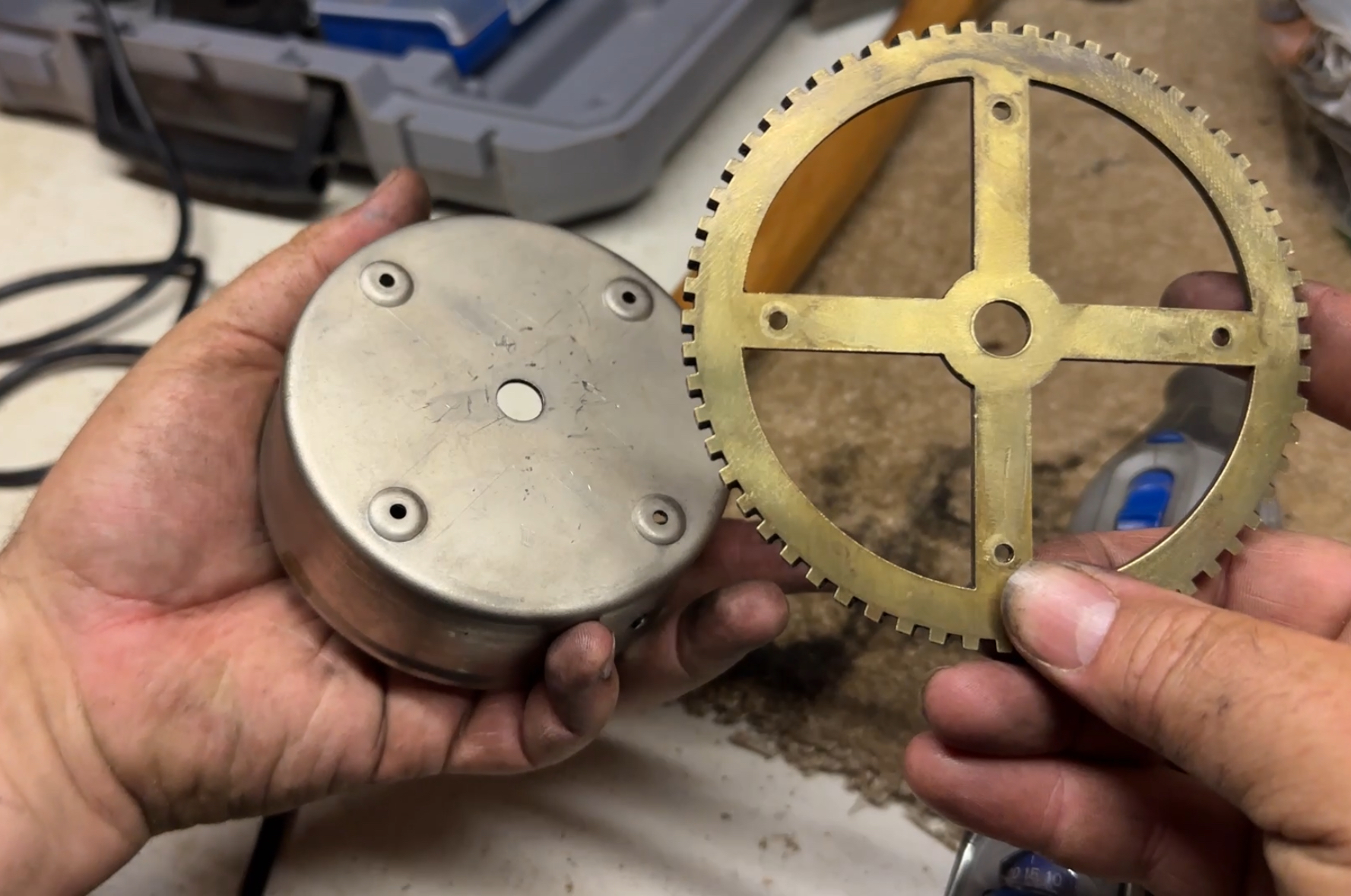

So I took the spring out of the main-gear spring barrel and decided to grind out the rivets in order to flip that gear over due to the wear on the "business" side of the gear. Another difficult spring to get out of the barrel (no worries about the spring ever slipping off the stepped rivet) and some trial-and-error in getting the rivets out. Used a Dremel to remove the top nub, used a drill to get below the surface of the gear, used a punch to push the rivet out, and sometimes I did all of those back and forth and more than once when the rivets proved stubborn. All this allowed me to remove the gear and get really specific about removing the remnants of that terrible weld job. Here's the photo mosaic:
Got the gear off after some trial and error
I want to remove ALL trace of this terrible weld job
Polishing out the Dremel work on the wire wheel
Quick shot of spray paint and sandwiching on the flipped gear to see what it will look like
