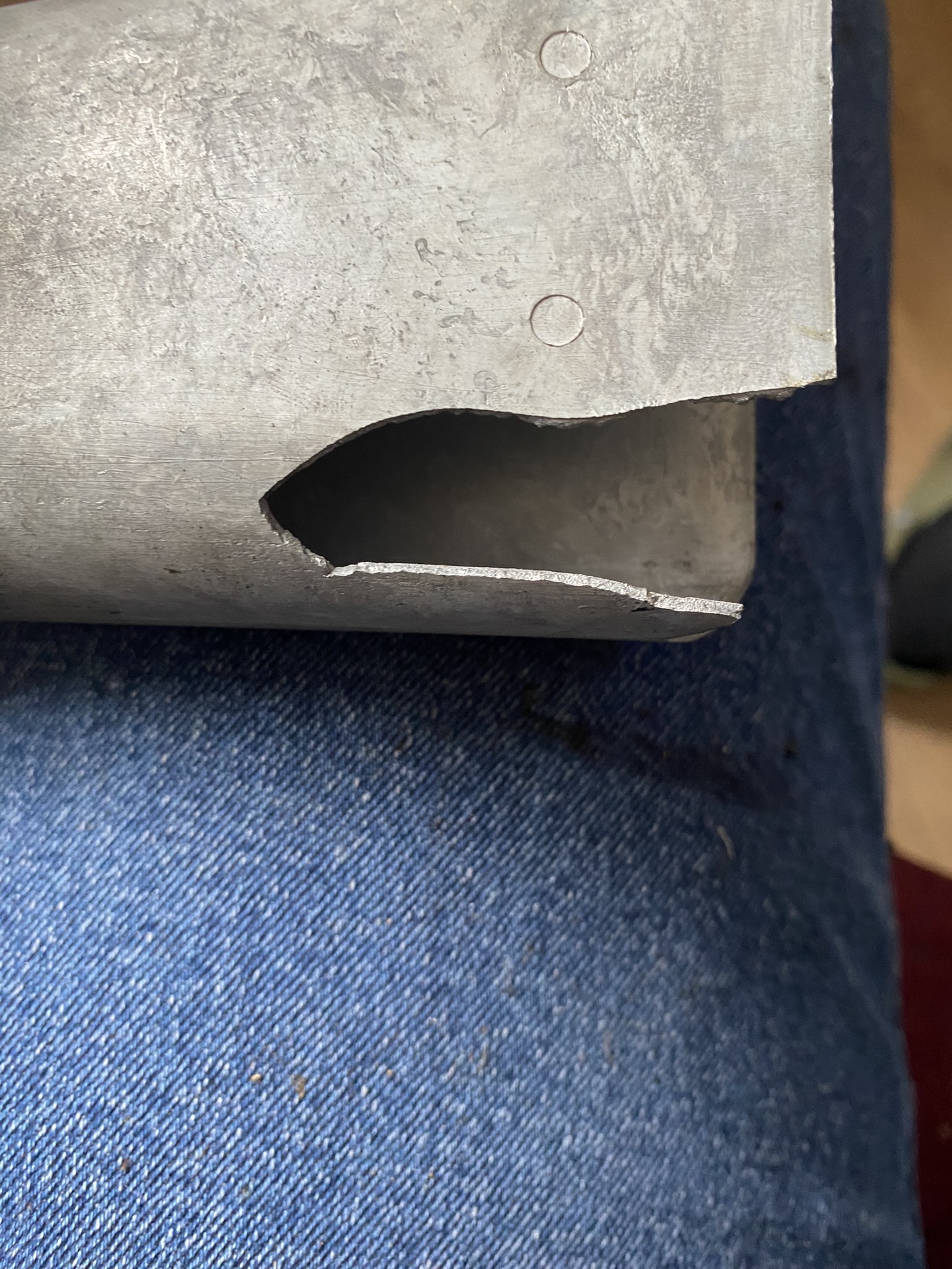

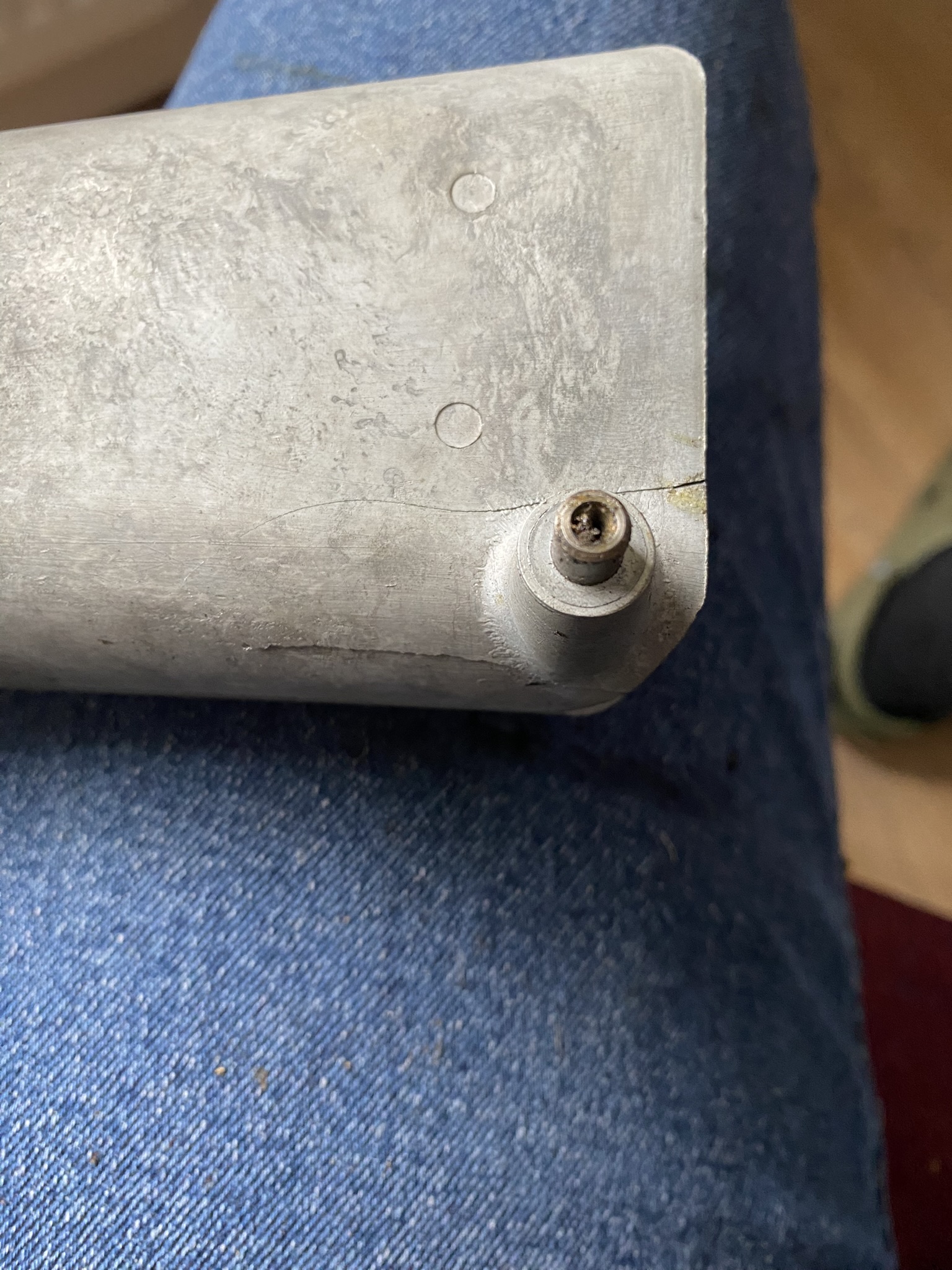

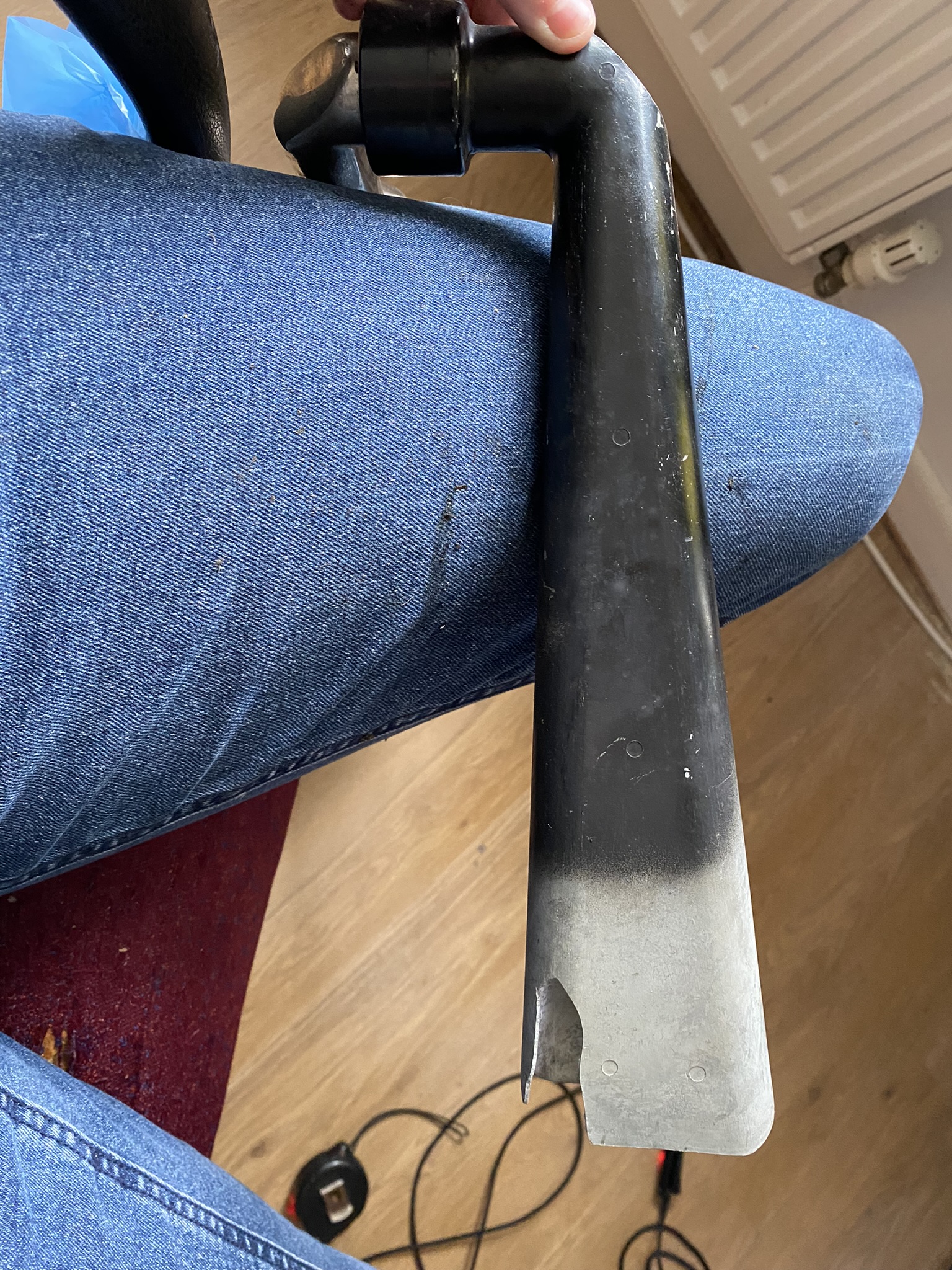

I will be setting aside the cabinet ones for now and focusing on the portable ones for restoration. Both are pretty much fine and in working condition but the 112a's pot metal horn at the suspended end where the bolt or what not holds the internal horn up is broken. I know this is a typical problem with this model and other pot metal items of considerable age (I learnt this the hard way with the HMV 5a back plate). So I was wondering how to fix this breakage in the horn. The breakage is very minimal as it is only a 2 inch long shard where the bolt attaches to the internal horn to keep it up.

First of all, the broken part is hard to visualize without a good quality close up photo. As I understand your description, the end of the horn is broken at its base where it enters the mounting plate on the cabinet. It is quite a common problem, which is easiest solved with a replacement horn. However, it may be able to be repaired by inserting a piece of curved metal to cover the broken area and epoxied in place, then drilled like the original part. Since the horn is pot metal, it cannot be soldered in place - heat melts pot metal. This is just a guess without actually seeing what you are dealing with.
Don't use super glue or household glue. You need two part epoxy - liquid or putty for strength.

The problem you mention affects both the Columbia 112a and it's successor the 202. The lugs on which the far end of the long pot metal horn pivot in the far end of the sheet metal horn are prone to breakage. Repair is possible but tricky.

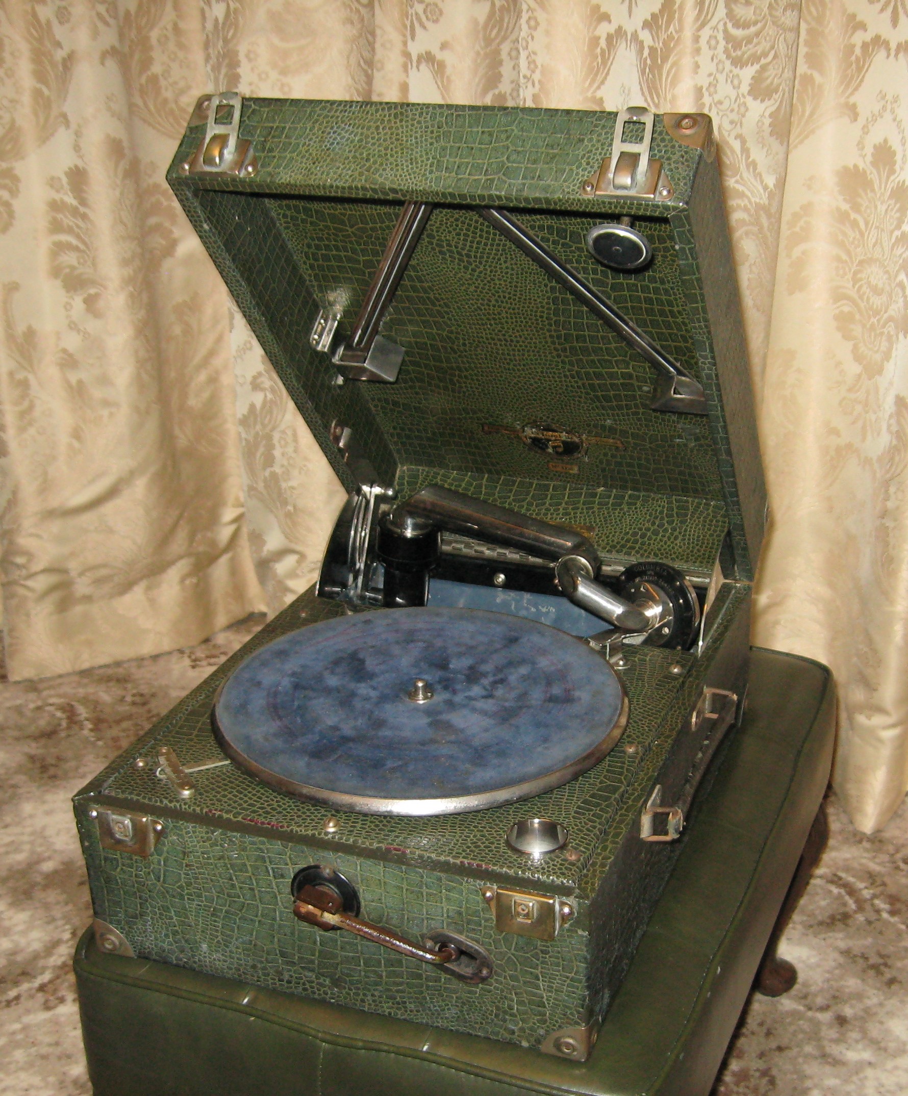

I repaired a rare Brown Crocodile 112a by very carefully drilling through the lugs and the sheet metal horn, then passing a threaded rod through the entire assembly and securing it with nuts at both ends. The repair was so difficult that I swore I would never do another, but then along came an even rarer Green Crocodile 112a with the same problem.

Thank you for all the helpful pointers, I will attach a couple of photos of the break.
