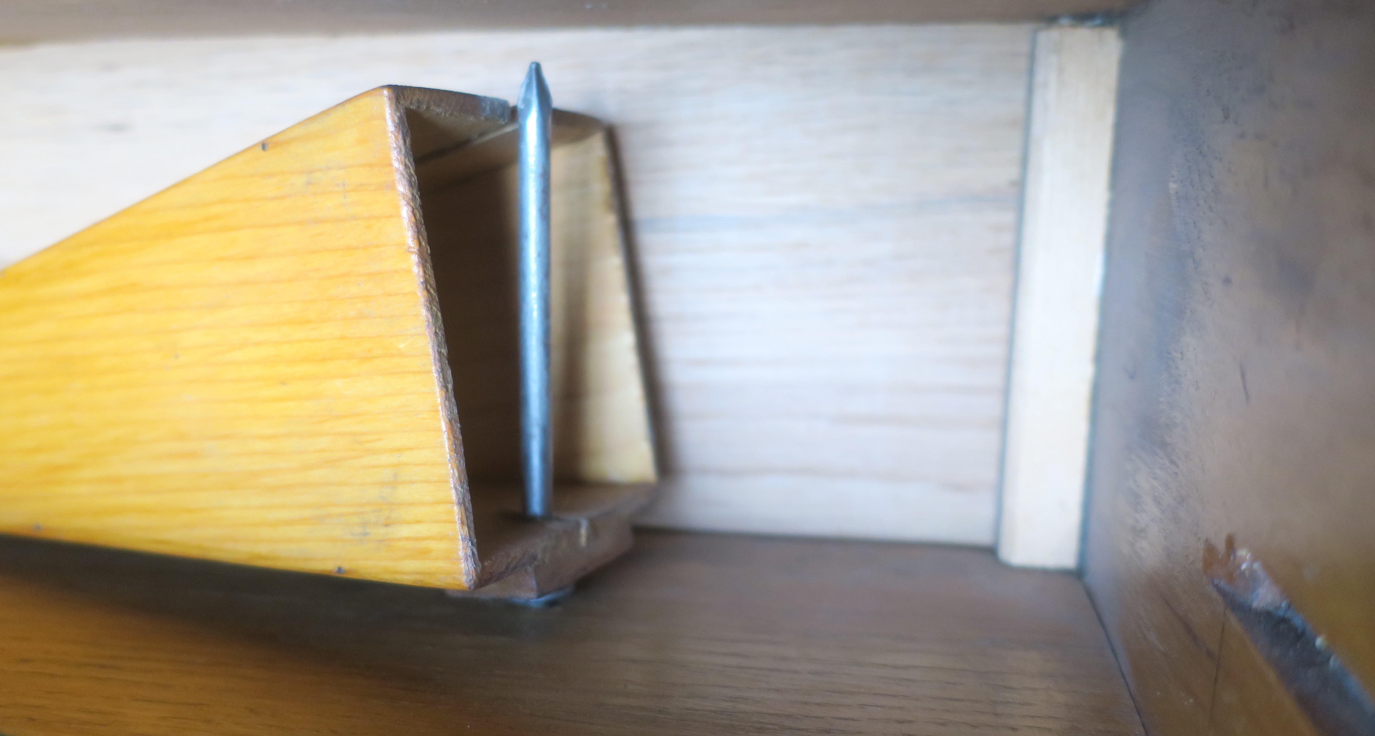

This is an 'Improved Ever Ready' model, introduced by Murdochs in September 1915. Wartime supply problems no doubt prompted the wood substitute for a tone-arm! The record tray is often missing; sometimes it sits on top of the ledges at each side, sometimes there is a groove in the sides for projecting 'tongues' on the tray.
The 'horn' is not removable; it pivots on a fixed stud that passes through a hole in the bottom of the horn and a slot in the top, so that, when the sound box is in position on a record, the top of the horn is stabilised by the stud, but still free to move vertically. On mine, the stud is a nail; whether it is original I cannot be sure, but it does the job perfectly - there are two washers under the horn. I have taken a photo, which was difficult, but I hope will show what I am talking about. To fit the nail, or remove it, it would be necessary to unscrew the bottom of the case.

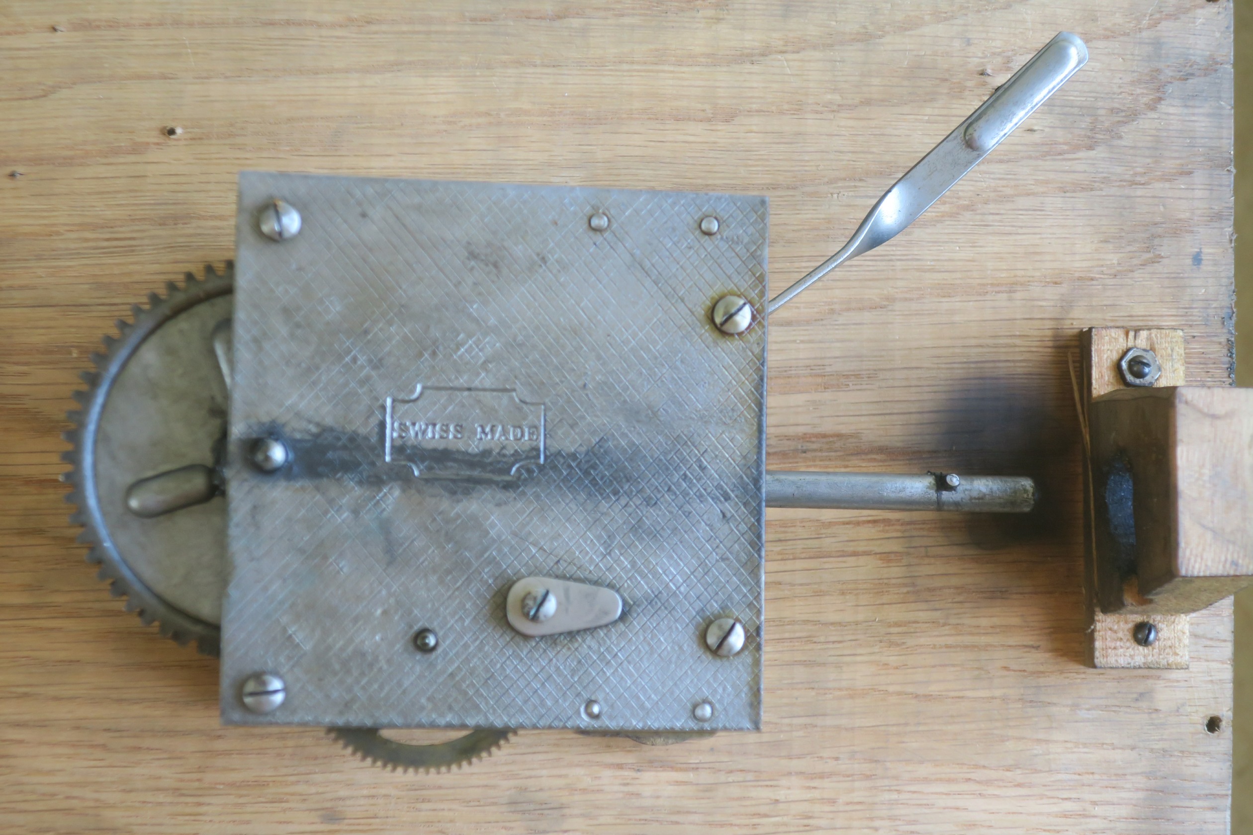

Thinking again about it, I realised it would not be necessary to remove the base of the cabinet to get at the horn mounting, because it is fitted on what is actually part of the motor board. So I took that out; the entire mechanism is mounted on the board, some 15 years before HMV adopted the same ideal for the 102!
The motor in mine is anonymously Swiss, but I can now see that the nail is original, and held in place by a small screw through its head (I feel like that sometimes, too). It is also clear that the pivoted hinge arrangement seen in an earlier post has never been fitted to this one -- but it is described in the blurb accompanying the announcement in September 1915. So, at some point the supply of hinges ran out, or perhaps they were found to be unsatisfactory, and the crude but effective 3 ½-inch round wire nail (often called French nails at the time) was adopted instead.
The internal block providing an extra bearing for the winding handle is unusual and serves little purpose given the normal metal escutcheon on the side of the cabinet.

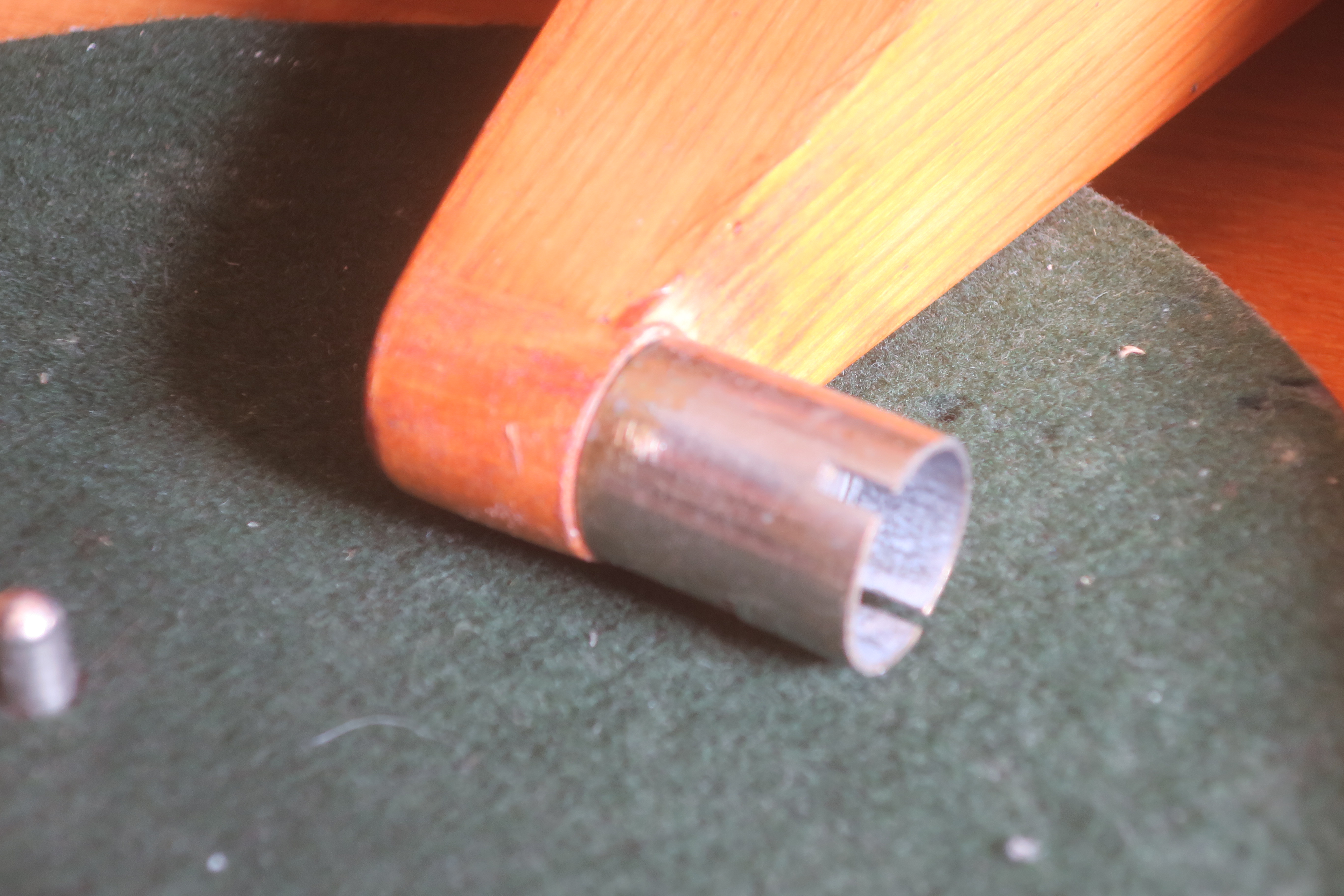

Before doing so, I would be most interested to see how the metal flange (a which connected the soundbox) is secured on the right angle - is there a wooden collar, or a small tube recessed into the narrow end of the cone? How is it interfaced to the wooden surrounds? I actually have the metal part (see pic earlier with the ruined soundbox) but would be keen to grasp how it is secured for maximum strength.

I managed to get some (not very good) photos of the sound box end of the horn. There is a wooden cylinder on to which the horn is closely fitted (the left hand side of the horn extends over the end of the cylinder to close it off). The cylinder is waisted at the right hand end, to take the metal socket, which is secured to to it by a small woodscrew at 6 o'clock, and the socket has a slit cut through the lower half, and a wider slit between that and the end, allowing it to be adjusted for varying sound box outlets, probably wise at a time when supplies of sound boxes were variable.
I hope this will make sense when you study the pix.
