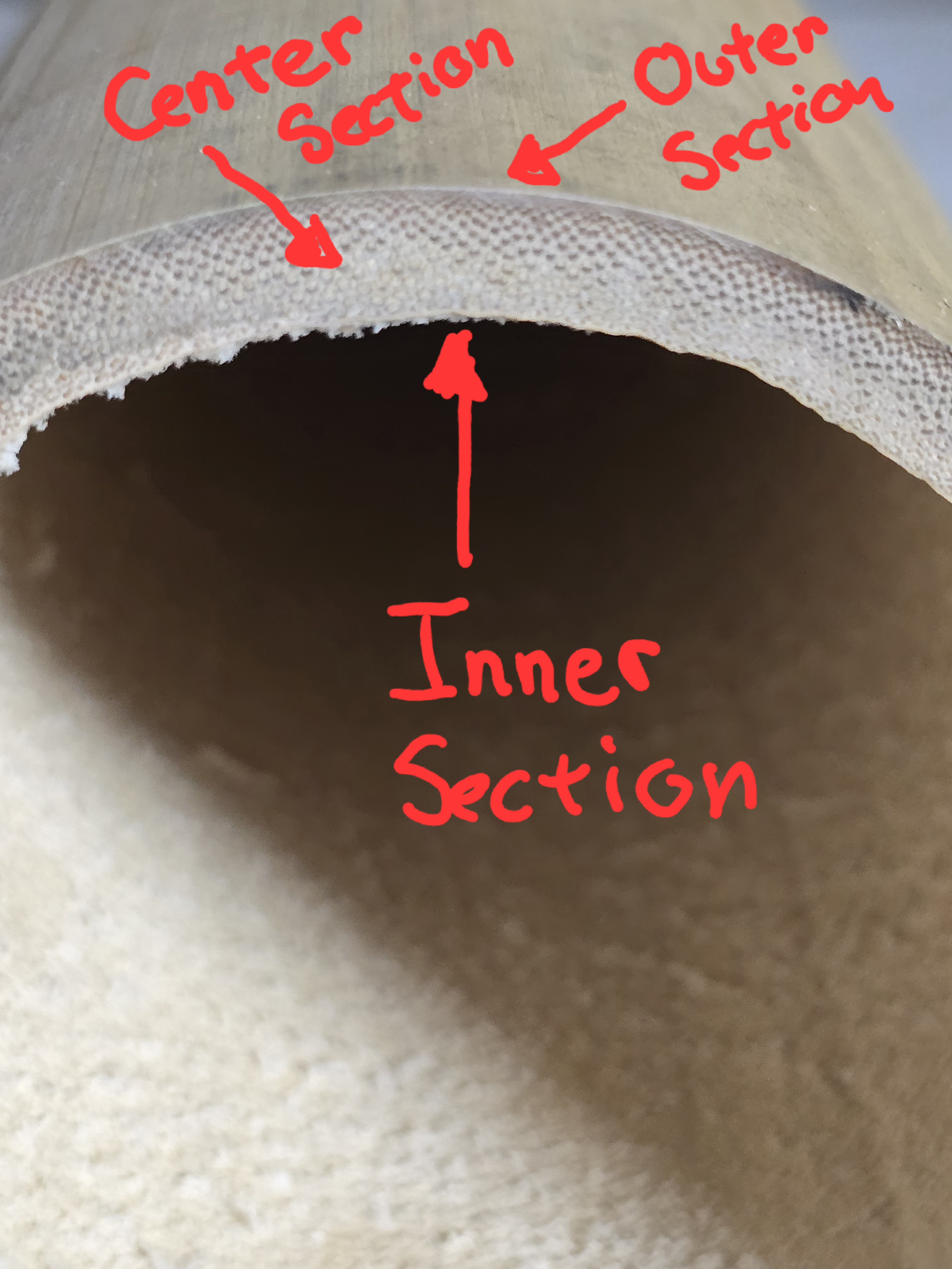

Big C, when you say 'the center of the bamboo' you're referring to the center between two knots in the cane stick?
BigC
Posts: 279
Joined: Sat Apr 24, 2021 2:13 pm
Location: Blythe California
Re: Bamboo Needles
Post by BigC »
I don't know the proper terminology but a picture is worth a thousand words. The outer section is really hard on this piece of bamboo, my cutter can't really cut it. The inner section is no good either. But the middle is perfect, it cuts good and played a whole record with no problem.
