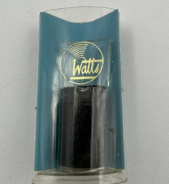

I have a couple of old Cecil Watts stylus cleaners that I use with great care. I dampen them with Discwasher fluid (I happen to have a couple of bottles kicking around). They are not the safest devices to use because they have a hard plastic core and their plush is quite short, but they are effective at loosening up pilled up balls of gunge from a stylus.

If I can’t remove a headshell or a cartridge sled or the stylus itself to work in good light, I never use the Watts cleaner—too dangerous especially with modern highly compliant cantilevers. It was OK with my old Stantons which were back-queue capable tough.

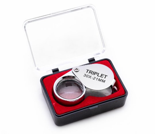

I monitor the cleaning with a 30x power jeweller's loupe.

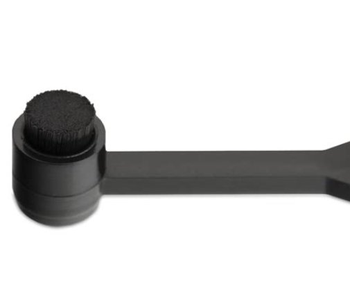

I do the fine residual work with a dry Project carbon fibre brush. There are innumerable near-identical brushes available from name and no-name companies—so the Project name here is not all that important. This brush is quite safe as the bristles are fairly long and quite fine if a bit stiff.
I also use the Project brush for periodic light cleaning with the cartridge/stylus in place in the tone arm.
