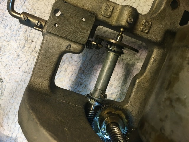

Re: No32 motor ball bearings
See the attachment please and tell if there is a keeper or bearing on right side of the governor.Inigo wrote: Thu Sep 26, 2024 4:08 pm I once tried to get these balls out, and it costed a lot of effort! It's likely they are in there still. You can maybe try to feel the ball using a gramophone needle tho touch it.
Some hmv governor bearings have a slot in the middle of the body, where the set screw must sit.. If only one of the two has the slot, that's the one that goes in the worm side. That position is thus fixed. This you mustn't change unless you've made modifications to the governor.
regards
Sheraz

- Posts: 4672
I believe that in my examples of no32 and no34 motors, I have bearing balls on both sides of the governor.
In any case, the side of the plate would nod need it, as the force is exerted on the other side, towards the worm.
