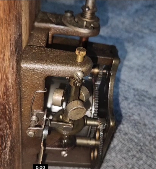

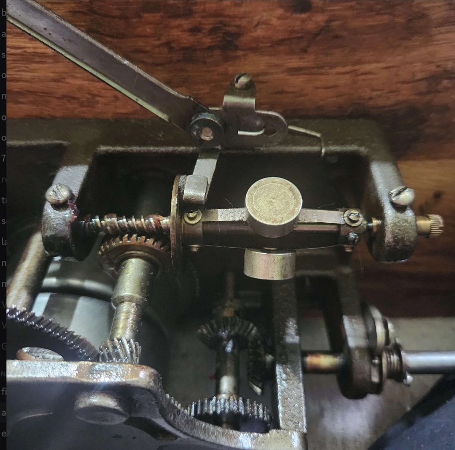

mrvic2
Posts: 131
Joined: Thu Apr 25, 2024 9:31 pm
Personal Text: Tiktok - "scamps" Instagram - "@ppoisonedbasin89"
Location: Maryland, USA
Re: Offbrand Phonograph making loud noise
Post by mrvic2 »
JerryVan wrote: Sat Oct 05, 2024 12:33 pm Let's see some pictures of the motor.
These aren't the best pictures since I'm not home at the moment, I'll get some more when I get back (hour or so)
Posts: 6828
Nothing really jumps out there. Are all the gear teeth on good condition? No burrs on any teeth, or mashed over teeth due to past rough handling? How about the teeth on the fiber worm wheel that drives the governor? Those are often chewed up.
