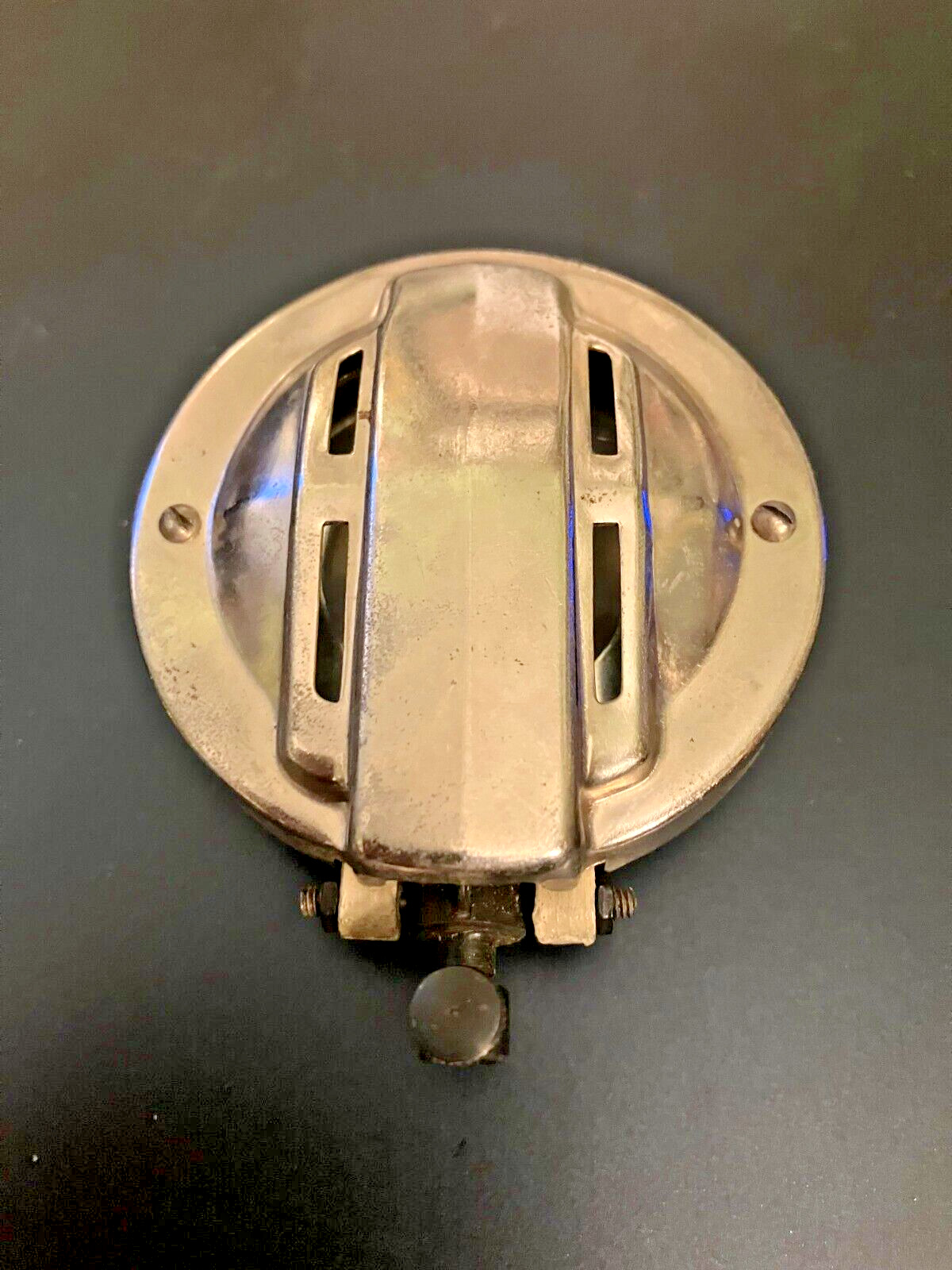

Very pleased with how this is going. I made an offer on a reproducer that will fit and hopefully I get a good deal; it's a cheaper one with a chrome mask and white back but black paint can help backdate it to the general styling of the 1920s.
The cheap reproducer isn't the original Audak. However, it'll be less prone to cracking, and of course I can put Exhibition tubing in the later style reproducers.

If you're looking for an Audak reproducer, drop me a line. I have this one as a spare:
- Attachments
- Audak 3.JPG (83.66 KiB) Viewed 1196 times
- Audak 1.JPG (76.17 KiB) Viewed 1196 times

@drh thank you for the offer! I had won a bid for one of these smaller late style generic reproducers because it's a smaller diameter. The short dimensions of the inside of the cabinet are causing some overhang when you put the tonearm near the spindle with a large Alba reproducer in place. Swap out for an Exhibition and it is lessened. So I went with a small reproducer like this which is similar to something from an inexpensive portable.
How do the Audak units sound? I have never heard one before. They look convincingly close to Victor hardware but I've not had a chance to get hold of a machine equipped with one. Awhile ago I thought about upgrading my XIV with one but didn't get anything in fixable condition.

They don't sound bad at all, in my experience. Not, perhaps, up to Orthophonic standards, but for a cheapie knockoff pretty respectable, I'd say. Mind you, I've not spent much time listening to one; I got this with a Victrola IX and promptly substituted an Exhibition after maybe one or two plays, and the last one I had got similarly short practical use.
