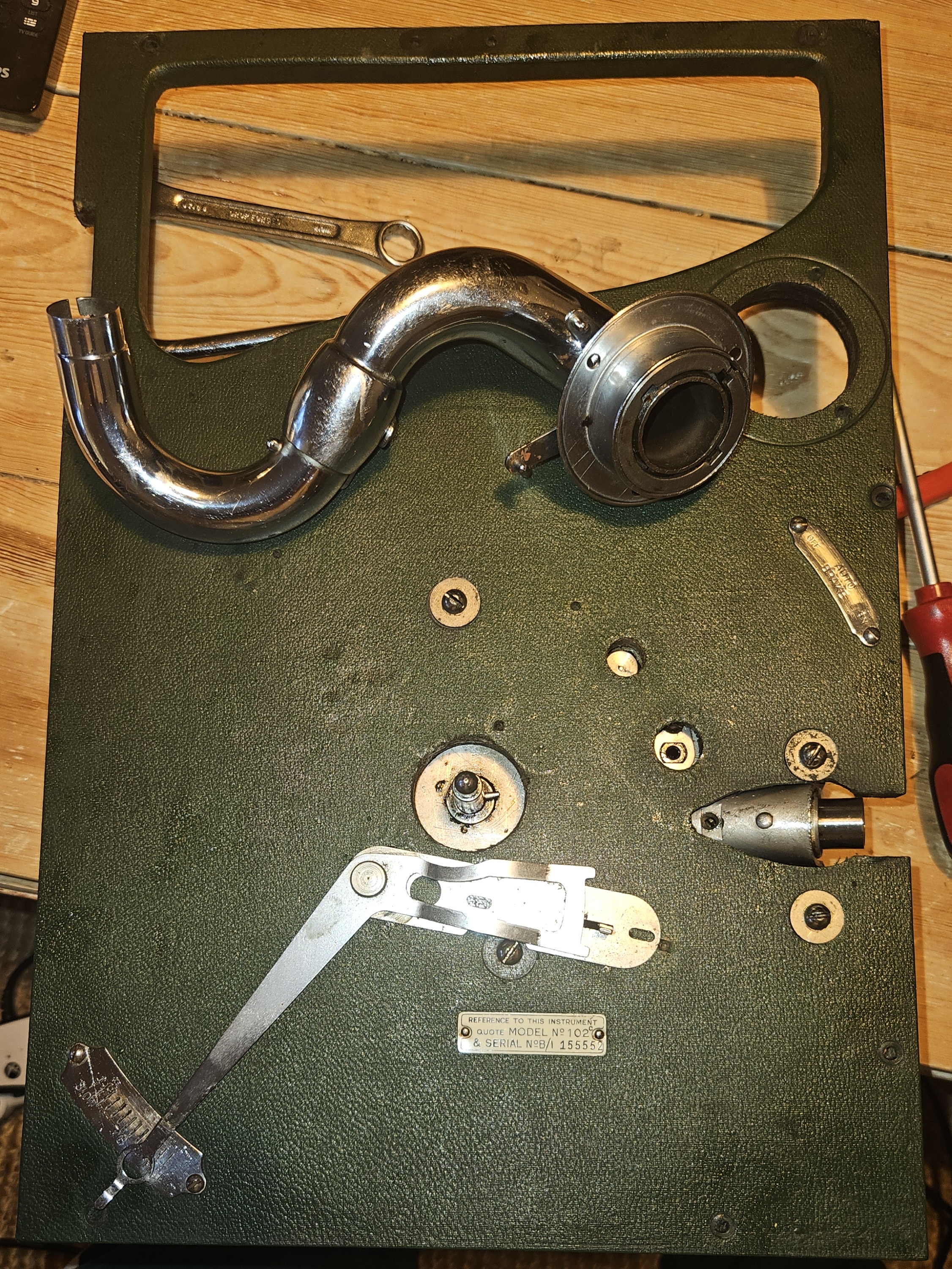

Okay. Before I post photos, I just feel the need for a disclaimer of sorts.
I've tried to assemble the pieced as best I could, but someone ragged this poor thing like a teenager rage quitting a computer game. The closer I look, the more "fair shape" seems like a cruel joke. I remember it playing and running just fine as a child, but since then it's been through it.
Anyway, here it is. The needle holding thingie, case, etc, are out of frame, but I've got them. Otherwise, this is what I'm working with. No idea if this is at all useful.
And someone clearly wanted whatever they'd hid in the spring at some point. I would like to have a chat with that someone.

Re: Missing brake on HMV 102c
When you lift the motor board out the horn, which is attached to the underside, should come out with it. I assume that you have separated it to get better access to the motor. It appears that someone has tried to remove the spring from it's casing to either replace or lubricate it, and has damaged the casing in the process. This will allow the grease to escape, so you need to source another casing from a scrap motor.
The machine would originally have had both manual and automatic turntable brakes, but will function perfectly well with just the manual brake. I don't see it in the pictures, but there will be two screw holes in the motor board where it was mounted.
