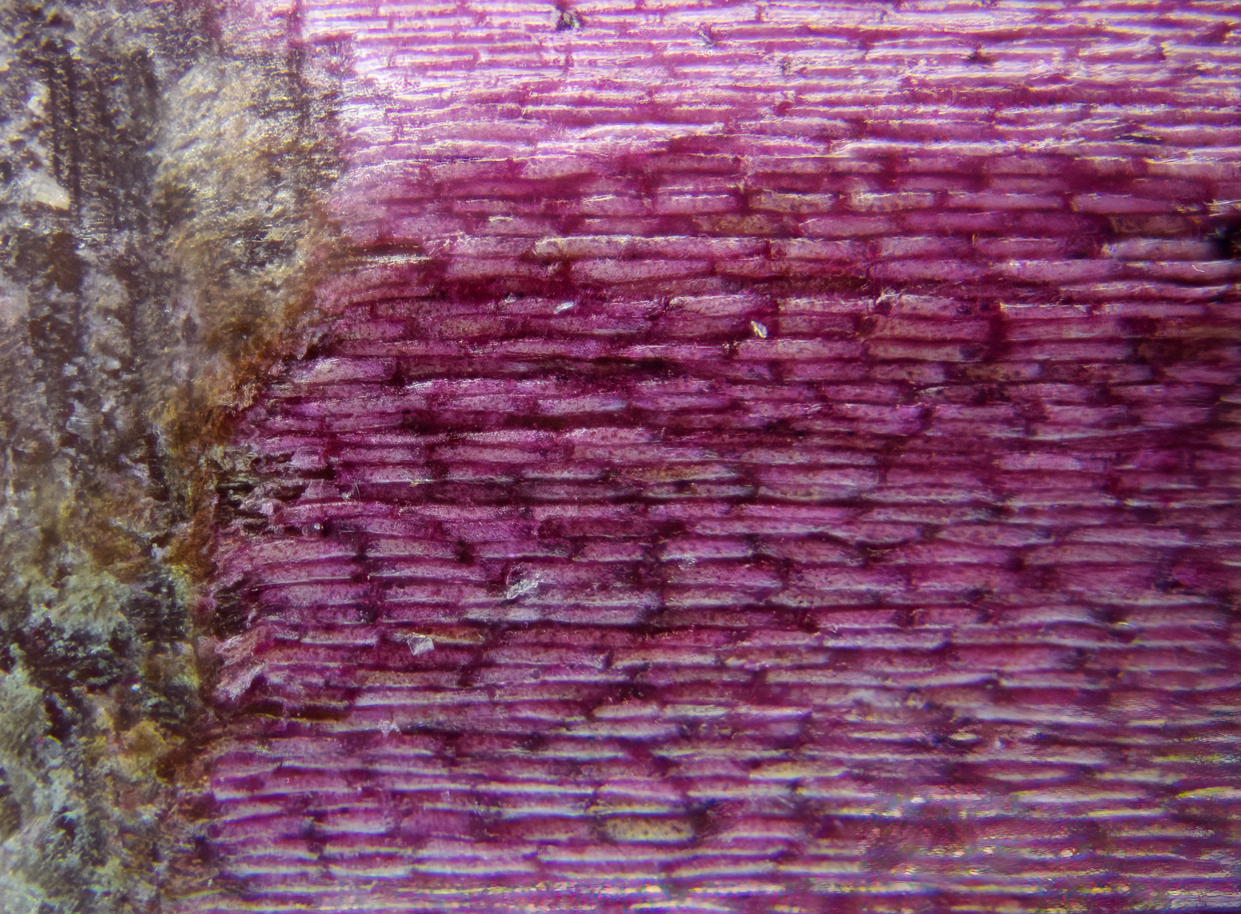

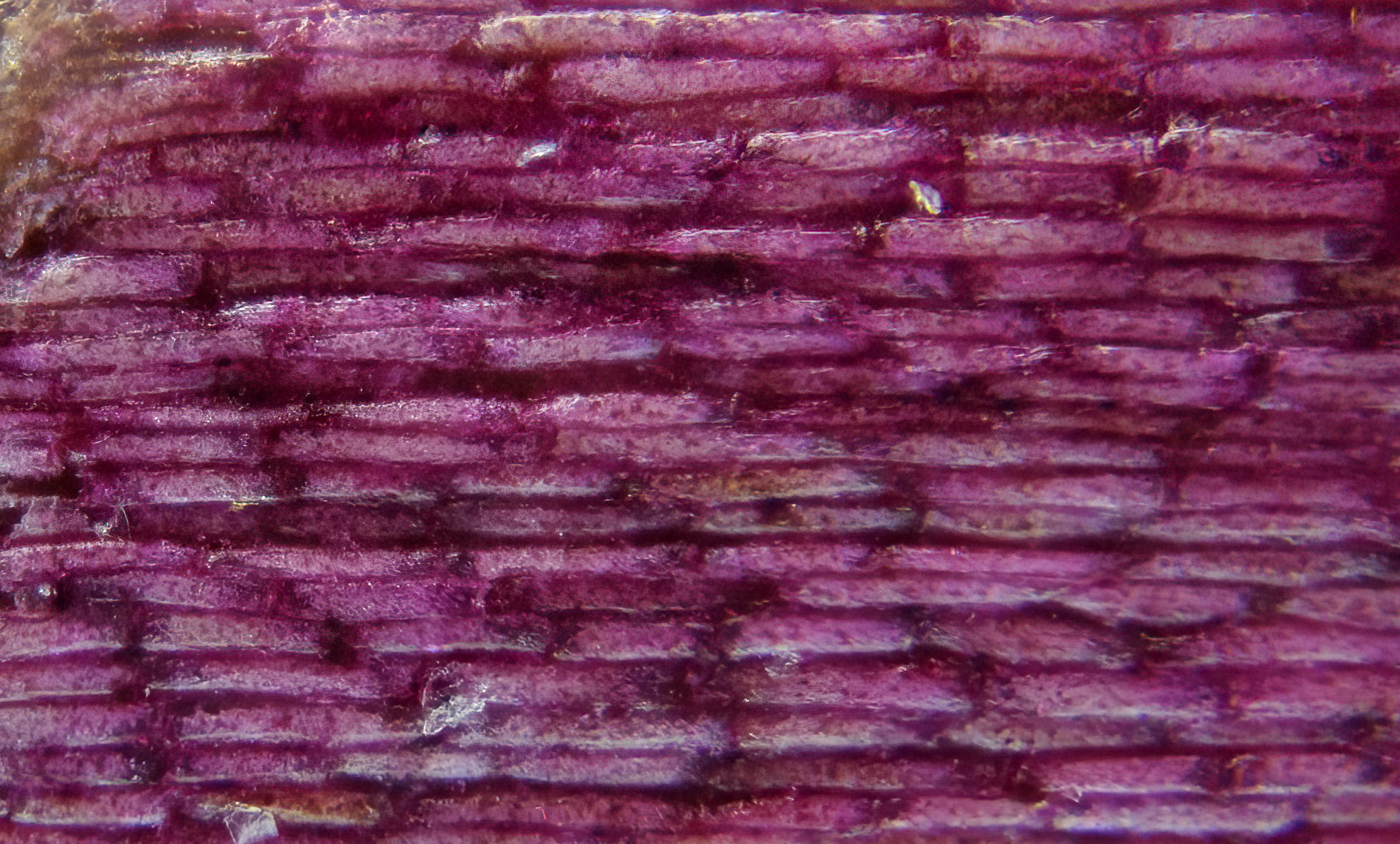

As promised yesterday, here's a BCN at very high magnification, taken today through a microscope.
The main image - and two closer crops - is a focus stack composite of 313 separate images. If you double click on the first image, there's a lot more detail to be seen in the tip.
The close up, and crop, of the needle surface was captured with a higher magnification objective, and is a stack of 87 images. The higher magnification objective isn't really optimal for this kind of photo-microscopy, but it's still fascinating to see detail in the individual cells.

Very interesting. Thank you.
I was going to ask you how you got the depth of field (in focus) through the optical lens of the microscope. But now you have explained about focus stacking.
I remember (vaguely and perhaps incorrectly) from my youthful days with my second hand Pentax SP1a 35mm SLR camera that depth of field (in non-microscopic photos) could be achieved with a tripod, a small aperture, and a long exposure.
I believe that some of the more expensive digital microscopes can automatically do focus stacking.
How do you accomplish this feat with your setup with an old school optical microscope?

Thanks very much. You're right that a deeper depth of field can be had with a smaller aperture and long exposure, but you get diminishing returns, as a smaller aperture increased fuzziness in the image, and through a microscope the DOF really is tiny! I've seen some gorgeous microscopes which do incredible things these day, including focus stacking, but when I've looked online, responding to adverts, I've been shocked by the prices. One was tens of thousands of pounds. I'm sure there are more affordable ones too...Lah Ca wrote: Mon Nov 04, 2024 8:33 am Very interesting. Thank you.
I'm actually using a trinocular microscope for these, so can simply stick a DSLR on the top. It's fairly basic, but does a good enough job for my level and interests.
