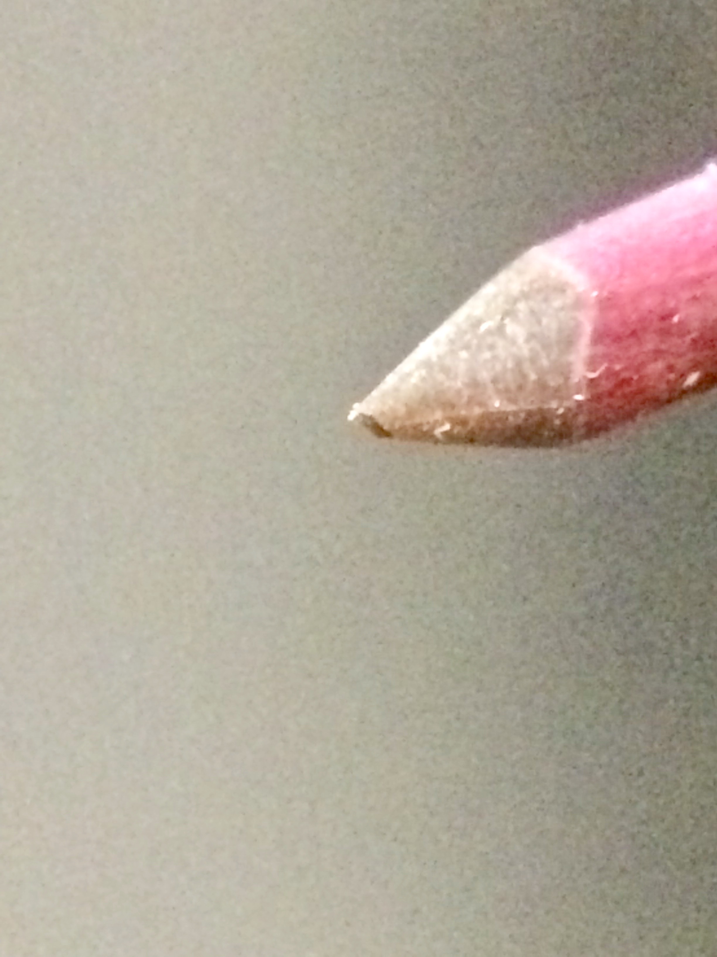

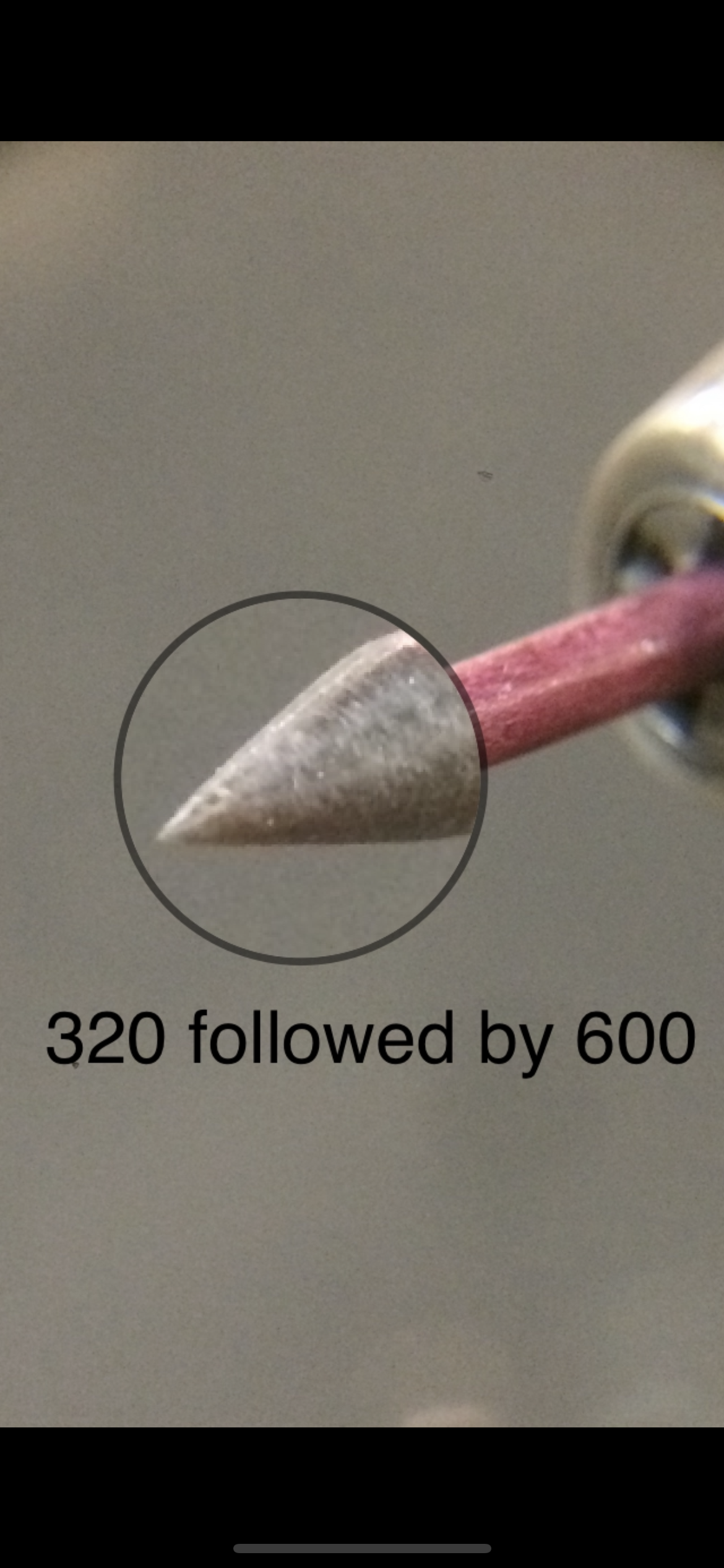

I have posted this photo before but some may not have seen it.
I always inspect the needle after sharpening, just to make sure I got it right, because I do not have a real sharpening accessory, I just use a pin vise and fine sandpaper.
Here also is a needle after a play or two.

Interesting. I'll definitely give this a go, and with some steel needles too.Hoodoo wrote: Fri Nov 08, 2024 10:57 am I have posted this photo before but some may not have seen it.
