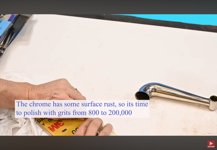

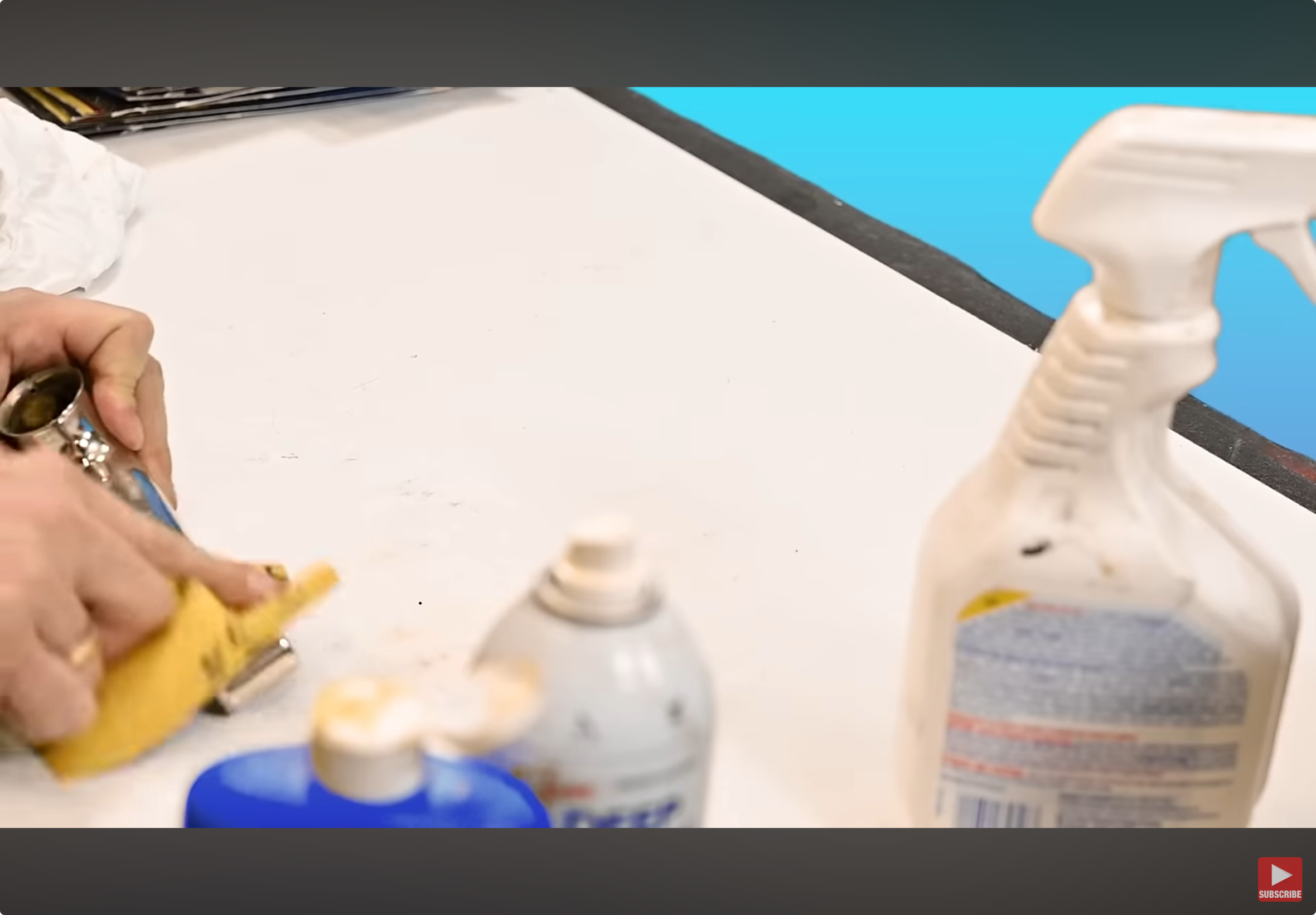

A dreadful tutorial on a Victrola restoration. Sandpaper to clean the tonearm, pliers on nuts, rough handling, polyurethane refinish,
How many poor techniques can you see?

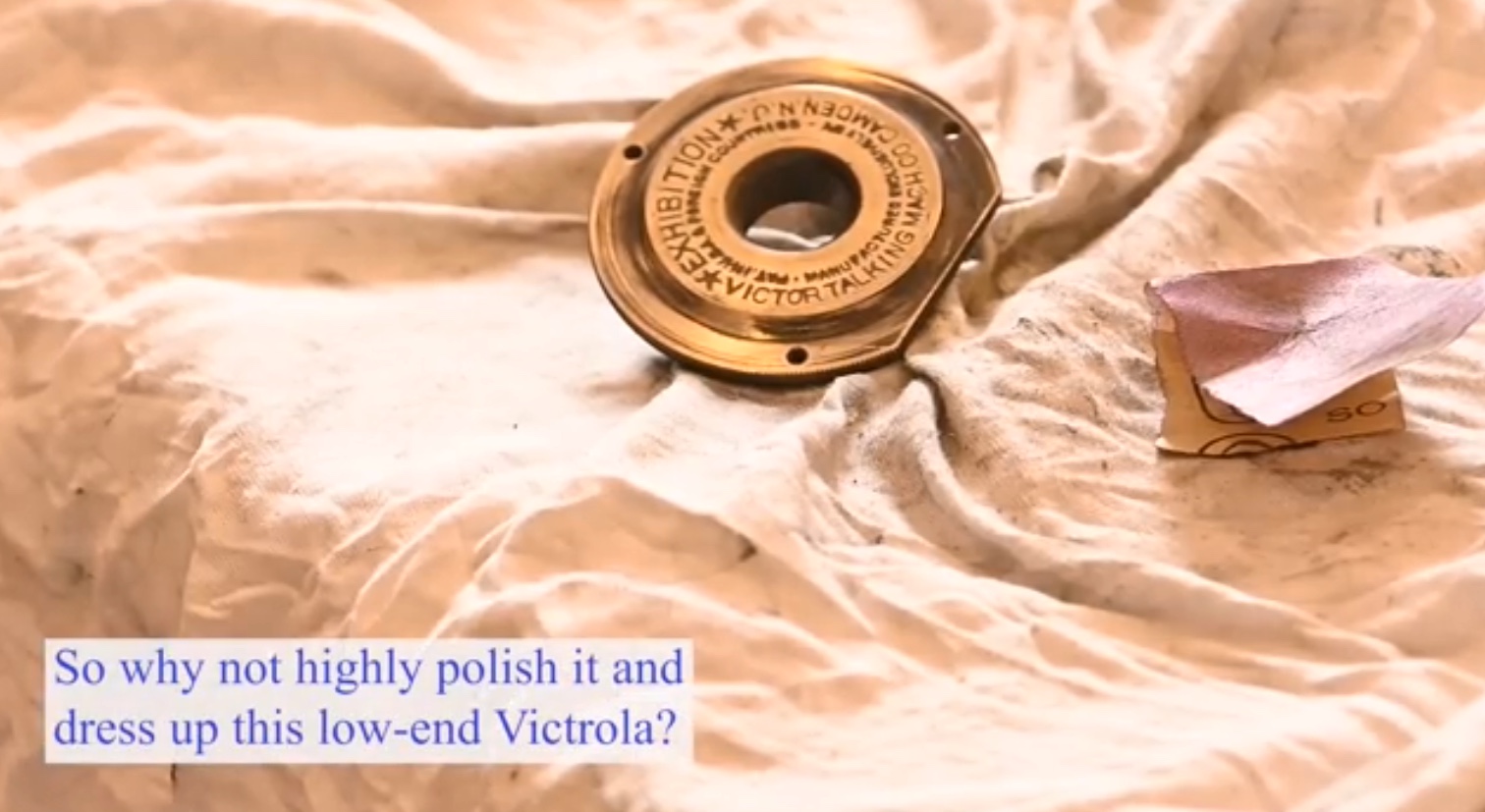

It irks me how he scrapped off all the paint on the back of the exhibition.

The fellow, I'm afraid, has no concept of conservation, of keeping an item's original integrity as much as possible. There was no need to remove the original felt. No need to strip and re-paint the back bracket. No need to "upgrade" the reproducer. And most of all, no need to sand and re-stain the wood. He could have left the original finish alone, or, if chosen, could have removed the remaining shellac with ethanol and a rag and leave the wood untouched. No need to stain, just a proper choice of shellac, and certainly no polyurethane. I'm not sure if that even existed in 1917.

We can answer the question asked by the ‘restorer’.
Because the black patination is original, was in good condition, and that is the way the machine is supposed to look.

It’s not “chrome”.
