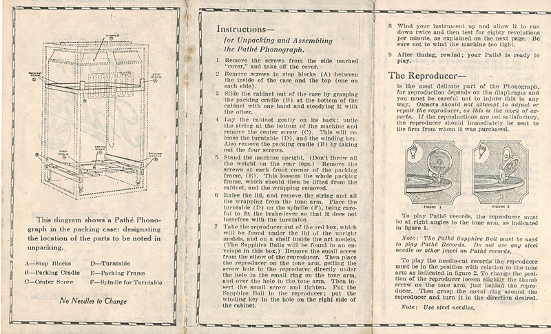

Re: Pathé Instructions
My first antique phono was (and is) a Pathé No. 100. With it, I received this setup manual--or, more properly, this now-ancient photocopy of one. I hope it's of interest/help.

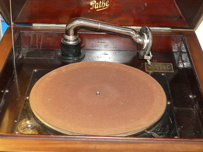

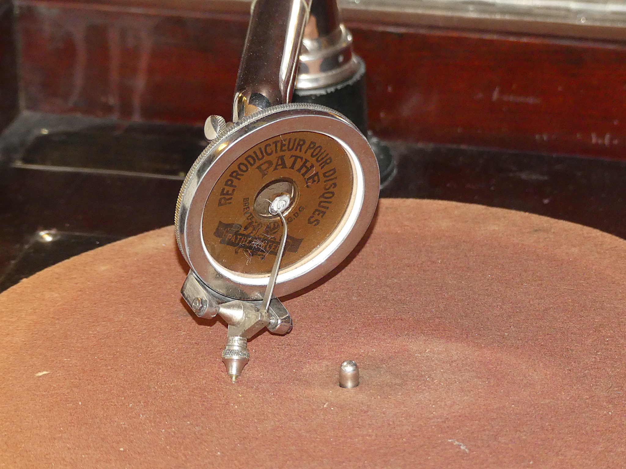

I should add that my tonearm/reproducer arrangement doesn't match what's shown here. It has a big set screw that locks the reproducer at a 45 degree angle, which works for playing any record, vertical or lateral. With the set screw in, there's no way to rotate the reproducer.

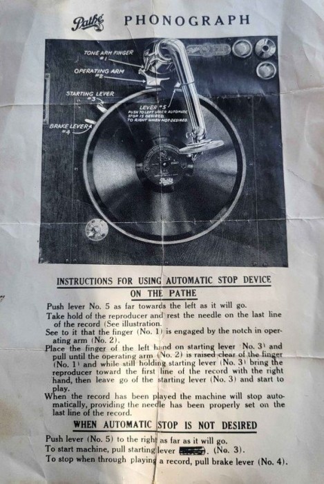

Thank you! This is pretty much what I'm looking for.drh wrote: Wed Nov 27, 2024 11:02 am I think this may be what you want. Apologies for the rather messy reproduction; I copied it from an eBay listing ages ago, and that's how it was presented there. I have another document I'll attach in a separate posting.
What got me curious was that, not too long ago, I came across a page with instructions for a Pathé auto-stop. These instructions were for the Actuelle-style auto-stop adapted to a traditional mica diaphragm Pathé. I really wanted to find out whether it was a standalone sheet or part of a larger instruction pamphlet.
While I would still love to determine if this came from a later Pathé pamphlet, what you’ve shared is more than enough for now. I really appreciate your help, Drh.
