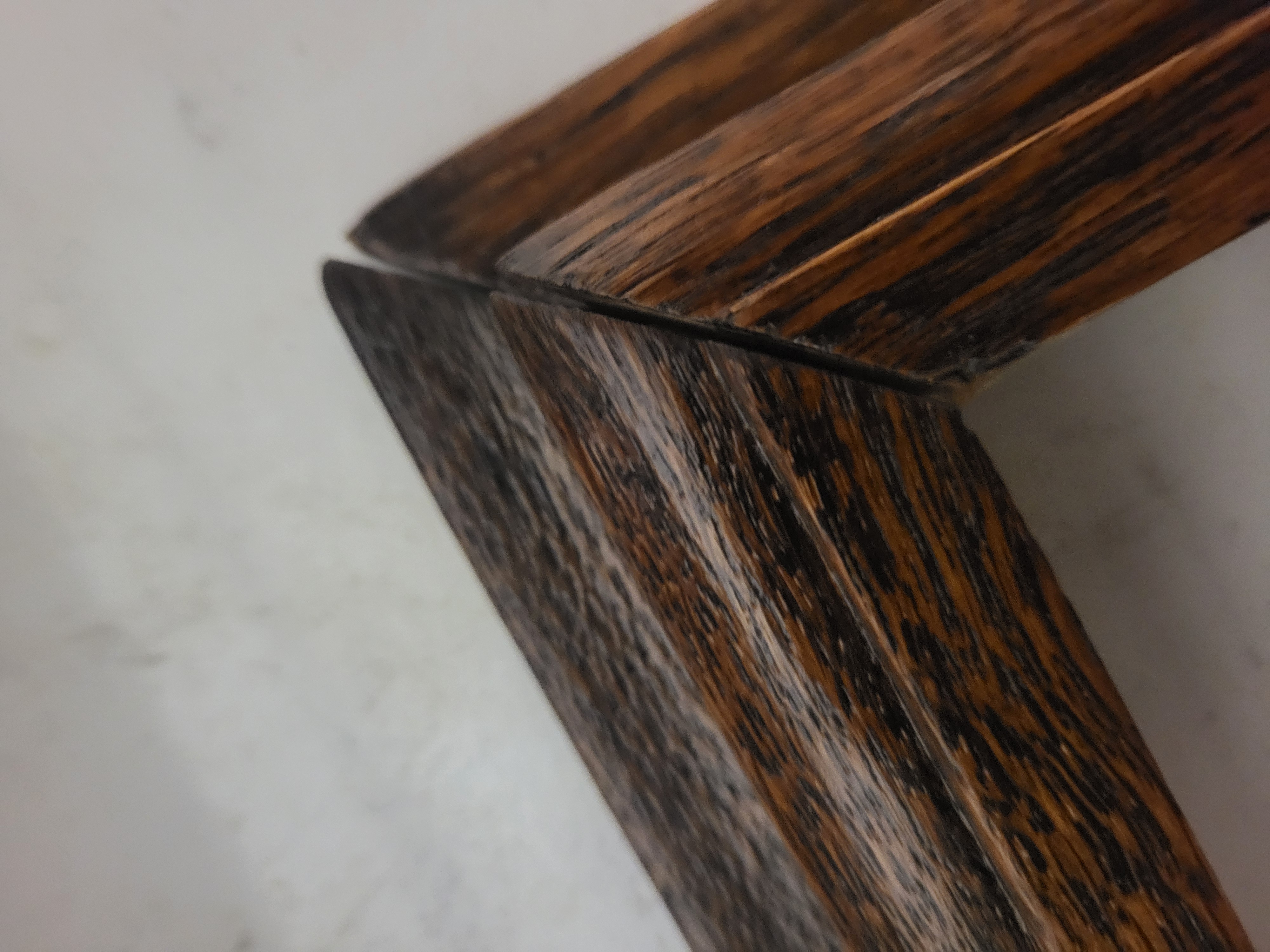

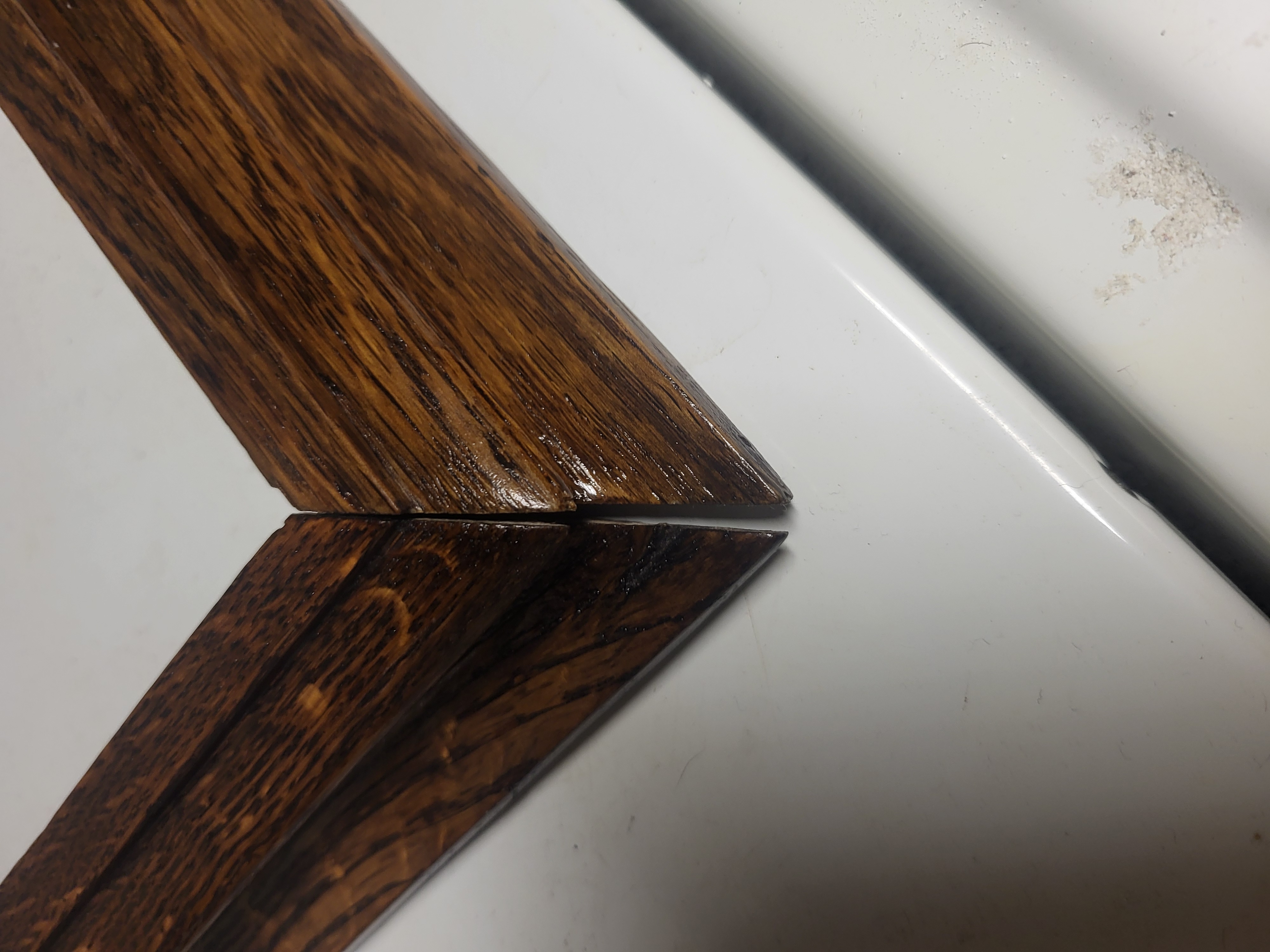

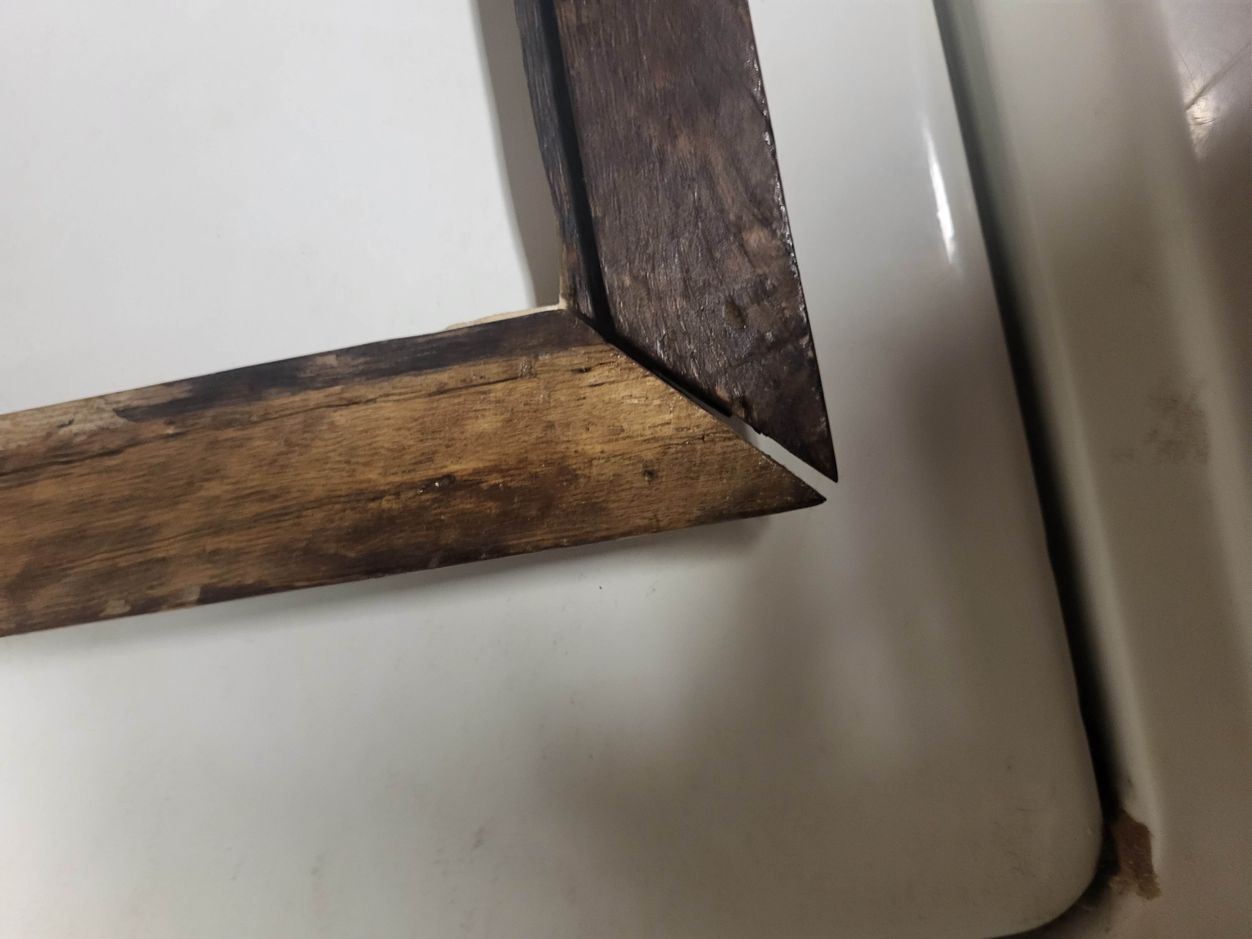

Hello iam restoreing the victor ii humpback it was in rough shape been outside and exposed to the elements my question is how can I close the gap on the trim I have removed it refinished the wood but iam afraid I will have lots of gap when assembled it thier away to close the gap by triming the angle non destructive like any help is appreciated

Here is some photos
Posts: 6631
Re: Victor ii humpback restoreation question
It's possible that the angles can be trued up very carefully. It will also require some very careful clamping & gluing. I'd first try separating the joints and cleaning them of any dirt and dried glue. I would then try "dry clamping" the mouldings to see if the joints can be closed by careful clamping. If so, then apply glue and re-clamp.

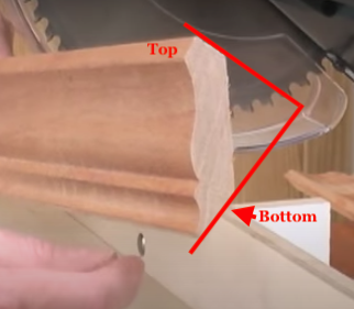

The gaps in your corners are due to laying them flat on a surface. When they were cut at the factory they were angled upwards while standing on their flat bottom edge, then cut on a 45 degree angle. They have to be glued back together in the same way. Hopefully, this pic will illustrate the issue...
Screenshot 2025-01-01 at 8.30.41 PM.png (123.57 KiB) Viewed 436 times
