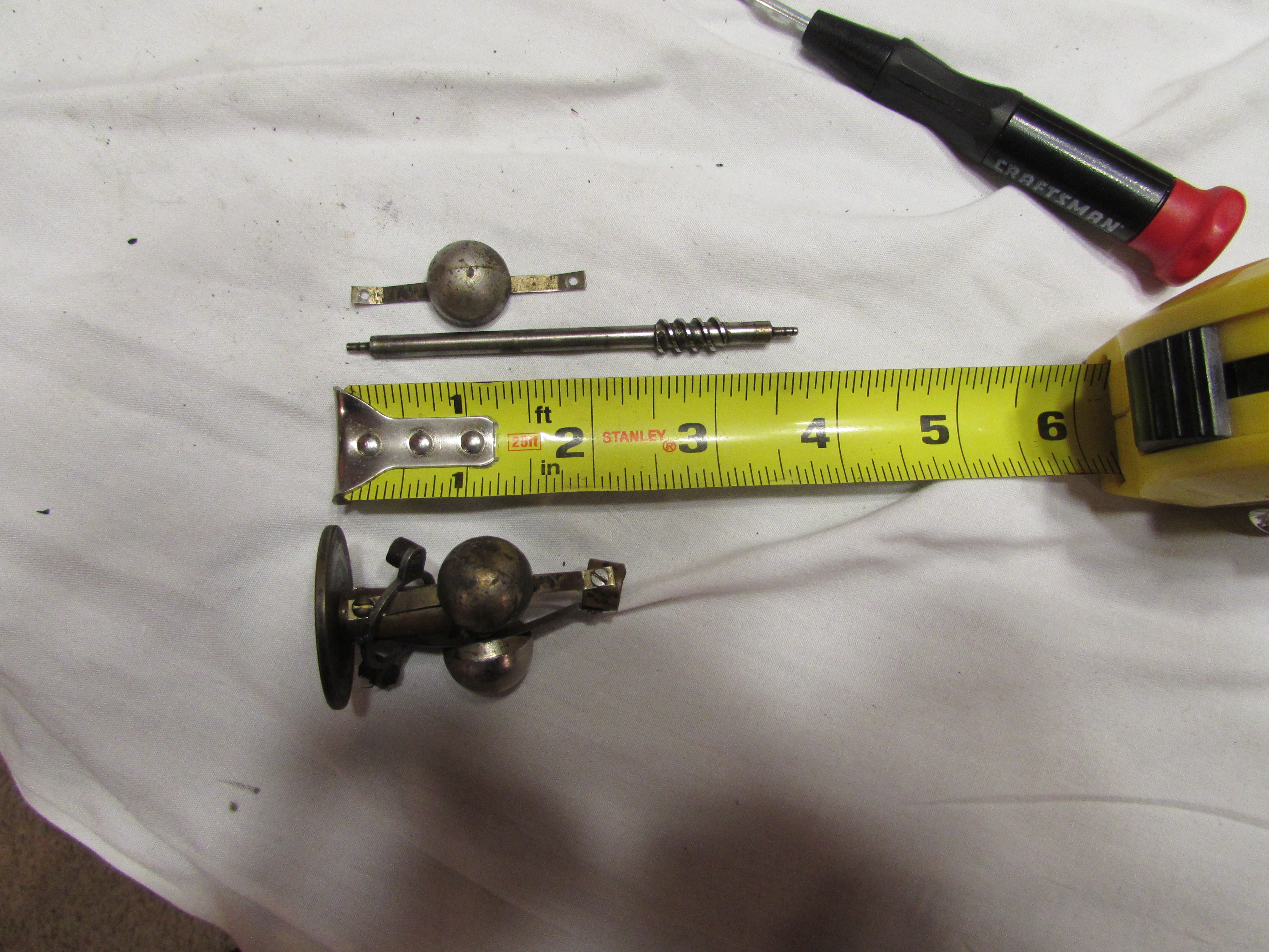

According to one phono site: "Motor Type used in Victor II, shares many of the same parts as Victor III and IV". My question is...are Victor III or IV or any other model's governors the same as in the single spring Victor II (2) model?
I just posted a wanted ad in the Forum Trader for the governor and could use some advice and am willing to buy one. Please see more pics and specifics in my "Wanted" ad....thank you.

I wish that were the case. Both brass pieces of the governor had some of the holes for the spring screws stripped from someone attempting to put the wrong and larger screws in.

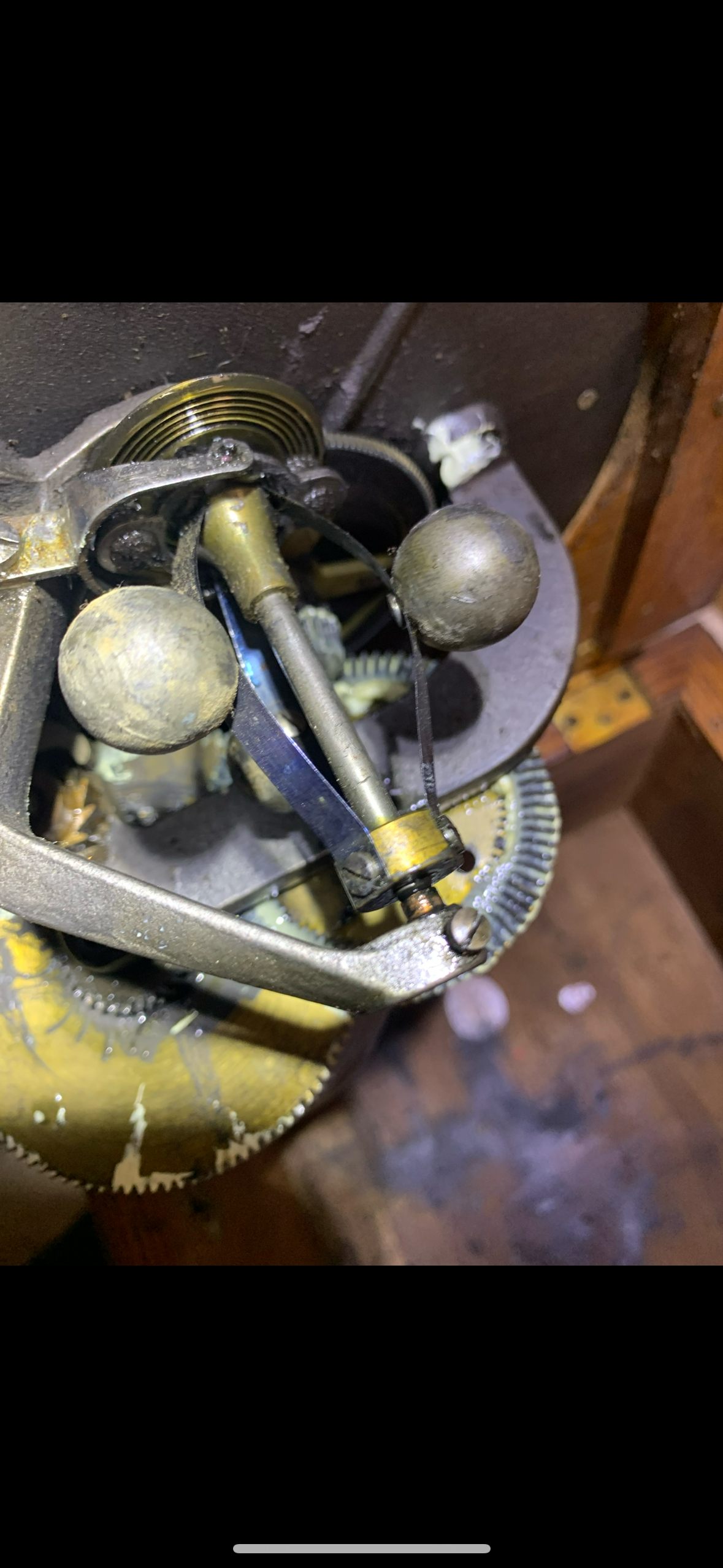

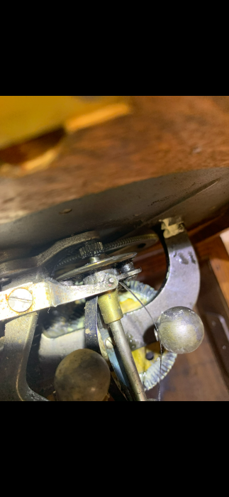

Attached below are two pictures of the governor on my Victor III - Monarch. As you can see, the governor on this machine is configured differently than yours. This particular machine has the monarch motor with the early beveled gears, but has always been rear mounted. It’s possible that a later model Victor III might have a different governor. I don’t know if this really helps you, but it is a starting point.

The 2 brass pieces are very similar...thanks for the help!
