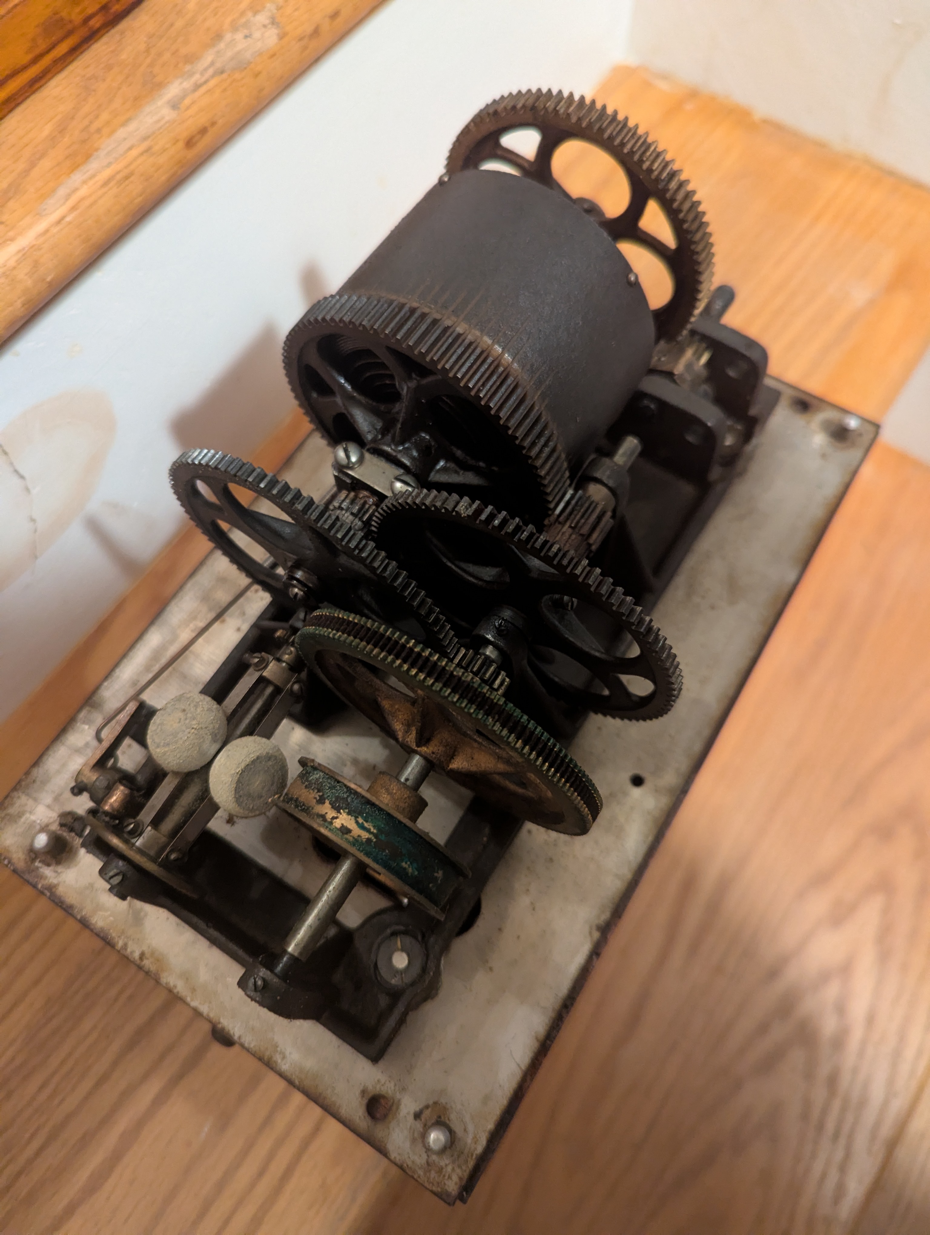

Yesterday, my wife sent me blurry photographs of a $55 cylinder phonograph in a local consignment shop. It looked rough, but I could see enough to determine that it was a Type N Graphophone. Of course, I told her to buy it.
Well, I've started cleaning it, and it's actually in much better condition than I imagined. Alas, it doesn't have the original gutta percha reproducer, but it does have what looks like a Number 2 (?) floating reproducer (with the Oct. 16, 1894 patent date) in perfect repair. The crank is missing entirely, but I used a spare slotted crank to wind it carefully, and the motor runs like a trooper--albeit noisily. It has the Bell & Tainter label under the lid.
So my next steps are to finish cleaning it and make it truly operational. Here are my questions:
* How would one best polish the bed plate, and should I do so? The nickel plate looks stable, though with small freckles of corrosion.
* Would paste wax brighten the finish a bit (after I finish cleaning it with Gojo)?
* What's the best lubricant to use on the motor? A combination of grease and a light sewing machine oil, depending on the application? If I have to open the spring barrel, I'd probably outsource that job to someone who knows this machine.
* Where can I find the appropriate belt material? An old belt was present--in many brittle pieces--inside the case.
* What sort of crank would be appropriate? I'm guessing that an original crank for a Type N would be very rare and expensive, so more common cranks would do for now.
Apologies for all the questions!

Re: Columbia Graphophone Type N in the wild
Nice Model N even better at $55. It looks like you have a #4 reproducer from a Grand model (AG, HG) machine not a #2.
Cleaning it up is up to you although you'll be getting all kinds of tips on the "best" way to clean it. Any of the short drop off type cranks will work, the original
N crank has a straight winding arm, no curve.
Don't use sewing machine oil. Synthetic or gun oil has been my choice.
Can't see the condition of the leather insert on the governor drive gear, make sure it's in good shape not missing teeth or worn down. If it's bad you can, as a temp fix, slide the gear over to catch the brass edge, a little nosier but but safer than using the bad leather area.
Chuck
Ah! I see now that the reproducer is indeed a #4. That in itself is well worth the $55 purchase price!ChuckA wrote: Sat Feb 22, 2025 9:27 am It looks like you have a #4 reproducer from a Grand model (AG, HG) machine not a #2.
Upon running the motor again, I heard a telltale regular "thump thump thump" that prompted me to check the governor drive gear. Sure enough, a small part of the leather insert between two teeth is missing, and those two neighboring teeth are worn.
Happy to apply your short-term fix, but what's a longer-term solution? Is there any possibility of repair?
Great find! As Chuck says, the reproducer isn't correct. A gutta percha one will be pricey, but you can use a slightly later aluminum Eagle reproducer, which turn up fairly regularly.

- Posts: 6831
The leather can be removed. A ring of Delrin plastic is then inserted, and new gear teeth are cut.Morell1 wrote: Sat Feb 22, 2025 10:20 am
Paul Baker has replaced the leather on these, not sure if he is still doing it. As Jerry said, Delron insert is an option also but either is labor intensive. Or look for an original from a junk machine, this gear was used in a few models.
Thank you! I wonder if it would be possible to 3D print the insert. It would of course require very detailed dimensions, but the regularity and repetition of the forms should make it possible.ChuckA wrote: Sat Feb 22, 2025 10:40 am Paul Baker has replaced the leather on these, not sure if he is still doing it. As Jerry said, Delron insert is an option also but either is labor intensive. Or look for an original from a junk machine, this gear was used in a few models.
