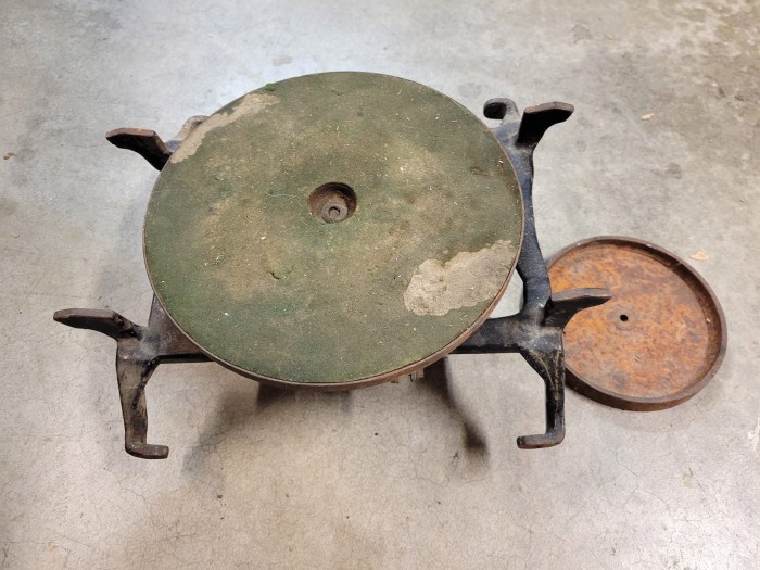

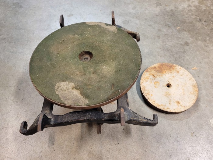

Does anyone know what this is?
Dr_Buzzsaw
Posts: 20
Joined: Tue Aug 27, 2013 8:05 pm
Post by Dr_Buzzsaw »
It came with a bunch of motor parts I bought years ago. It's incomplete and damaged but I'm wondering if anyone can identify it, assuming it actually is talking machine related.

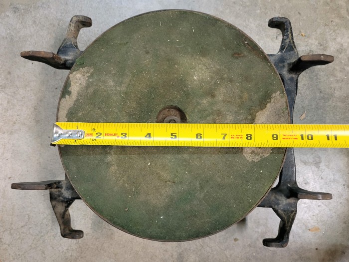

The turntable is cast iron, about 9-½ inches diameter, and settles around 78 rpm if I spin it by hand. The governor resembles a slightly larger version of those in Victor's bevel gear motors. The only mark I've found so far is "E54" on the underside of the turntable. Overall the work looks professional, i.e. not home made. I don't know if the other cast iron wheel is a part of it, but they came together so I'm including it just in case.

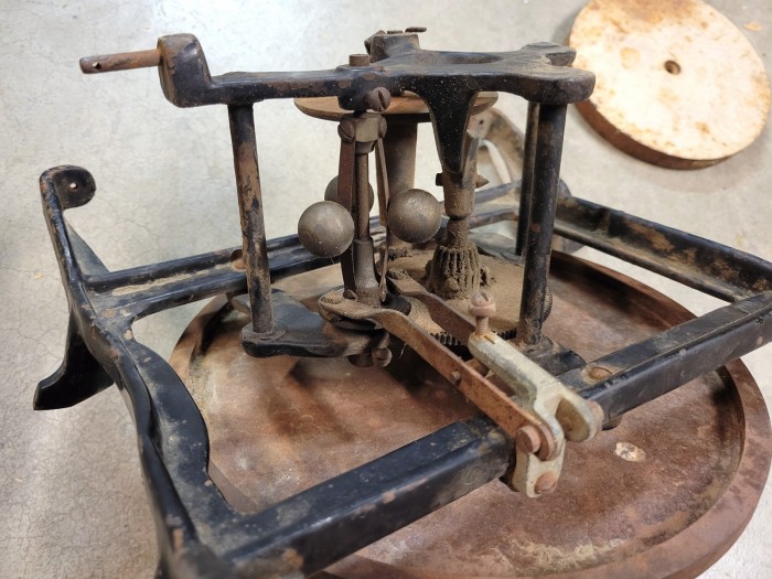

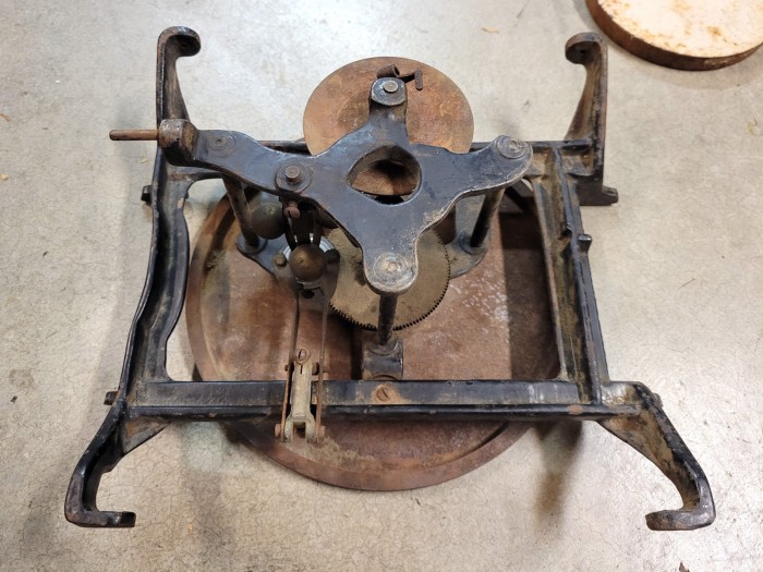

Not certain, since some of the motor is missing; but could it be a rotating store display? I seem to recall some reference to those.
- Bill
PS. I've been puzzling over the photos, and there are more mysteries: what is that large flanged part?
It appears to be driven from (or driving?) the large spindle gear; the flange and slightly conical neck are not geared- more like a small flywheel.
There also seems to be a bevel gear on the spindle, without a mating gear, but what appears to be a bearing for another shaft/gear.
-Bill

Dr_Buzzsaw
Posts: 20
Re: Does anyone know what this is?
Shawn:
I agree about it being looking / being too industrial for home use. I've wondered if it might be part of a lathe ever since I got it, but didn't want to jump to conclusions. It just doesn't seem very likely that part of an early disk lathe would end up in someone's shed in the rural Pacific Northwest. Unlikely doesn't mean impossible though.
Bill & JerryVan:
There's no obvious place to attach the missing bevel gear, its other bearing, etc, to what I have. Presumably it was on another part of the complete assembly. There's also a pin in the bottom casting, outboard of the governor, that looks like an attachment point to some other piece of casting. The flanged and tapered thing has been a mystery to me too. It doesn't make a lot of sense (to me) as a flywheel, with the much heavier turntable right there. I could be wrong though. It sort of looks like a spool, but for what and why if so? Does its beveled rim mean it was supposed to drive a friction wheel? And, if there ever was a spindle that fit into the center of the turntable, it's long gone by now.
