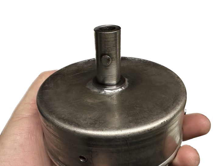

Well, I can finally say that my time has come to an end on this project. After countless failed leads at finding someone who can braze metal together and not wanting to buy an oxyacetylene torch, it finally dawned on me that I could solder these parts together. So I cleaned the area to be soldered with some fine sandpaper (making sure to clean off the nickel coating on the spring barrel), used some ancient Nokorode soldering paste, a butane torch, and some Radio Shack electrical solder that's a little too thick for the electrical parts I usually work on and voila!

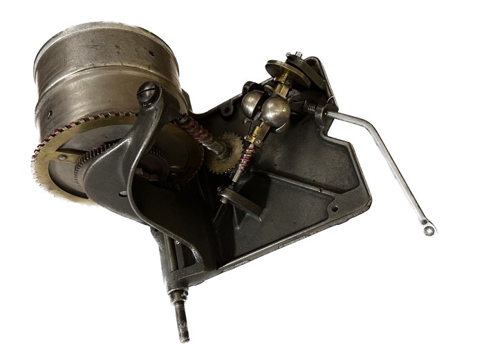

In fact, at this point, I still don't believe it's working and I messed with it for so long there's a part of me that feels like it's all going to come crashing down. Perhaps it was this frustration that led to the barrel becoming separated from the spindle and being rage-welded together in the first place! Well, my soldering job did its job, nothing broke loose or came dislodged during my rant in the basement. And so I was finally able to put the motor all back together and here it is, complete and as it was meant to be for the first time in who knows how long!
