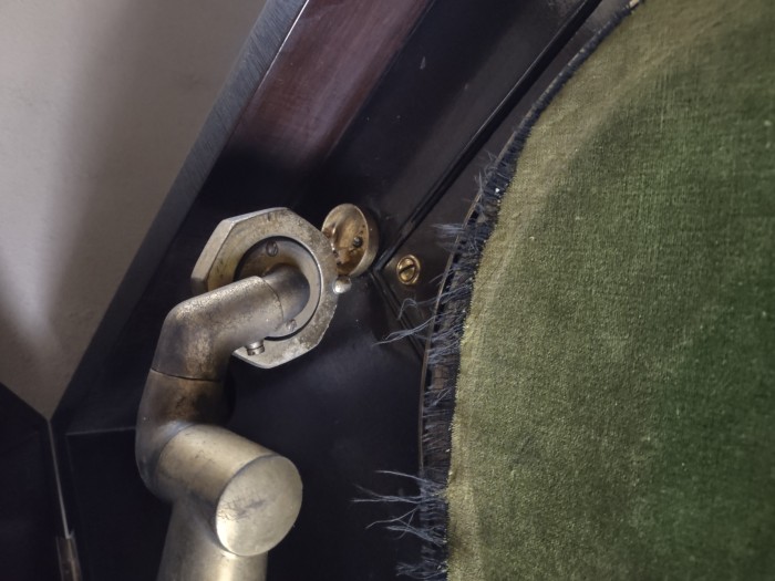

Sounds thin, several probable causes.

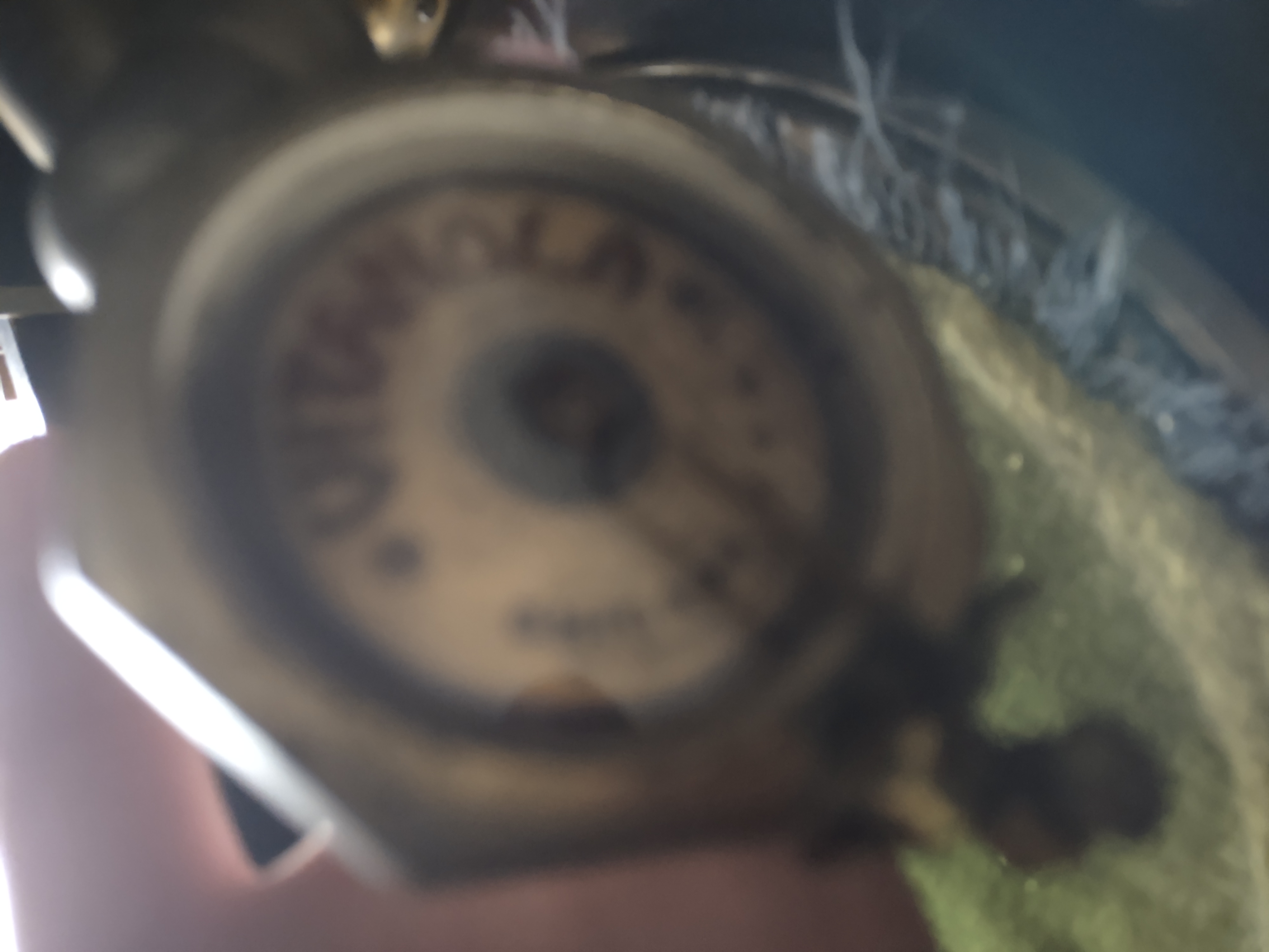

A photo from the front of the diaphragm would be very illustrative to diagnose the problem.
Could also be a problem in the conduit or horn, obstruction or air escape.
Could also be the tonearm... That joint allowing to raise or lower the soundbox works soft or hard? It seems to have a pot metal tonearm which can swell with age, preventing the joints to work softly...

I think I'm hearing some buzzing in your video. I think a rebuild is in order. As Inigo requested, some pictures of the reproducer face might help.
