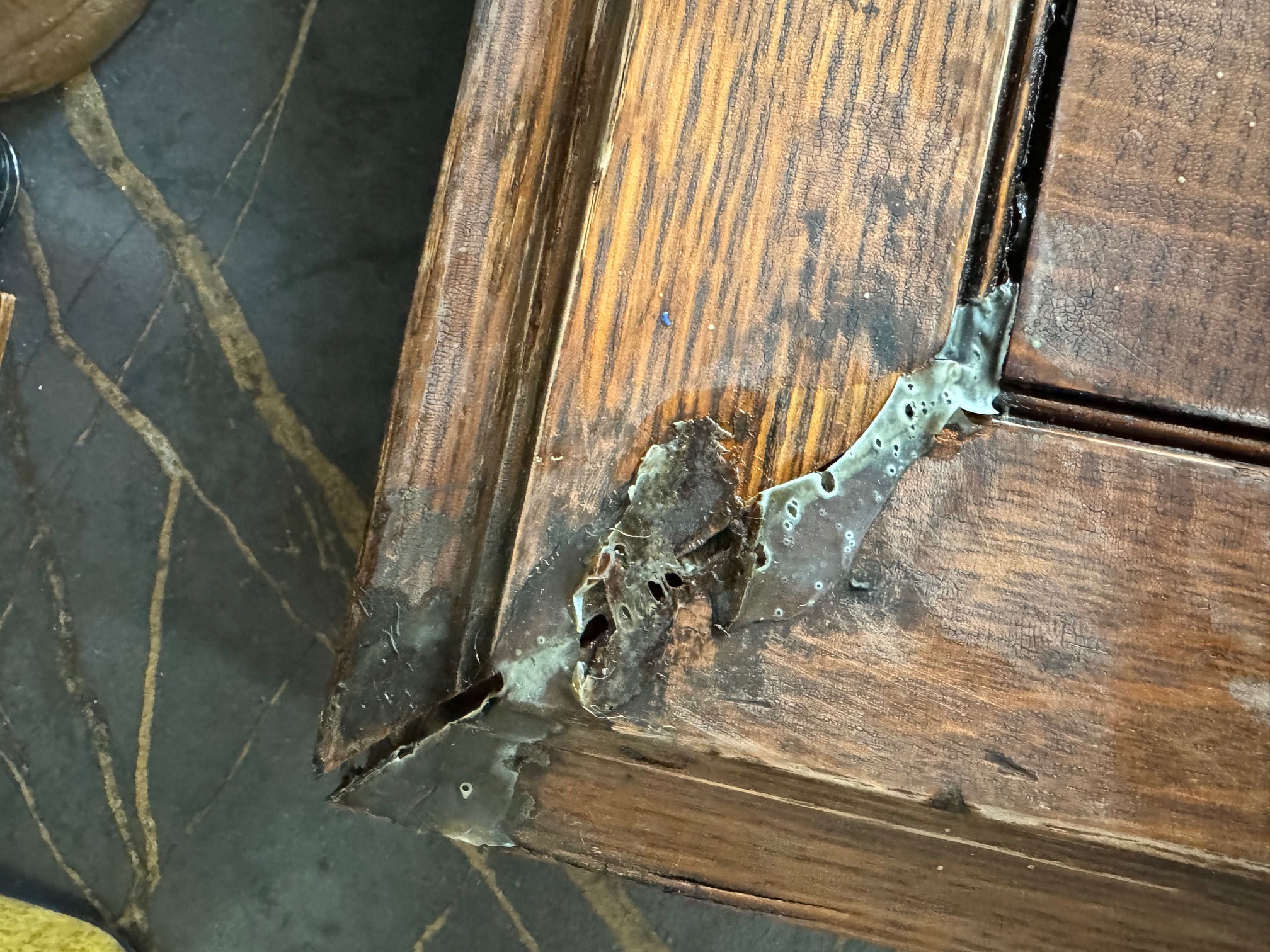

The horn was sagging badly and shimming it wasn’t working so well (thanks for advice here. Elbow is pretty dinged up - I took a different non-purist route to repair - pics in next post.

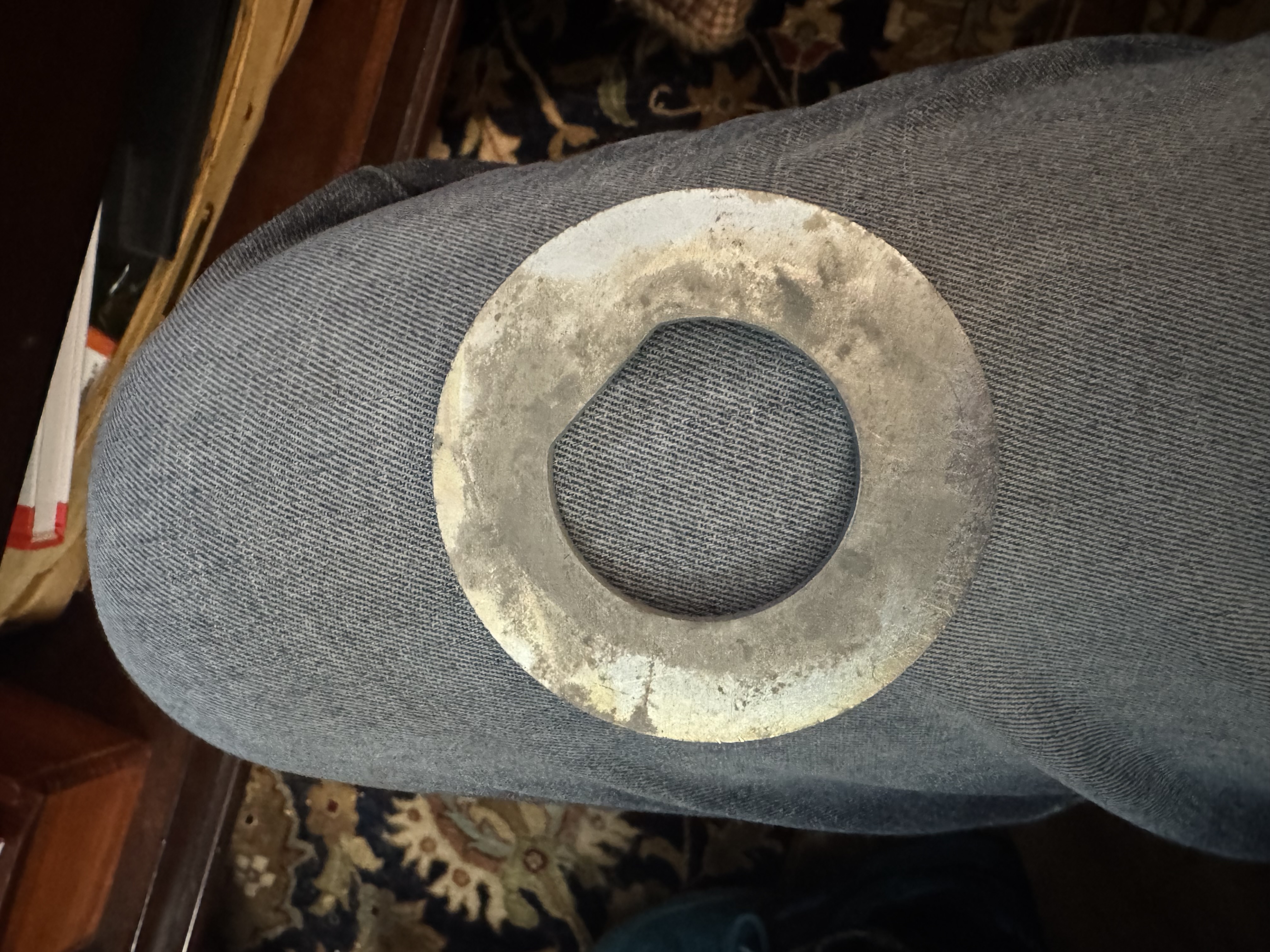

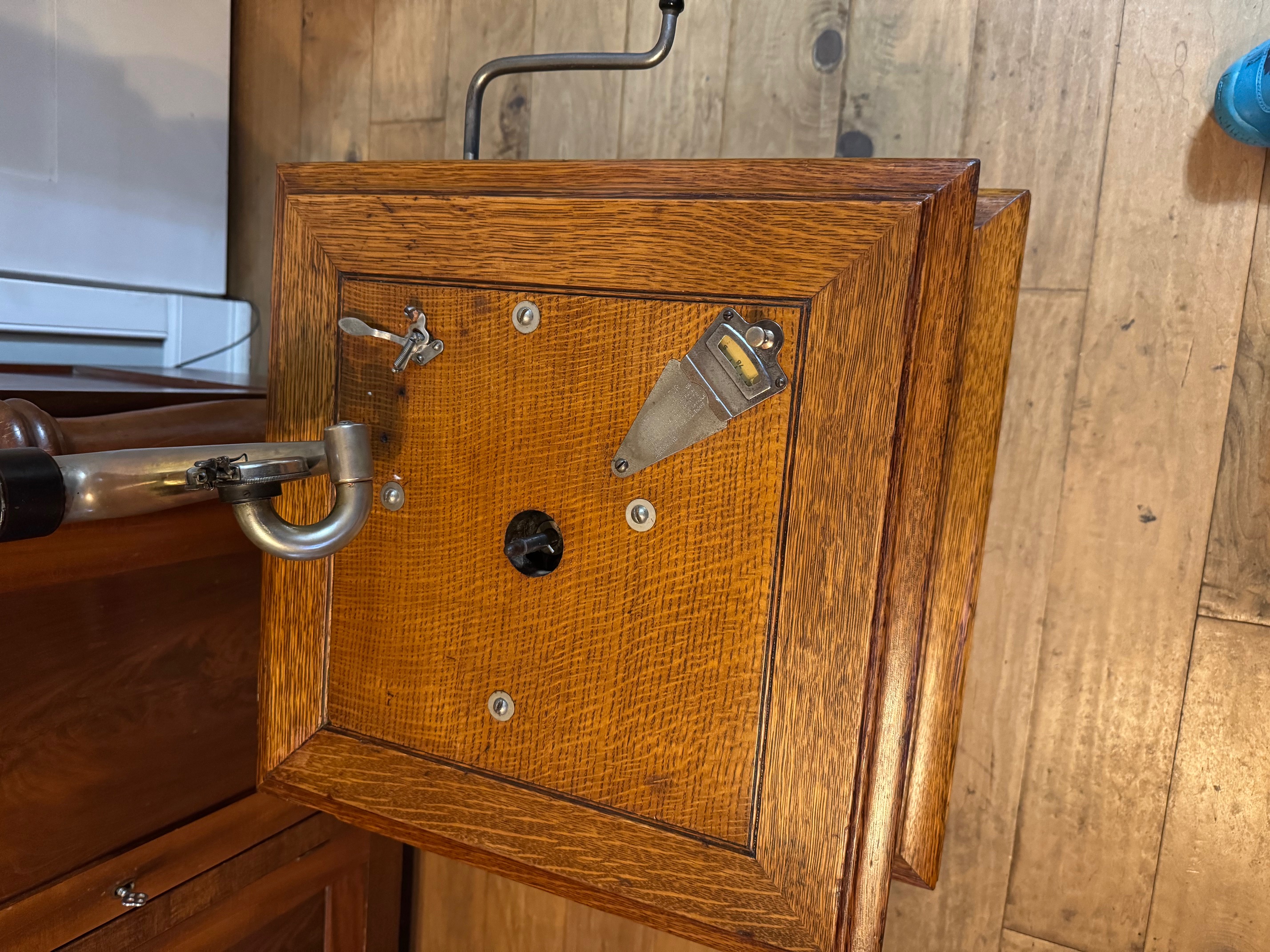

I spent some time straightening and rounding elbow best I could with expanding lathe chuck and reinforced it inside with thin spring steel. It was better but after sitting with horn in it for two days I was left with this.
So I went to awesome surplus store in Glassboro NJ and bought this giant washer
And made this (modeled after the elbow support bracket on my Victor II)
I decided I a make-do bracket made to look of appropriate age than have to deal with a sagging horn. Not sure why V did not have a similar support bracket originally. I fabricated the top support bracket along with a spacer below it.

Posts: 4672
Re: Victor V 'restore'
A very nice modification to maintain this marvelous machine in working order...
